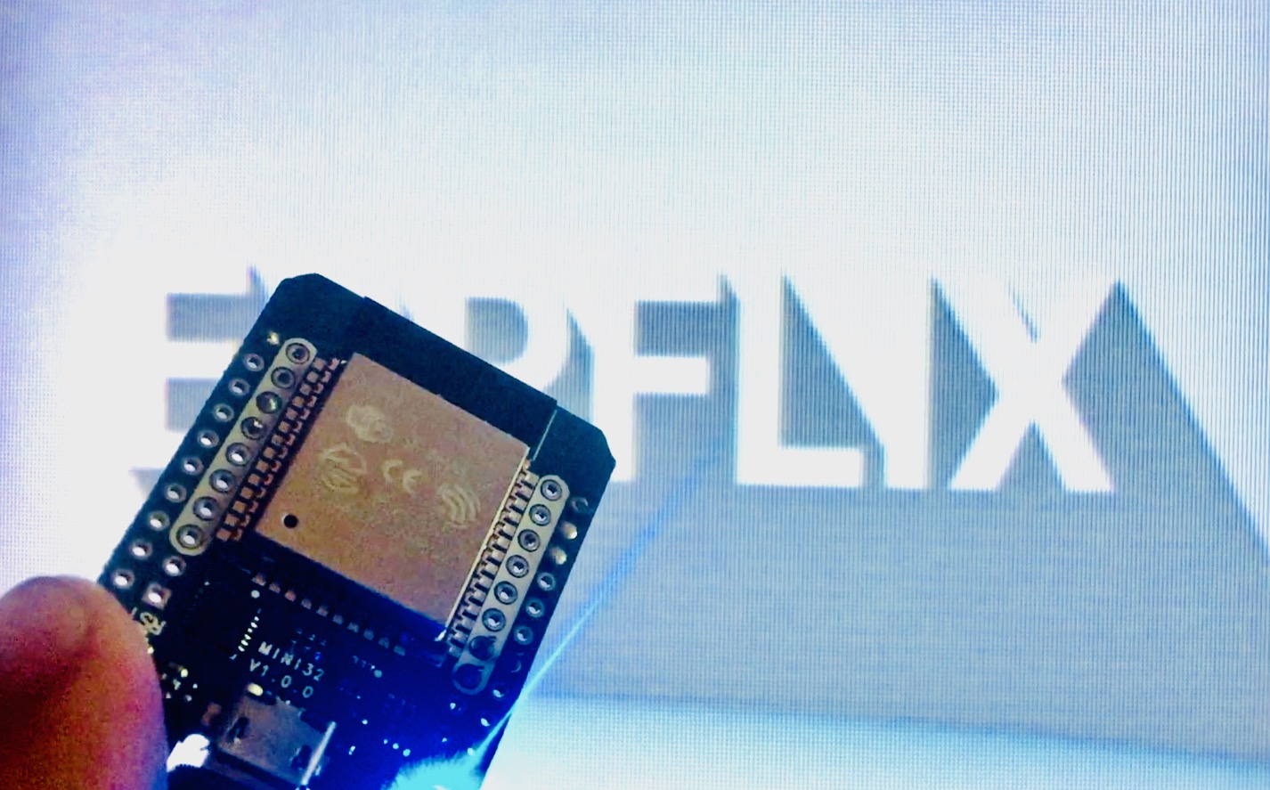

Recently, the well-known maker Rossum demonstrated in his blog the open source streaming service ESPEFLIX he created, which is based on the Arduino IDE framework and can run normally on ESP32. Lewin Day, author of Hackaday website, believes: "Now, if your TV is too old to directly access streaming services, you will have several options, such as using Apple TV, Chromecast or Android set-top box to play the content you want to watch. But if you still have some retro complex, ESPFLIX is the perfect choice for you."

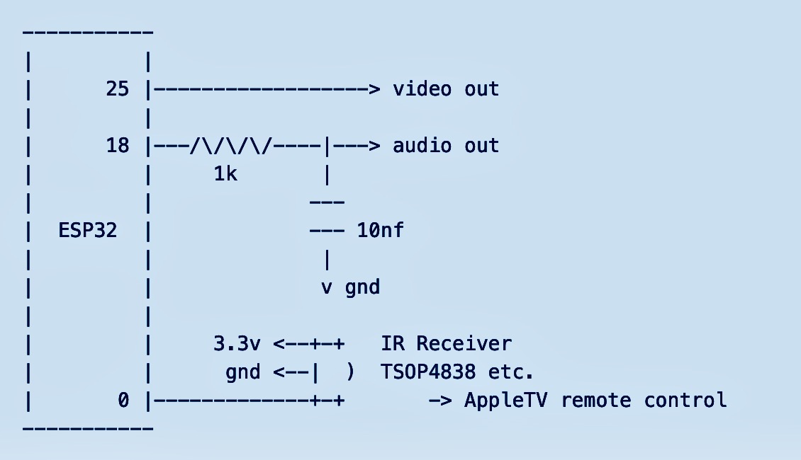

ESPFLIX is the basis of Rossum's previous ESP_8_BIT project (details: http://www.eeworld.com.cn/RDesigns_detail/50639) Developed on, the schematic diagram is very simple.
ESPFLIX adds video and audio codecs and AWS streaming services to the NTSC/PAL color composite video output capabilities of ESP_8_BIT, thereby creating an open source platform similar to Netflix (a subscription-based streaming platform). The video output of ESPFLIX adopts the MPEG1 standard with a resolution of 352×192; the audio output is generated through the SBC audio codec. SBC was originally used for Bluetooth devices, but in this project, it is easier to decode in the ESP32's RAM because it has a very small sample buffer. Finally, ESP32 generates the composite video and performs video output.
