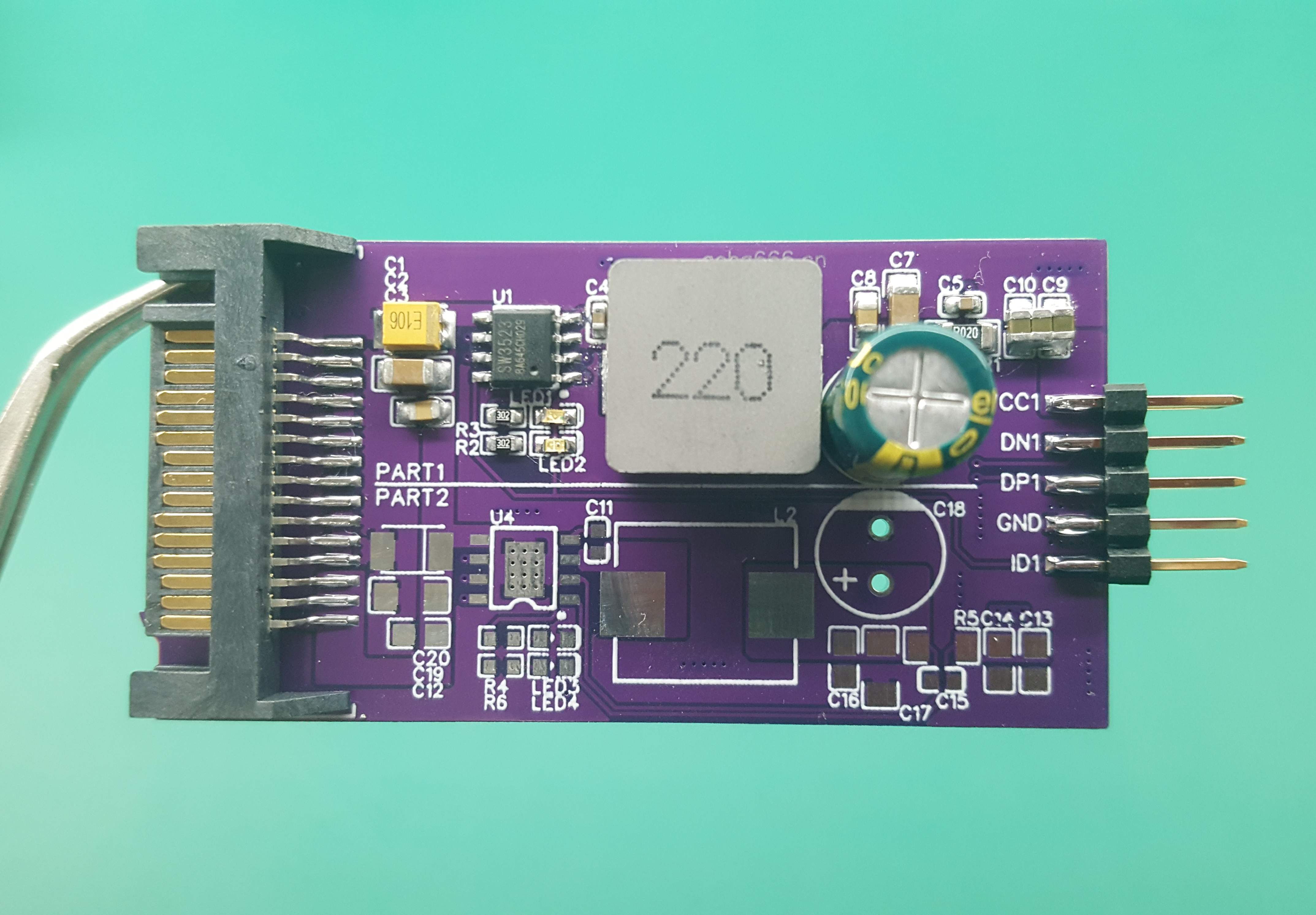

Computer front panel USB fast charging module_SW3523
characteristic
  • Support QC/AFC/FCP/SCP/PE/SFCP/VOOC
  • Compatible with front panel USB interface of normal chassis
  • Single/dual channel optional
  • Support large 4D interface and SATA power supply interface
Notice
  • The USB on the front panel of a normal chassis is 4 pins, which does not include ID pins, which will result in incomplete protocol support.
  • If the chassis interface has a fool-proof design, you may need to use 2*4P pin headers instead of 2*5P pin headers.
  • After modification, the USB port has no data transmission function (can only charge)
  • Please pay attention to the USB wiring on the front panel of the chassis. In some cases, the 5V lines of the two front panel interfaces are connected and a short circuit may occur.
  • The large 4D interface supports three packages, please refer to C35486 C492553 C492556
  • SATA power supply interface reference Taobao link
  • Because I forgot to buy the 10mR resistor, I used two 20mR resistors on top of each other. Don’t follow my example.
