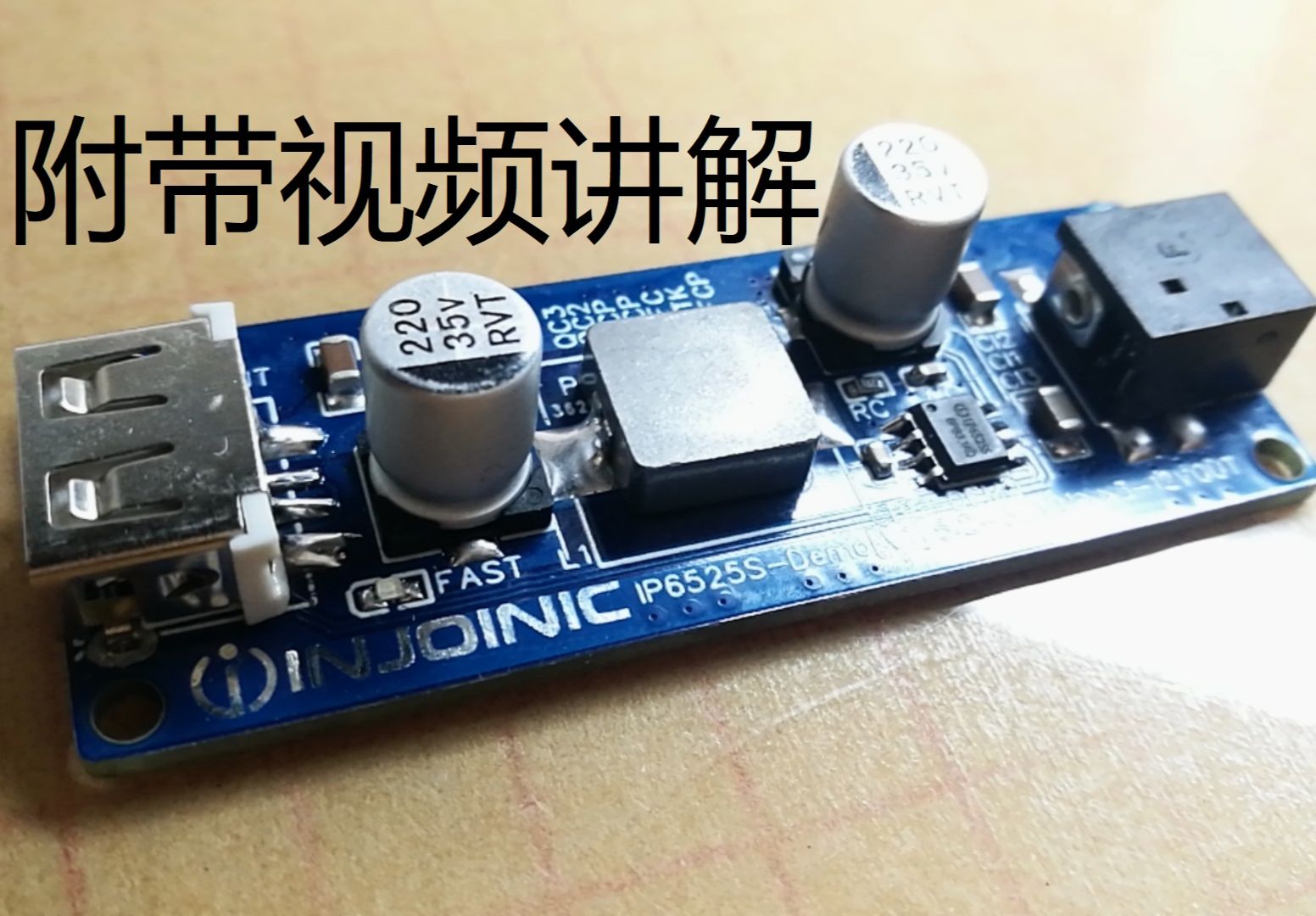

IP6525S synchronous switching buck converter
Built-in power MOS
Input voltage range: 5.2V to 32V
Output voltage range: 3V to 12V, automatically adjusted according to fast charge protocol
QC output power: maximum 18W (5V/3.4A, 9V /2A, 12V/1.5A)
SCP maximum output power: maximum 22.5W
Output has CV/CP/CC characteristics
VIN=24V, VOUT=5V/3A, board-side conversion efficiency is 94.2%
Soft start function
Output Voltage line compensation function, line compensation voltage 50mV@1A
IP6525S is a buck converter with integrated synchronous switch, supports multiple output fast charging protocols, and provides a complete solution for car chargers, fast charging adapters, and smart power strips.
IP6525S has built-in power MOS. The input voltage range is 5.2V to 32V and the output voltage range is 3V to 12V. It can provide a maximum output power of 22.5W. It can automatically adjust the output voltage and current according to the recognized fast charging protocol. Typical output voltage and The current is 5V/3.4A, 9V/2.0A, 12V/1.5A.
IP6525S has an over-current point automatic adjustment function. When the SCP and low-voltage fast charging protocol handshakes are successful, it supports 5V/4.5A and 4.5V/5A.
The output voltage of IP6525S has a line compensation function. When the output current increases, the output voltage will increase accordingly to compensate for the voltage drop caused by the impedance of the connecting line.
IP6525S has a soft-start function, which can prevent the inrush current during startup from affecting the stability of the input power supply.
IP6525S integrates the fast charging protocol, which can automatically identify the fast charging protocol supported by the output terminal access device through DP/DM, and then automatically adjust the output voltage and current. The fast charging
protocols include DCP (Apple and BC1.2), Qualcomm QC2.0/QC3.0, Huawei fast charging protocol FCP, Samsung fast charging protocol AFC (MAX 12V),
MTK fast charging protocol, Spreadtrum fast charging Protocol SFCP and OPPO fast charging protocol VOOC.
IP6525S has a variety of protection functions, including input overvoltage and undervoltage protection, output overcurrent, overvoltage, undervoltage, short circuit protection, etc.
IP6525S is packaged in ESOP8.
