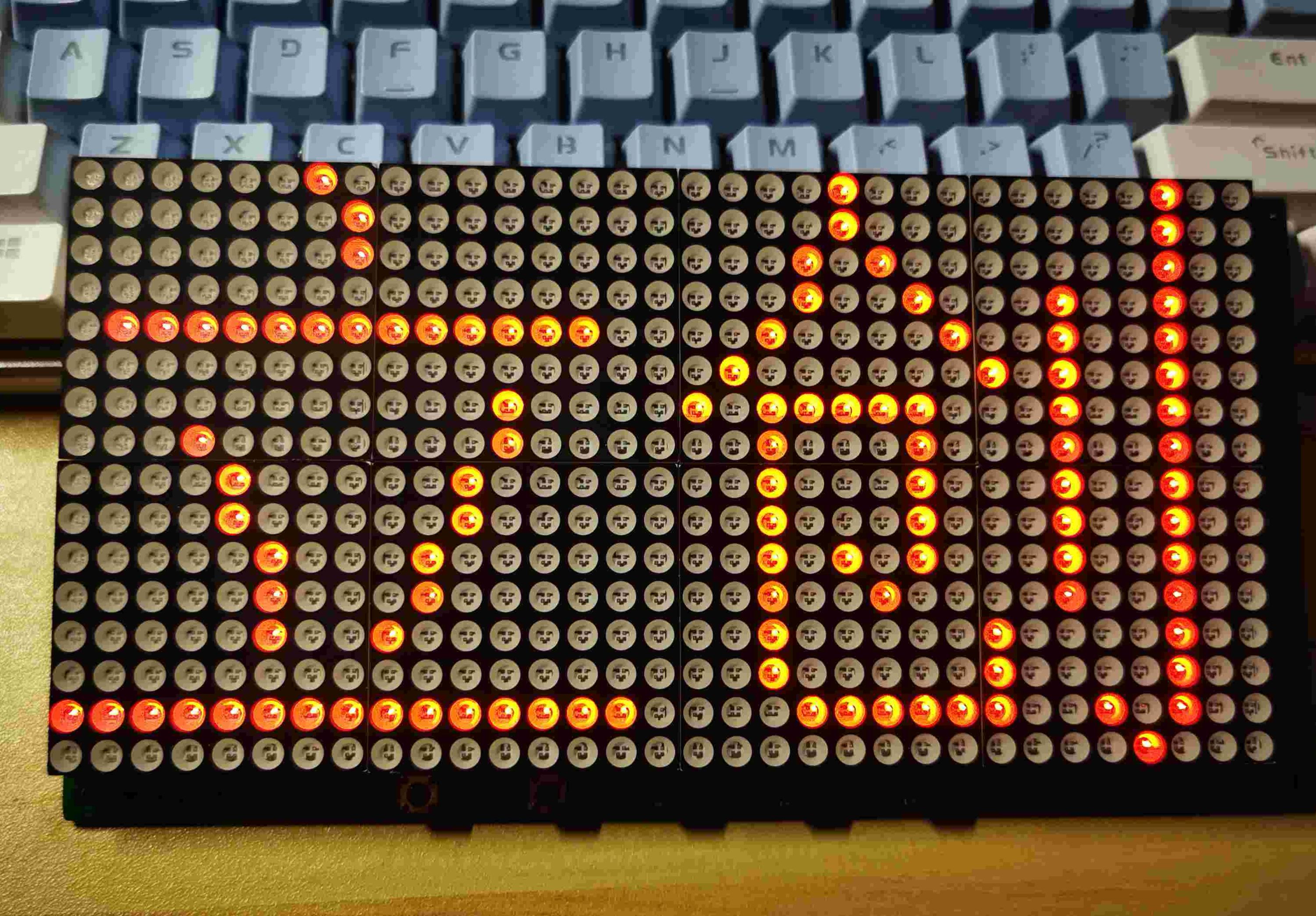

The display effect is as follows:

The actual writing effect is as follows:
The picture above demonstrates the light mode. If you accidentally write it wrong, you need to use the light mode. The principle is similar.
