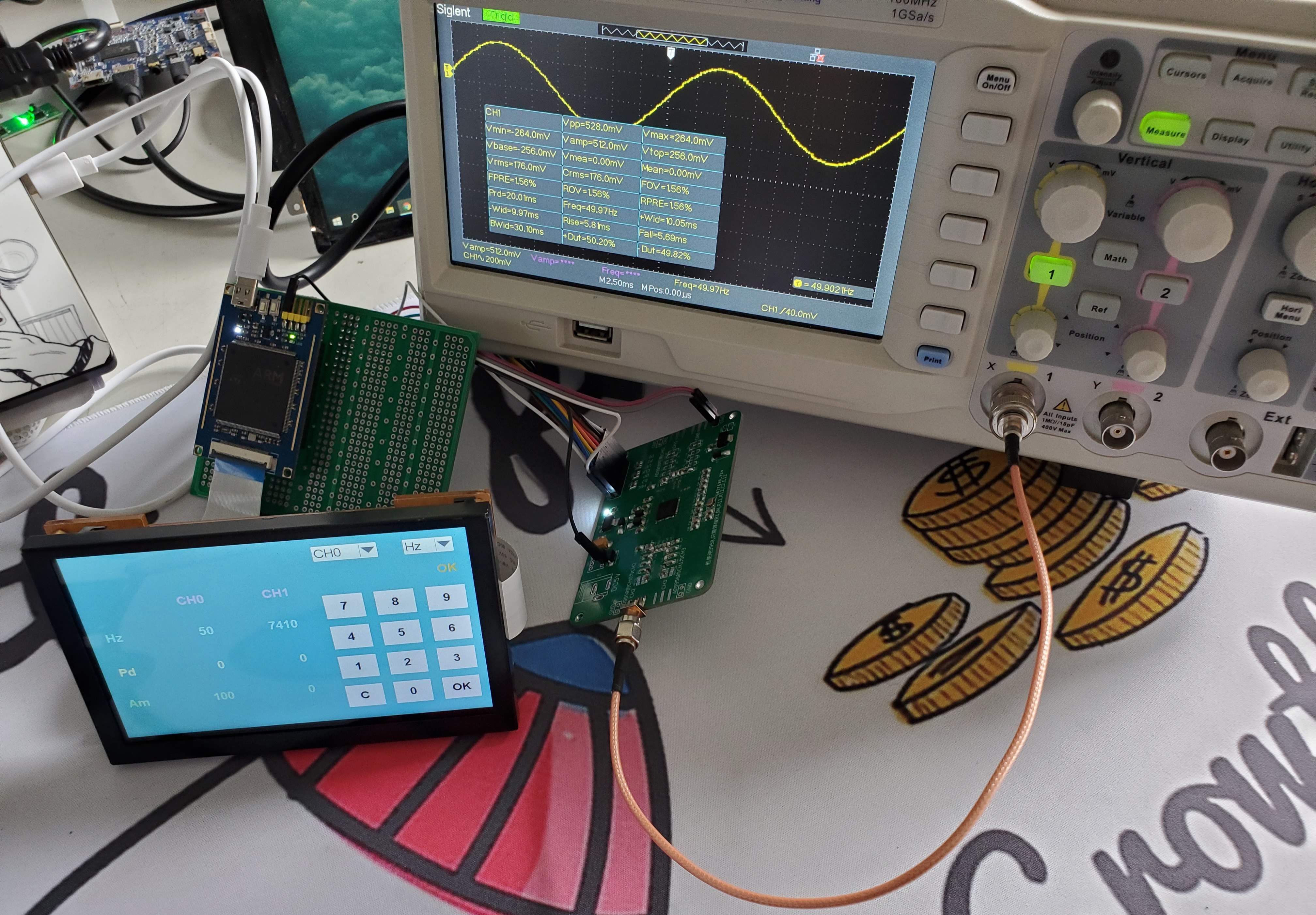

Based on STM32F429BI, it runs uCOS-III and emWin driver AD9958+5-inch screen.
The above is all about introducing them, and there is nothing important at all. Next, let me talk about the problems I encountered in making the board and debugging:
  1. The AD9958 board actually does not require much attention. Try to draw it as standard as possible. The key point of this chip is flexibility. It can be used to correct imbalance problems between signals caused by analog processing such as filtering and amplification or PCB layout mismatch. .
  2. The test pin of AD9958 is pin 17. When it is completely welded and powered on, the voltage of this pin is about 1.2V. Then the chip works normally. If there is a weak soldering or internal damage to the chip, the voltage of this pin is 0. (Don’t ask me why I know, I lost a piece of soldering and my 300 yuan was gone.) The package of this chip is LFCSP. Particularly easy to solder.
  3. When using microcontroller driver, SDIO_3 pin must be low level
  4. AD9958 and AD9959 common codes, the only difference is that two channels are castrated
  5. The modulation and frequency sweep of this chip are still under study, and it is estimated that it will be used in the two projects of amplitude-frequency characteristic detection device and multi-waveform radar signal source.
  6. uCOS-III needs to pay attention to the release and acquisition of semaphores and mutexes
  7. The capacitive touch screen does not require calibration and can support up to 5-finger touch. However, in emWin, I still touch with one finger to prevent accidental touches.
  8. The graphical interface needs to be optimized and debugged slowly. There are many videos on the Internet, you can check it out.
  9. Since there are no amplification and gain modules around, I haven’t done many functions. In addition, I have to review for the final exam, so I don’t have much time to do it.
  10. Since I only welded one channel interface, there were only changes in frequency and amplitude in the demonstration, but the phase could not be seen (I can’t use an oscilloscope, I’m too bad)
  11. Our school only has 100M oscilloscopes. . . . . . . So the frequency range I set is 1Hz~99Mhz
  12. I also added a file system. I wanted to add the function of taking screenshots and adding an SD card so that I could view my saved configurations. However, I ran out of time and the event was about to end, so I didn’t proceed further. I just added it in. The follow-up will be slow. slow to perfect
  13. 硬件图
  14. The video only demonstrates the frequency. Since I only welded one channel, the first channel was not displayed on the oscilloscope. The phase and amplitude can also be set, but the oscilloscope couldn't play with it, so I didn't operate it. That's it for the time being. 0.0 0.0 0.0 more
