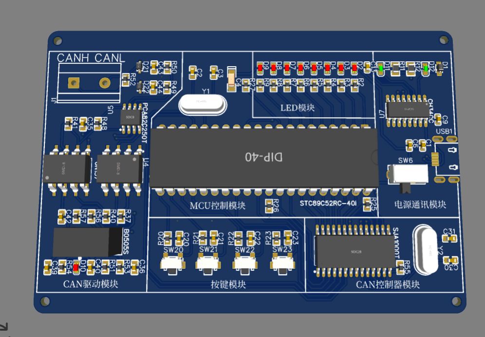

The magnetometer data transmission system based on CAN bus adopts STC89C52RC microcontroller as the core for expansion design, combined with
The software program for CAN bus communication implements communication tasks such as receiving and sending data. To enhance the CAN bus
For anti-interference capability, the TX0 and RX0 pins of SJA1000 pass the high-speed optocoupler 6N137 with the CAN driver PCA82C250
TXD and RXD are connected to achieve electrical isolation between CAN nodes on the bus . In order to realize the communication between the magnetometer data transmission system and the computer,
The USB to serial port chip CH340C is used as the power supply circuit , and at the same time it realizes the transmission function of CAN bus to serial port data .
The debugging assistant can see the CAN data being transmitted.
