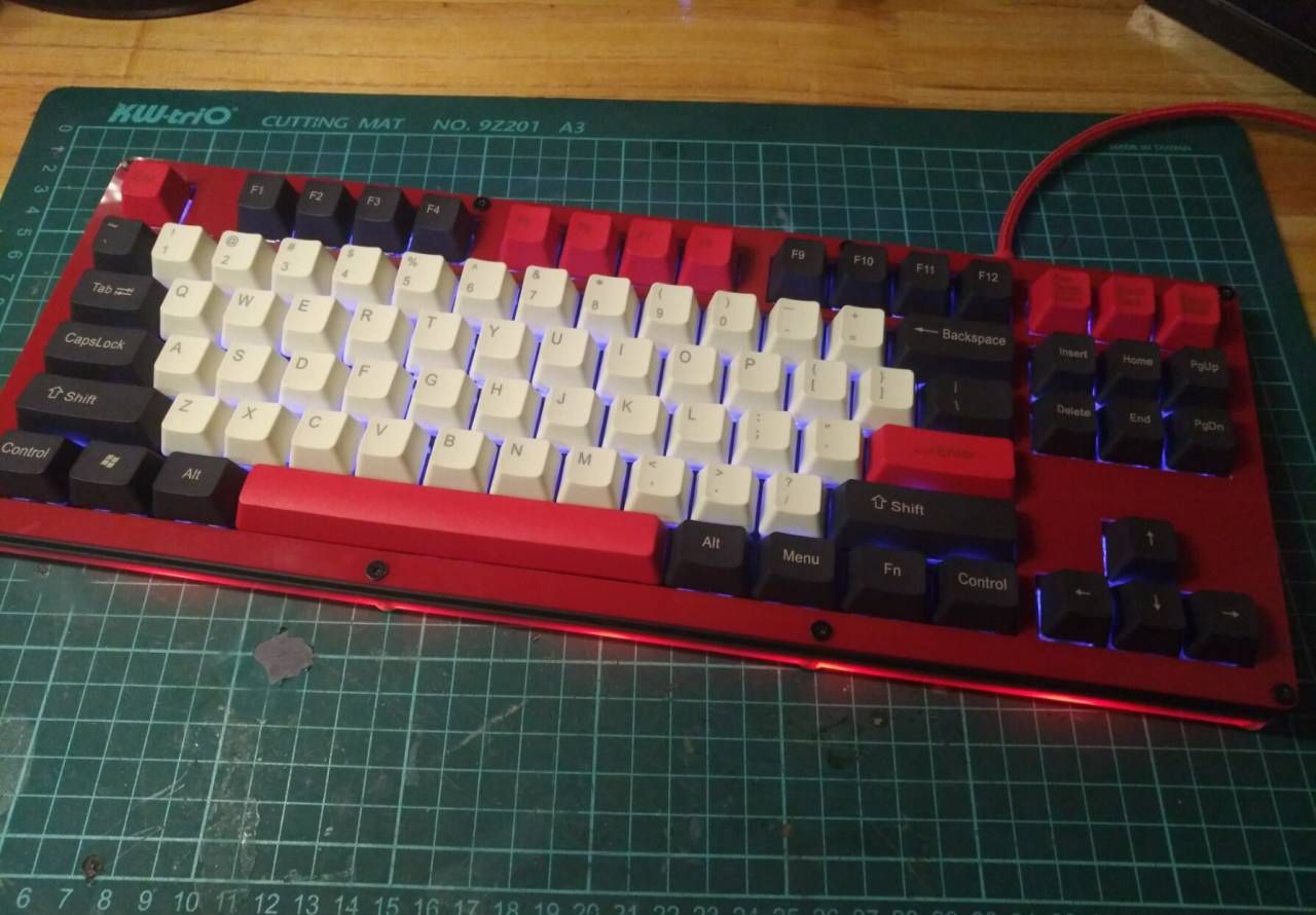

I had open sourced an 87 before, but it couldn't be used in actual testing. This time I redesigned it, made some improvements, and the prototype has been tested successfully!
The configuration is as follows:
  1. ATMEGA32U4 master control (compatible with AU, MU)
  2. QMK solution
  3. Monochrome SMD shaft light
  4. Compatible with three-legged and five-legged shafts, welded shaft body
  5. PCB satellite axis
  6. Type-c USB interface
  7. 12 RGB backlights
  8. Acrylic stacked shell (PCB does not need to be fixed, the shell is fixed with locking copper rivets)
  9. I will draw the CNC shell later (big guys with a lot of money can try it)
  10. The firmware source code needs to be used with the QMK compilation environment (Bilibili has a construction tutorial)
  11. All matrix pins are lead out individually and can be connected to other external masters.
The actual test went well!
2021.2.8 update: Fixed ISP download pilot error
PCB display:
QQ picture 20201011165311.jpgQQ picture 20201011165302.jpgQQ picture 20201011165305.jpg
The duck after welding: QQ picture 20201011165229.jpgQQ picture 20201011165235.jpgQQ picture 20201011165238.jpg
Lighting effect diagram: QQ picture 20201011165246.jpgQQ picture 20201011165249.jpgQQ picture 20201011165253.jpg The lighting effect demonstration video is in the attachment below
Acrylic stacked shell effect display:
I have attached the specific production instructions, production files and 3D files in the attachment below.
Note about the casing: The small square hole opened on the bottom layer is a bit upward and may conflict with the reset button on the PCB. It is recommended to grind it down about 3 mm. QQ picture 20201128230713.jpgQQ picture 20201128230655.jpgQQ picture 20201128230817.jpgQQ picture 20201128230811.jpg
