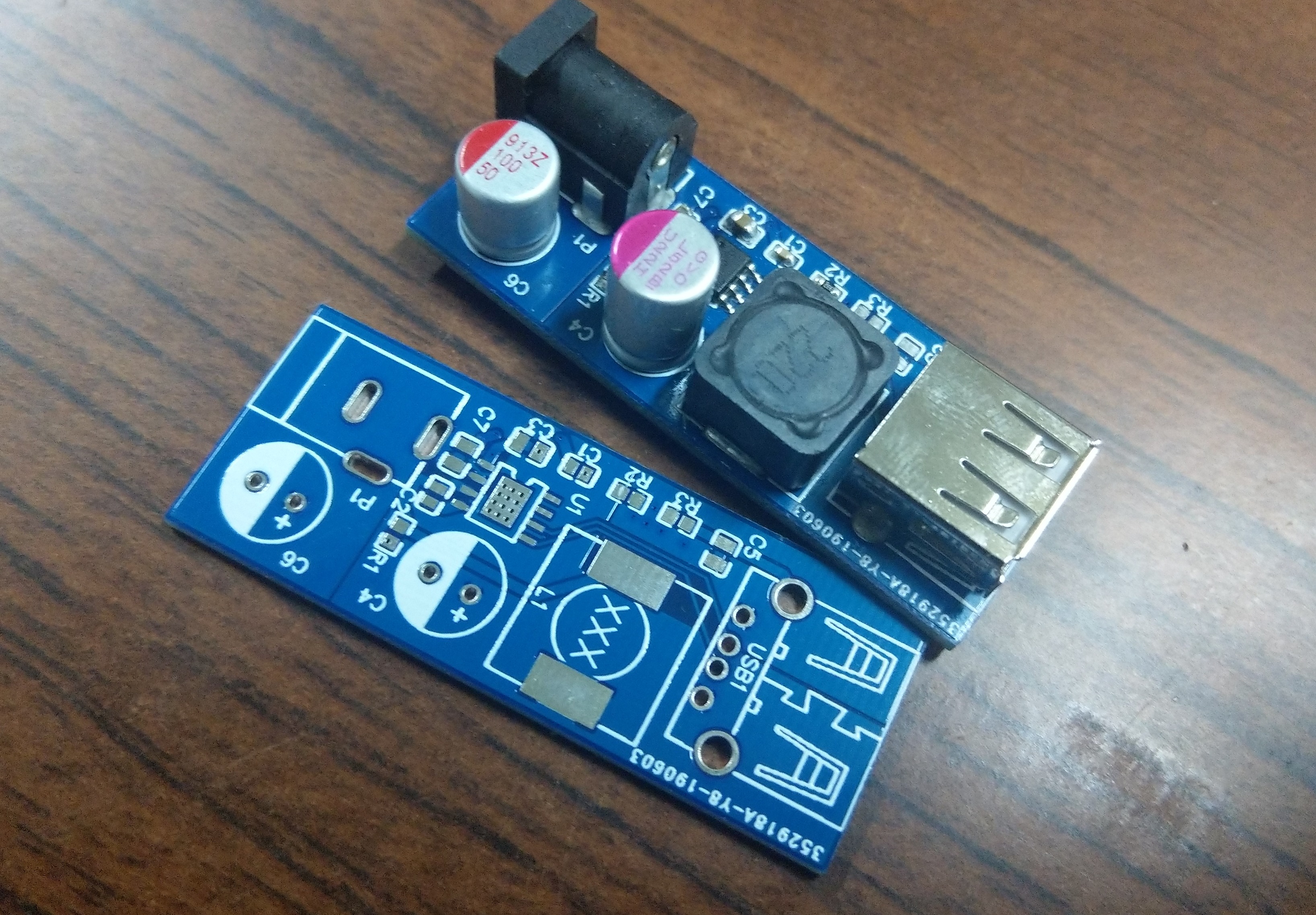

IP6510 test photo.jpg This circuit is an IP6510 solution verification board that supports fast charging protocols from 4.5V to 32V input, QC 3.0, FCP and other protocols. IP6510 is a buck converter with integrated synchronous switch, supports 9 output fast charging protocols, supports Type-C output and USB PD protocol, and provides a complete solution for car chargers, fast charging adapters, and smart power strips. IP6510 has built-in power MOS, the input voltage range is 4.5V to 32V, the output voltage range is 3V to 12V, it can provide a maximum output power of 18W, and can automatically adjust the output voltage and current according to the recognized fast charging protocol, typical output voltage and current There are: 5V@3.1A, 7V@2.4A, 9V@2A, 12V@1.5A. The IP6510's buck conversion efficiency is as high as 97%.
Instructions for use: Connect 4.5V - 32V to the DC5.5 interface (to ensure fast charging, it is not recommended to go below 12V), connect the mobile phone to the USB port, and start charging the mobile phone.
