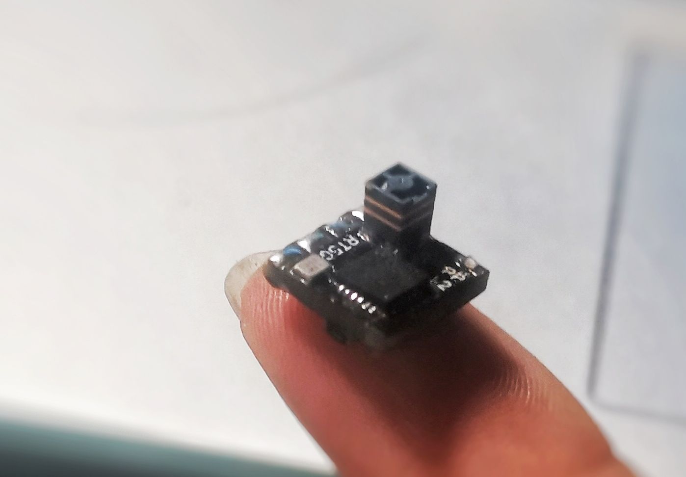

This receiver is a non-original product in the ExpressLRS open source receiver project and is only for the convenience of domestic players.
For this project, it is recommended to choose a thickness of 1.6mm when laying out a four-layer PCB board. The components are all packaged in 0402. The antenna is made of Molex 47984. When heating with an air gun, the temperature should be kept as low as possible and avoid prolonged heating to prevent the antenna from melting.
