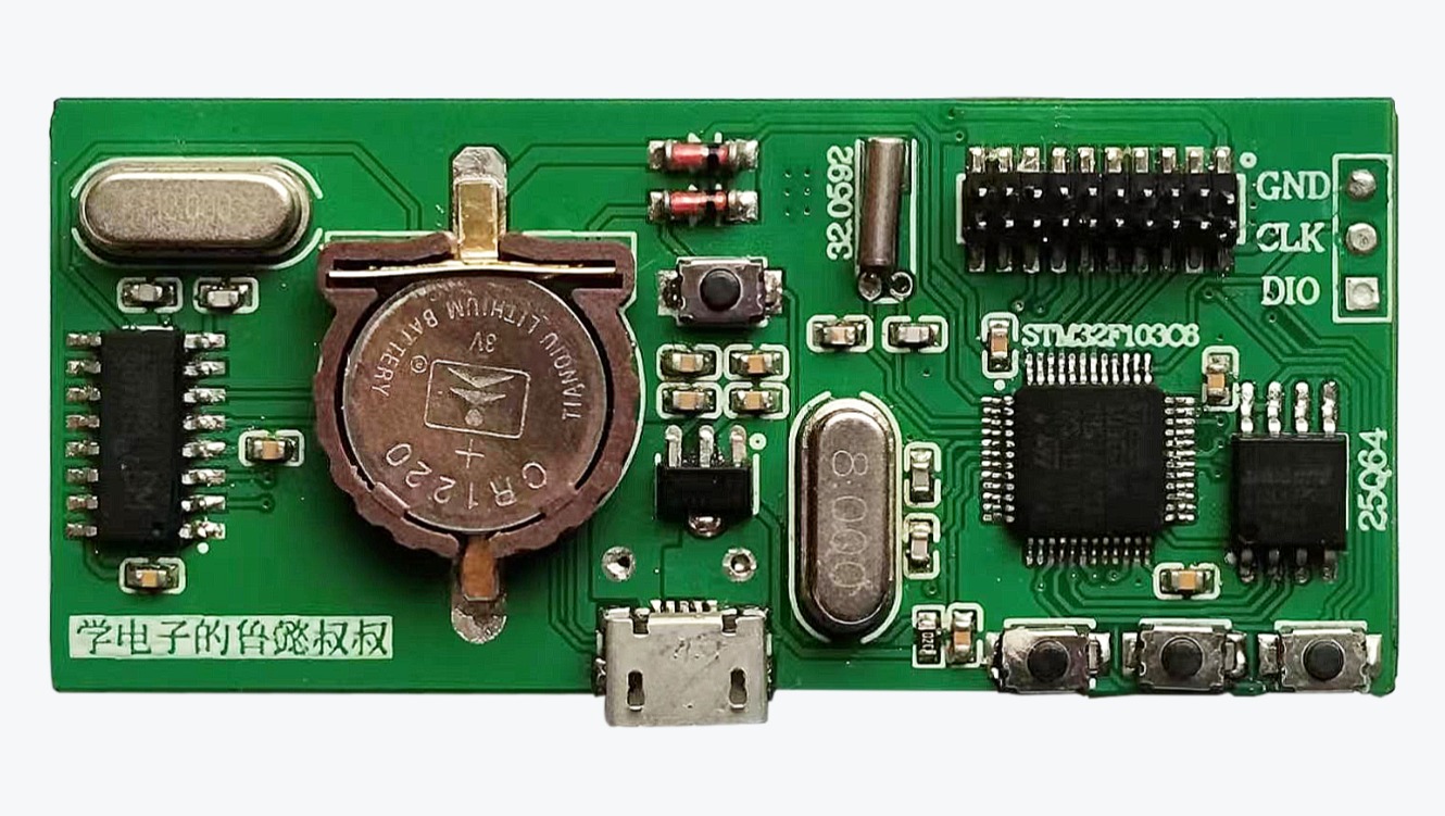

Introduction: This module is the main control board of the analog Nixie tube clock and is used to drive the analog Nixie tube display module.
1. Project Introduction
This module is a main control chip board that simulates a Nixie tube clock. It can store picture information and drive the display module. The main control board cannot be used alone and needs to be used with the display module to achieve the display effect of a Nixie tube clock.
2. Application scenarios
can be applied to the development projects of consumer-grade analog Nixie tube clocks such as desktop ornaments and decorations.
3. Product Overview
The main control chip board uses STM32F103C6T6A, the cheapest chip of the STM32F1 series, as the main control chip. It is equipped with a CH340 USB to serial port circuit, an RTC power supply, an 8M SPI Flash (W25Q64), and uses common MicroUSB for power supply. The SWD interface is left for firmware burning, and three independent button interfaces are provided. Users can define button functions by themselves. It is connected to the display module through a 2*10PIN 1.27mm pin header to drive the display module and achieve the effect of simulating a Nixie tube clock. At the same time, the time information is not lost when the power is turned off.

1 . After getting the module for the first time, connect the main control board and the display module. The interface is as shown in the diagram below.
2. To burn the firmware, the burning tools and burning documents are in the attachment. You need to prepare ST-LINK or JLINK by yourself. Serial port burning is not supported at the moment.
2. After the firmware burning is completed, you need to download the display image. Before connecting, you need to prepare the CH340 driver. The driver file is in the appendix. After the driver is installed, use a micro USB data cable to connect the device to the computer.
3. Open the "Analog Nixie Tube Clock Image Download Tool.exe" software in the "Analog Nixie Tube Clock_Supporting PC.zip" in the attachment, and download the image according to the "Image Download Tool User Manual.pdf" file operate.
4. After the download is completed, disconnect the USB and power on again to display the simulated Nixie tube clock effect.
