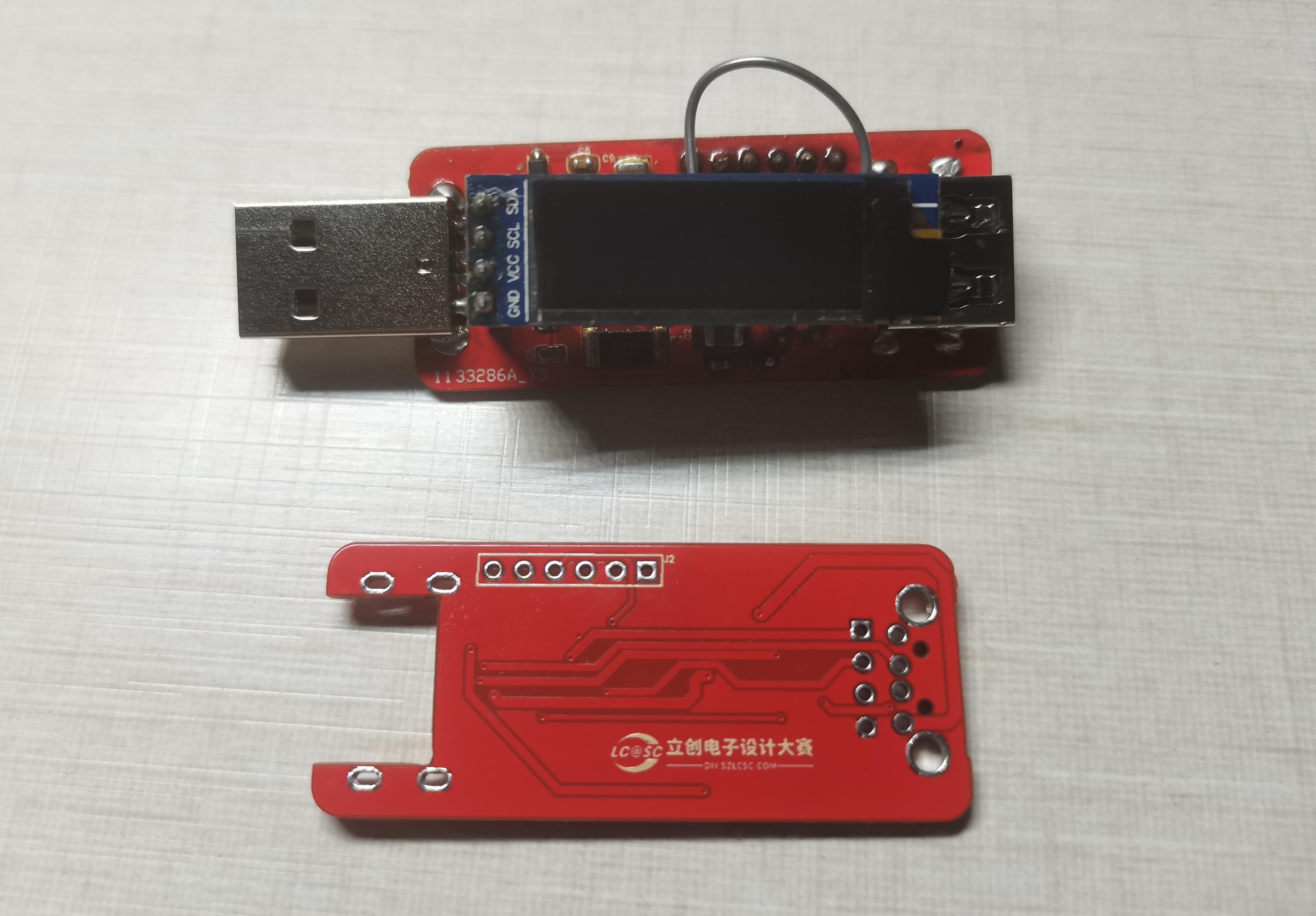

Although I downloaded LiChuang EDA a long time ago, I am still a novice and don’t have much good content to share with you.
1. Large currents require thicker wires
2. Be careful not to use the wrong network labels and identifiers (be careful!!), because the error was so unexpected that I couldn’t find the cause after several days of investigation, and I almost gave up completing the project (as shown in the figure below, the 9-pin VCC uses the network label, and the other power pins use identifiers. This error caused the screen to not light up, which was later solved by flying wires)
3. The power count value fluctuates greatly. I guess it is caused by irregular layout and flying wires. I would like to ask for an answer.
4. This time, I followed the official board drawing intact. I have experienced the whole process of electronic products from design to finished products. I hope that I can have my own ideas and realize them in the next training camp.
