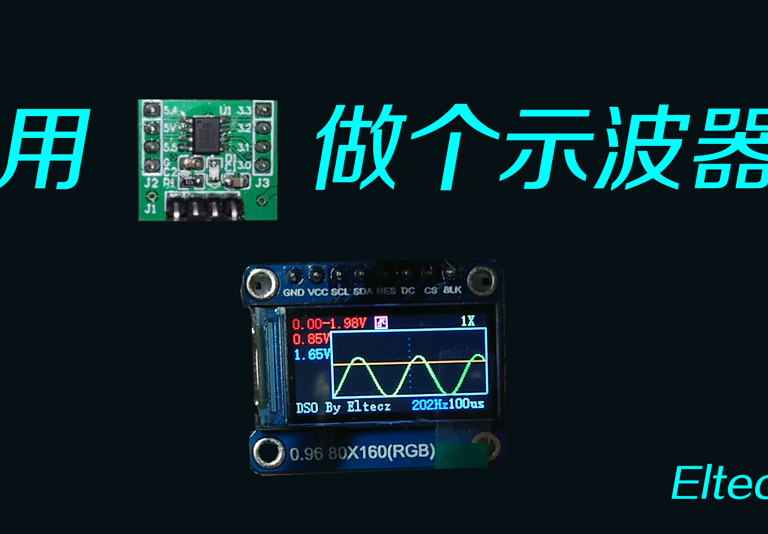

Oscilloscope parameters:
AD input voltage 0-3.3V/5V (depends on the screen)
8bits@200Khz
1-2-5 time base step from 5us to 500us
Vertical magnification 1-2-5 times
Three triggering methods, 10 trigger levels from 0-90%
Waveform measurement function
The core board is based on my project https://oshwhub.com/Eltecz/stc8h1k
The schematic diagram is for reference, LAYOUT is not drawn, and the TSSOP20 microcontroller will be used to make the actual object. The new version of the oscilloscope has been produced, see [Station B] / [LCEDA]
Note, please adjust the frequency to 32Mhz when downloading
Note: If you use a microcontroller with 8kb Flash space, please change the compilation level to -level 9, and the compilation option needs to be changed to favor size
