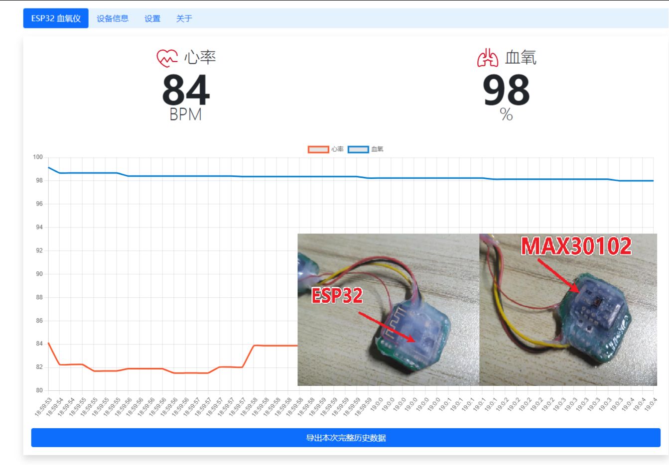

# ESP32 MAX30102 Web Oximeter
A MAX3010X Web Oximeter based on ESP32.
The heart rate and blood oxygen calculation and driver codes of this project come from the following project:
https://github.com/coniferconifer/ESP32_MAX30102_simple-SpO2_plotter
This project is reconstructed on the basis of the above project, adding a Fat file system, allowing users to use FTP to manage the file system to upload the web front end; using Bootstrap + ChartJS to redesign the front-end program, adding the historical chart curve function, and adapting to the mobile phone
![1.png] ![230111huk2e645fauu4auf.png] ![230111xqqrf2fgi27qifh3.png] # [**Demo video**](https://www.bilibili.com/video/BV1DG4y1L7N2/?vd_source=2827e677d6d7e32ef3817579a35304ac)

- ESP32 automatically turns on the hotspot "ESP32 Oximeter"
- Connect to the hotspot
- Use a browser to open [http://192.168.4.1](http://192.168.4.1)
- Start using

The front-end interface is as shown below:
![1.png] ![2.png] ![3.png]
