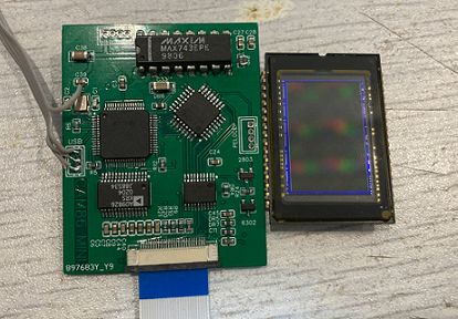

The first and second generations are proof of principle, please ignore them.
Three generations, four generations are the most perfect. The fourth generation has optimized wiring (tested to have lower noise levels)
Refer to the Maozi schematic diagram for CCD terminal wiring. The lines are symmetrically distributed, which is convenient for wiring or PCB routing.
Please refer to the original version of Maozi for the BOM table.
