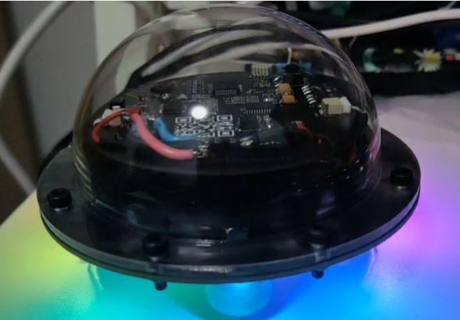

【CW32】UFO Car Bluetooth Brushless Remote Control Car Based on CW32
UFO Vehicle!
Appearance Gallery
circuit
Main control board, Bluetooth, motor driver, 3.3v, 5v ldo.
The base plate is in charge of RGB. There are several holes on it to connect the main control board and wheels.
structure
Universal wheel
Wheel (brushless motor body)
Tires made of water pipes (^_^)
Velcro covers messy wires
hardware
MCU
Two MCUs are used, both made in China.
CW32F030C8T6 and MCU Pin2Pin from foreign companies, up to 64M.
The CH571K peripheral only requires a capacitor and crystal oscillator to realize the Bluetooth function.
The motor is a small inductive brushless motor, directly driven by the motor driver chip PT2432. PT2432 internally integrates over-current, over-temperature protection and stall protection.
CW32F030C8T6 outputs pwm to PT2432 to control motor rotation, and several gpio are attached to control forward and reverse rotation.
CH571K is connected to CW32F030C8T6 through the serial port, transparently transmits the data sent by the remote Bluetooth, and controls the motor or ws2812 after decoding.
