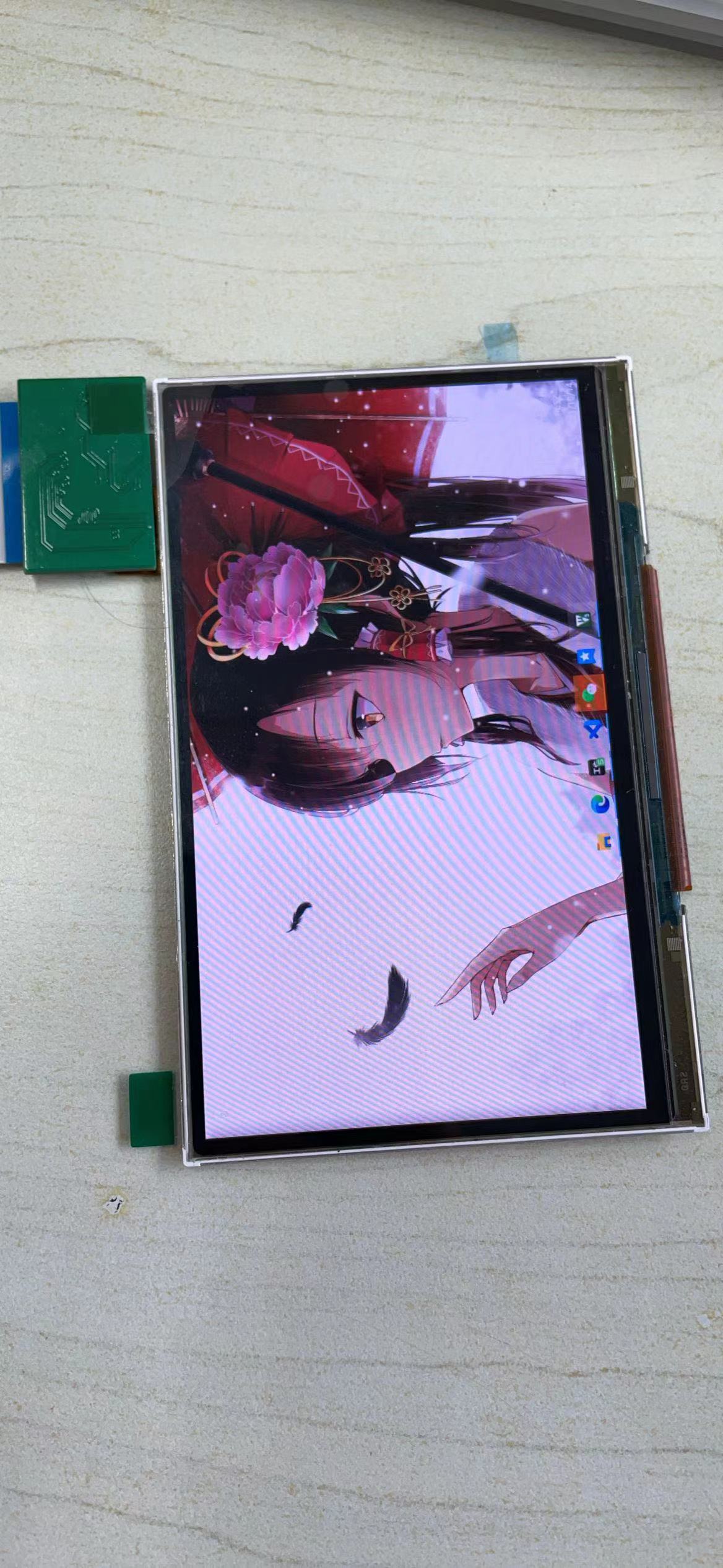

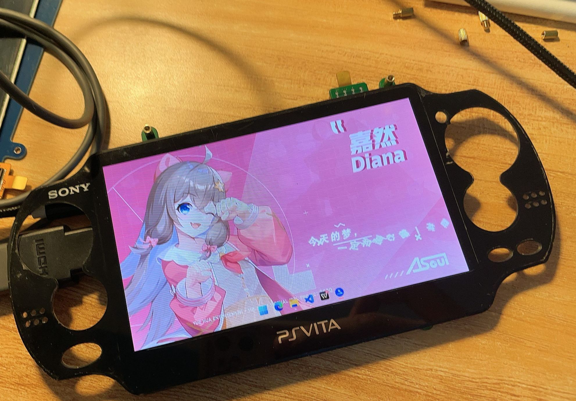

【PocketLCD】HDMI Portable Monitor V1
bilibili small TV
[ Commercial use prohibited]
[Supported devices (tested) : PC, Raspberry Pi and other pi, default horizontal screen ]
[Unsupported device (tested): Switch]
[This version is a development version and is not recommended for boarding. Of course, you can use it for boarding.]
March 6th is Ranran’s birthday. Let us wish the sweetest little strawberry in the world a happy birthday.
V1 version
[ 2021/10/27 ] ->  [Do not use this PCB]
1. Proof the test version of the baseboard adapter board, and reduce the order to within 10x10 (
2. The new PCB has not been uploaded yet
3. The [Bilibili_Board_TestBoard] file is a test version, please do not proof it. [Bilibili_Board_V1_Outline] file is a size file, please do not proof.
[2022/2/15] ->  [Upload the Lichuang eda version, the following functions have not been tested]
1. Connect pins 2 and 3 of Q2 without soldering Q2 to cancel the HDMI HPD function, but it has been written in the firmware.
2. Weld 0R on the NC resistor above FUSE1 to cancel the battery BAT power supply function.
3. You can use the gerber file in the attachment to cast the board directly. The 3D shell is purchased from a friend for free, and the accuracy may not be achieved through some 3D printing services on the Internet.
4. The schematic diagram in Lichuang EDA is incomplete. For details, please refer to the PDF document and BOM list in the attachment.
5. Use the magic method to download the program (), the screen model is [AMS495QA]
