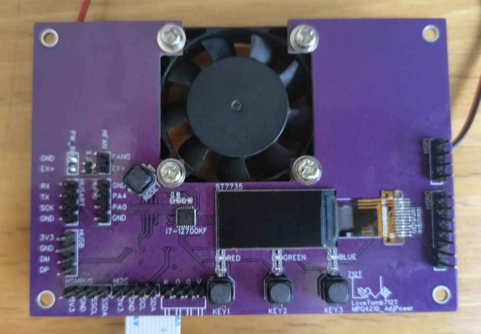

This project is a CNC power supply project and is still under development. This page is the control layer of the project.
The core MCU is: STM32G031G8U6
The pin configuration is as follows
Pre-configured 2-way I2C (SMBus + I2C) via MX
SPI pre-configured via MX (host transfer only)
Preconfigured UART via MX (slave mode)
Three independent LED lights (red, green and blue respectively)
Three independent buttons (normally pull up, press to pull down )
2 GPIOs available for additional configuration
Equipped with an ST7735 main control 0.96-inch IPS screen
Reserve a 4040 DC fan installation slot
Onboard reset button
Almost all pins have independent pinout
Power tiers will be released in a pro version post at a later date
