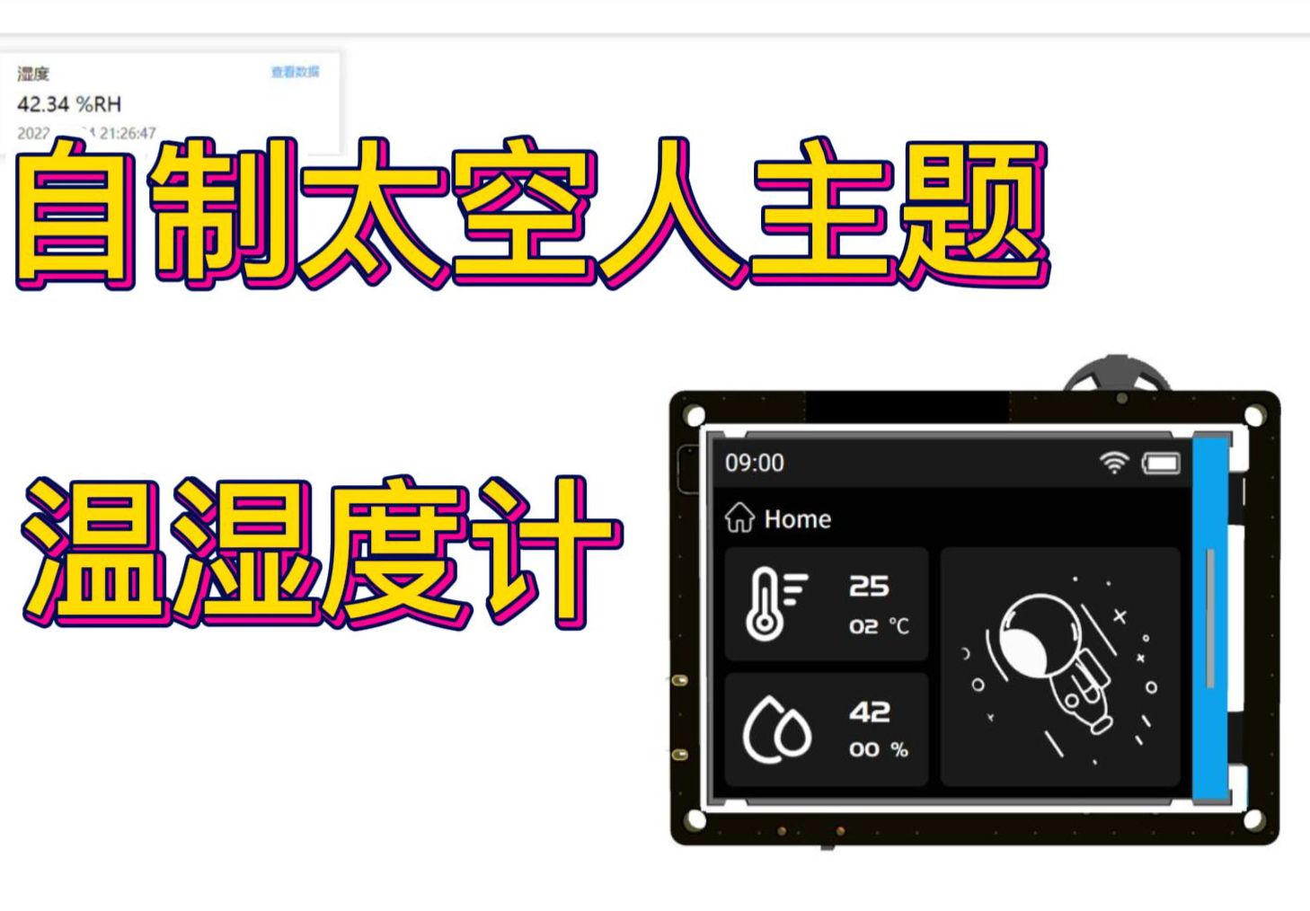

Homemade astronaut-themed thermometer and hygrometer
The project introduction uses ESP32 as the main control, the sensor uses SHT31, the screen is 2.4-inch ili9341, the UI is written using lvgl, and the collected data can be uploaded through a custom protocol in json format based on TCP. The demo video https://www.bilibili.com/video/BV1mr4y1x7e1 code is in my Github repository, including the firmware code of ESP32, and the IoT cloud platform code of a custom protocol implemented by myself https://github.com/ hsinyuwang/PicoIdeal Temperature and humidity numbers in large fonts are the first two decimal places, and in small fonts are the two decimal places. Actual renderings
