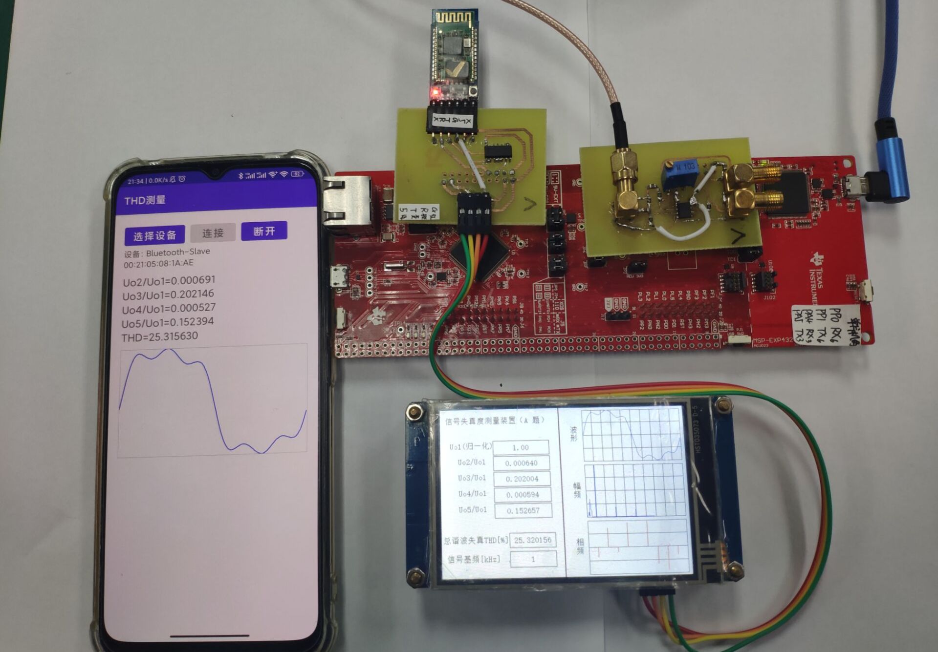

## Physical display! [Full view of the work.jpg]
## The work is assembled
according to the above physical diagram. Just plug the two corroded and welded circuit boards directly into the microcontroller development board. The connection is stable and reliable. When testing, you only need to connect a USB power cable and SMA signal input cable.
### Test process
1. Connect the USB power cable and signal SMA cable, and start the output of the function signal generator.
2. Turn on Bluetooth on your phone and pair it with the Bluetooth-Slave device.
3. Open the PC APP on your mobile phone, select the device, and click "Connect" to start Bluetooth monitoring.
4. Change the signal of the function signal generator and observe the display on the serial port screen and mobile phone.
### Test results
For a low-frequency signal with a fundamental frequency of 1kHz, a peak-to-peak value of 400mV, and a 1-5th harmonic ratio of 1:0:0.20:0:0.15, the theoretical total harmonic distortion is 25%, and the measurement result is 25.37 %, the error is less than 5%.
![1k.jpg] For a signal with a fundamental frequency of 50kHz, a peak-to-peak value of 200mV, and a 1-5 harmonic ratio of 1:0:0:0.15:0.08, the theoretical total harmonic distortion is 17%, and the measured result is 16.32 %, the error is less than 3%.
![50k.jpg]For a signal with a fundamental frequency of 100kHz, a peak-to-peak value of 40mV, and a 1-5th harmonic ratio of 1:0:0:0:0.1, the theoretical total harmonic distortion is 10%, the measurement result is 10.00%, and the error is less than 3% .
![100k.jpg] In summary, the specific numerical indicators of the signal can meet the requirements of the competition question.
