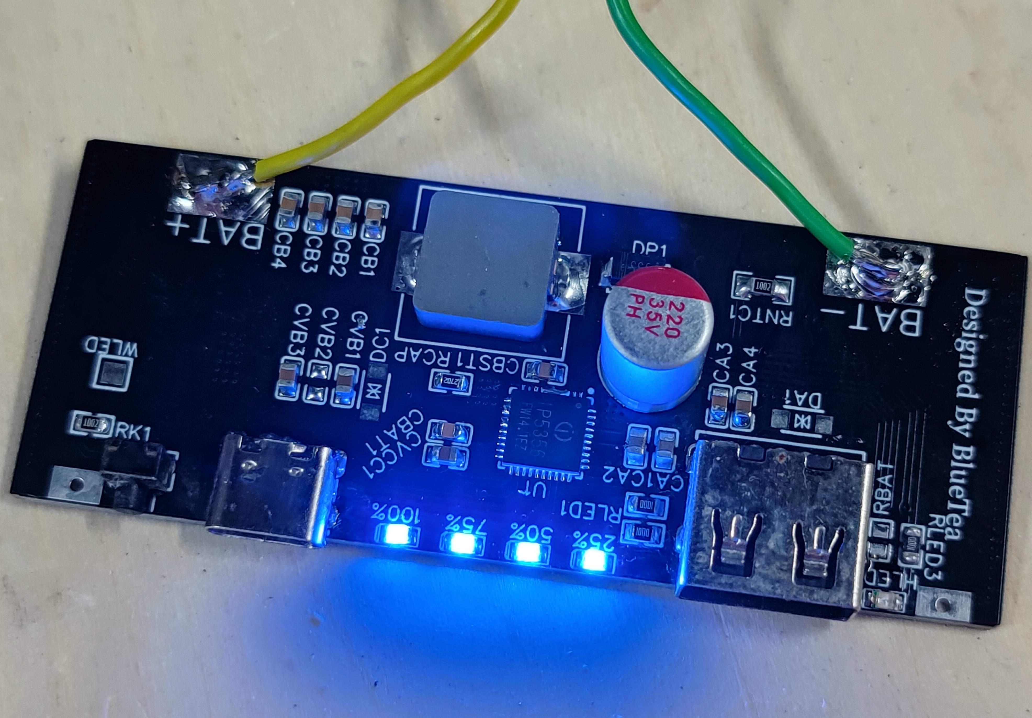

IP5356 bidirectional multi-protocol fast charging power bank
This solution is:
[Upgraded Version] IP5358 Bidirectional Multi-protocol Fast Charging Mobile Power/Power Bank - Jiali Chuang EDA Open Source Hardware Platform (oshwhub.com)
Solution Replacement.
Due to the large number of IP5358 versions, many stores on Taobao use other versions of IP5358 instead of IP5358_BZ to sell
different versions of IP5358. The functions of different versions of IP5358 are different, resulting in high cost and high risk of making IP5358-BZ projects.
Therefore, an alternative solution with IP5356-LED-BZ chip is made.
Note that it is IP5356-LED-BZ, not IP5356-188-BZ.
For other parameters, refer to the original author's document.
4-light power display, with fast charging indicator light
1 TYPE-A port supports 22.5W maximum power output, integrated 22.5W all fast charging protocols
1 TYPE-C port supports 22.5W maximum power input and output, integrated 22.5W all fast charging protocols
(without VOOC protocol)
Multiple protections, high reliability, input overvoltage and undervoltage protection, output overcurrent, overvoltage and short circuit protection, battery overcharge, overdischarge and overcurrent protection
BOM is extremely simple, single inductor realizes charging and discharging functions
If the fast charging protocol recognition is slow, please appropriately reduce the capacitance on USBA-OUT
参考设计图片
