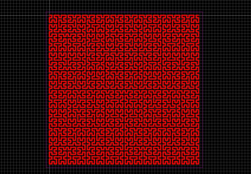

# Effect diagram
![Untitled.png]
Array arrangement + manual adjustment on the left, plug-in generation on the right (semi-finished product, not used yet)
> First order (iteration 1 time)
![image.png]
> Second order
![image.png]
> Fifth order
![image.png]
> Seventh order (plug-in limit 10 orders, my broken computer can run up to 7, and the page will crash if it is higher)
![image.png]

# Use the plug-in
1. Open a PCB file
2. Click the "Hilbert Curve" button in the menu
2. Enter the line width, line spacing, and number of iterations in the pop-up window, and then click Apply
3. The plug-in is executed, and a PCB file is automatically added. A Hilbert curve of the hc$9999 network is generated at the top level
**Note: ** See the figure below for the line width and line spacing. The number of iterations is actually the number of function recursions, that is, the order of the Hilbert curve, which is the total size of the graph in human terms
![image.png]
![image.png]
