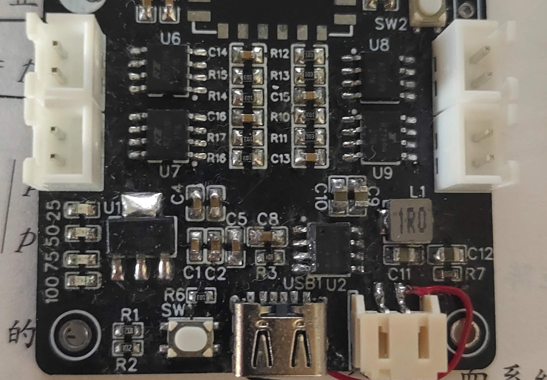

【Solicitation Order】Wireless car with lithium battery charging circuit
Based on esp8266 main control, it can be connected to the network and controlled remotely using other platforms. 4 pieces of rz7899 are motor driver chips, which effectively prevents the upper and lower tubes from being directly connected. The charging circuit uses the ip5306 chip. The reason for choosing this chip is that it has a 5V boost function, which is convenient and easy to use. However, since the circuit does not have battery protection, it is best to use a lithium battery with a protective plate. It is not recommended to use batteries like batteries.
