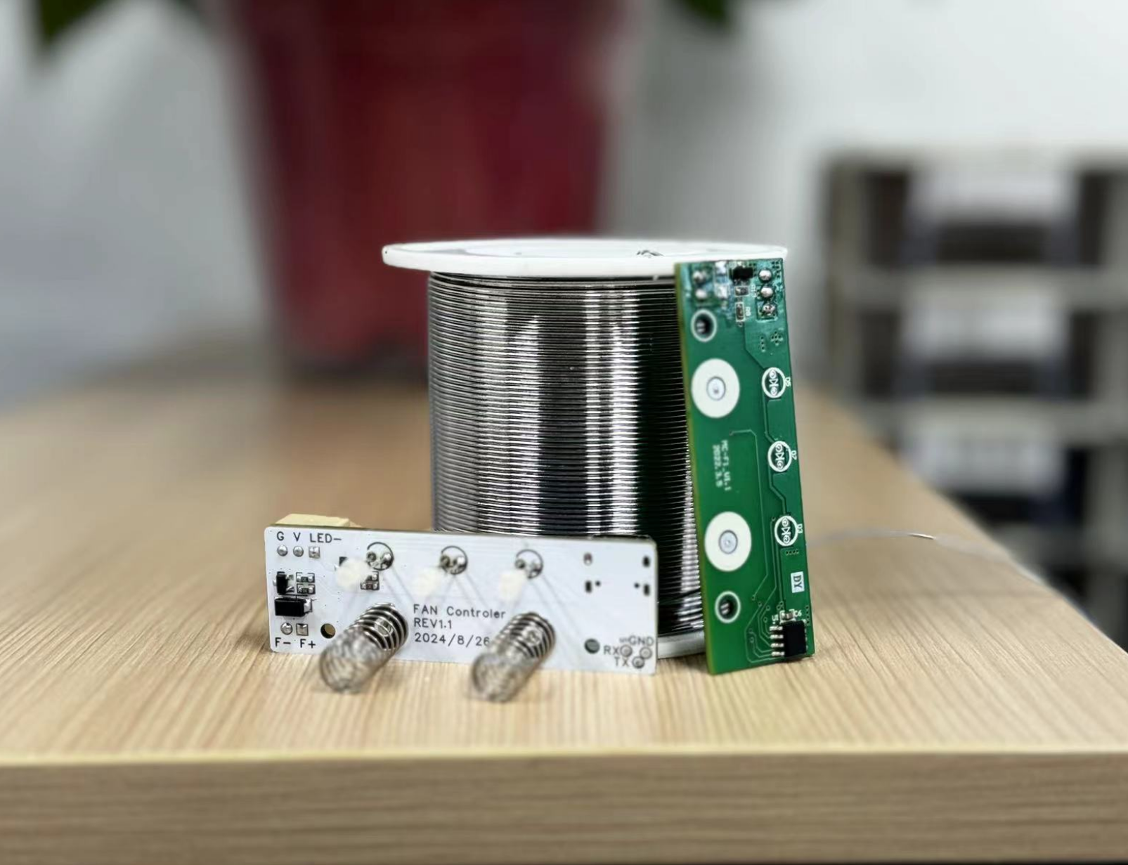

Fan controller used in a certain brand of desktop smoking device.

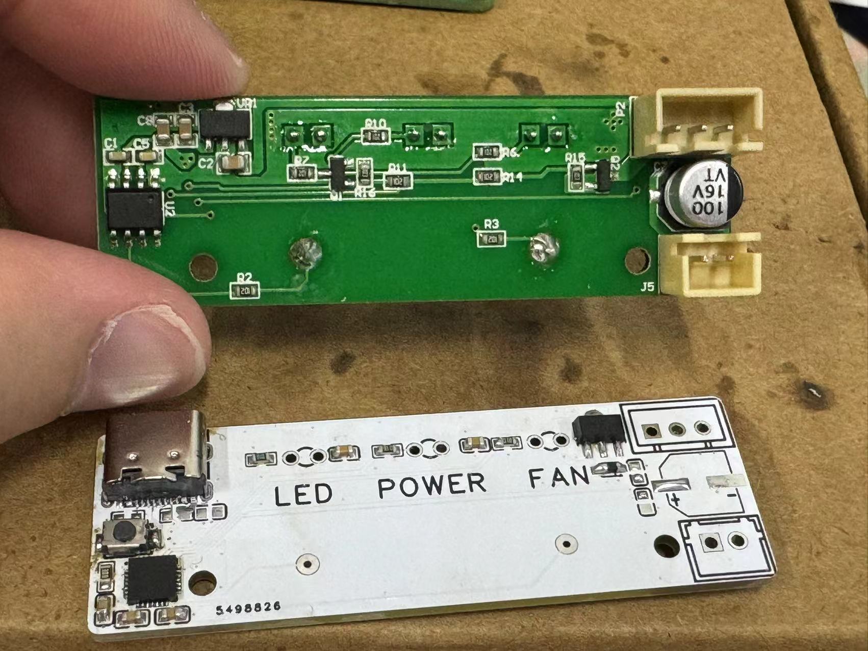

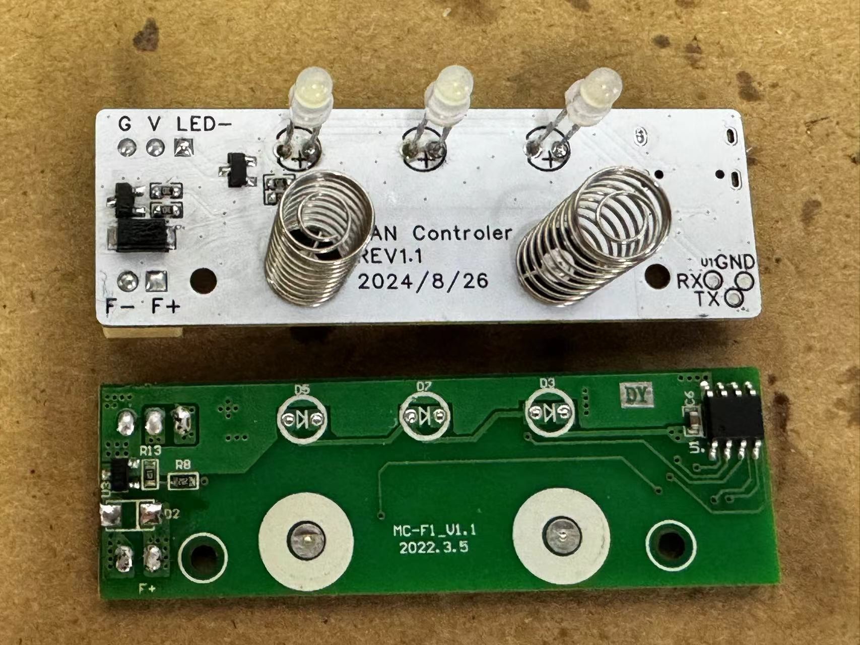

The green section
represents the original controller inside the smoking device, featuring two touch buttons and three LED indicators. The touch buttons are used to turn the LEDs and fan on and off.

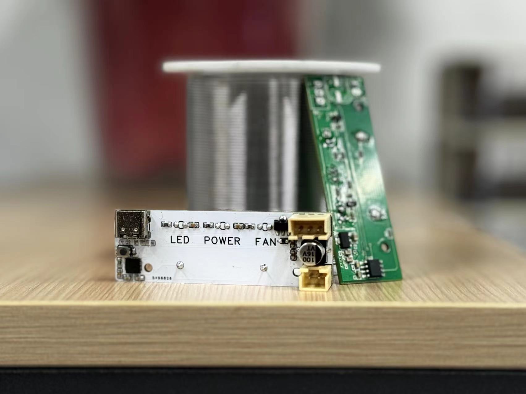

The white section represents the redesigned fan controller, structurally compatible with the original PCB.
Interfaces, LEDs, capacitors, and touch springs were all directly reused from the original PCB.
The power chip has been replaced with a CJA1117-3.3 to power the microcontroller.
The touch functionality is programmable.

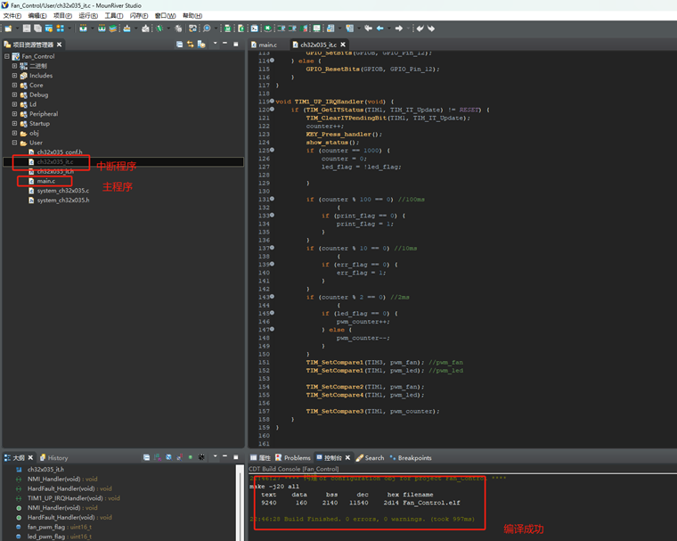

The fan speed program is located in `key_function`. The original code has been modified to:
     `if (key_fan_short_flag == 1) { // If the fan button is pressed, execute the following program //function if(pwm_fan == 0) { pwm_fan = 480; } else { pwm_fan += 40; if(pwm_fan > 640) { pwm_fan = 0; } } //function key_fan_short_flag = 0; // Release the button }`
The fan is too noisy at high duty cycles, so it's limited to between 48-64%, where the noise level is acceptable.

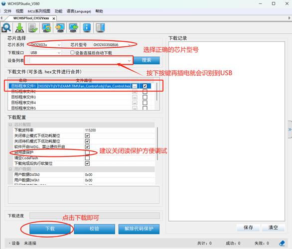

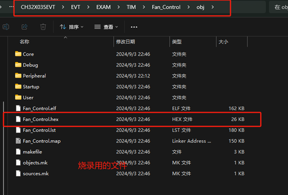

Software:
Download
and install WCHISP_TOOL.
Press the button and then insert the USB; the software will recognize the device.
Finally, click download and wait for the programming to complete.

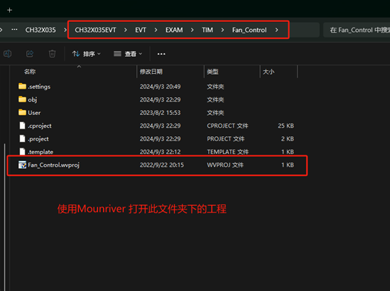

If reprogramming is required, please first download the WCH compilation environment: Mountriver. This is a RISC-V microcontroller compilation and development environment from Qinheng Micro.
Download the CH32X035 series SDK package.
I have already placed the written program in the folder; you can directly open the project.
The project folder is:
xxxxxCH32X035EVTEVTEXAMTIMFan_Control . Two C files are used for

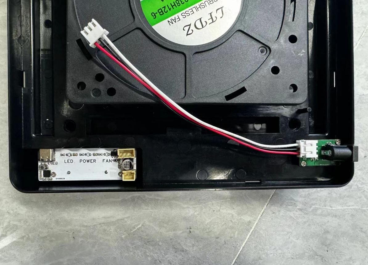

global compilation : one is the interrupt program, containing a 1ms timer interrupt for button timing; the other is the main program, containing system initialization, PWM initialization, etc. A picture of the completed soldered device:
