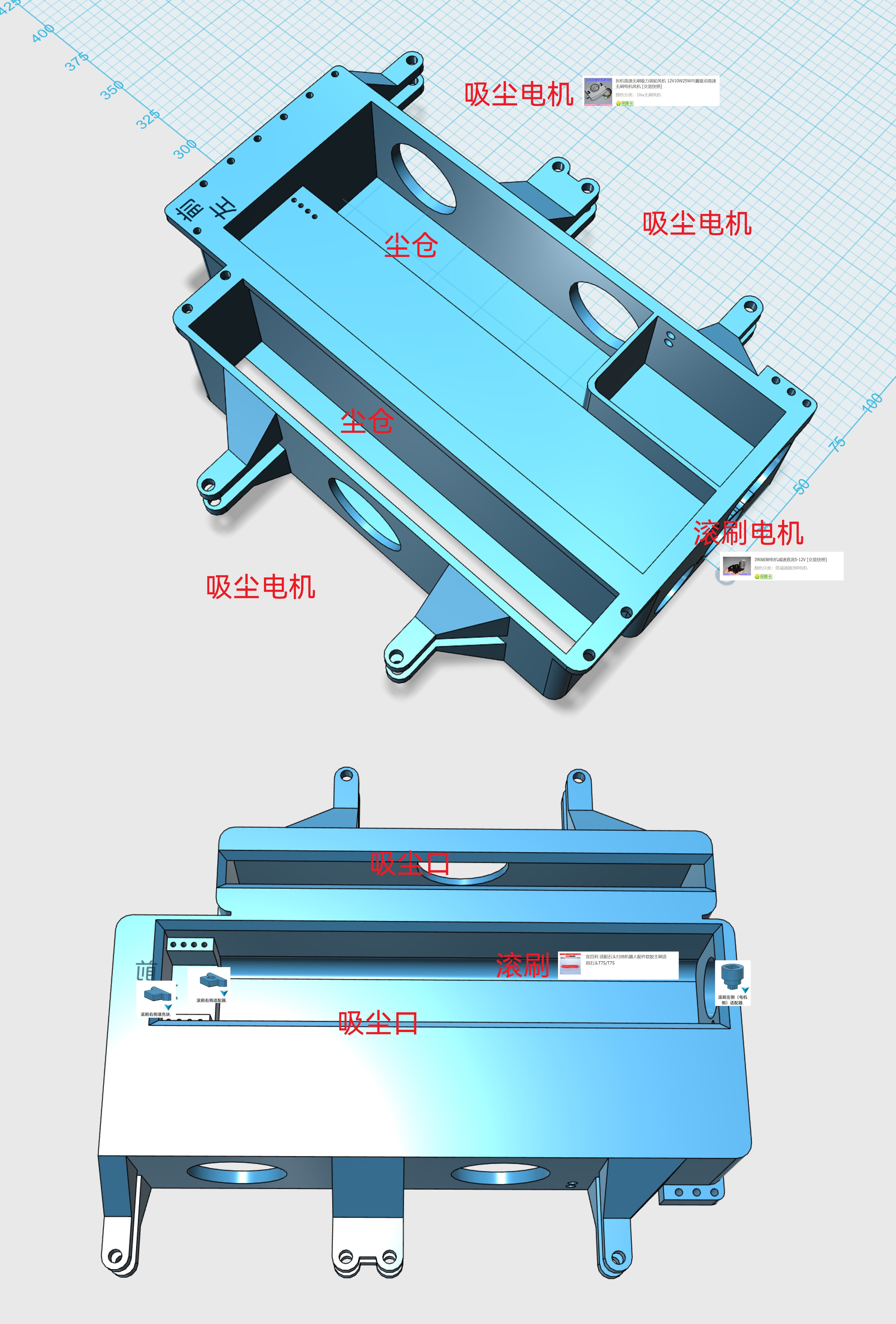

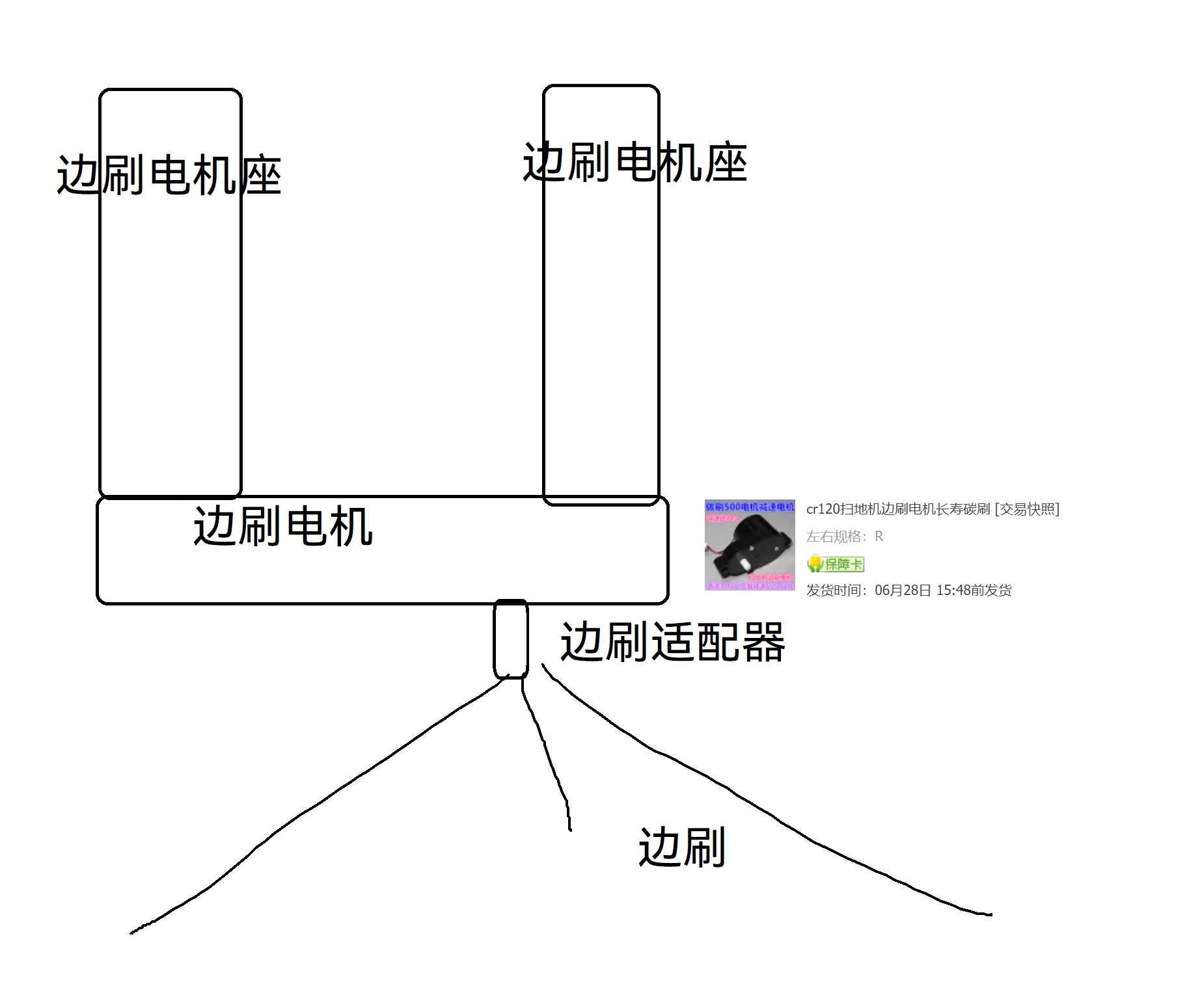

. At the front is the side brush assembly, including two 500W motors and two side brushes, used to move debris to the front of the robot. Next is the pre-vacuum assembly, including a vacuum motor, a dustbin, and a filter. Then comes the roller brush sweeping assembly, including a roller brush and its motor, two vacuum motors, a dustbin, and a filter. Finally, there is the mopping assembly, which is essentially a mini mop with a lead screw motor that pulls the mop loops to squeeze out the water. Normally, the mop is at the back of the robot. When mop washing is needed, the motor lifts the mop and sends it to the water tank at the top of the robot. (An ultrasonic sensor at the rear prevents the mop from damaging debris during lifting.) The entire machine is driven by a four-wheel drive system composed of four 550W motors with differential steering.

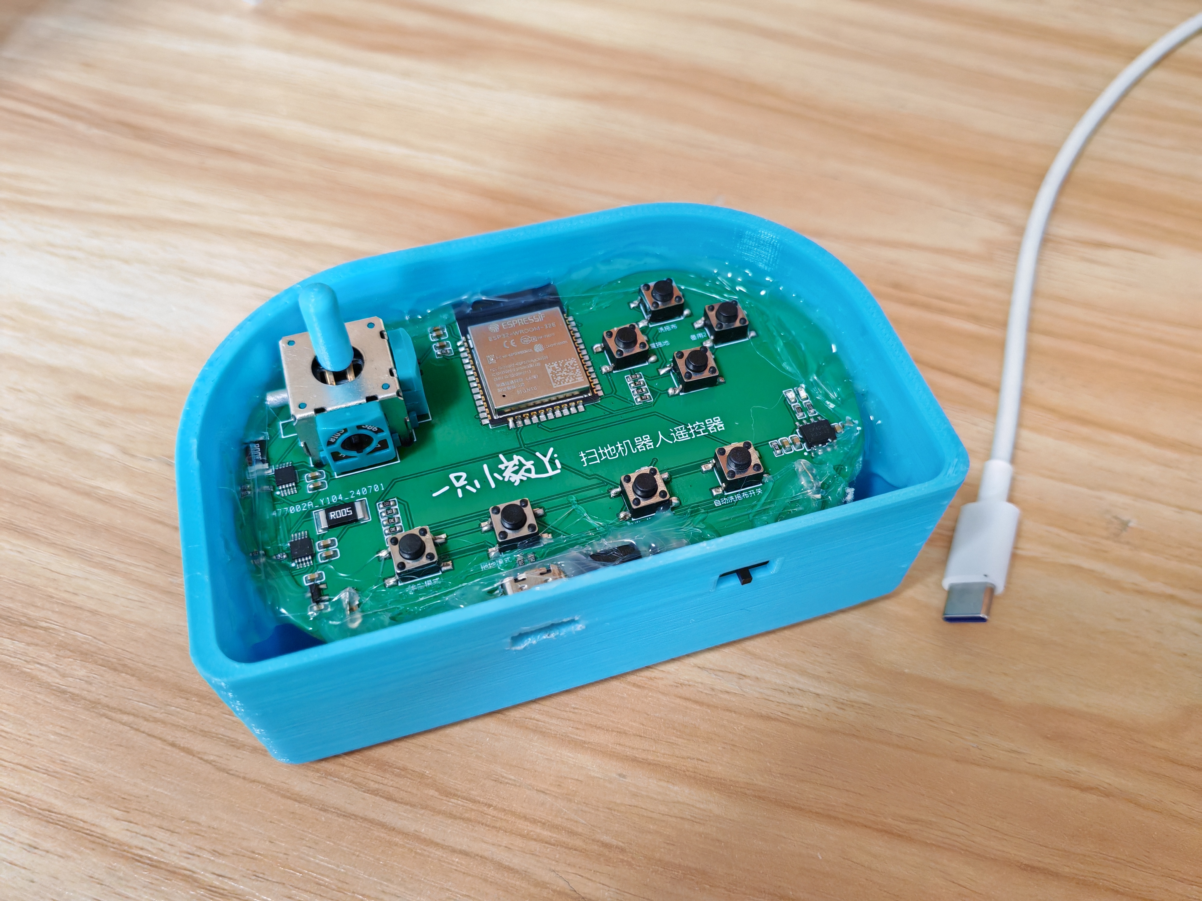

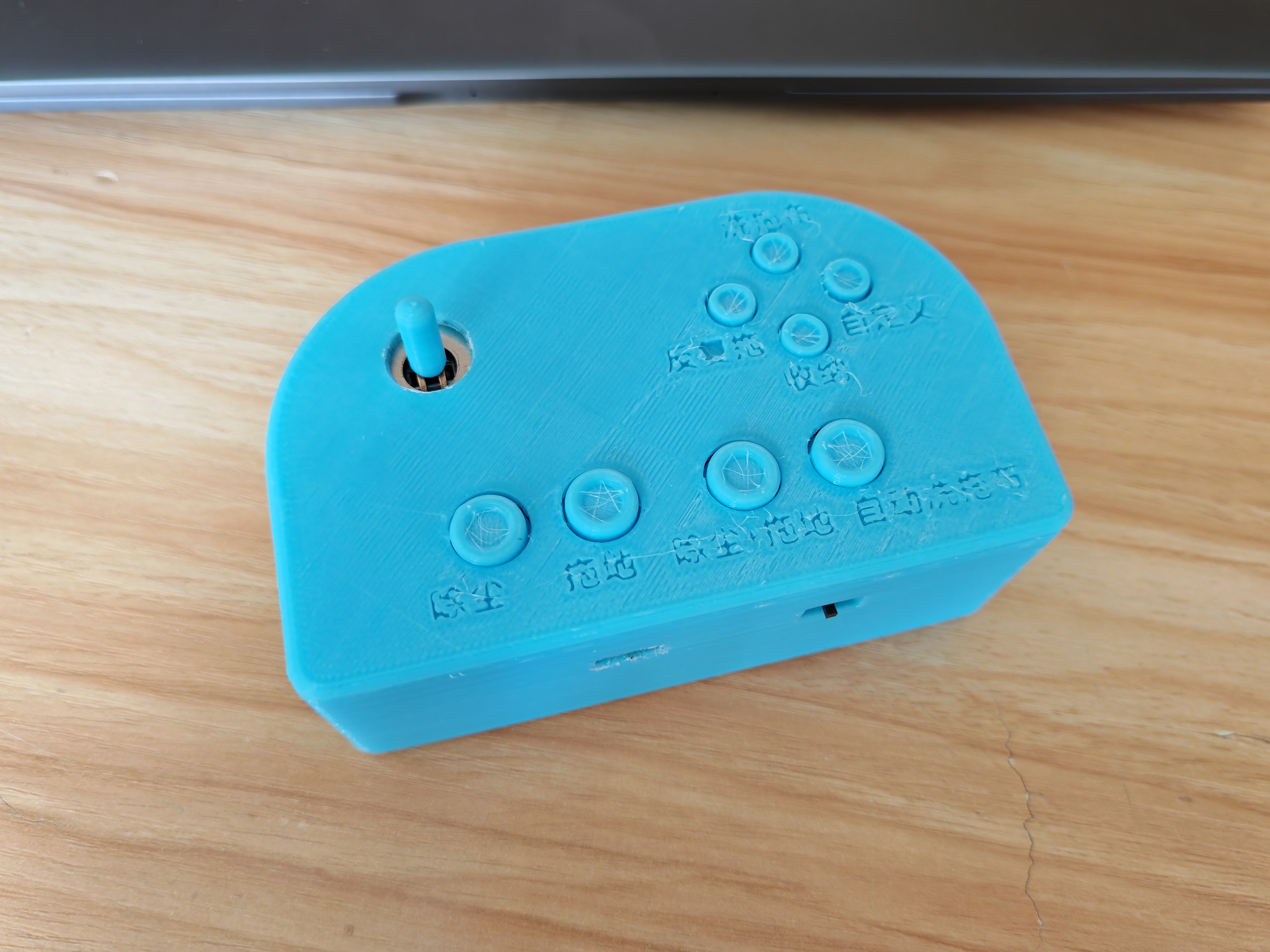

The remote control is shaped like a game controller, with joysticks and buttons to achieve various functions (forward/backward/left/right, dusting/mopping/dusting + mopping/storage mode, automatic mop washing switch, manual control of mop washing, repeated mopping)
The circuitry of the remote control is relatively simple. This project uses the classic Bluetooth (Bluetooth serial port) ESP32 to achieve remote control functionality.
The ESP32 is used as the main controller, with a Type-C + CH340 for program upload, a TP4056 for charging and an 18650 battery for power. An XC6206P332MR (which can be replaced by an SC662K) provides step-down power to the ESP32. An INA226 reads the joystick voltage and is used for interaction with the joystick, buttons, and LEDs.

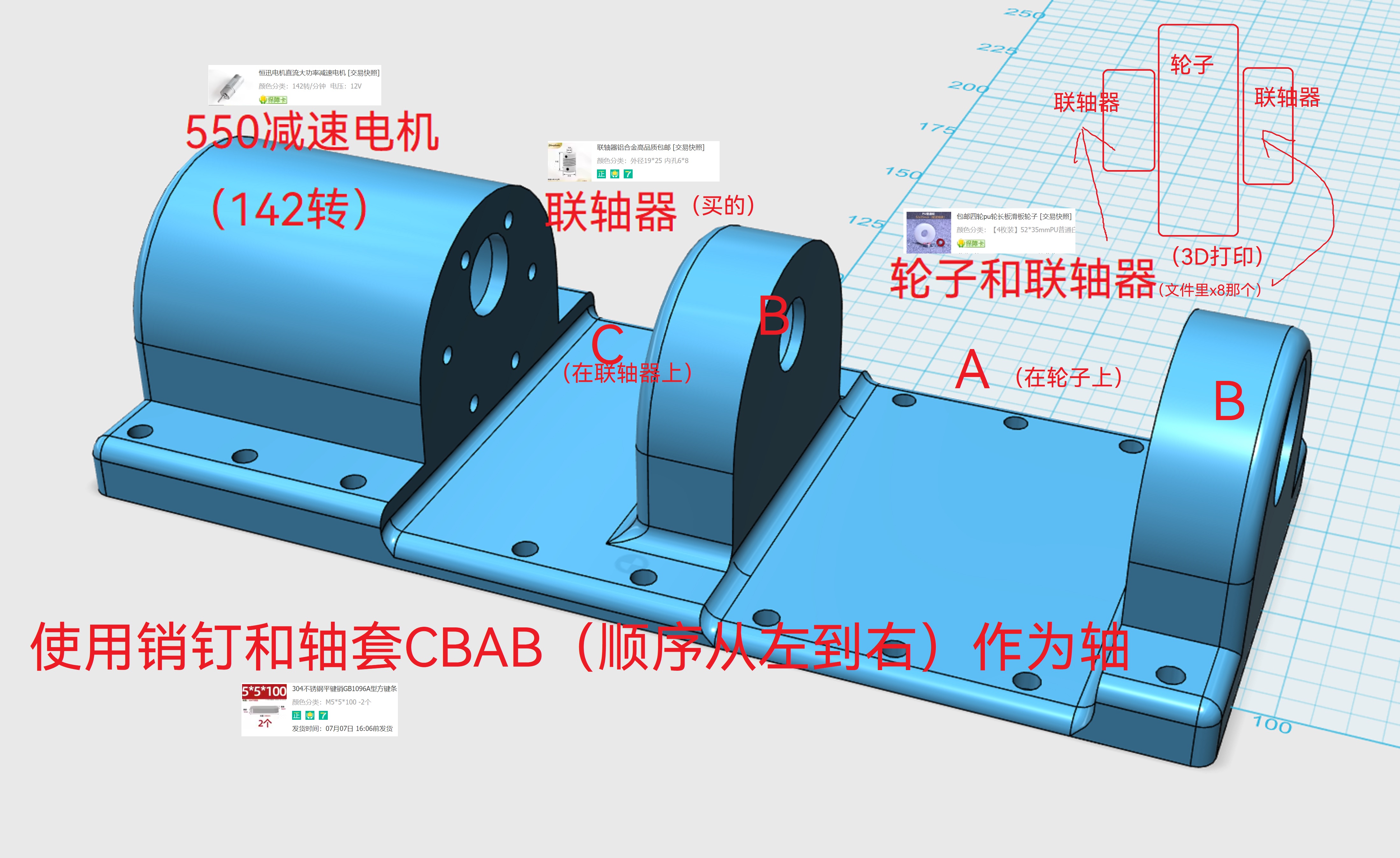

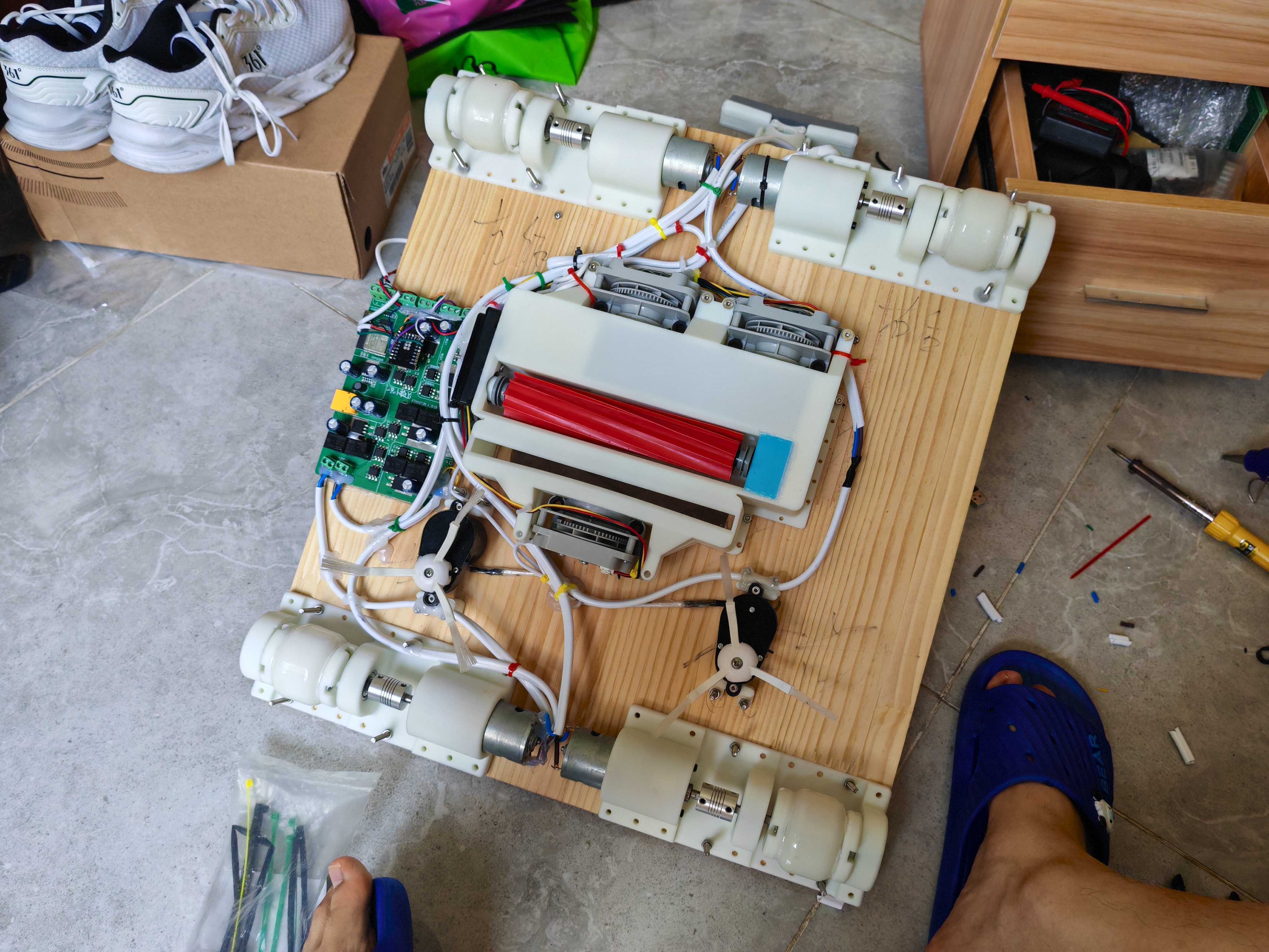

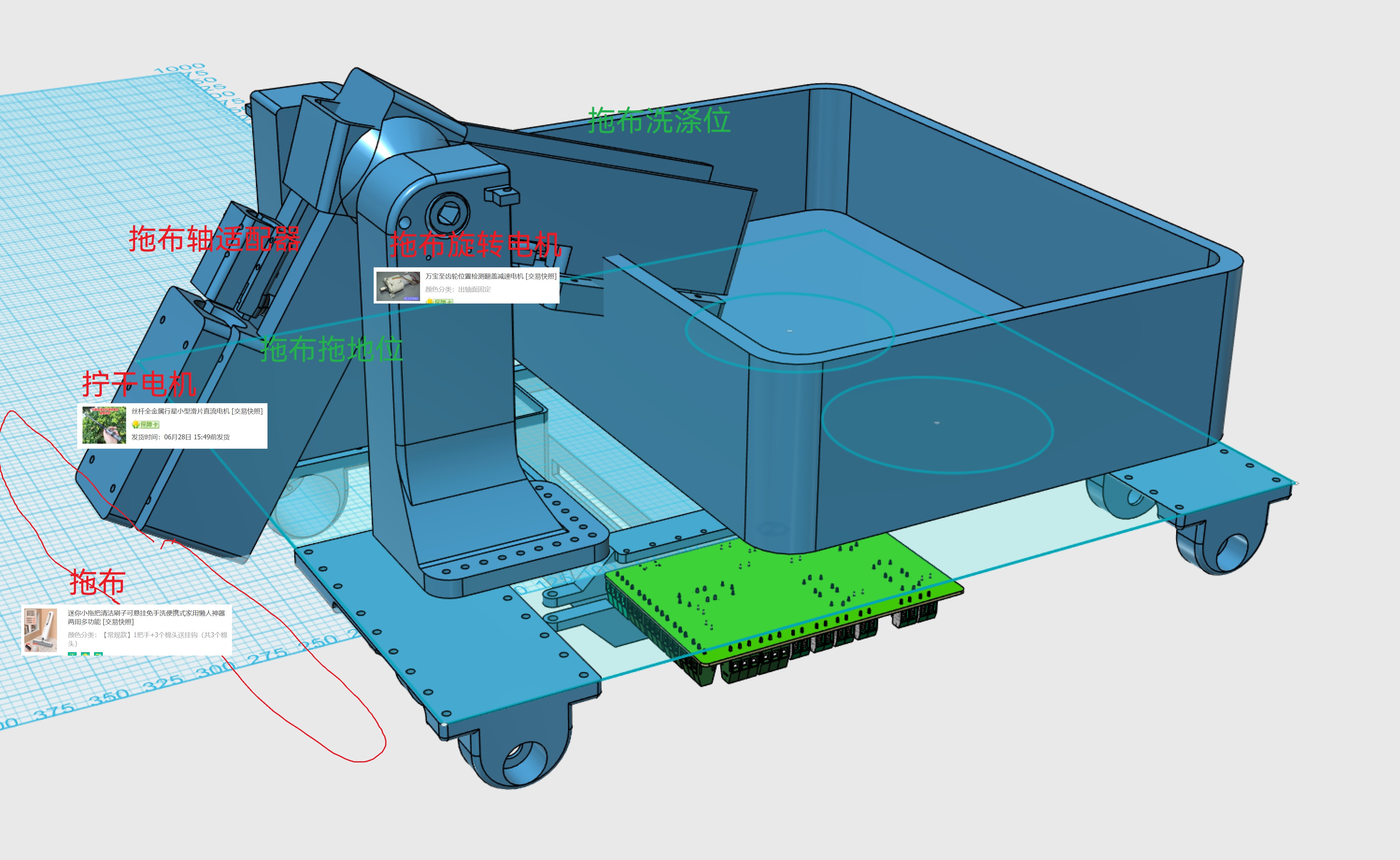

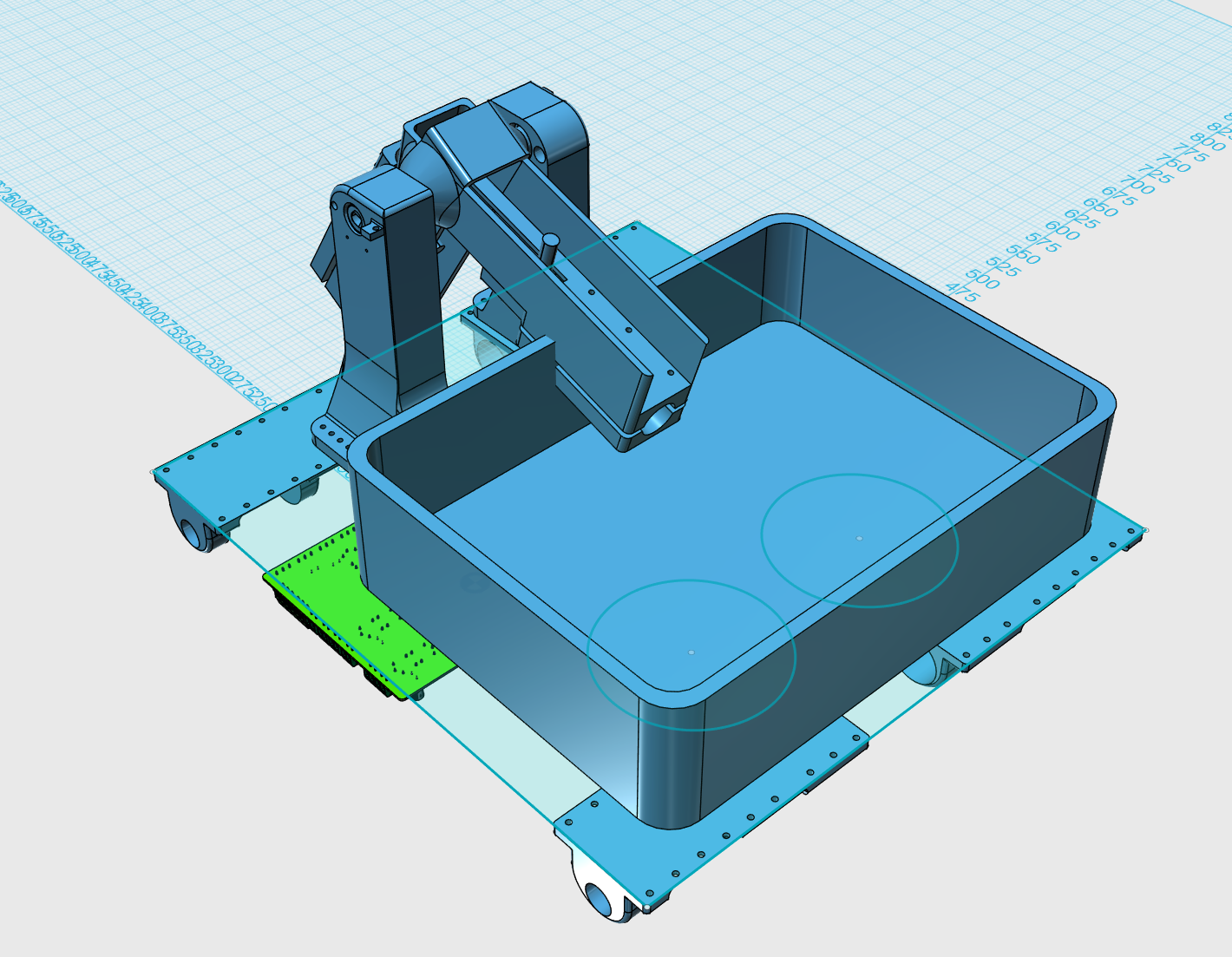

The assembly diagram is as follows:
Drive unit (4 units in total, forming a 4-drive system)
; Side brush unit (corresponding to the two circles in the assembly diagram)
; Vacuuming module;
Mopping
water tank (nothing special, just a water tank mounted on the chassis with a water pump for washing the mop);
