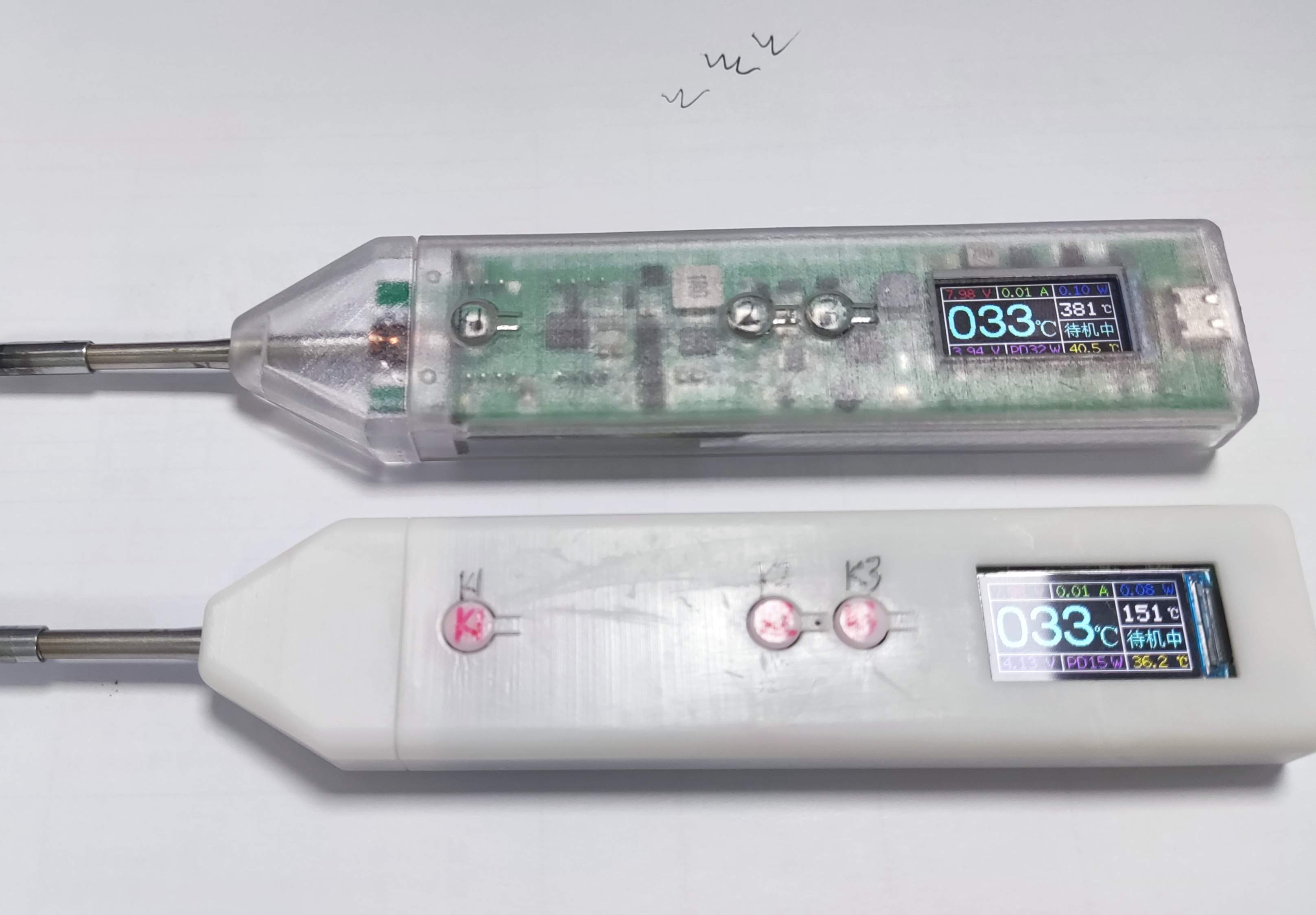

ESP32-C245 Wireless Soldering Iron
Project Description:
The ESP32-C245 wireless soldering iron is a portable wireless soldering iron powered by a built-in lithium battery. It uses a C245 heating element and supports direct power supply via TYPE-C fast charging and lithium battery charging. It supports real-time measurement and display
of parameters such as soldering iron temperature, current, voltage, and power. Features:
1. Supports temperature range measurement and calibration from -100℃ to 450℃ .
2. Supports dual power supply via lithium battery and TYPE-C, automatically switching between power sources and charging the lithium battery.
3. TYPE-C input power: 5~20V/5A; PD fast charging trigger power default: 65W.
4. TYPE-C interface supports program download and fast charging trigger power supply (distinguished by reversible insertion).
5. Three commonly used buttons for mode switching and parameter settings; one reset button for program burning.
6. ST7735 0.96-inch 160*80 pixel color LCD screen displays various parameters
. 7. Supports multiple function settings and data retention even after power loss. 8. Low-power sleep mode (20uA) and button wake-up
. Maximum heating power is 20W when powered by lithium battery; heating speed is slightly slow; soldering above 350℃ is difficult; battery life is also relatively tight.
9. Maximum usable heating power is 99W when powered by TYPE-C; adjustable
current limit
 . This project is licensed under the "CC BY-SA 4.0" license. Please do not use it for commercial purposes. When reprinting, please include the original source link and this statement.

Design Principles
: 1. The project uses an ESP32-S3FN8 as the main controller, which uses an ADC to collect the temperature and current signals from the soldering iron's thermocouple to control the PWM-driven PMOS switch, thereby controlling the soldering iron's temperature and heating power.
2. The HUSB238-002D chip is used for fast charging deception; however, this chip's support for fast charging protocols is not very good, and it cannot deceive some chargers into outputting the correct power.
3. The TPS61088RHLR is used to boost the battery voltage from approximately 3.7V to 8V to power the soldering iron and increase its heating power.
4. The XB7608AJ provides overvoltage, undervoltage, overcurrent, and short-circuit protection for the lithium battery. The SLM6305 is used for lithium battery charging
. 5. The LIS3DHTR is used for motion detection to determine whether the battery has entered deep sleep mode
. 6. The GS8552 amplifier is used to amplify the temperature and current signals from the soldering iron's thermocouple.
7. Due to the influence of the low-end current sampling circuit, the current during operation will affect the thermocouple temperature signal of the soldering iron. Therefore, intermittent sampling of the thermocouple temperature signal is adopted, and the temperature is obtained by looking up a table .

: 1. The EESP32-C245 wireless soldering iron consists of: main control PCBA + adapter PCBA + lithium battery + casing + C245 soldering iron core.
2. The main control PCB and adapter PCB use ordinary RF-4 material, 2-layer board, 0.8mm thick. 1. The two boards are soldered together using pin headers. Note the orientation; do not solder them backwards.
2. The adapter board PCBA needs to be soldered with three types of beryllium bronze crown springs: O4.5-8mm / K10#-8 / K16#-6, one of each. See the picture for details. Note the ventilation; beryllium bronze soldering is toxic.
3. The casing uses SOLIDWORKS 2021 design. There are two similar designs: a large casing and a small casing. They are interchangeable, only slightly different in appearance. Choose one.
4. The recommended lithium battery is the Fuli 782768SV model aircraft battery cell, with a capacity of 1750mAh and dimensions of 68mm (L) x 27mm (W) x 7.2mm (H). See the picture for details. Other models can also be used as long as the parameters are suitable
. 5. The TFT uses the ST7735 0.96-inch 160*80 pixel color LCD screen with a solderable 13-pin interface. Note that only the ST7735 can be used; the ST7735S may not display
. 6. The C245 soldering iron tip uses the Sugong C245-SK small knife tip soldering iron tip.
