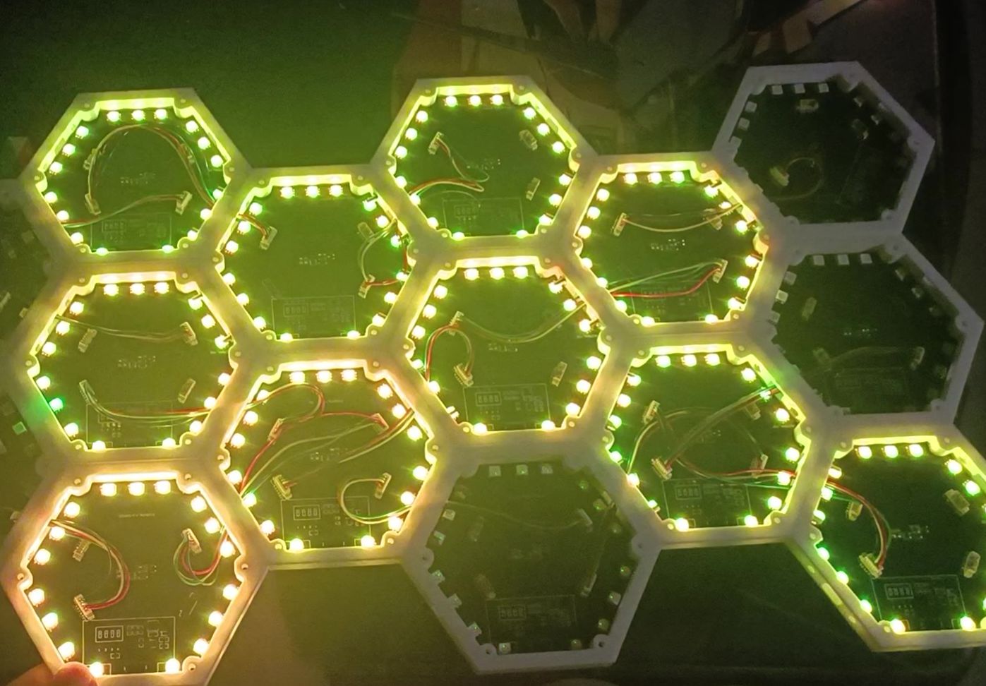

Touch-activated illuminated table (upgraded version)
Video Production: [(Open Source) Touch-Sensitive Illuminated Table Upgrade, River Table - Bilibili] https://b23.tv/kPmtszI

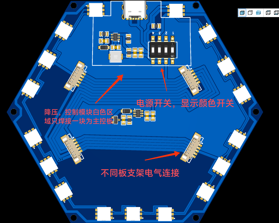

1. Only the first motherboard in the white area needs soldering; the others don't
. 2. Switch 1 is the power switch, switch 2 is the blue light switch, switch 3 is the red light switch, and switch 4 is the green light switch. The three colors can be combined.
3. The PCB needs to be tapped manually to M3 (also needed for 3D printed parts).
4. There are two 3D model files: one for the main control board and one for other luminous modules.

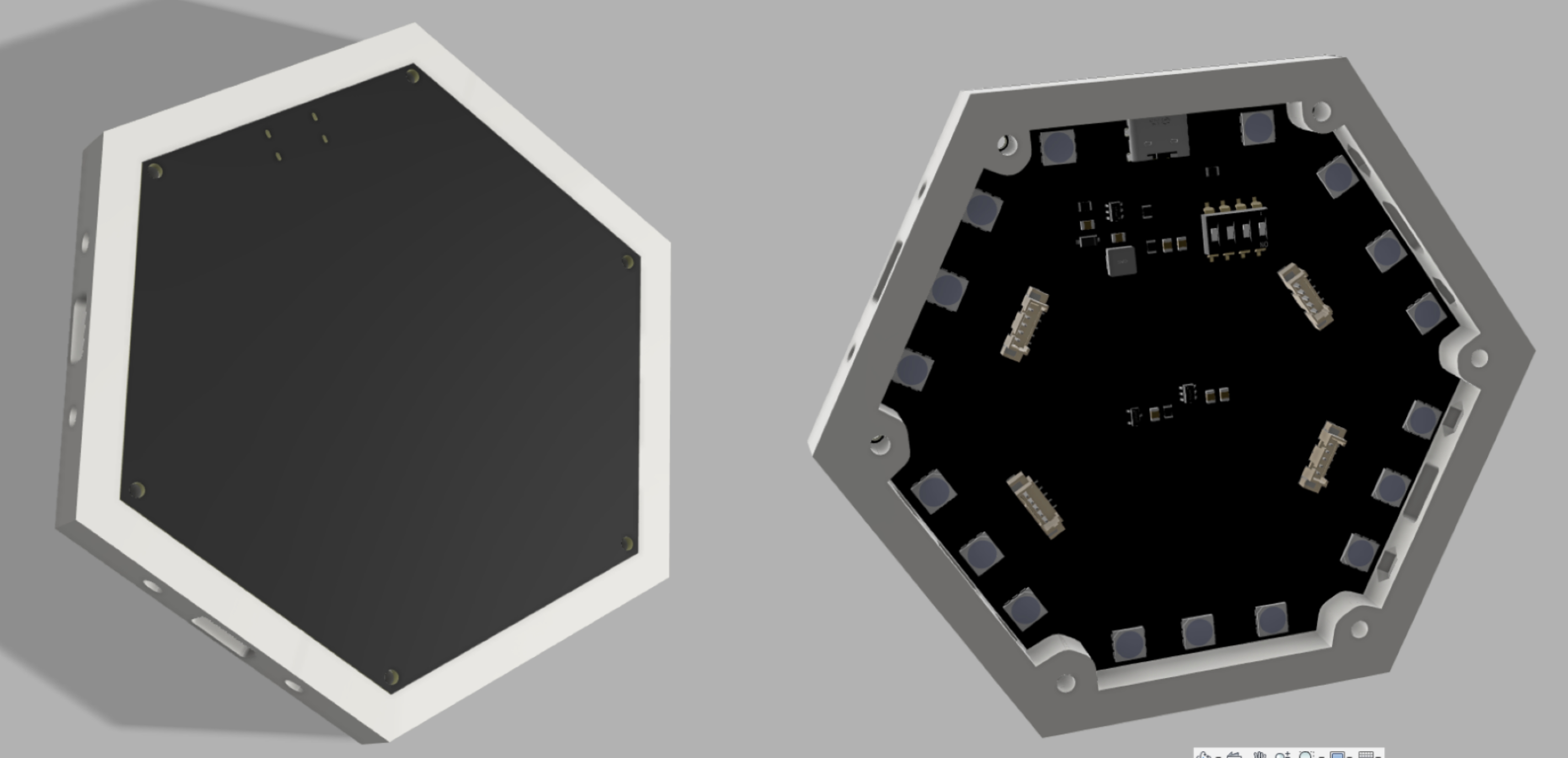

5. The PCB and model are fixed with M3X5 headless hex screws. Modules are fixed together with M3X10 studs and hex nuts.
6. Electrical connections between different modules are made with 1.25mm pitch, 15cm long 5-pin connectors.
7. The PCB and model must be oriented in the same direction, the charging port and the model notch must be aligned, and all module charging ports should face the same direction when fixing.
8. The attachments include some purchase links and 3D printing files (25% infill for 3D printing).
9. The delayed shutdown and light adjustment functions have been completed, but there is still one problem to be solved: the output power of the step-down module is only 2W, which means that the more lights are touched,
the lower the brightness of the lights (there is no solution yet), and increasing the voltage or current will not increase the power.
