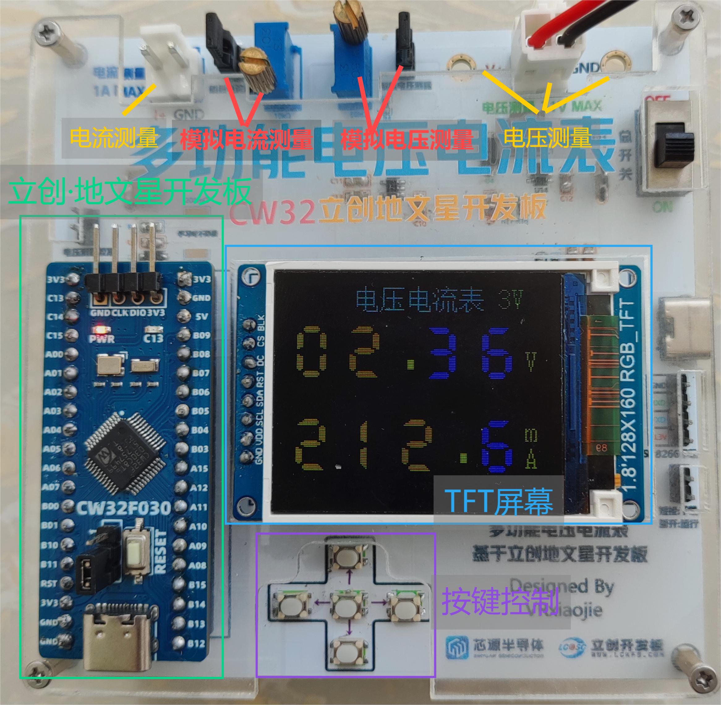

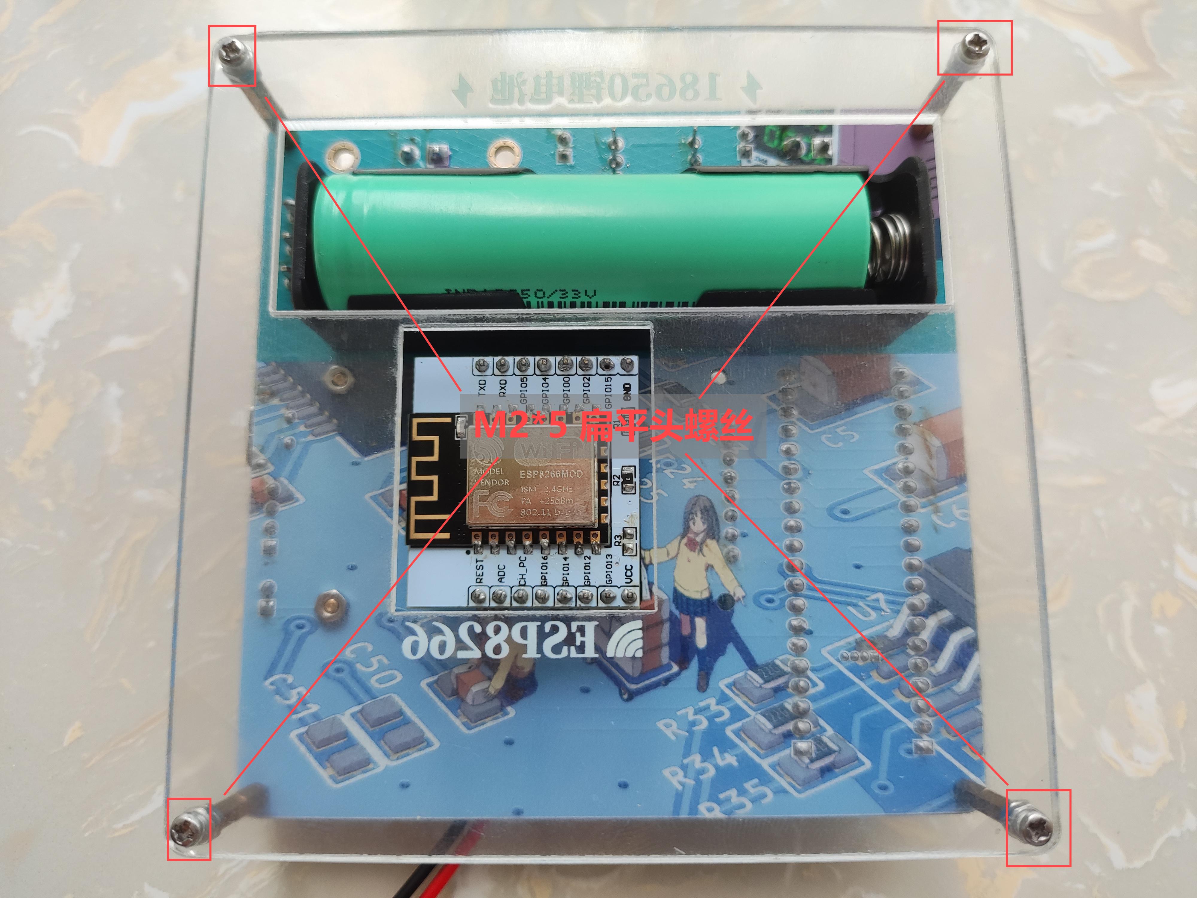

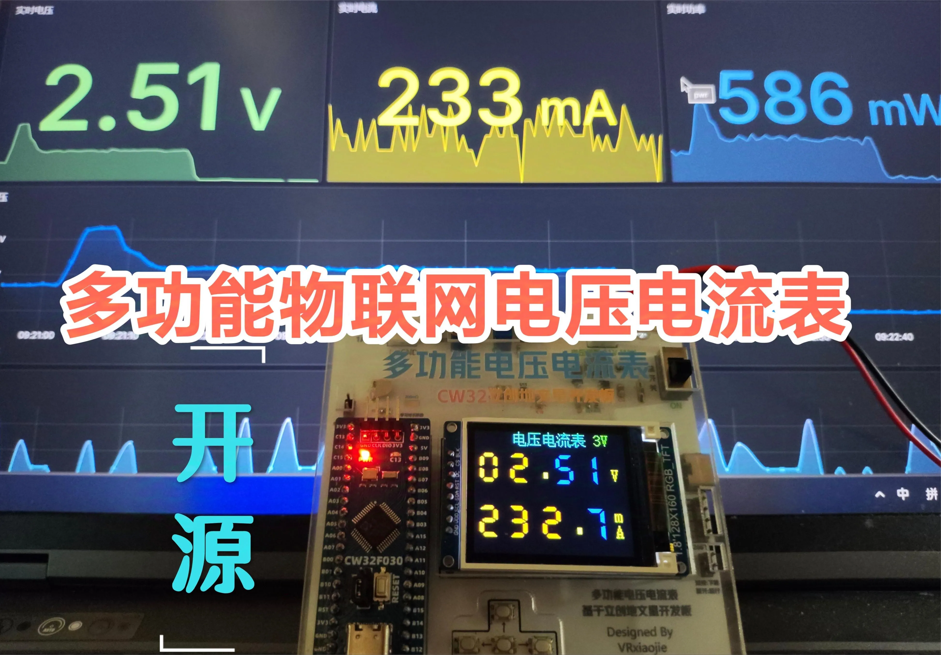

  First, here are some pictures of the actual product. You can further improve and optimize the PCB layout and software design based on this project.
Figure 1 Front of the actual product
Figure 2 Back of the actual product

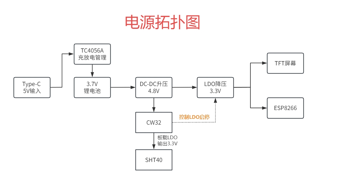

2.1 Power Supply Circuit
  The power supply topology diagram is shown in Figure 3.
Figure 3 Power Supply Topology Diagram

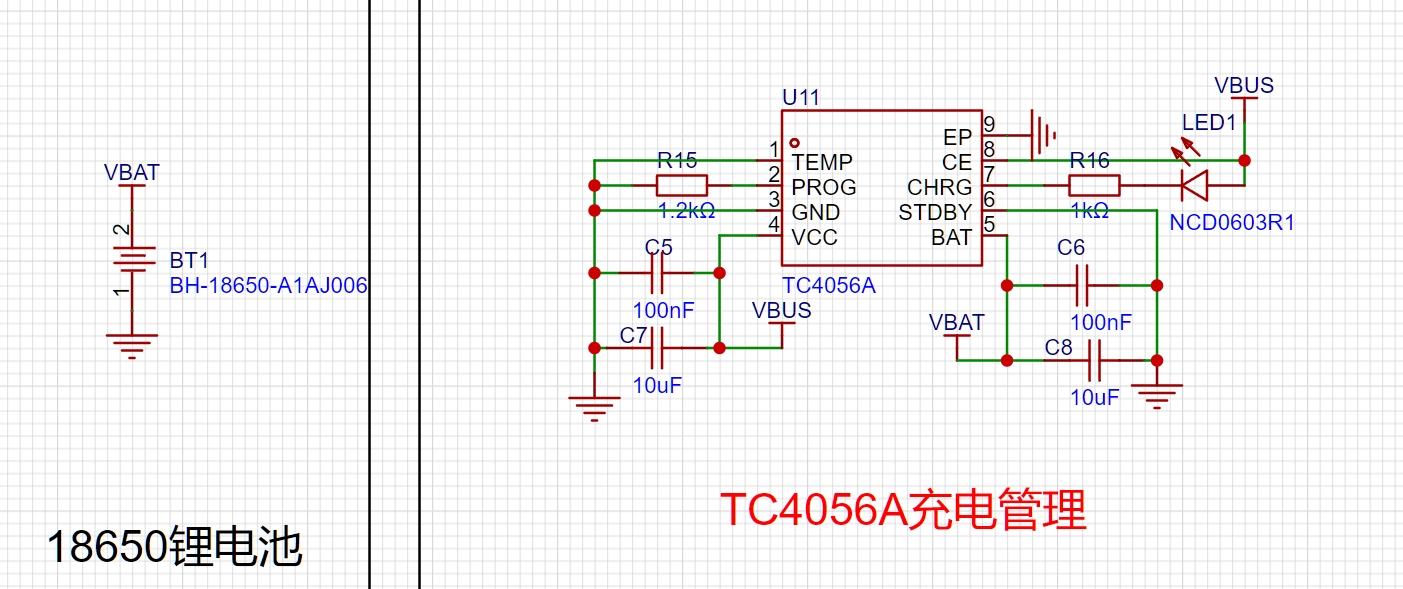

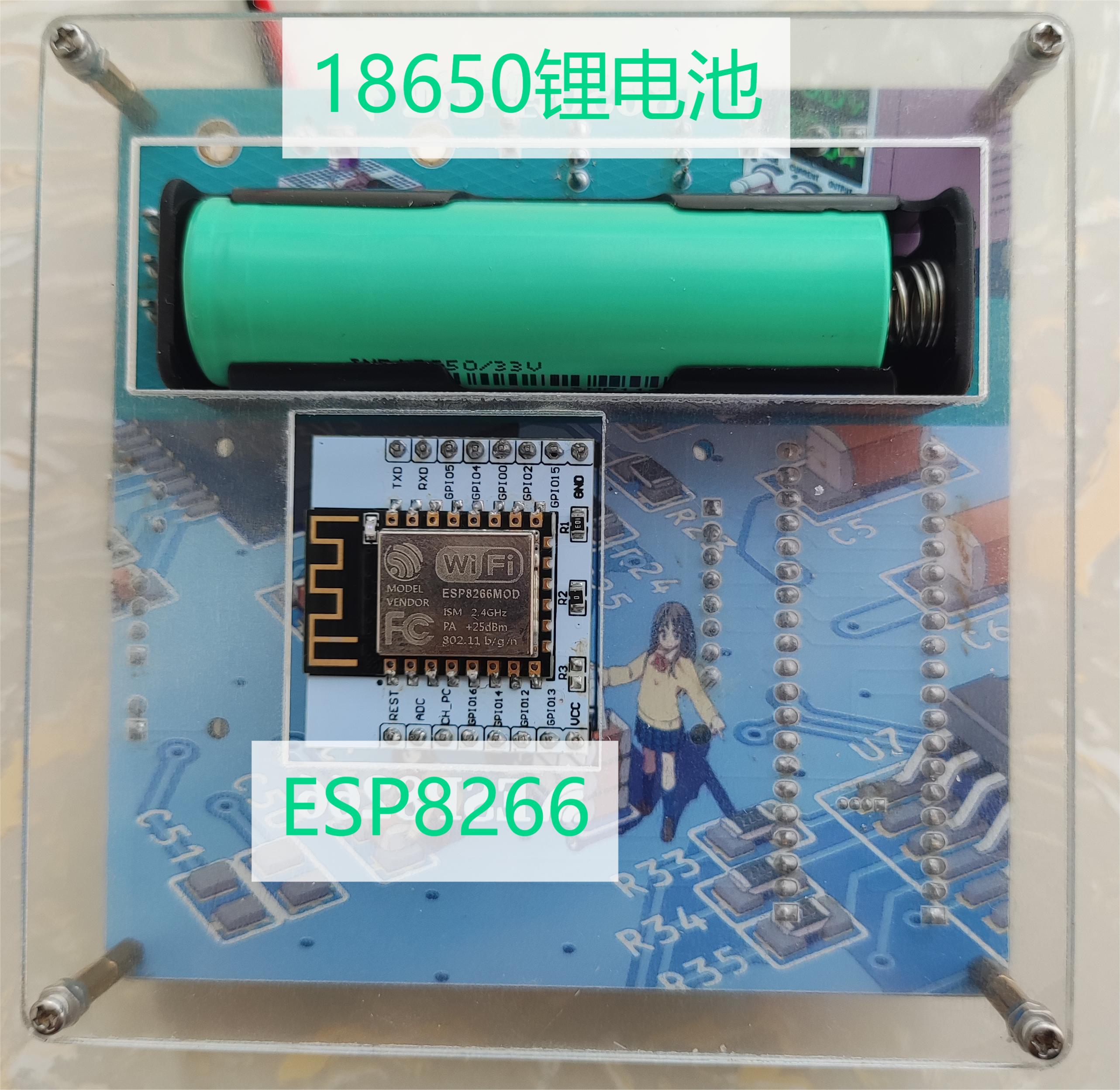

  The power supply section uses one 18650 lithium battery, and the charging management chip is TC4056A, which can support a maximum charging current of 1A. The circuit design is shown in Figure 4.
Figure 4 The charging management circuit

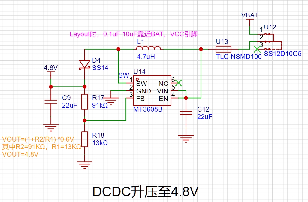

  is shown in Figure 5. The DC-DC boost circuit uses the MT3608B, which has an efficiency of approximately 92% when the current is less than 100mA. The output voltage uses a resistor divider feedback method: VOUT = (1 + R2/R1) * VREF. The datasheet states VREF = 0.6V; I chose R2 = 91KΩ and R1 = 13KΩ, resulting in VOUT = 4.8V. Larger resistors are preferable here, as they draw less current and consume less power. The 4.7uH inductor is based on the chip datasheet; it's recommended to choose an inductor with a lower equivalent DC resistance to improve efficiency. A Schottky diode is essential; considering the low overall current, an SS14 is sufficient.
Figure 5
DC-DC Boost Circuit

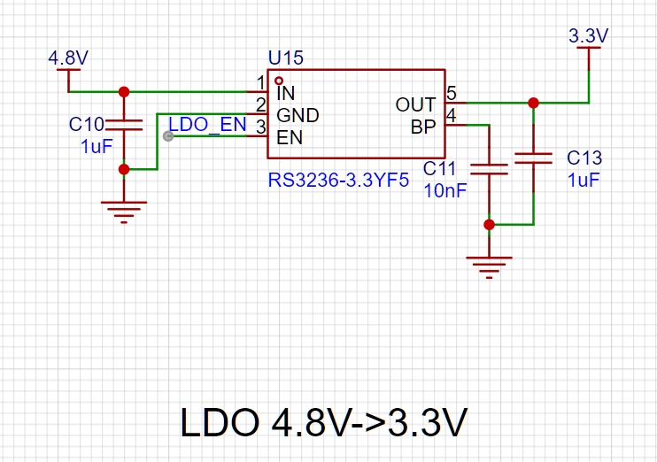

  The LDO used to step down to 3.3V is the RS3236-3.3. It was chosen because it has an EN pin, allowing the CW32's GPIO to control the LDO's start and stop. Furthermore, it has extremely low standby current (0.01uA), further reducing the overall system's quiescent current. The LDO circuit design is shown in Figure 6.
Figure 6 LDO Step-Down Circuit

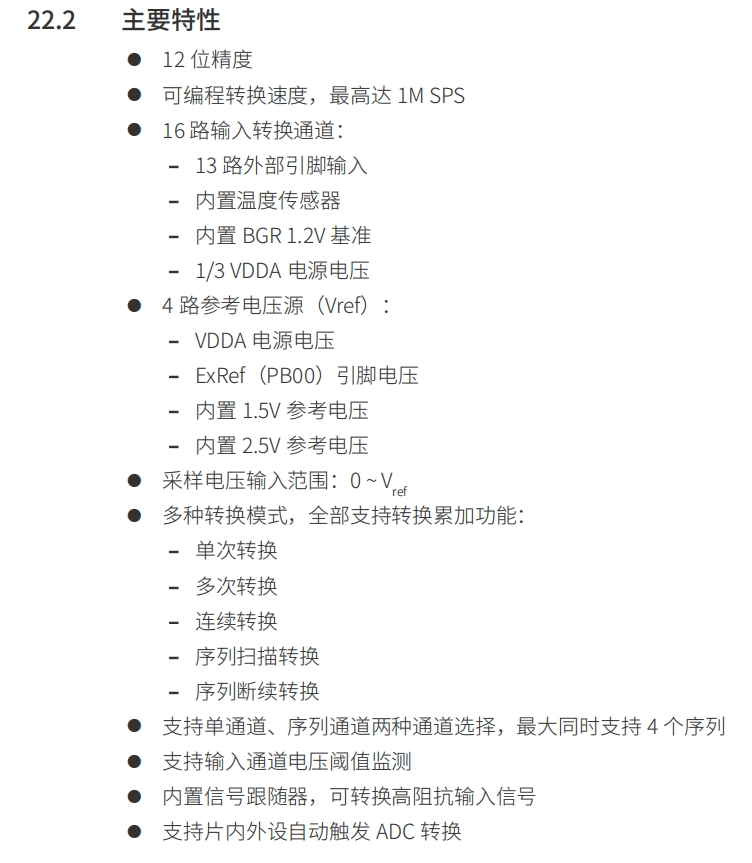

2.2 MCU Selection – Why Choose CW32
  for Voltage and Current Measurement? The core of this project is voltage data acquisition, and since voltage values ​​are analog, an ADC (Analog-to-Digital Converter) is needed to convert them into digital values ​​that the program can read. The LCSC Diwenxing development board uses the CW32F030C8T6, a high-speed ADC with 12-bit precision and multiple Vref reference voltages: 1.5V, 2.5V, VDD, and ExRef (PB00) pin voltages. The STM32, however, only has one VDD reference voltage. Considering accuracy, having more selectable Vrefs is naturally better. The CW32 user manual's introduction to the ADC is shown in Figure 7.
Figure 7 CW32 Datasheet Introduction to ADC
  Furthermore, considering that this project uses a TFT screen, ESP8266, button control, and ADC acquisition, requiring a large number of I/O ports, the Diwenxing development board provides 32 I/O pins, which is sufficient.

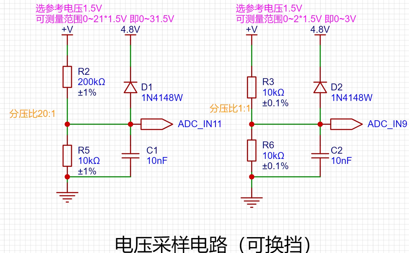

2.3.1 Voltage Sampling Circuit The voltage
  sampling circuit design is shown in Figure 8, with Vref set to the built-in 1.5V voltage.
Figure 8 Voltage Sampling Circuit
  For the large range, a 200k and 10k resistor voltage divider is used to sample the voltage value across the 10k resistor. The maximum range is calculated as follows:
U_{adc11max}= frac {1.5}{frac{10k}{10k+200k}}=31.5V
ag {1}
  Take the integer 31V. When the voltage is 31V, calculate the power across resistors R2 and R5:
P_{R5max}= frac{(31 imes frac{10k}{10k+200k}) ^{2}}{10k}approx 0.218mW
ag {2}
P_{R2max}= frac{(31 imes frac{200k}{10k+200k}) ^{2}}{200k}approx 4.36mW
ag {3}
  Therefore, 0603 packages (100mW) are more than sufficient for R2 and R5. Choose the surface mount resistor package according to the components you have on hand.
  For the small range, two 10kΩ ±0.1% resistors are used for voltage division. The maximum range calculation method is the same as formula (1). Similarly, the range can be calculated to be 0~3V.
  The automatic range switching function was later implemented in the software, achieving high-precision measurement of small voltages and high accuracy even after calibration for large voltages.

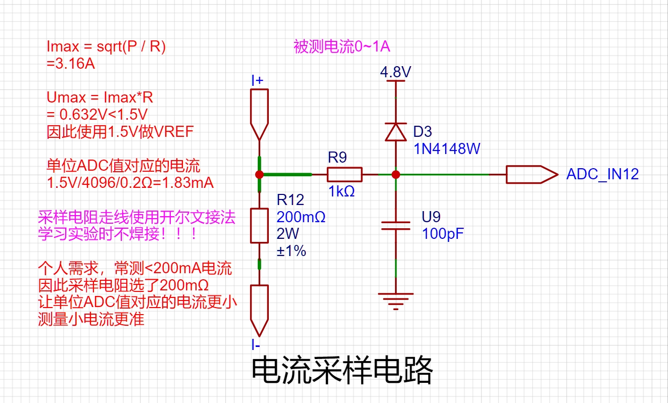

2.3.2 Current Sampling Circuit
From
Is = frac{V{REF}}{4096} imes frac{1}{R{sa}} ag{4}
, it can be seen that when the reference voltage $V{REF}$ is constant, the larger the sampling resistor $R_{sa}$, the smaller the corresponding $I_s$. Because I frequently measure milliampere-level currents, I naturally want the current corresponding to a unit ADC value to be as small as possible. Therefore, a 200mΩ resistor in a 2512 package with a power rating of 2W was selected.
I{Rmax} = sqrt{frac{P{max}}{R_{sa}}} = sqrt{frac{2}{0.2}}approx 3.16A
ag{5}
  From equation (5), we know that the maximum current that the 200mΩ resistor can collect is 3.16A, which is greater than the designed collection current of 1A. At this time, the current corresponding to the unit ADC value is
I_s = frac{1.5V}{4096} imes frac{1}{0.2Ω} approx 1.83mA ag{6}
which meets the design requirements.
  The current sampling circuit design is shown in Figure 9.
Figure 9 Current Sampling Circuit

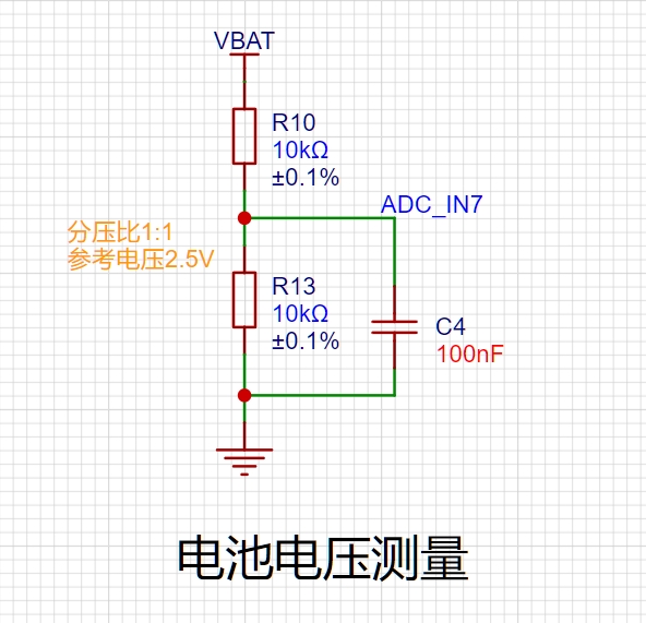

2.3.3 Battery Voltage Sampling
  The battery voltage sampling circuit design is shown in Figure 10. Two 10KΩ ±0.1% resistors are used for voltage division. The internal reference voltage is selected as 2.5V.
Figure 10 Battery Voltage Measurement Circuit

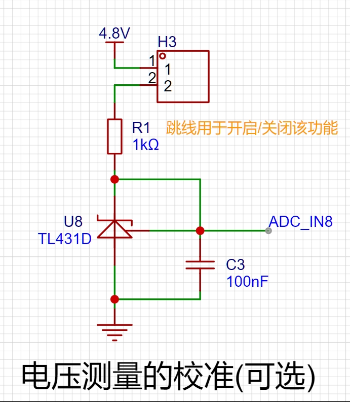

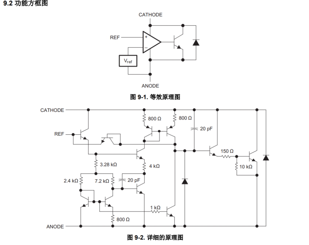

2.3.4 TL431 Voltage Calibration Circuit (Optional)
  A TL431 voltage calibration circuit was also used in this project to provide a 2.5V reference voltage. Although the CW32 has a built-in 2.5V voltage reference, theoretically eliminating the need for an external reference, the TL431 can be used to study the application principles of voltage reference chips.
Figure 11
The TL431 schematic
  is shown in Figure 11. The core of the TL431 is an operational amplifier (op-amp), which acts as a comparator in the circuit. Internally, the chip has a voltage Vref (approximately 2.5V), which acts on the inverting input of the comparator. A voltage is input to REF at the non-inverting input of the comparator. When this voltage is greater than Vref, the comparator outputs a high level, enabling the transistor and connecting the CATHODE (cathode) and ANODE (anode) terminals. If REF and CATHODE are at the same potential (connected together), the potential at REF is pulled low. When the potential at REF is pulled down below Vref, the comparator outputs a low level, the transistor turns off, and the potential at REF rises back up. When it is higher than Vref, the above process continues, and so on. Because the hardware response speed is extremely fast, the voltage at REF is almost equal to Vref.
  The TL431 circuit design is shown in Figure 12.
Figure 12 Voltage Calibration Circuit

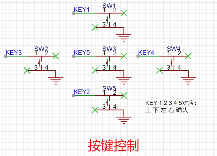

2.4 The CW32's internal I/O ports
  can be configured with pull-up and pull-down resistors, but this is not necessary for the external button control circuit. One end of the button is connected to the MCU's I/O, and the other end is grounded. When the button is pressed, the I/O is pulled low. The falling edge needs to be detected and an interrupt triggered during code writing; the code will be explained in the software design section (Section 3). The button circuit design is shown in Figure 13.
Figure 13 Button Control Circuit
The button operation logic corresponding to each I/O port is shown in the table below.
I/O Port
Operation Logic
PA12
Up
PA8
Down
PA9
Left
PA11
Right
PA10
OK
2.5

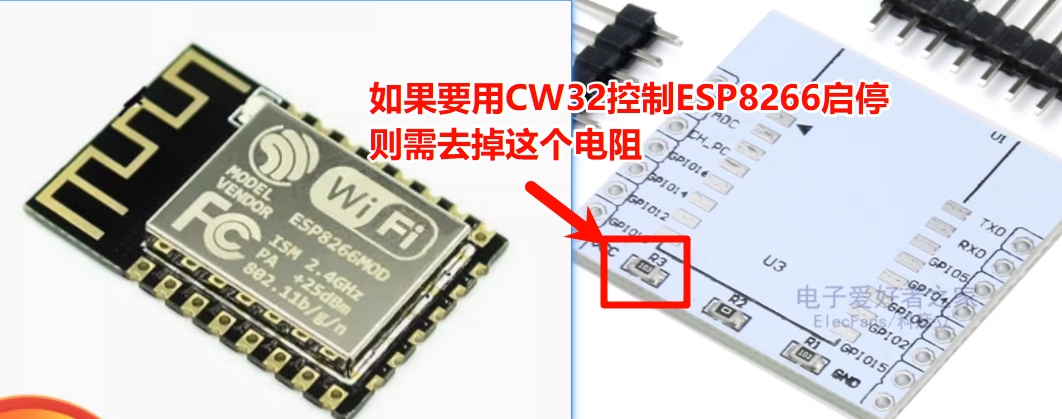

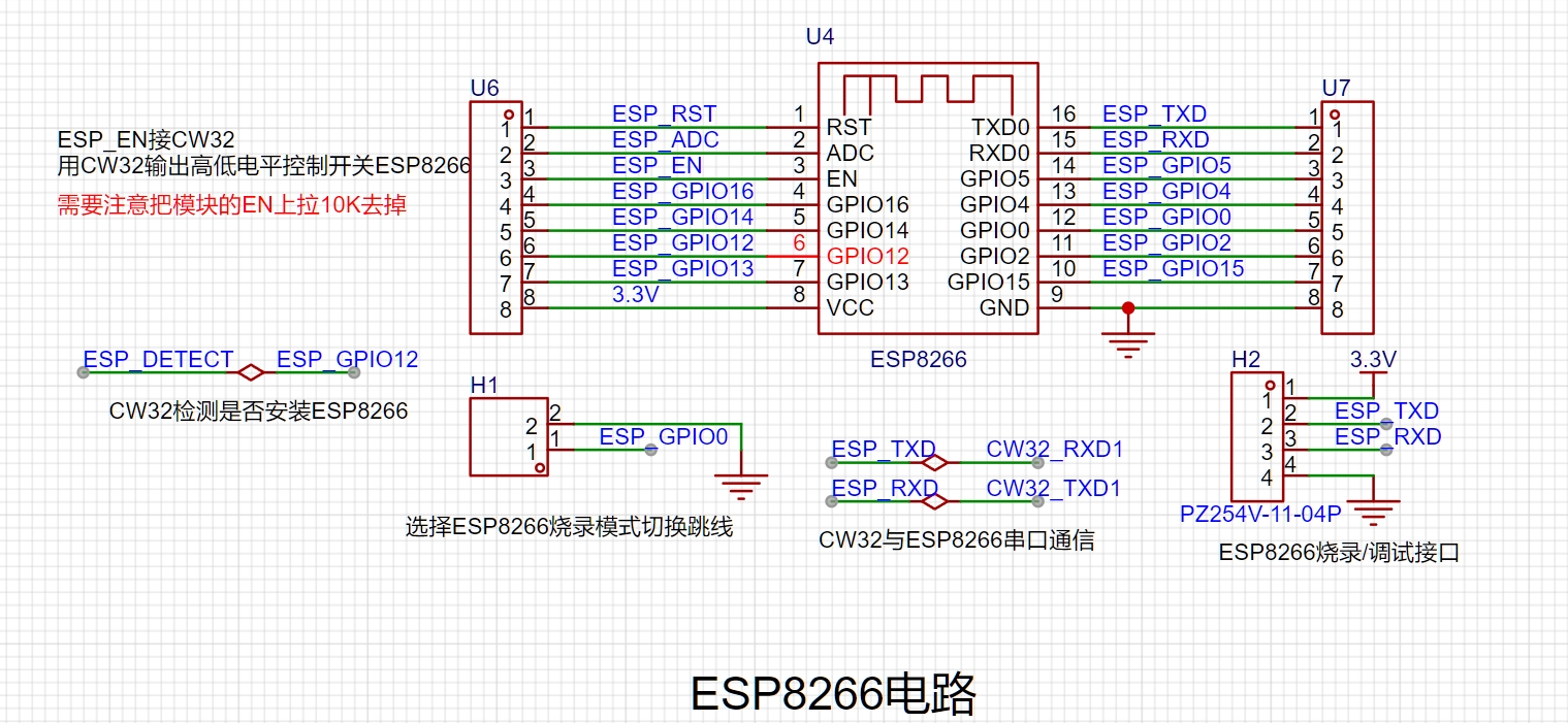

  Since this project uses an "Internet of Things" voltmeter and ammeter, it must connect to the network via Wi-Fi to upload data. Therefore, Espressif's ESP8266 was used. Its core is the ESP-12F+ with a matching adapter board, which costs about 6 RMB on Taobao. The adapter board is used for easy plugging and unplugging and reuse, as shown in Figure 14. Additionally
  , if you, like me, want to use a CW32 to control the ESP8266's start and stop, you need to remove a 10K resistor from the adapter board; its location is shown in Figure 14.
Figure 14 ESP8266 Module and Adapter Board
  The ESP8266 circuit design is shown in Figure 15. The 8266's serial port is connected to PB8 and PB9 of the CW32, and a header pin is brought out as an external programming interface. Furthermore, GPIO0 can be grounded via a jumper cap to switch between download and debug modes without external wiring.
Figure 15 ESP8266 Circuit Design

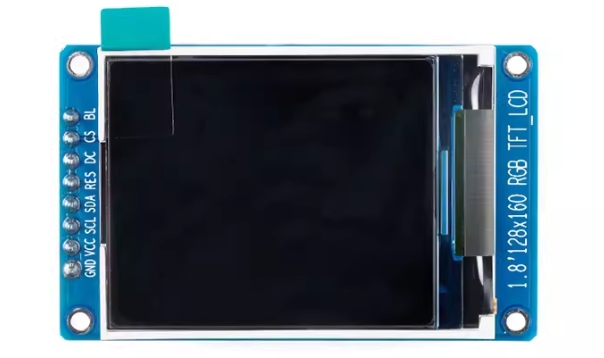

2.6 The TFT screen
  used in this project is a 1.8-inch color screen with a resolution of 128*160, driven by an ST7735. It uses SPI communication, and the pin definitions and functions are shown in the table below:
|Pin|Function|
|SCL |SPI clock, corresponding to the host computer's SCK SPI|
|SDA |SPI data input, corresponding to the host computer's MOSI SPI|
|RES |Reset, active low, high during operation|
|DC |Command mode and data mode switch bit, low for command mode, high for data mode|
|CS |Chip select signal, corresponding to the host computer's CS SPI|
|BL |Backlight, high for on, low for off, PWM dimming available|
  Figure 16 shows the appearance of the TFT screen. Please confirm with the vendor whether it uses an ST7735 driver; otherwise, you will need to adapt the code yourself.

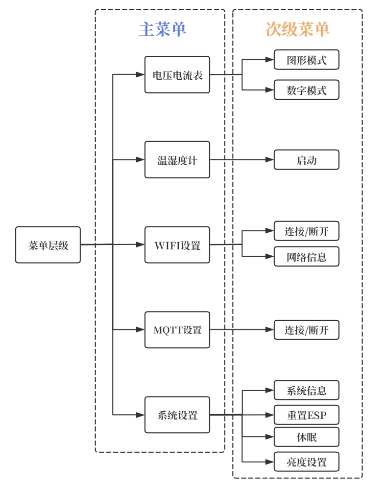

3.2 Menu Design
  The menu logic adopts a two-level menu. The main menu is used to select functions, such as connecting to WIFI, voltage and current meters, etc., and is placed on the left side of the screen; while the secondary menu is used to select branches under the main function and is placed on the right side of the screen. The menu hierarchy diagram is shown in Figure 17.
Figure 17 Menu Hierarchy Diagram
  Menu-related functions are all placed in the menu.c source file. The Show_Status_Bar function is used to display the current battery level, WIFI connection status, ESP8266 connection status, and MQTT connection status. The core is to call the TFT screen drawing function showimage_16, which can be viewed in the GUI.c source file. The drawn image is obtained by an image modeling tool, and the converted hexadecimal array is placed in the Picture.c file.

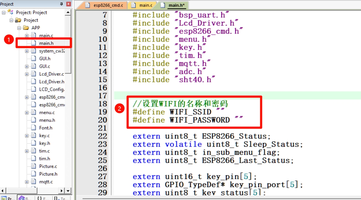

  At the user level, simply calling the `Connect_WIFI` function completes the WIFI connection.
`void Connect_WIFI() {`
GPIO_WritePin(ESP8266_EN_PORT,ESP8266_EN_PIN,GPIO_Pin_SET); //Turn on ESP8266

3.4 The functions related to the voltage
  and current meter are all in the va_meter.c file. The Launch_VA_Meter function is the entry function to start the voltage and current meter
  . Here, the main thing is that the value drawn on the screen needs to be handled a little bit. The floating point number is converted to a string by taking the mantissa. This function contains two modes: graphic mode and digital mode, which are controlled by the va_meter_style variable.
void Launch_VA_Meter(uint8_t idx)
Lcd_Clear(BLACK);
Init_VAmeter_ADC();
key_flag[2]=0;

while(key_flag[2]==0) //The left button is not pressed, and it is in the loop
ADC_GET();
//Process voltage data
if(adc_value[0]>=4090) //When the voltage value is greater than 3V, switch to 0~31V
voltage_value = (adc_value[1]/4095.0 * 1.5 * 21)-0.075; //The reference voltage is 1.5V, and the voltage division ratio is 1:20. After calibration, it is 0.075V higher than the normal value, so subtract 0.075
Gui_DrawFont_GBK16(128,0,RED,BLACK,"3V");
else //When the voltage value is less than 3V, switch to 0~3V
voltage_value = (adc_value[0]/4095.0 * 1.5 * 2); //The reference voltage is 1.5V, and the voltage division ratio is 1:1
Gui_DrawFont_GBK16(128,0,GREEN,BLACK,"3V");
if(voltage_value <=0.3) //When the value is below 0.3, it is considered an ADC error, and the value is set to 0, making this data acquisition invalid
. voltage_value = 0.0;
mqtt_volt = voltage_value;
voltage_value *= 100; // Process to display two decimal places
for(uint8_t i = 0; i<4; i++)
voltage_num[3-i]=(int)(voltage_value/(pow(10,i))) %10;
// Process current data
current_value = ((adc_value[2]/4095.0 * 1.5)/0.2 * 1000)-10.8; // Reference voltage is 1.5V, sampling resistor is 0.2ohm, current unit is mA, calibrated to be 10.8mA higher than theoretical value
if(current_value < 0)
continue;
mqtt_curr = current_value;
current_value *= 10; // Process to display 1 decimal place
current_num[3-i]=(int)(current_value/(pow(10,i))) %10;
// MQTT send interval 4-->- approximately equal to 0.3s
send_wait++;
if(send_wait>4)
VAmeter_Mqtt_Send_Data(mqtt_volt,mqtt_curr);

switch(va_meter_style)
case 0:
for(uint8_t i = 0; i<2; i++)
Gui_DrawFont_Num16(i*8,112,GREEN,BLACK,voltage_num[i]);
Gui_DrawFont_GBK16(16,112,ORANGE,BLACK,".");
for(uint8_t i = 2; i<4; i++)
Gui_DrawFont_Num16(8+i*8,112,GREEN,BLACK,voltage_num[i]);
Gui_DrawFont_GBK16(40,112,ORANGE,BLACK,"V");
for(uint8_t i = 0; i<3; i++)
Gui_DrawFont_Num16(60+i*8,112,BLUE,BLACK,current_num[i]);
Gui_DrawFont_GBK16(84,112,ORANGE,BLACK,".");
Gui_DrawFont_Num16(92,112,BLUE,BLACK,current_num[3]);
Gui_DrawFont_GBK16(100,112,ORANGE,BLACK,"mA");
Draw_Value_Line();
break;
case 1:
//Voltage
Gui_DrawFont_Num32(i*32,24,ORANGE,BLACK,voltage_num[i]);
Gui_DrawFont_Num32(16+i*32,24,BLUE,BLACK,voltage_num[i]);
//Current
Gui_DrawFont_Num32(i*32,80,ORANGE,BLACK,current_num[i]);
Gui_DrawFont_Num32(112,80,BLUE,BLACK,current_num[3]);
break;

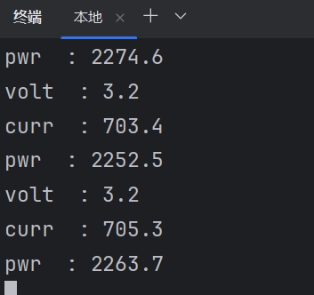

  There is also a function VAmeter_Mqtt_Send_Data, which sends voltage, current and power data to the MQTT message queue. This function will be automatically enabled after connecting to WIFI and MQTT.
void VAmeter_Mqtt_Send_Data(double volt,double curr)
if(mqtt_status == 0)
return ;
double pwr = volt*curr;
char *data = malloc(150);
char t[10] = {0};
strcpy(data,"{"volt":");
num2char(t,volt,log10(volt)+1,2);
strcat(data,t);
memset(t,0,10);
strcat(data,","curr":");
num2char(t,curr,log10(curr)+1,1);
strcat(data,t);
memset(t,0,10);
strcat(data,","pwr":");
num2char(t,pwr,log10(pwr)+1,1);
strcat(data,t);
free(t);
strcat(data,"}");
MQTT_Publish(data);
free(data);

The button-related functions are in the key.c source file. The initialization function Key_Init sets each button to pull-up input mode.
void Key_Init(void)
GPIO_InitTypeDef GPIO_InitStruct;
PA8 -> UP_KEY
PA9->DOWN_KEY
PA10->LEFT_KEY
PA11->RIGHT_KEY
PA12->CONFIRM_KEY
GPIO_InitStruct.Pins = LEFT_KEY_PIN|RIGHT_KEY_PIN|UP_KEY_PIN | CONFIRM_KEY_PIN| DOWN_KEY_PIN;
GPIO_InitStruct.Mode = GPIO_MODE_INPUT_PULLUP; //Pull-up input
GPIO_InitStruct.Speed ​​= GPIO_SPEED_HIGH; //High output speed
GPIO_Init(CW_GPIOA, &GPIO_InitStruct); //Initialization

. (3) Configure WIFI. As shown in Figure 18, configure the WIFI name and password in main.h.
Figure 18 Modify WIFI name and password

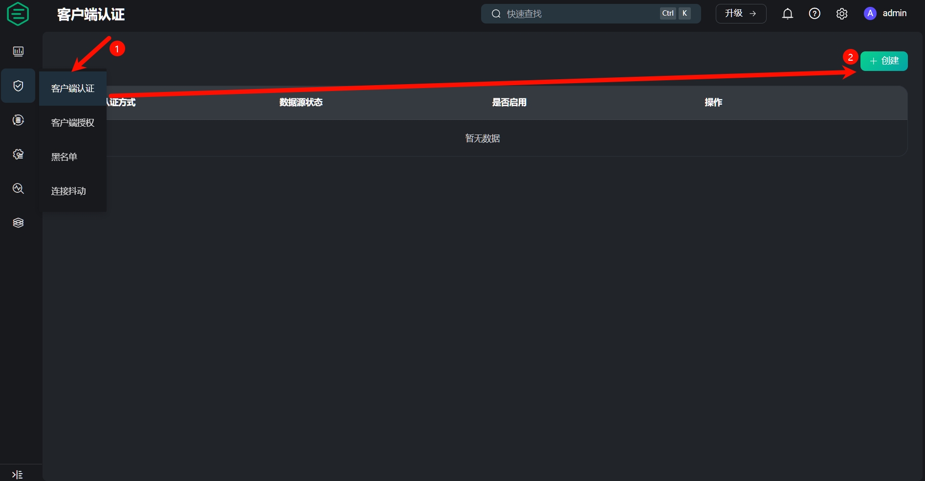

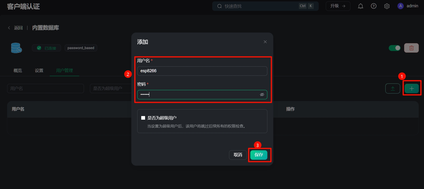

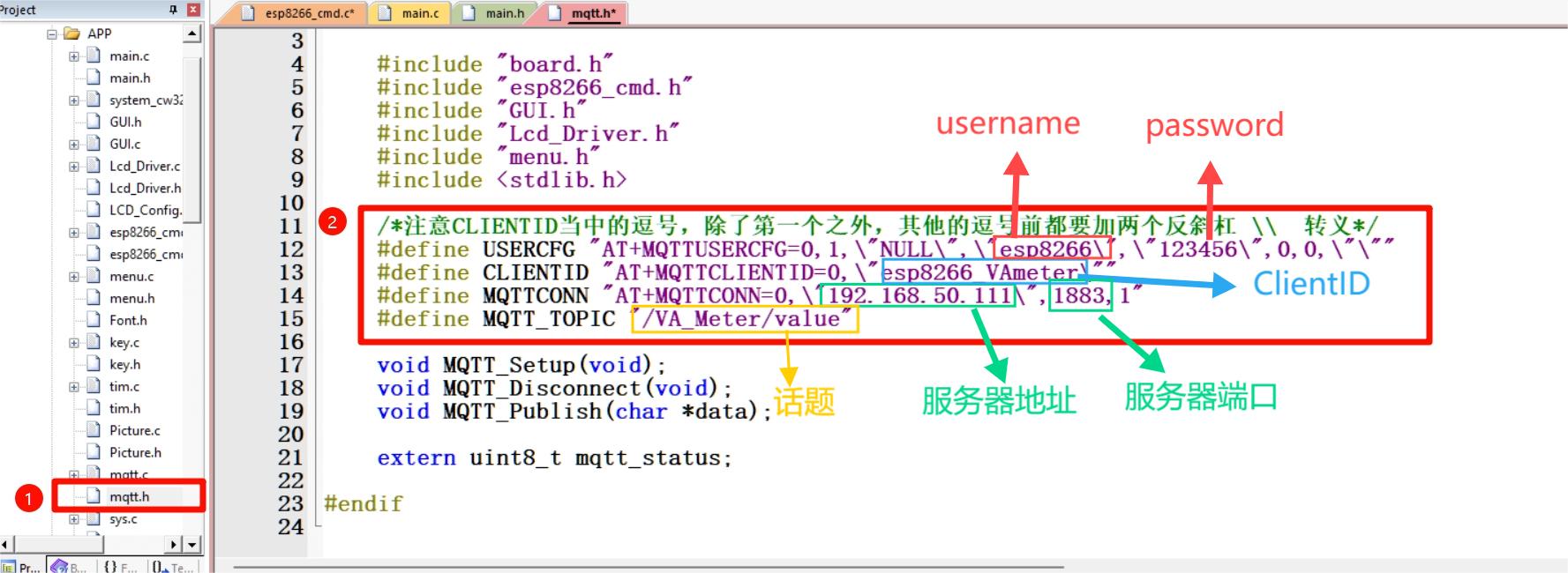

(4) Configure MQTT. Please return to this step after setting up the MQTT server in Section 4.5.
  As shown in Figure 19, the username and password are set on the EMQX server. Please refer to Section 4.5 for details. The ClientID is set by yourself. I set it to esp8266_VAmeter for easy identification. The server address is the IP address of the EMQX device. The port generally does not need to be changed and is 1883 by default. The topic is the topic to publish messages. You can write a name that you can remember, because you will need to subscribe to this topic when configuring the Python forwarding program later.
Figure 19 MQTT connection configuration

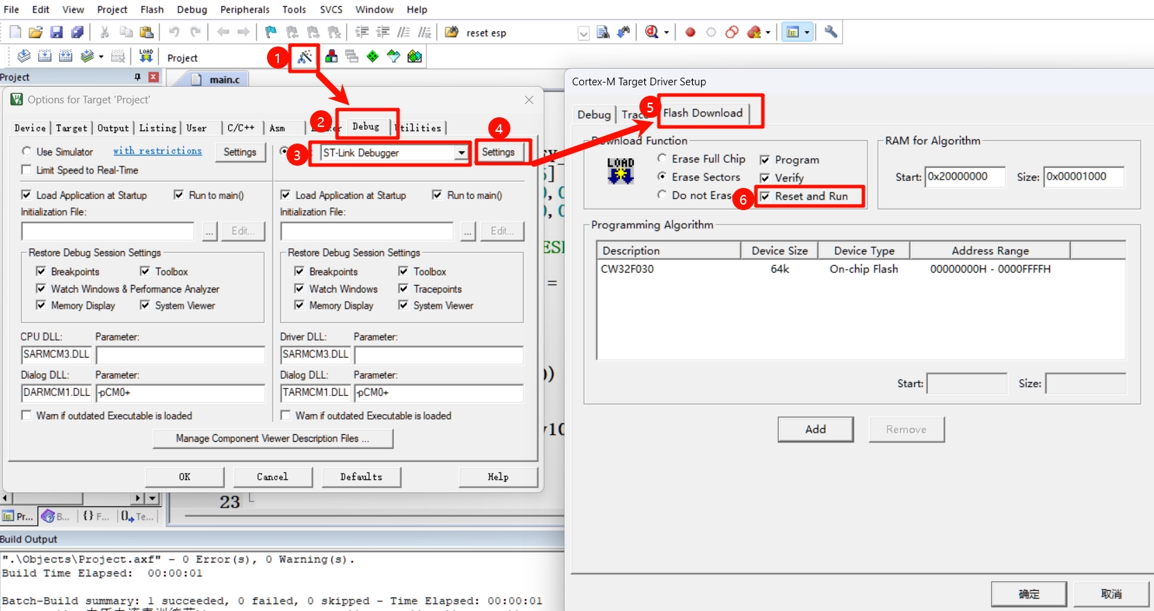

(5) Keil downloader configuration. As shown in Figure 20, I am using ST-LINK. Please choose according to your downloader.
Figure 20 Keil downloader configuration

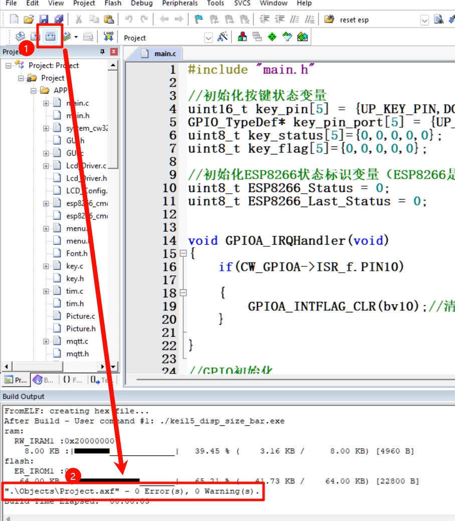

  To make it easier for everyone to download, I have transferred this file from the official website to the cloud drive: https://www.123pan.com/s/TBfTjv-jdvg.html
(7) Click the Rebuild button in Keil. After compilation, there should be 0 Errors and 0 Warnings, as shown in Figure 21.
Figure 21 Recompiling Rebuild
(8) Connect the downloader, click the Download button, wait a few seconds, and it will be used normally.

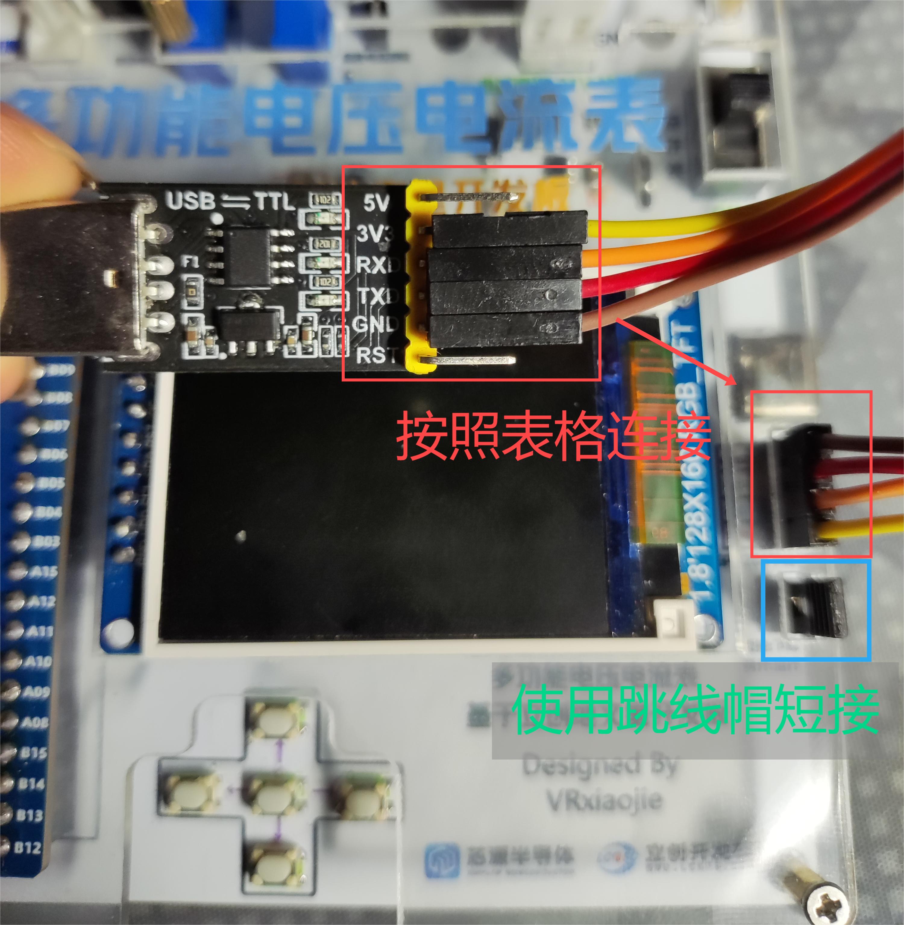

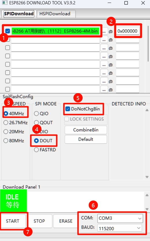

4.3 Download the MQTT AT firmware of ESP8266
(1) Download and unzip flash_download_tool.zip and 1112_esp8266-4m.zip in the attachment.
(2) Using a USB to serial port module, connect the serial port module to the onboard download interface according to the table below. Serial
port module
onboard interface
3.3V
3.3V
TXD
RXD
RXD
TXD
GND
GND
(3) Using a jumper cap, short the download selection jumper, as shown in Figure 22.
Figure 22 ESP8266 serial port download wiring
(4) Insert the serial port module into the computer, open the flash_download_tool_3.9.2.exe in the unzipped flash_download_tool folder, in the pop-up window, select ESP8266 as the first option and develop as the second option, then click OK.
  In the next interface, configure it as shown in Figure 23. Select the COM port according to your computer's recognition. After configuration, click START.
Figure 23 Firmware download tool configuration
(5) Since ESP8266 is disabled by default in the CW32 program, you need to go to the CW32 menu to System Settings -- Start ESP8266.
Please note: Keep the onboard main switch off, otherwise the firmware of ESP8266 may not be able to be downloaded normally.
(6) Check the flash_download_tool on your computer. It has started downloading. Wait patiently for the progress bar to finish.
(7) Unplug the serial port module wiring and jumper cap, operate the menu to WIFI-Connect WIFI, and check if the connection is normal. You can also operate the menu to WIFI-Network Information after connection to obtain device IP and other information.

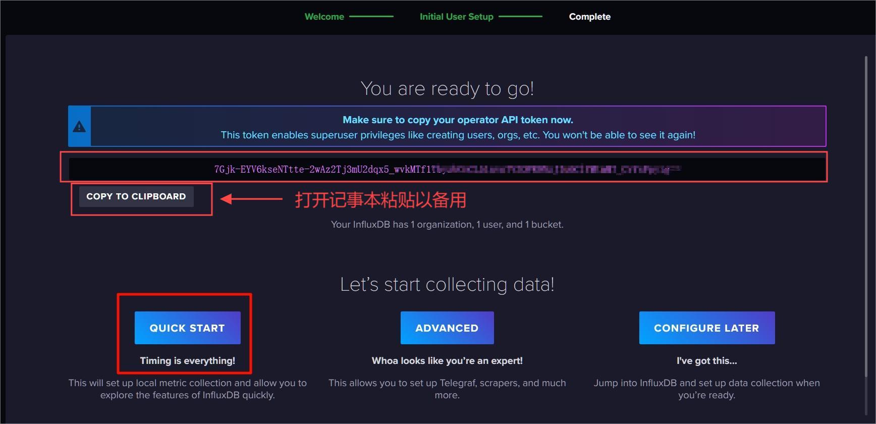

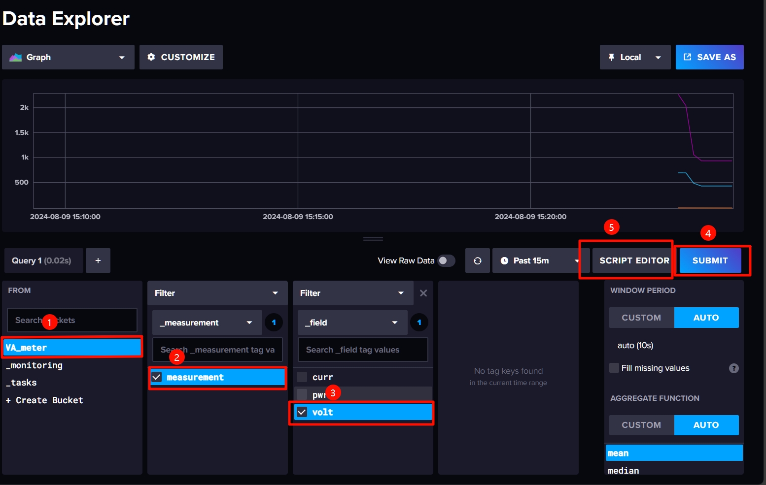

4.4 Self-built InfluxDB database
Please note: Sections 4.4, 4.5 and 4.6 are based on Docker one-click installation and deployment. If you have not installed Docker, please refer to the following tutorials for installation:
Windows Docker installation tutorial: https://www.runoob.com/docker/windows-docker-install.html
Ubuntu Docker installation tutorial: https://www.runoob.com/docker/ubuntu-docker-install.html
  After installation, type the command docker -v in the command line (windows) or terminal (Linux). If it returns Docker version xx.xx.x,build xxx, the installation is successful and you can continue to the next step.
(1) Pulling the InfluxDB image
  Here I use a Docker image accelerator that I built myself to accelerate the image. It may become unusable if there are too many accesses. If you have a domain name, you can refer to this tutorial and use Cloudflare. Workers can build their own.
It doesn't matter if there is no domain name, just use my image to speed it up. Open the terminal and enter the following command to create the directory to store the data.
mkdir config && mkdir data
(2) Then run the docker run command, where $PWD is the folder where the terminal is located. I changed the port mapping to 3086
sudo docker run -d
--name=influxdb2.0
-p 3086:8086
-v "$PWD/data:/var/lib/influxdb2"
-v "$PWD/config:/etc/influxdb2"
docker-mirror.vrxiaojie.top/library/influxdb:2.7.6
(3) If nothing goes wrong, it will start to automatically pull the image without any errors. Then we open the webpage and enter the IP address and port of the machine where you deployed InfluxDB, for example, mine is 192.168.50.111:3086, and we can see the welcome screen (Figure 24)

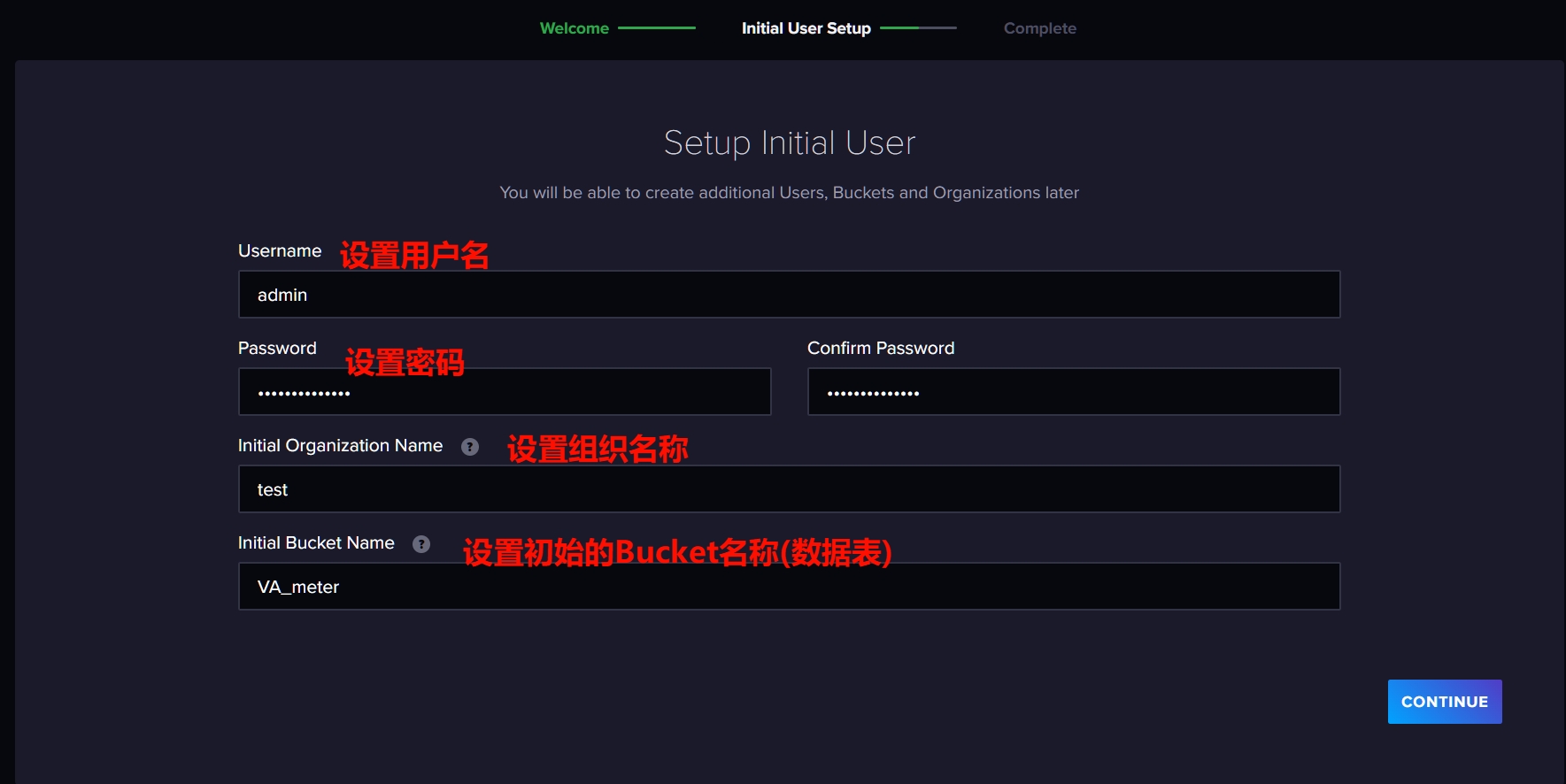

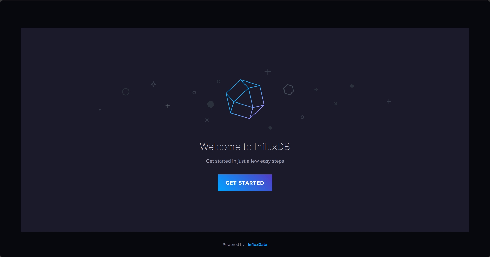

. Figure 24 InfluxDB Welcome Screen
(4) Click Next to go to the initialization settings, where you are asked to fill in the username, password, organization name, and initial Bucket name. You can fill them in yourself or follow mine (Figure 25).
Figure 25 Initializing InfluxDB Settings
(5) Done! Save the displayed API token, which will be used later. Then click Quick Start (Figure 26)
Figure 26 InfluxDB initialization complete
At this point, the InfluxDB database is set up.

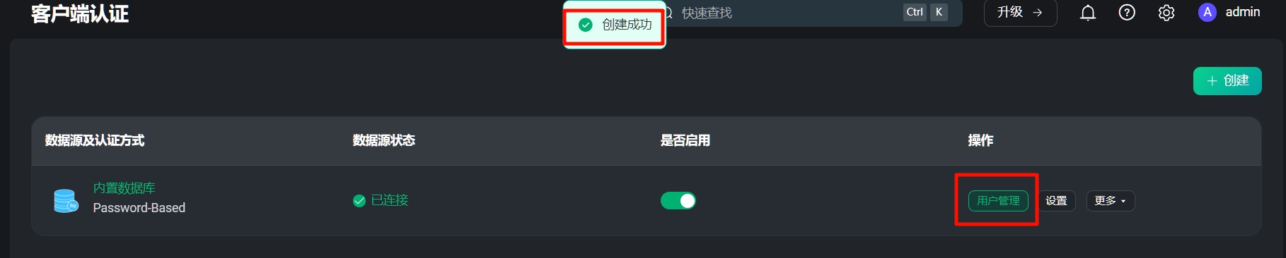

(4) Create client authentication, see Figure 27. Client authentication --> Create --> "Password_Based" Next --> "Built-in database" Next --> "username" "sha256" "suffix" --> Create
Figure 27 EMQX Create Client Authentication
(5) After successful creation, click User Management (Figure 28) --> "+" sign --> Enter the username, I wrote esp8266, password 123456 --> Create (Figure 29).
  Similarly, create a username named python for use in the next section.
Figure 28 Create User
Figure 29 Set the client username and password

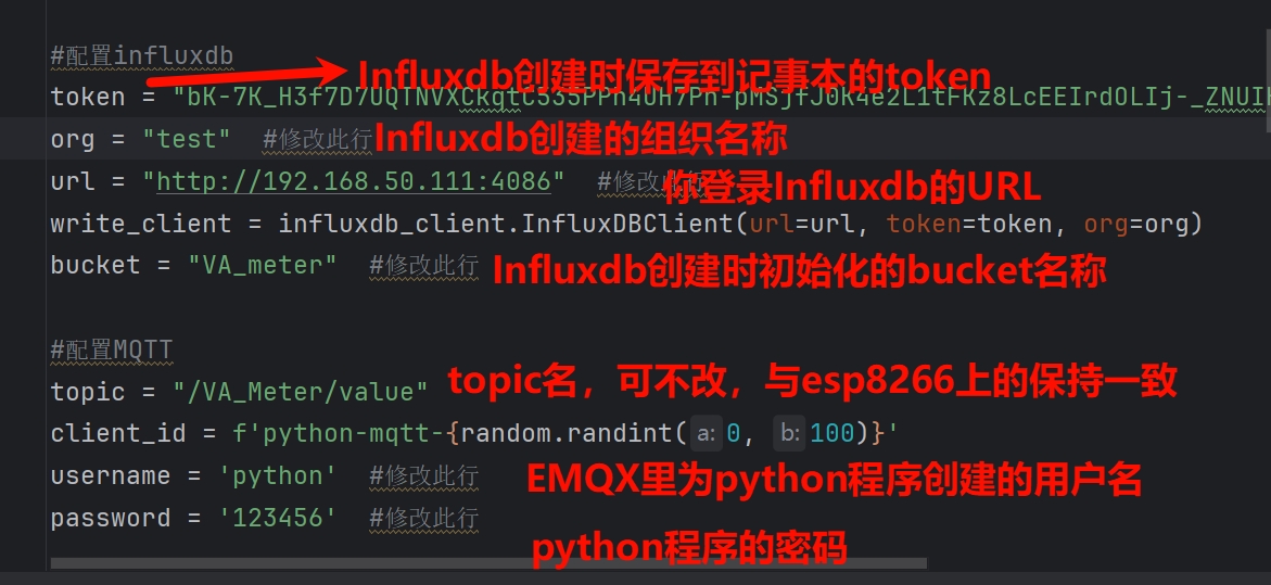

(2) After completion, open emqx_receive_VA_meter.py with any editor and modify the parameters marked # in this line. As shown in Figure 30. Remember to save after modification.
Figure 30 Python program parameter settings
(3) Run the py program. Open the terminal in the current directory and enter
python emqx_receive_VA_meter.py
If you see Connected to MQTT Broker!This indicates that the connection to the EMQX server has been successful. The program can then be placed in the background.

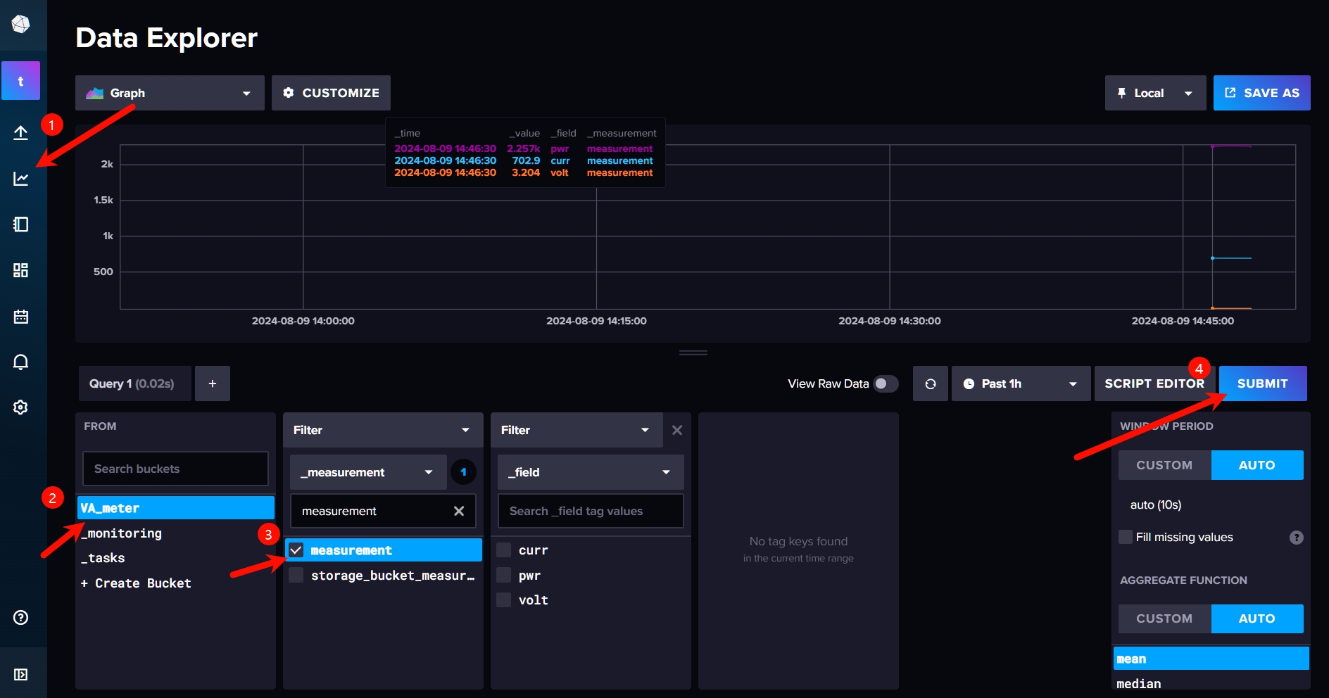

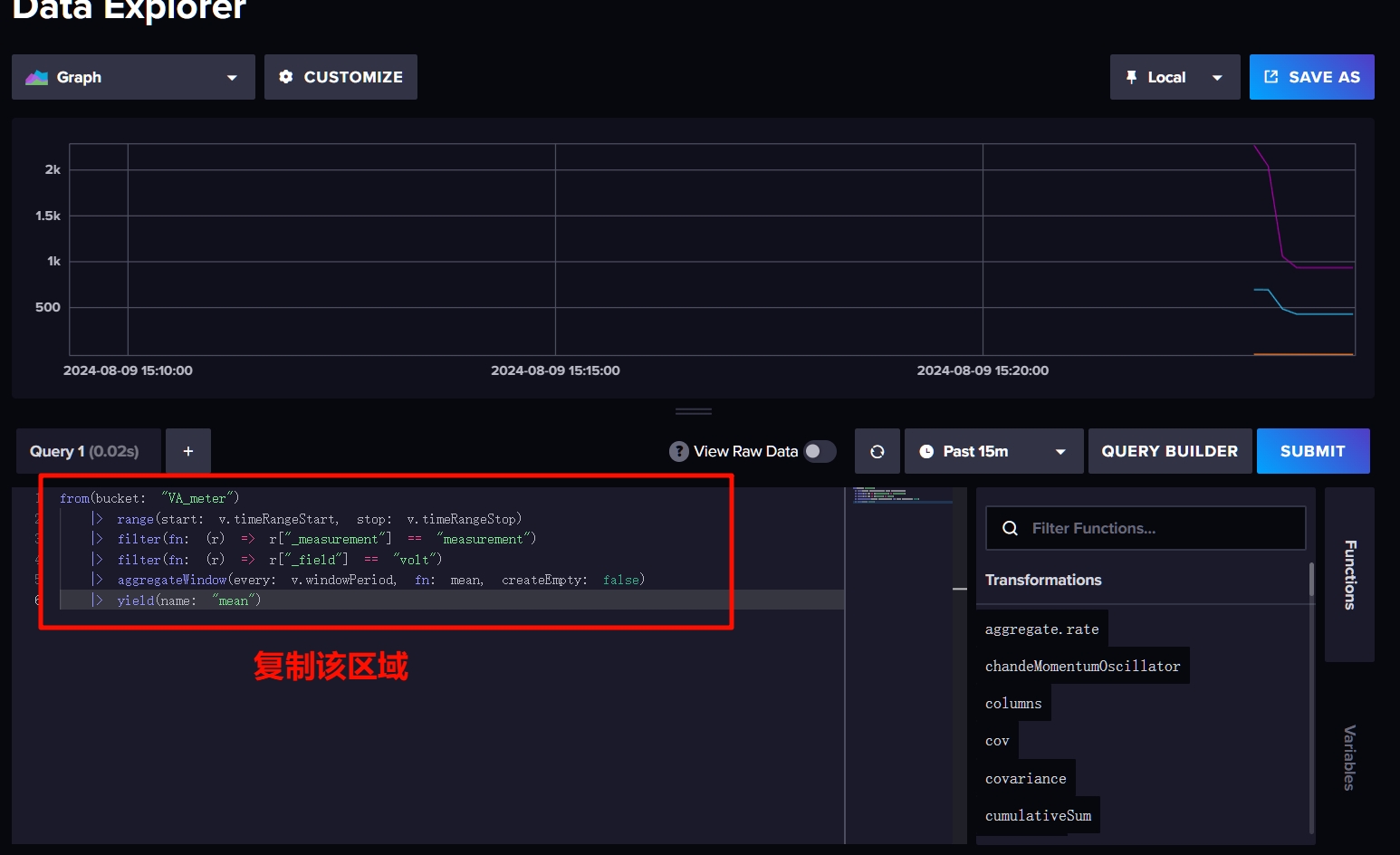

(5) Enter the InfluxDB backend management interface and follow the steps shown in Figure 32 to find the data that was just sent.
Figure 32 InfluxDB data query

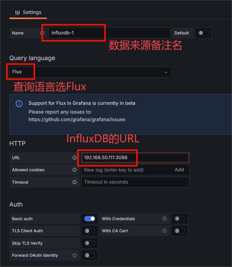

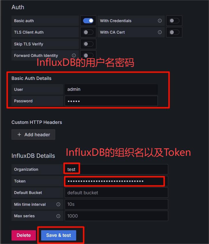

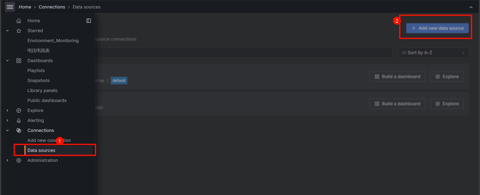

(4) Create a data source. As shown in Figure 33, click Data Sources in the left sidebar, then click Add New...
Figure 33 Grafana Add Data Source
Select InfluxDB, and then fill in the following pages as shown in Figures 34 and 35.
Figure 34 Data Source Configuration
Figure 35 Data Source Configuration

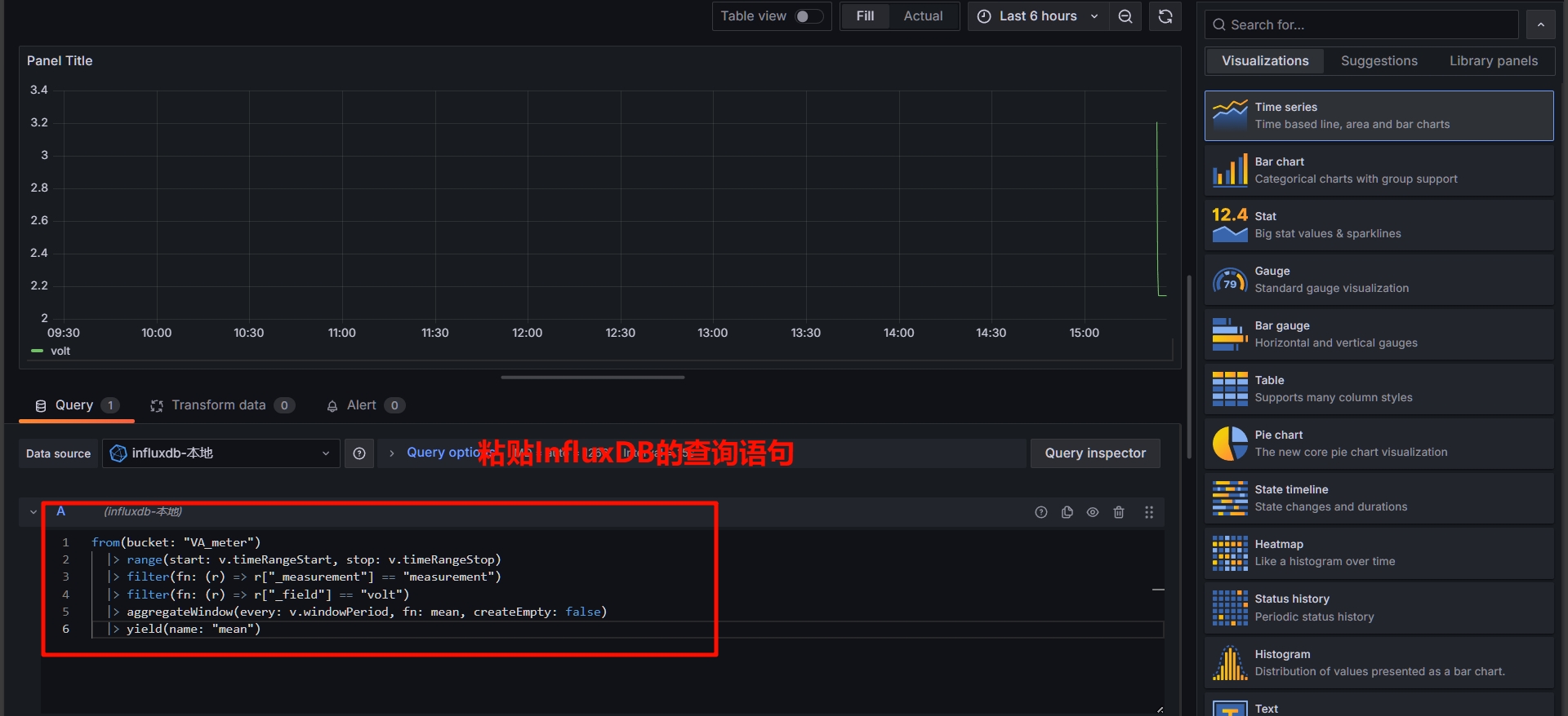

(5) Click the "+" sign in the upper right corner of the homepage, select New Dashboard, click Add visualization, and select the data source you just created. Here I will add a voltage curve as a demonstration; the other items are similar.
  Return to the InfluxDB backend, in the place where we just queried the data, follow the operation in Figure 36, then copy the area code shown in Figure 37 and paste it into Grafana (Figure 38). Some styles can be adjusted in the right sidebar. After finishing, click Apply and Save.
Figure 36 Data Query Operation
Figure 37 Get Query Statement
Figure 38 Paste query statement

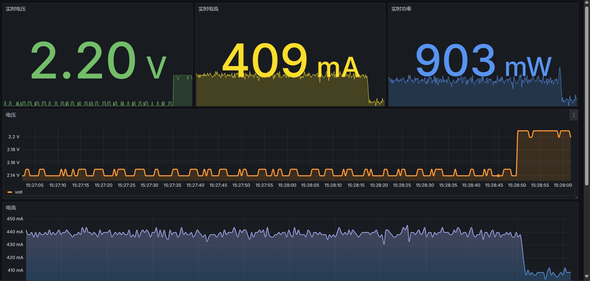

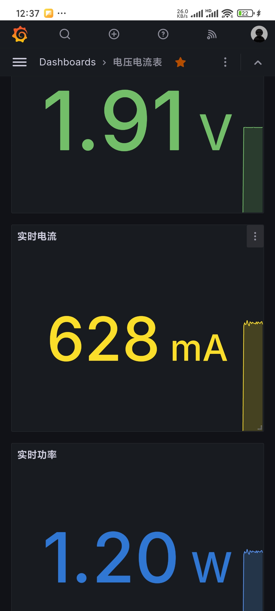

(6) Do the same for current and power using similar operations. See Figures 39a and 39b for the final effect.
Figure 39a Grafana dashboard PC
Figure 39b Grafana dashboard mobile

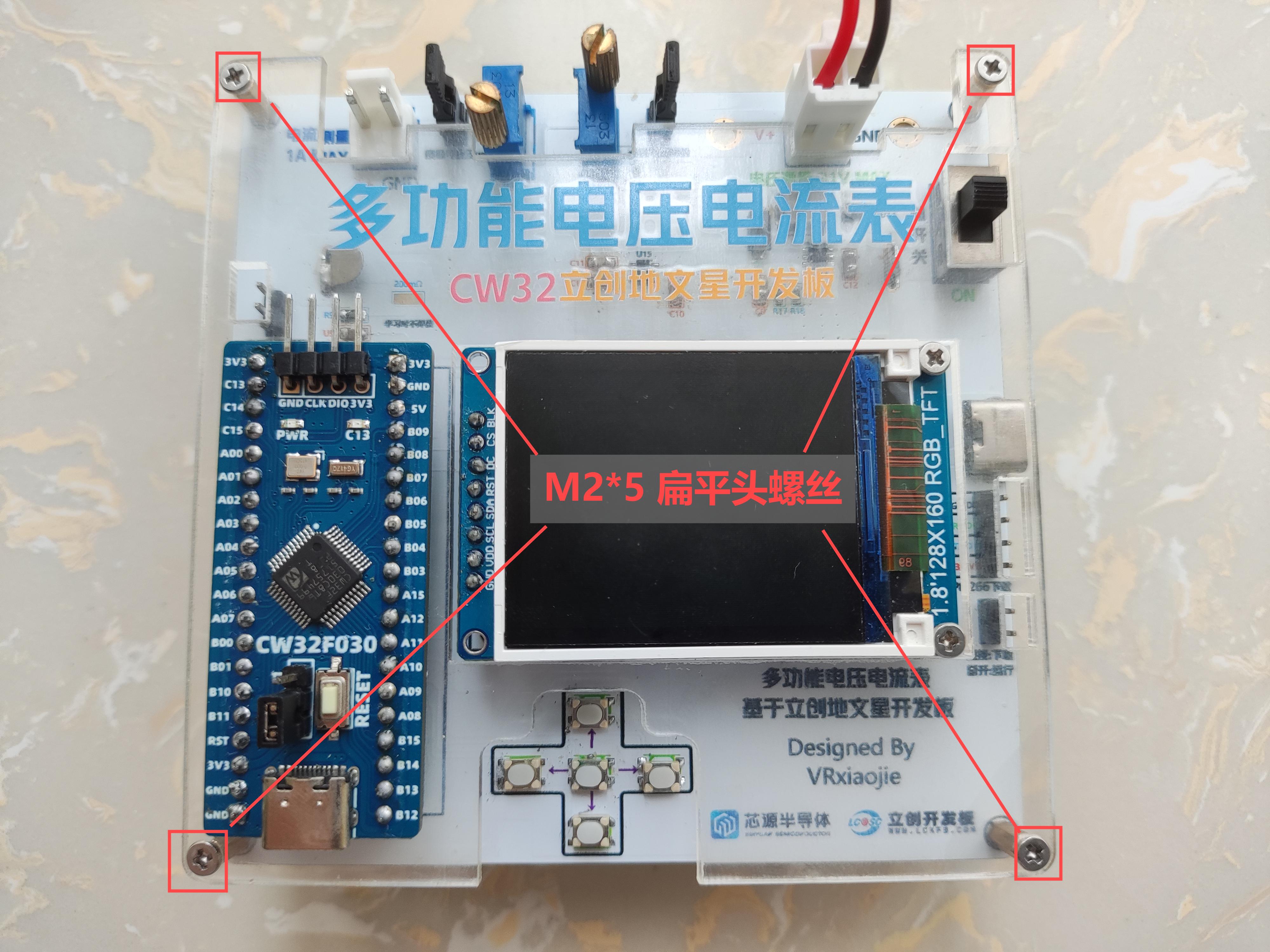

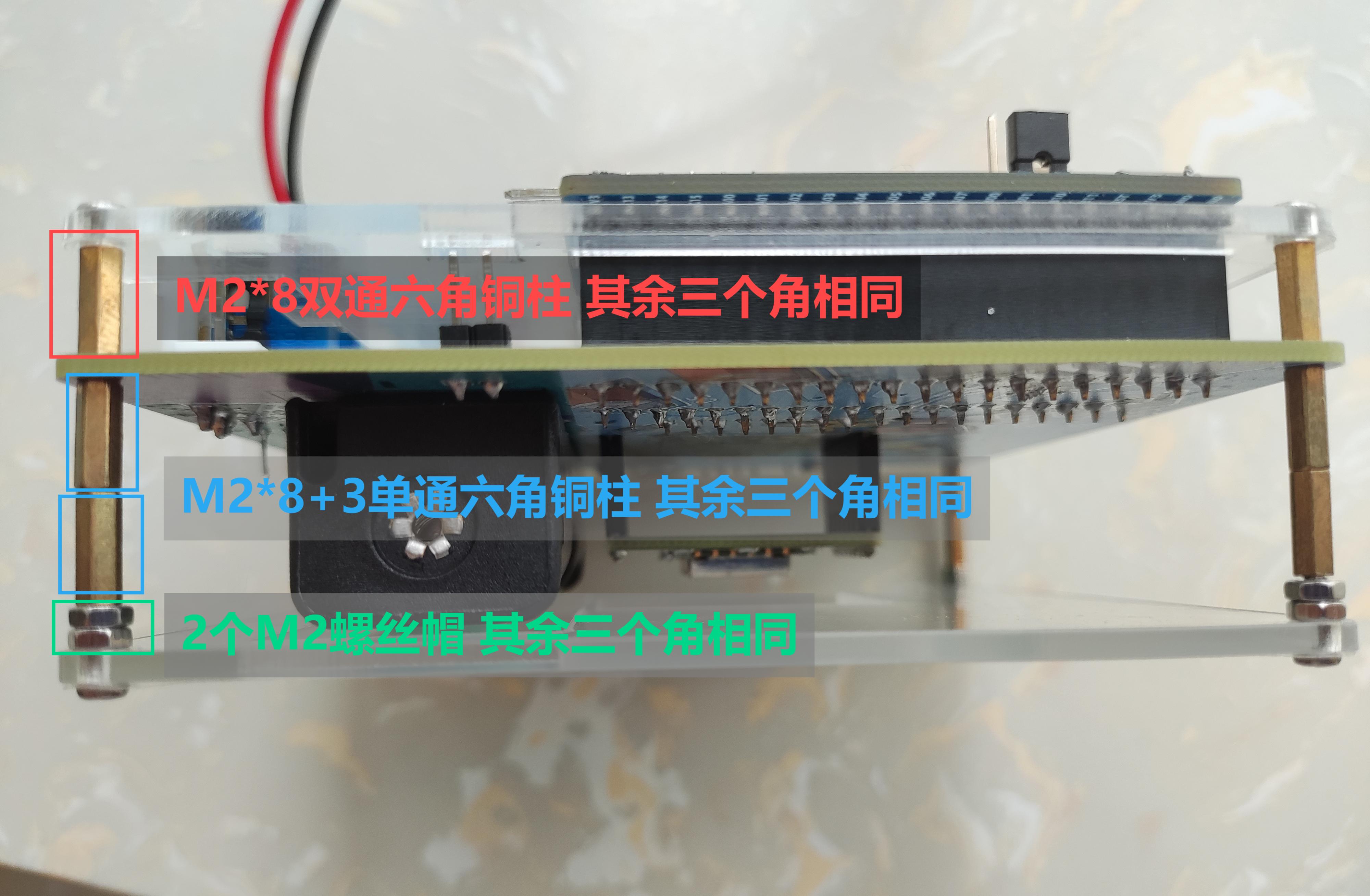

After receiving the panel, it needs to be assembled with screws and other fasteners. The materials required are shown in the table below
| Parts | Quantity |
|M25 flat head screws|8|
|M28 double hexagonal copper pillars|4|
|M2*8+3 single hexagonal copper pillars|8|
|M2 Screw Cap|8|
The assembly positions of each part are shown in Figures 40-42.
Figure 40 Top View
Figure 41 Side View
Figure 42 Bottom View
