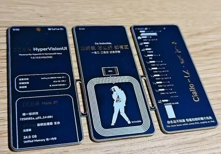

Icer-Mate XT, a Huawei-style tri-fold folding phone, is available for free.
A three-fold hinge version is being considered, regardless of how it's folded.
We're primarily looking for someone skilled in 3D modeling; interested parties can contact us.
NFC has been added. Size 1:2.5.

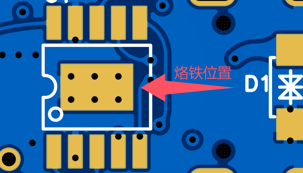

Soldering notes: When soldering CH224K, try to use a heating table or hot air gun, but a soldering iron can be used.
        Soldering method (not recommended): First, build up solder on the heat sink pad. Use low-temperature solder, 37% lead is also acceptable. Set the soldering iron to high temperature and keep it heating, then quickly remove the soldering iron and press the chip on. Finally, complete the soldering.

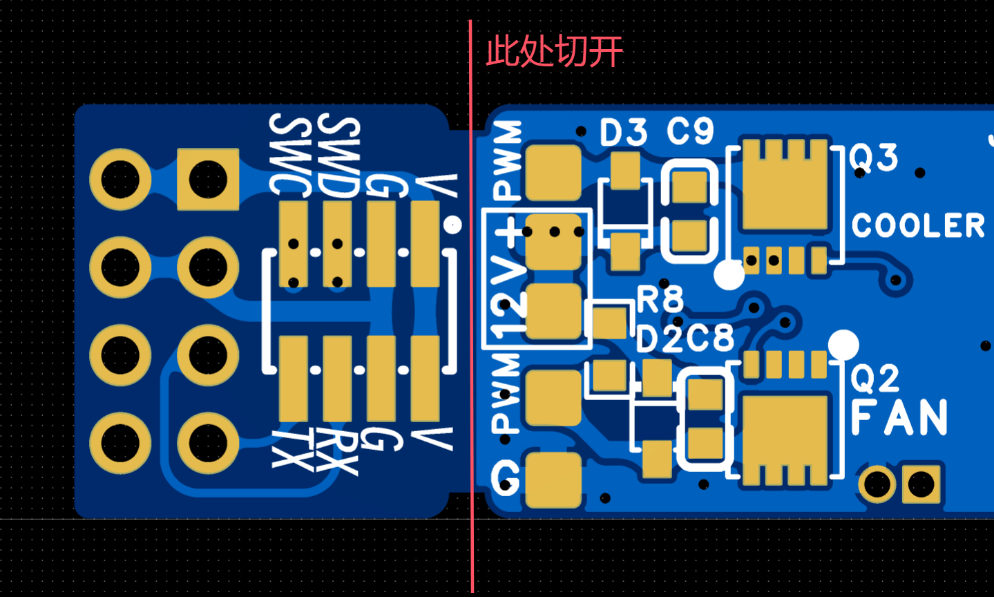

1. Cut the end of the board as a download interface adapter board and solder it separately.
2. Do not use a four-wire speed control motor, so there is no need to solder R8.
R8 is a 12V pull-up resistor, 10k is sufficient.

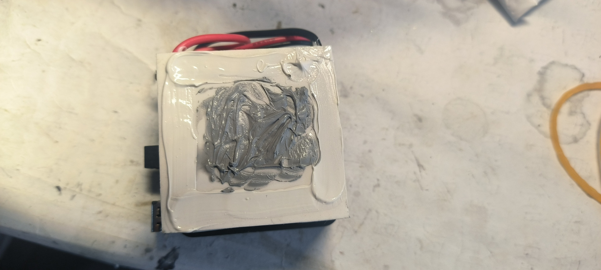

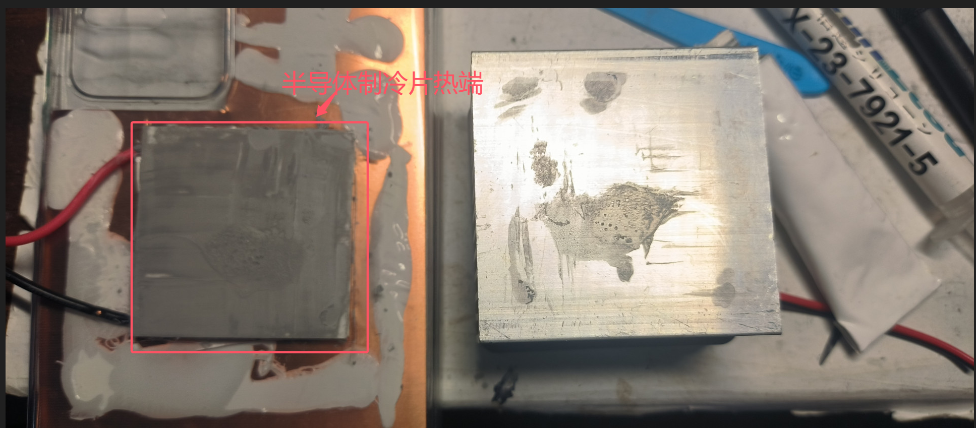

Cut the phone case opening to be similar in size to the heat sink; cut the copper sheet to fit your phone;
apply silicone grease and install the heat sink and semiconductor cooling chip. The side of the semiconductor cooling chip with the lettering is the cooling side, stick the copper; the other side is the heat sink .
Incorrect example: The silicone grease area is too small, the glue area is too large, and the thermal conductivity is not good.
Correct example: Apply silicone grease to the front, this time it is 7921, which is more difficult than scraping putty. Attach it to the heat sink and fix it with glue on the outside.
Wait for the glue to cure .
    3. Fix the phone case and copper sheet
    4. Apply silicone grease and install the copper sheet and semiconductor cooling chip.
Due to the small space, it is difficult to operate. I used the above "incorrect example" for installation.
    5. Attach the board to the heatsink, being careful not to short-circuit.

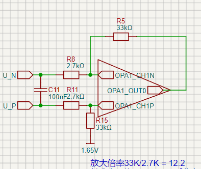

Current sampling design: Since an on-chip op-amp is used, the amplification factor is adjusted by external resistors. Due to the small resistance value, the input impedance is small. Therefore, the 1.65V reference voltage needs to be output by an op-amp forming a voltage follower. Three resistors are used for sampling because the remaining op-amp is used.
Adjusting the amplification factor: Amplification factor calculation: When R5=R15, R8=R11, Vo = (R8/R5)*Vi. As shown in the figure, the amplification factor is 12.2. Therefore, the corresponding resistance value is adjusted to adjust the amplification factor.
Reference voltage: Since the motor current being sampled is a sine wave, it is necessary to sample a value with the opposite direction and the same amplitude; the ADC cannot do this; after using a differential amplifier circuit with a 1.65V bias, the AC voltage to be sampled can be mapped to a positive voltage range of 0~3.3V.
Sampling resistor: The maximum current that can be sampled is Imax = 1.65 / (amplification factor) / (sampling resistor). The larger the sampling resistor, the simpler the debugging. A 50mR resistor is actually used. MOSFET selection for

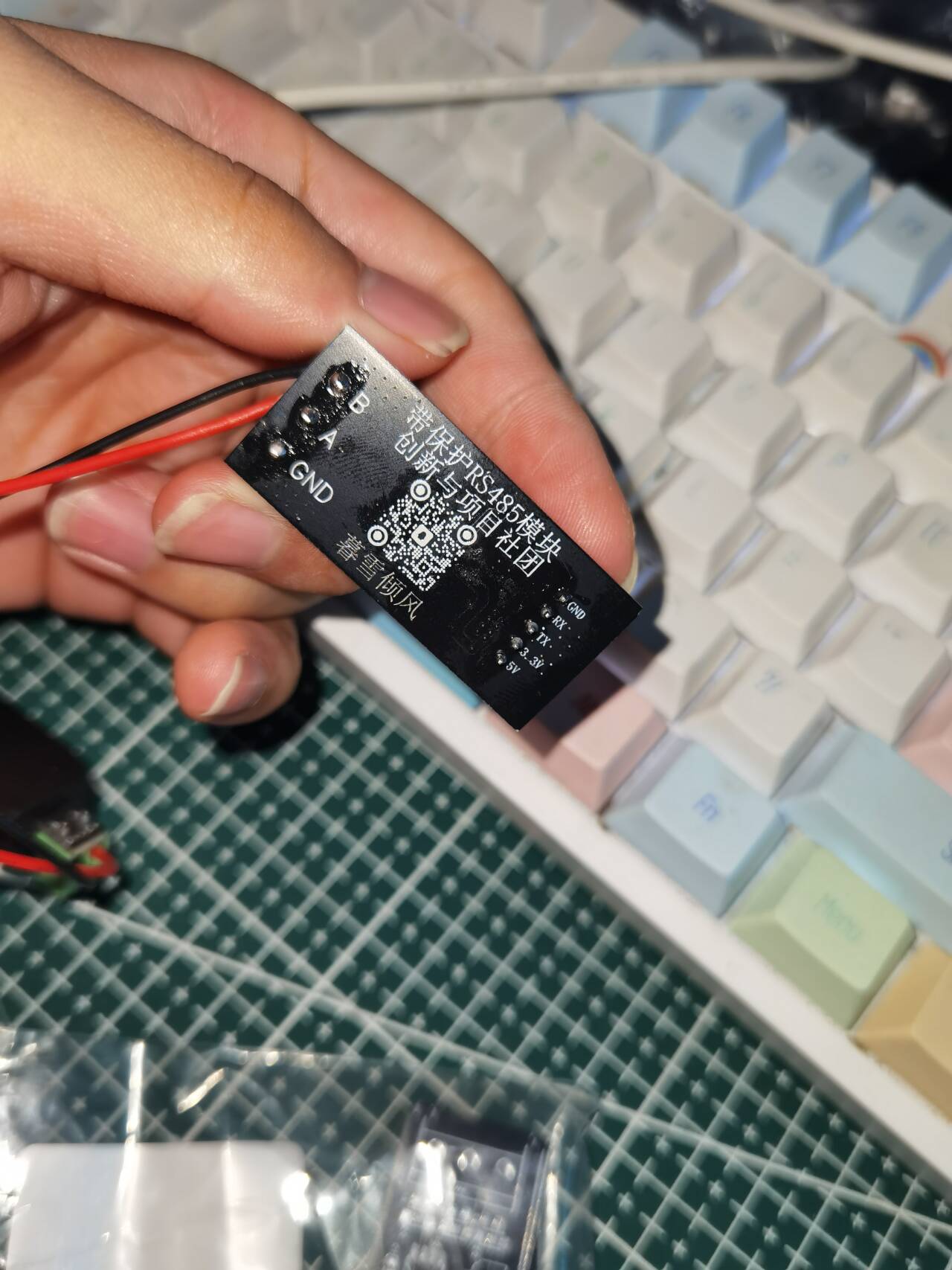

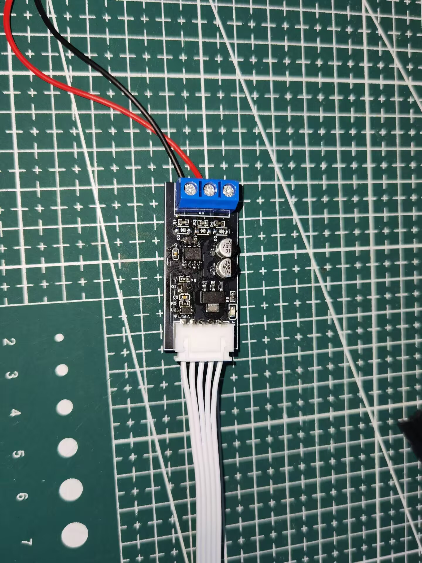

TP8485 485 module with protection and automatic transmit/receive determination

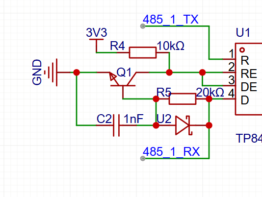

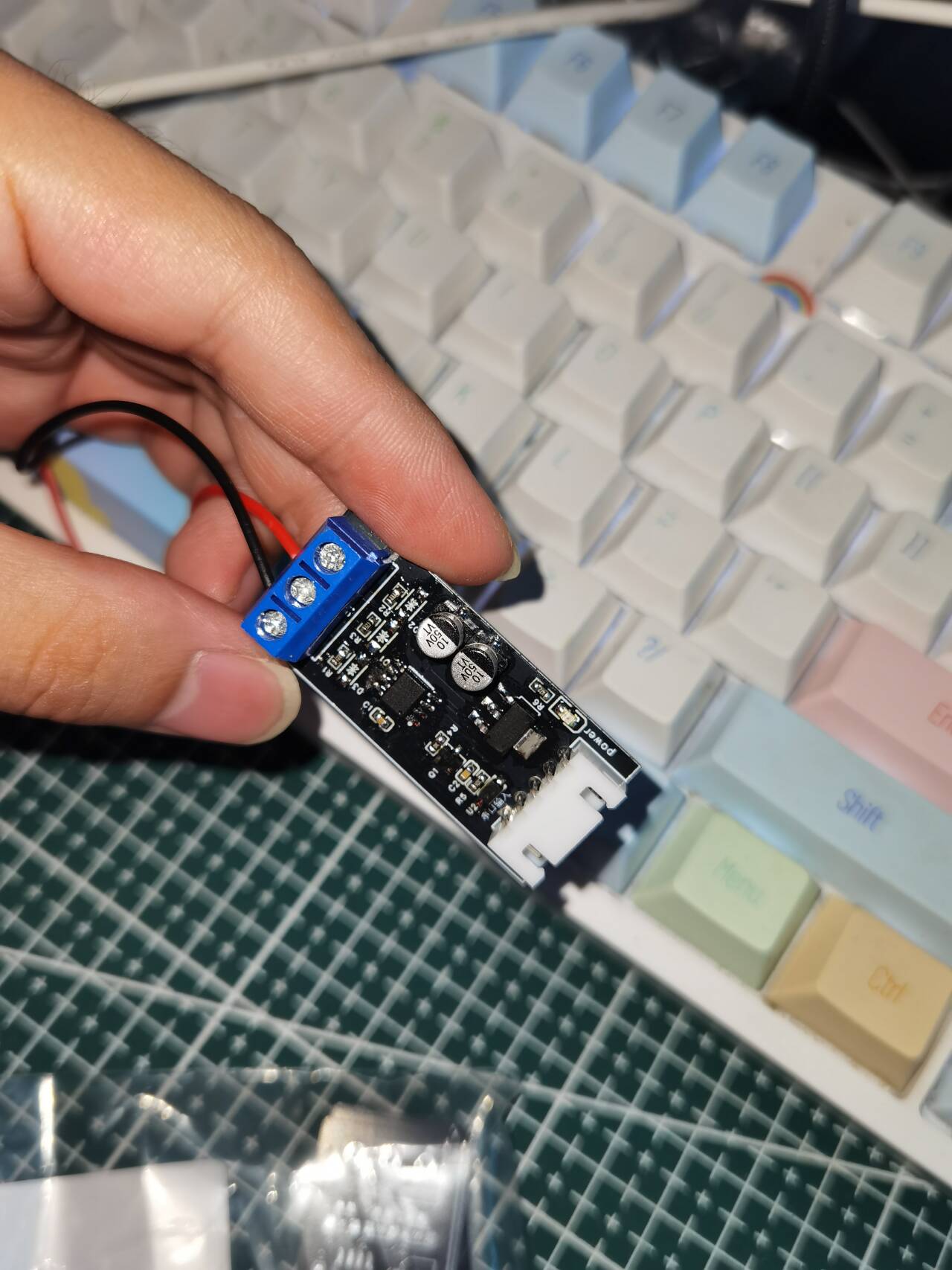

RS485 module with TVS protection based on TP8485 chip for automatic determination of transmit and receive status.
Almost all RS485 communication chips require pull-up/pull-down resistors to the RE and DE pins to determine the transmit/receive status of RS485 communication.
In project development, this would occupy a pin on the microcontroller. Therefore, a transistor is used in this circuit for level selection to determine the transmit/receive status. This transistor automatically selects the transmit/receive status based on the RX pin;
this has been verified.

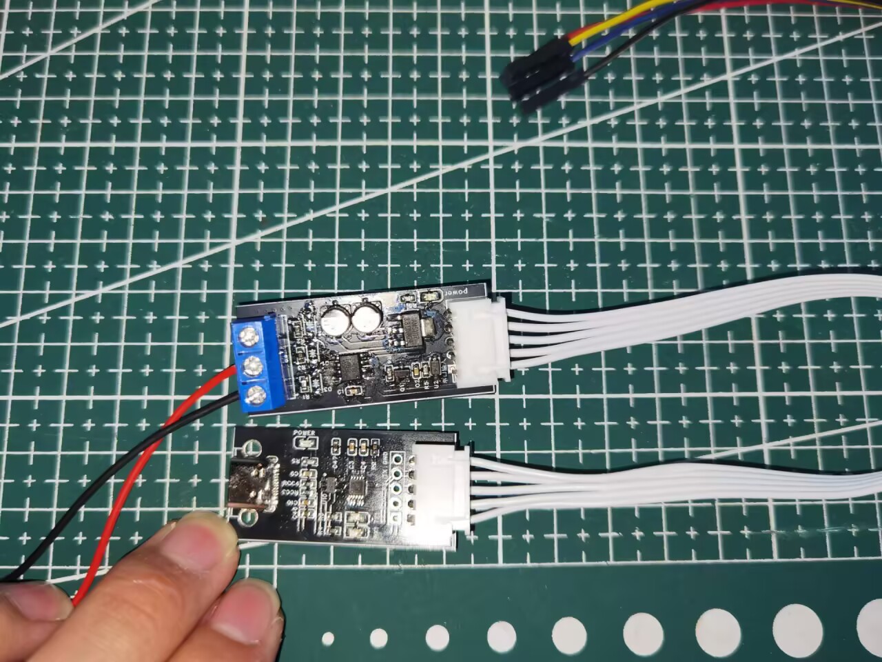

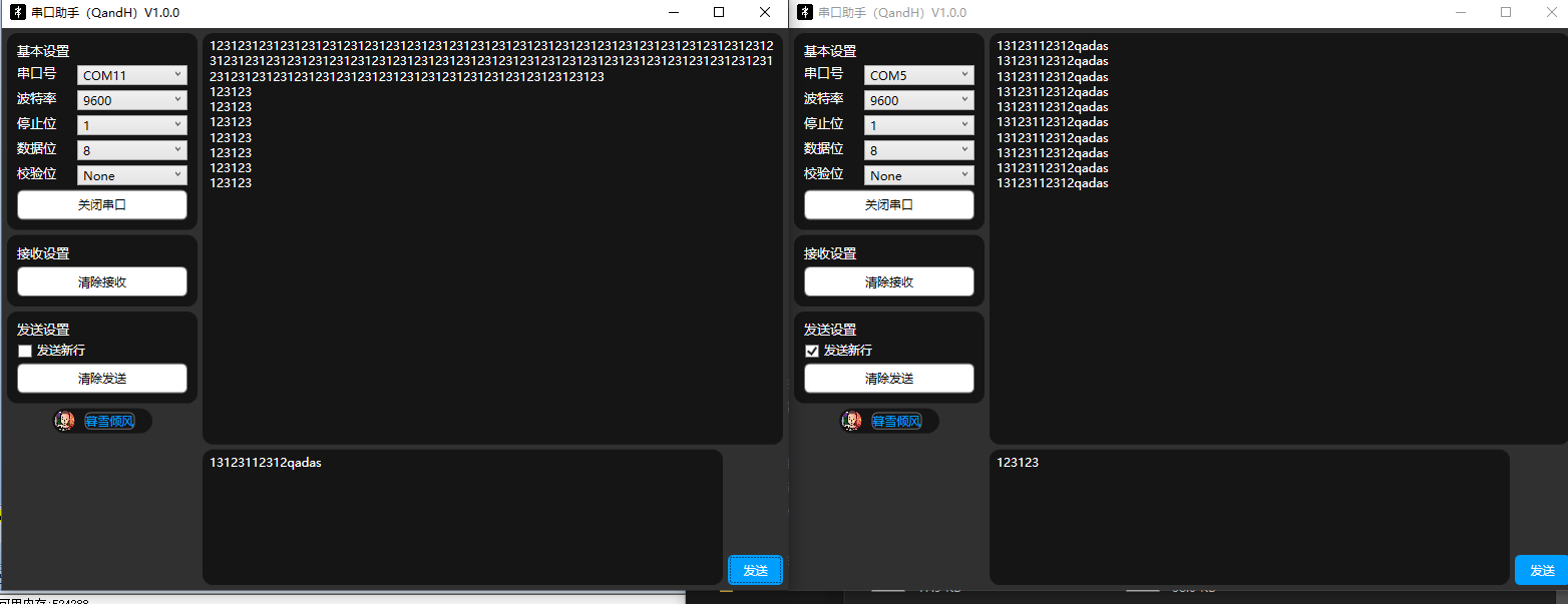

The module's 5-pin connector is directly compatible with my designed serial port module and development board, and can be directly plugged into the 5-pin interface of my designed serial port module or development board.
Physical
demonstration and test results are provided.
