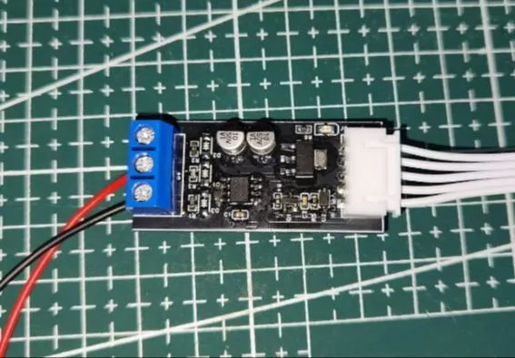

TP8485 485 module with protection and automatic transmit/receive determination
Almost all RS485 communication chips require pull-up/pull-down resistors to the RE and DE pins to determine the transmit/receive status of RS485 communication.
In project development, this would occupy a pin on the microcontroller. Therefore, a transistor is used in this circuit for level selection to determine the transmit/receive status. This transistor automatically selects the transmit/receive status based on the RX pin;
this has been verified.
The module's 5-pin connector is directly compatible with my designed serial port module and development board, and can be directly plugged into the 5-pin interface of my designed serial port module or development board.
Physical
demonstration and test results are provided.
