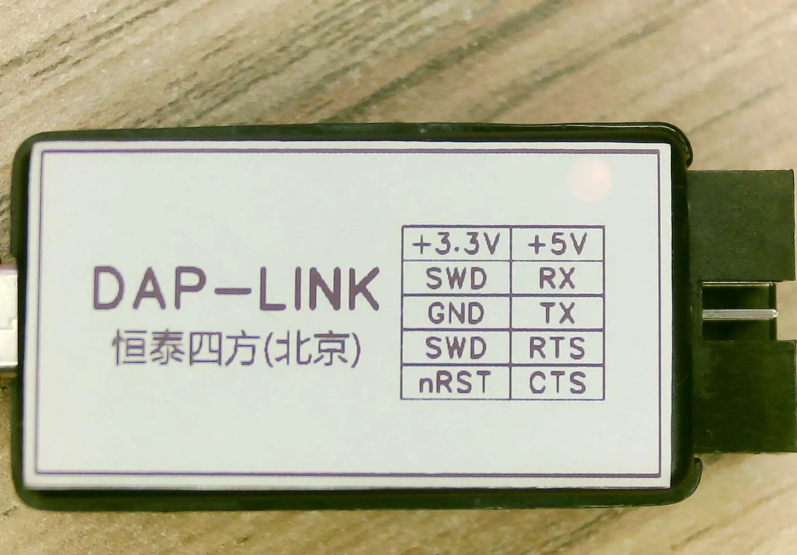

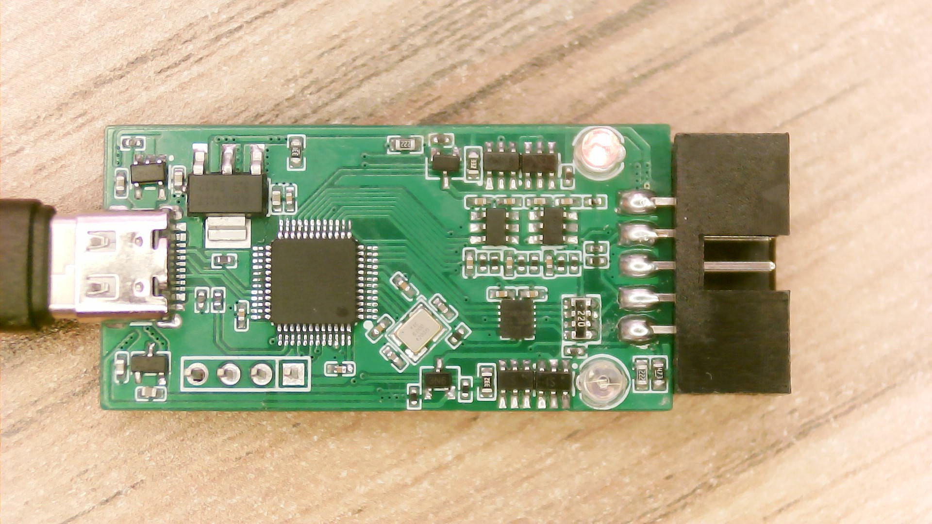

DapLink
1. SWD interface supports adaptive target board voltage (1.8V, 3.3V, 5V). 2. USART interface supports adaptive target board voltage (1.8V, 3.3V, 5V). 3. Data interface features bidirectional Schmitt buffer drive, high speed, and high stability. 4. Automatically identifies SWCLK and SWDIO pins, eliminating the hassle of pin location. 5. TYPE-C interface supports interface current limiting protection. 6. High-speed SWD interface supports stable 10MHz high-speed programming. 7. High-speed USART interface achieves communication rates up to 4.5Mbps with no packet loss when the target board uses a crystal oscillator. 8. Supports drag-and-drop programming (only one target is supported; please leave a message specifying the required target CPU model). 9. Supports offline automated programming, suitable for mass production in factories. (Target CPU model required; maximum firmware support is 35K).
