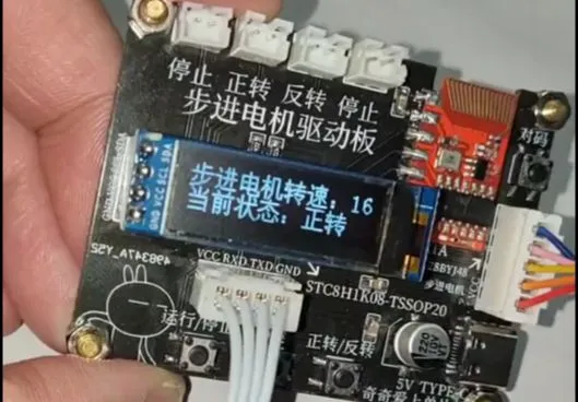

Stepper motor driver board with 433 controller
DC5V 4-phase 5-wire stepper motor 28YBJ-48 28BYJ48 Geared stepper motor
diameter: 28mm
Voltage: 5V
Step angle: 5.625 x 1/64
Reduction ratio: 1/64
Single weight: 0.04KG
5-wire 4-phase can be driven by a common ULN2003 chip.

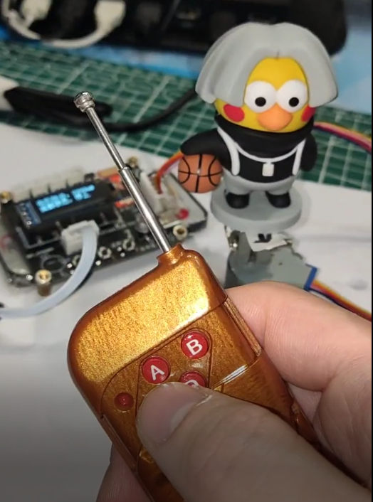

Hummingbird Wireless "Ling-R1A"
A. Learning Pairing Code: After powering on, quickly double-click the S1 button. The work indicator light will start flashing, entering the setting mode. In this mode, triggering any button on the remote control will cause the work indicator light to light up for about 1 second, indicating successful pairing. After pairing is complete, wait 10 seconds without any remote control activity, then automatically time out. B. Clearing All Remote Controls: After powering on, press and hold the S1 button for more than 8 seconds, then release the button to clear all learned pairing codes.
//The source code and PCB layout for the above projects are publicly available. Search for the username "Qiqi Loves Microcontrollers" on the "LCSC Open Source Hardware Platform".//Microcontroller model: STC8G1H08 1. When programming, be sure to select built-in IRC=30MHz. 2. Set the reset pin to the IO port. 3. Uncheck the option to erase the user EEPROM area when downloading the user program
