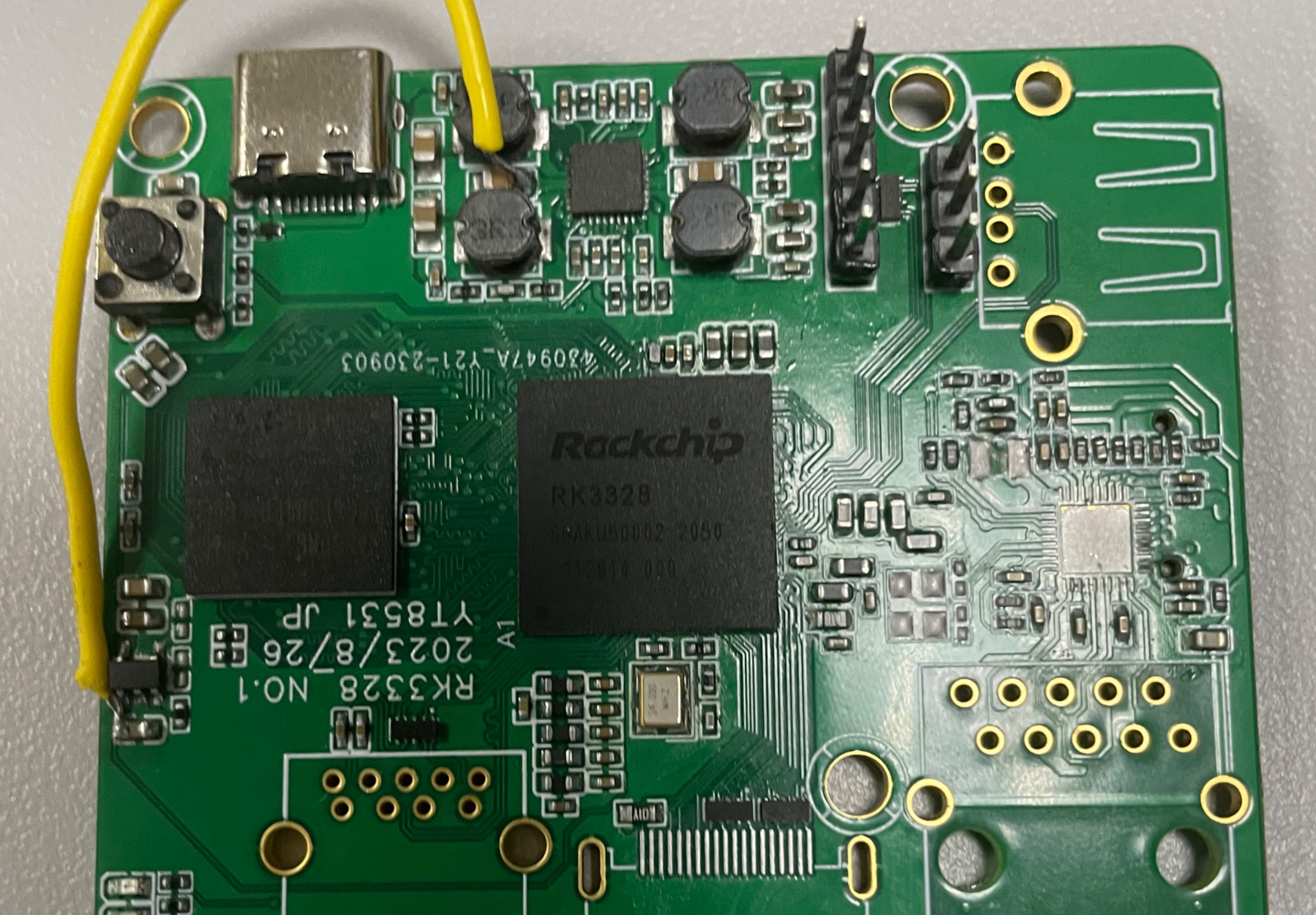

Rockchip RK3328 small board
The schematic is still based on Xunlong, but one gigabit Ethernet port has been removed and replaced with USB 3.0.
DDR runs without problems
, but there are some issues with burning the R1 system. It can enter the kernel start stage, but fails to boot, reporting a network card
problem:
YT8531 Ethernet is not working;
LPDDR3 1.8V is not connected;
TF card 3.3V is not connected.
