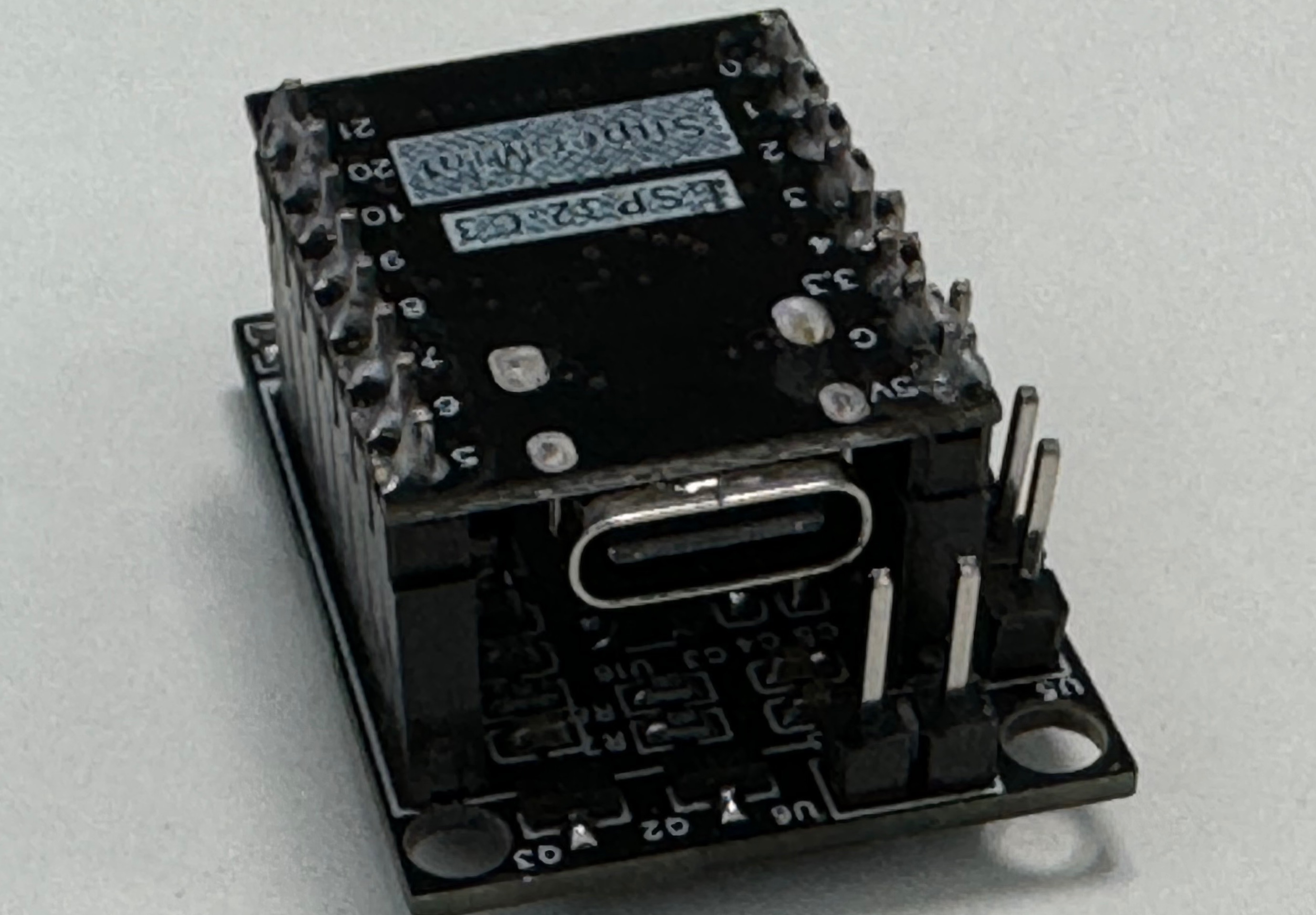

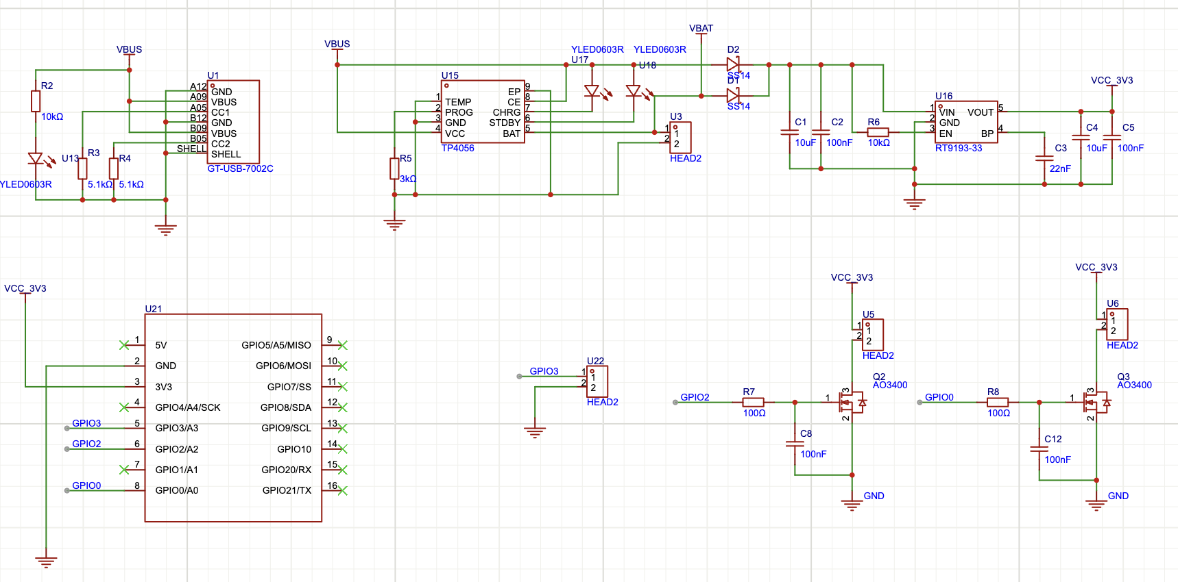

TP4056 lithium battery charger + ESP32C3-supermini board
Project Introduction
: This section provides a basic introduction to the project. Example:
This project is based on the ESP32C3-Supermini circuit board. It can be powered by a single lithium battery or by USB-Type-C. It provides two GPIO MOS switch ports and one ADC port for external interfaces, facilitating remote switching and control.
Design Principles (Hardware Description):
This section details the project's design principles, breaking them down. Example:
It uses a single lithium battery charging module (TP4056) and an RT9193-33 LDO to convert the voltage to 3.3V to power the ESP.
Combined with the 5V USB-Type-C port, it can be powered by USB or a battery alone
