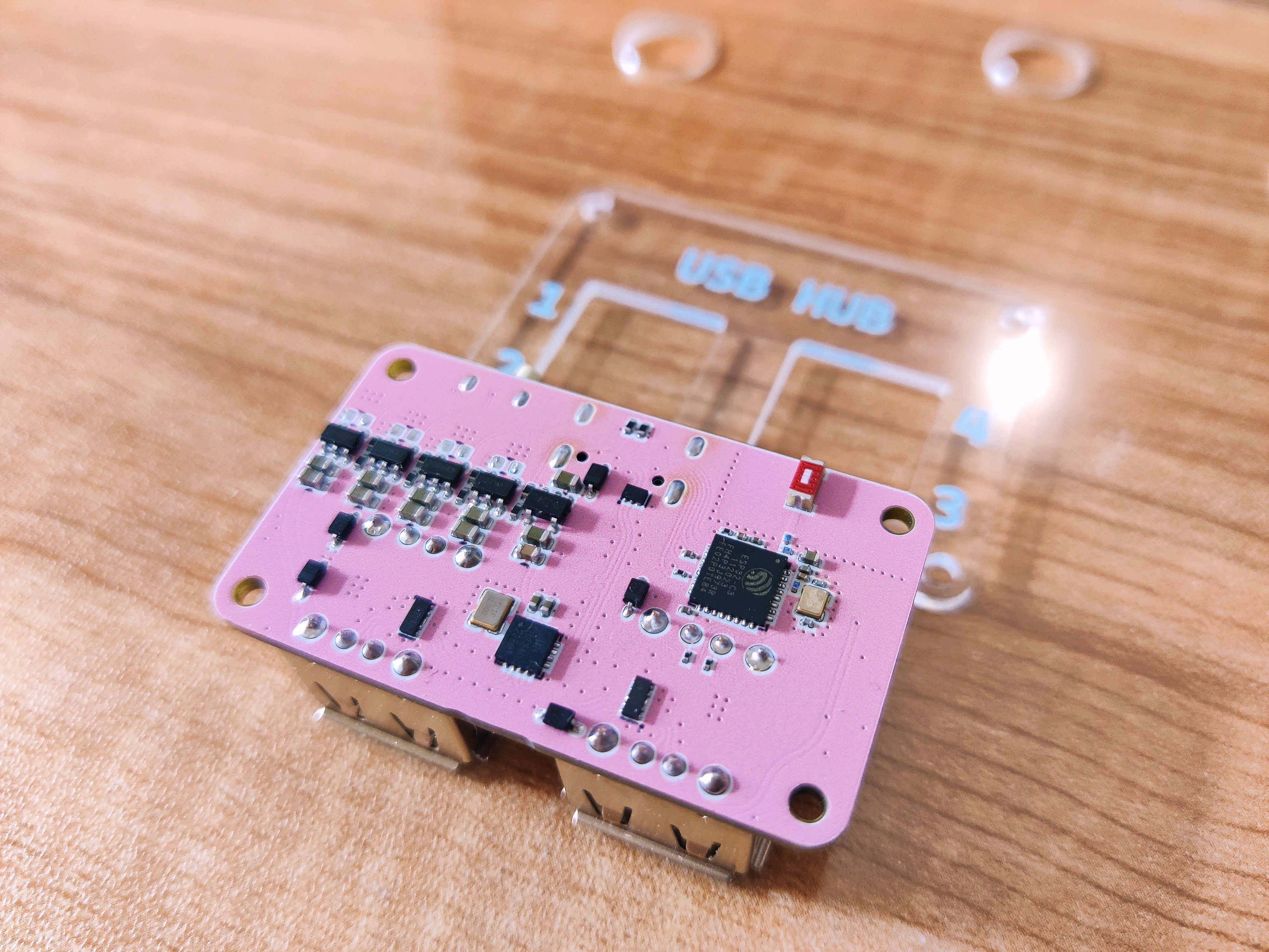

Hardware Specifications
: Main Control Chip: ESP32-C3, providing WiFi wireless communication;
USB HUB Chip: CH334P, used to expand USB ports;
Electronic Load Switch: MT9700, each USB port independently limits current to 680mA, protecting devices from overcurrent damage.

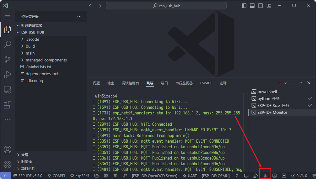

This project uses ESP-IDF, which requires you to enter the Bafa Cloud private key in sdkconfig and compile it yourself.
Press and hold the button while plugging in the USB to enter Bootload for programming. After programming, use SmartConfig for network configuration (press and hold the button for 5 seconds to reconfigure). A one-click network configuration mini-program can be used in the lower left corner of the Bafa Cloud WeChat official account.
The USB pins of the ESP32-C3 are connected to the first port of the USB HUB via a 0R resistor, which can be removed after programming.

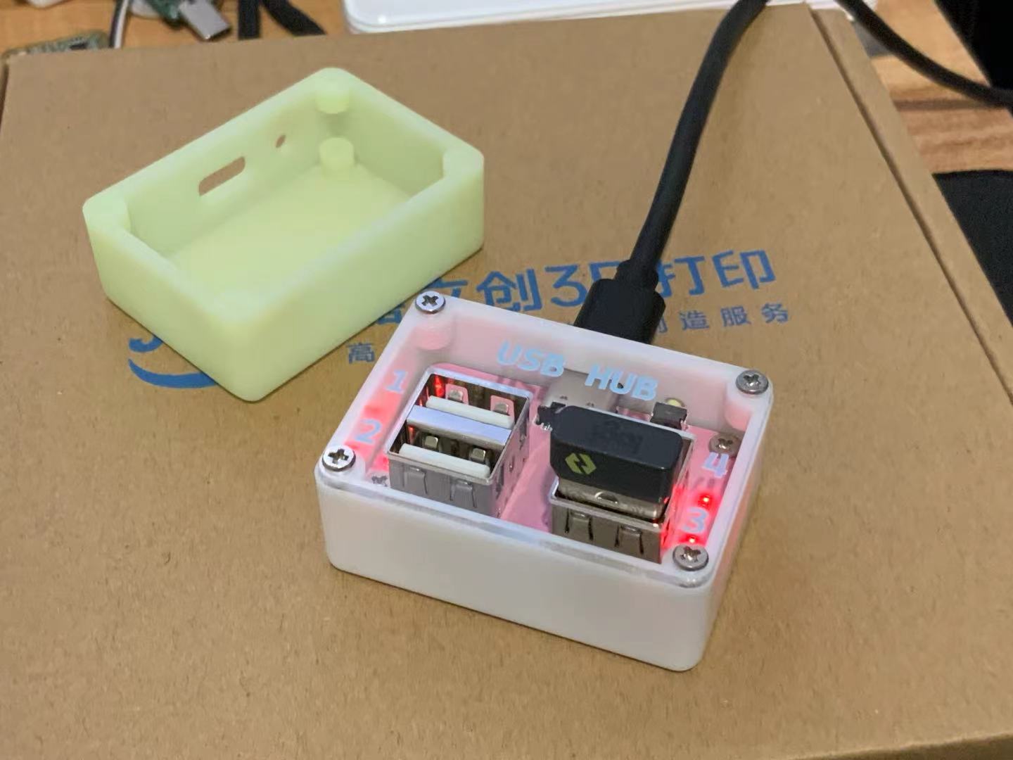

PCB Specifications: Board thickness 1.6mm, acrylic panel thickness optional 1mm or 1.5mm.
Screw type: M2x5x4 flat head Phillips head self-tapping screws.

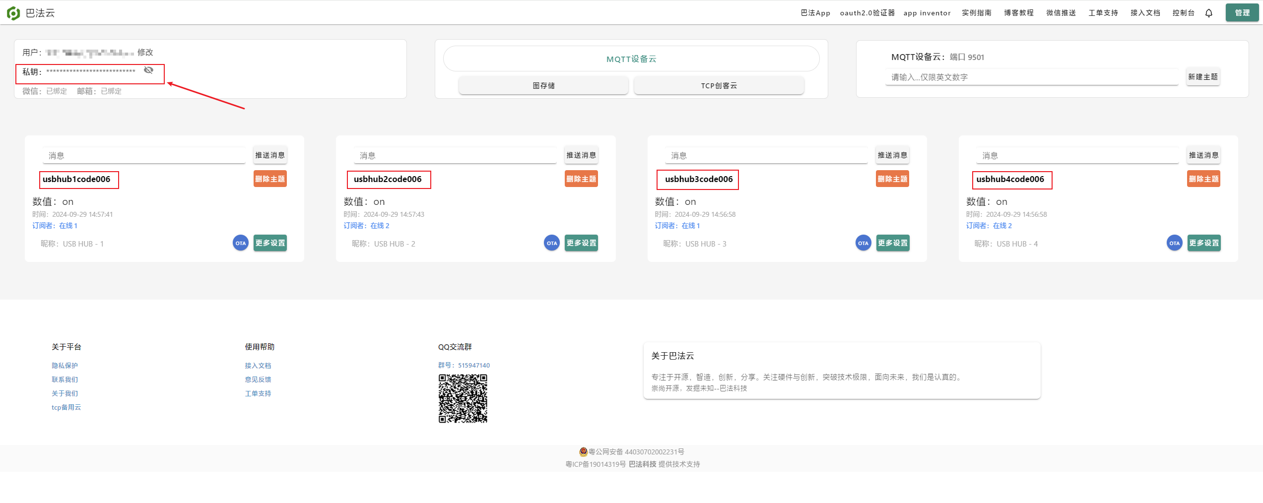

: 1. Buffalo Cloud Configuration:
https://cloud.bemfa.com/tcp/devicemqtt.html
Create 4 MQTT topics:
usbhub1code006
usbhub2code006
usbhub3code006
usbhub4code006

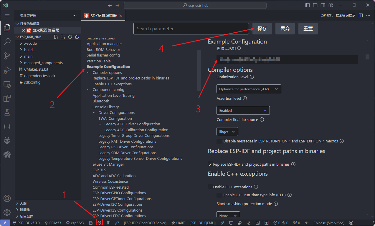

2. Copy and paste the Buffalo Cloud private key into the ESP-IDF SDK configuration editor.
3. Compile and flash. Special
