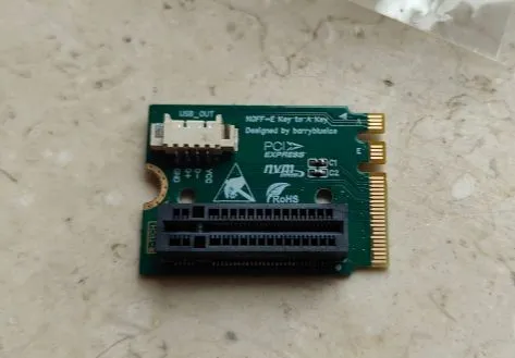

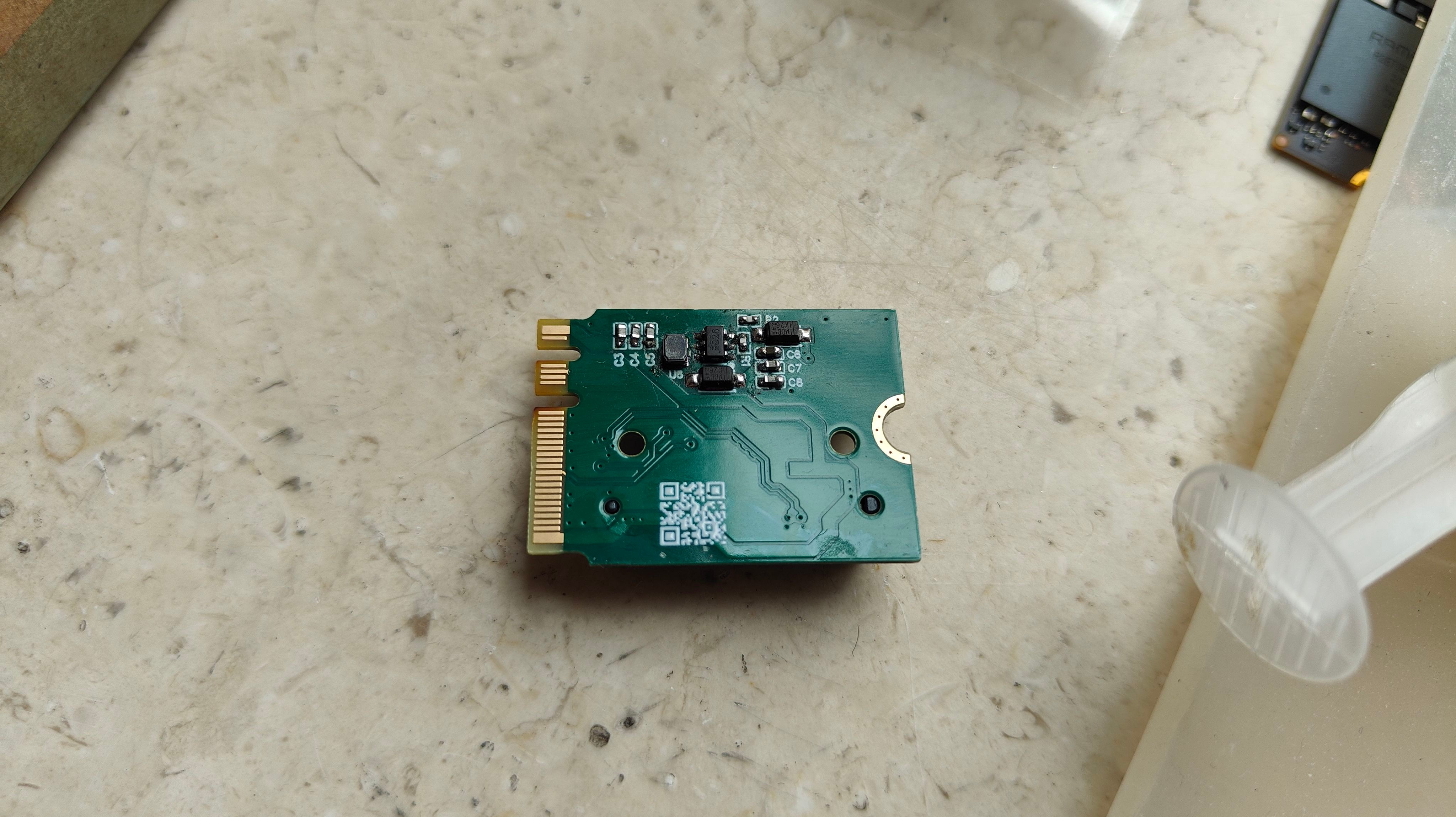

This was a project I made out of boredom. My ASRock H670 PG motherboard for servers has a really weak WiFi port, so I decided to make a vertical adapter to convert it to an NVMe SSD.
The SSD only uses the X1 routing definition, theoretically allowing negotiation up to PCIe 3.0*1 and backward compatibility.
The board has an MX1.25 USB port (originally for a network card and Bluetooth), which can be used with other USB devices.
Important notes:
CNVio interface is not supported. Please check if your motherboard's WiFi port supports PCIe network cards before use.
Please check if your motherboard's WiFi port natively supports Bluetooth. If Bluetooth requires an additional cable, the USB port will be unavailable.
Regarding design, prototyping, and manufacturing:
Updated 2024.11.10:
Four-layer board design with two complete ground planes, impedance control.
Designed with 50Ω single-ended impedance and 85Ω differential impedance. Effectively fixed the severe speed drop issue of the previous generation during large read/write operations (suspected to be caused by excessively loose impedance).
When customizing the PCB, you can use a four-layer free immersion gold coating voucher, 0.8mm thick. For impedance requirements, please select JLC04081H-3313.

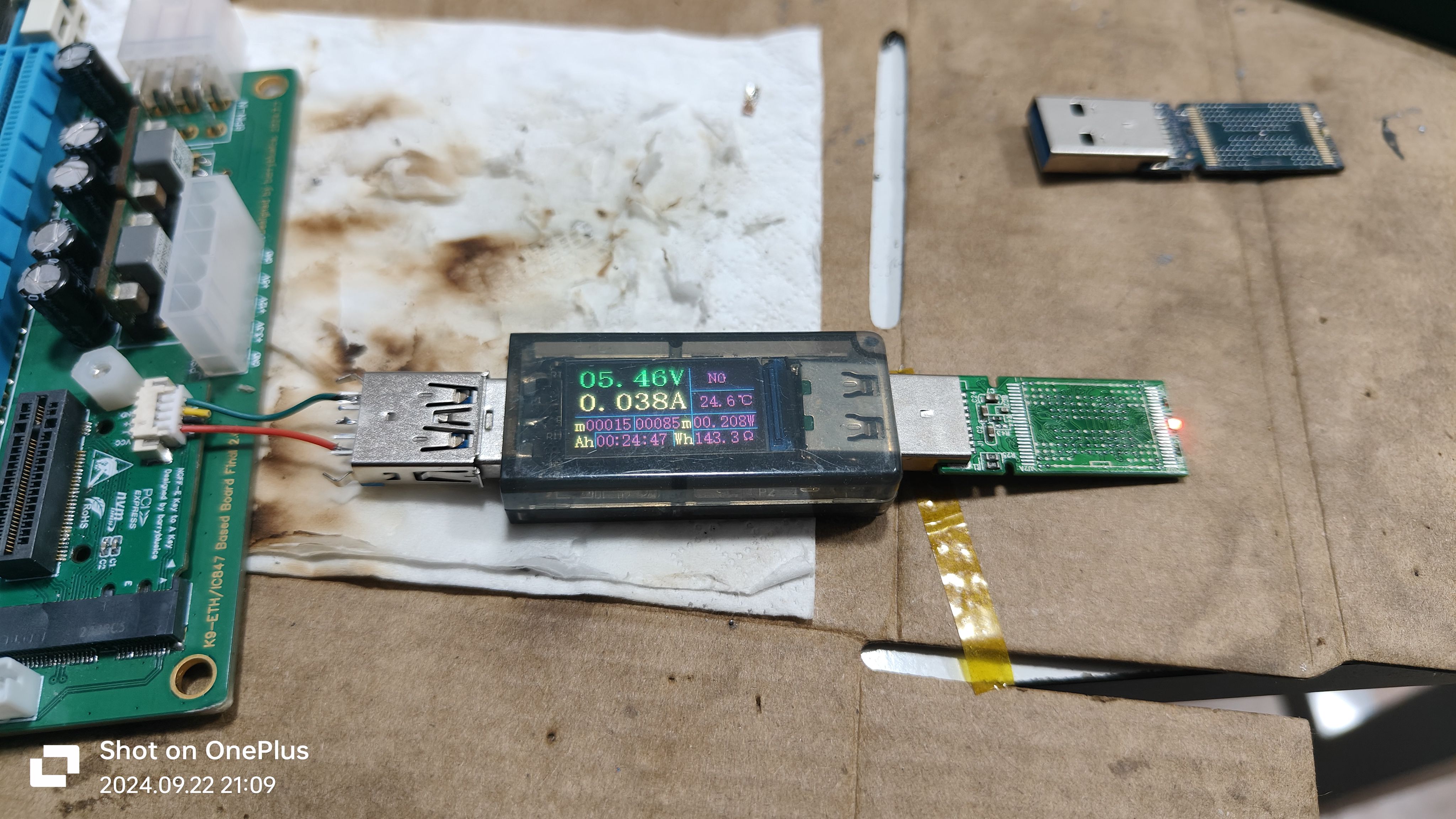

The USB 5V boost circuit uses SX1308, and actual testing shows it can output 5.5V.
The vertical NGFF M-key can be purchased from this store on Taobao or Alibaba.
There are two through holes on the back of the socket, which can be used for hard drive brackets (which can be made by yourself).
Currently compatible with:
ASRock H670 PG Riptide (I'm using it, tested and working)
, ASRock Z690 PG4 (same design as H670 PG Riptide, just different chipset),
Maxsun Z690 Terminator

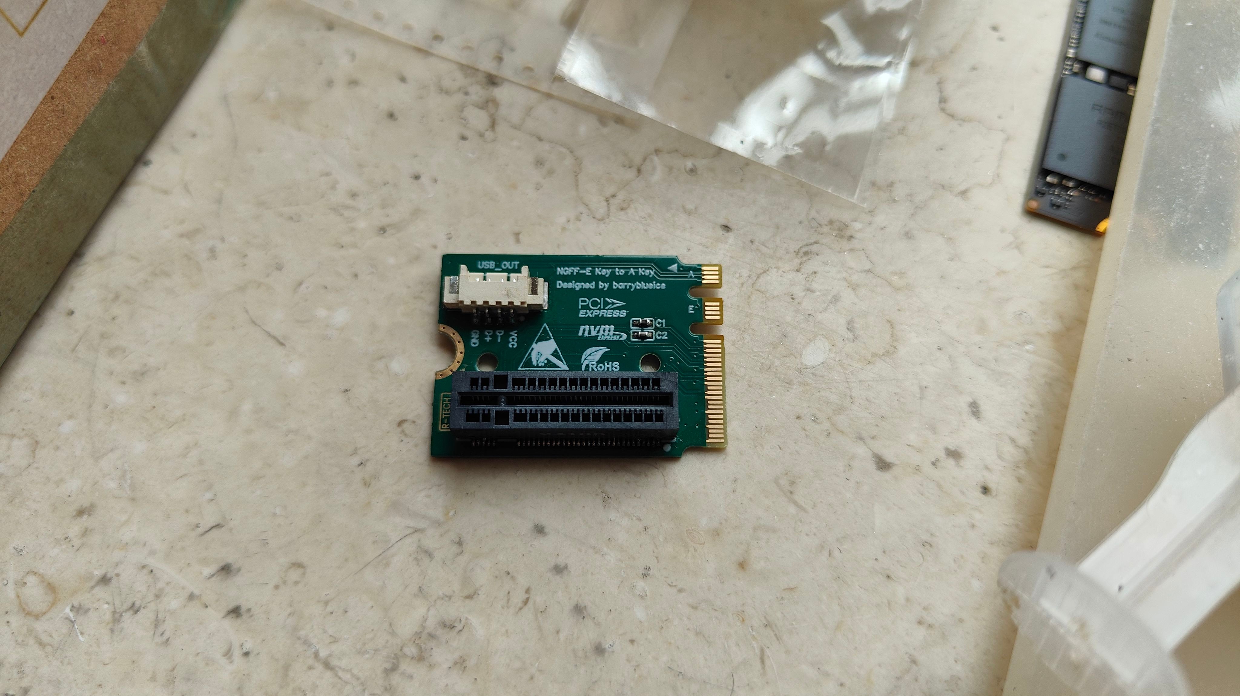

Soldering demonstration (please be gentle with your soldering skills):
Front:
Back:

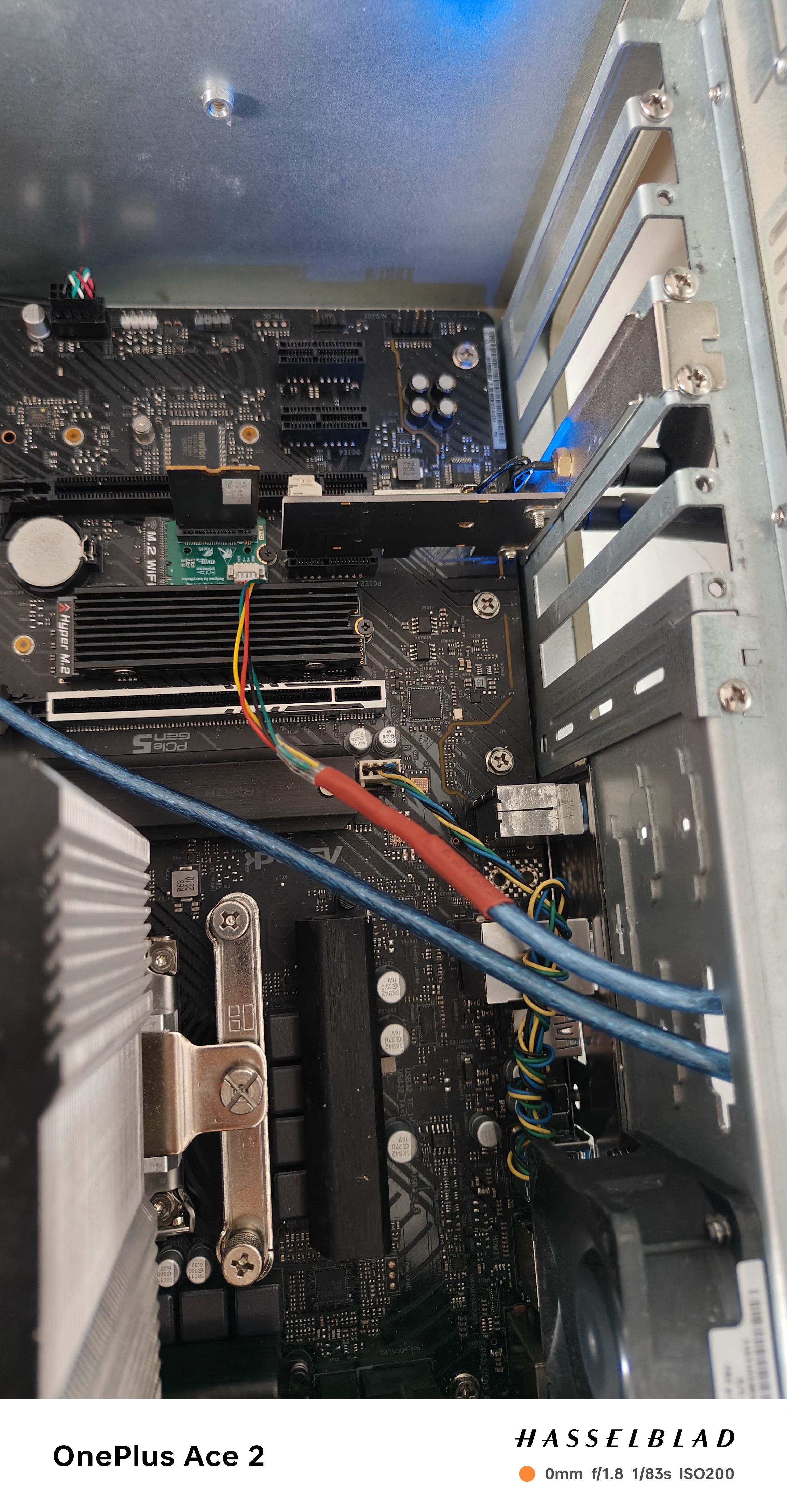

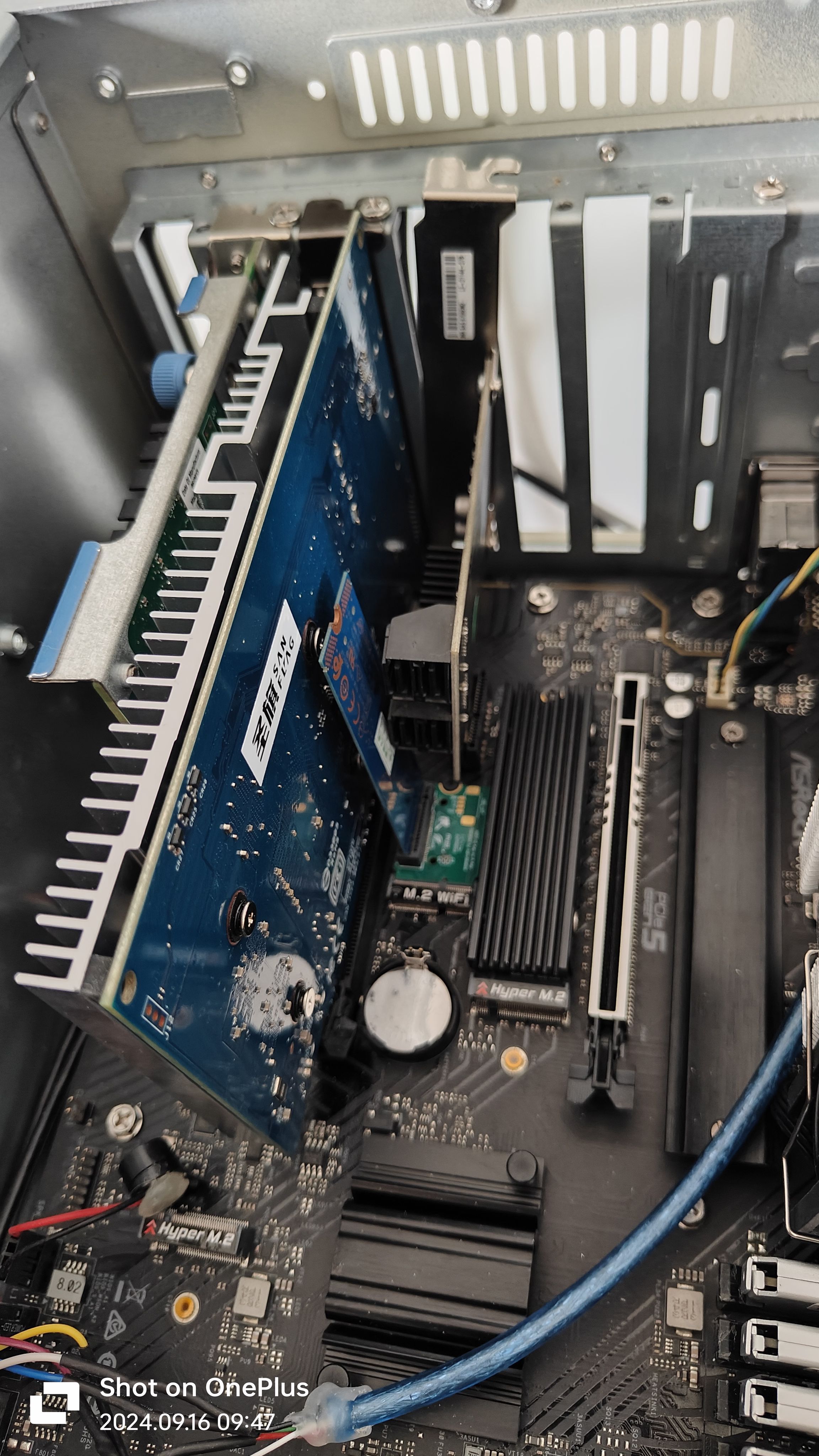

Physical compatibility test:

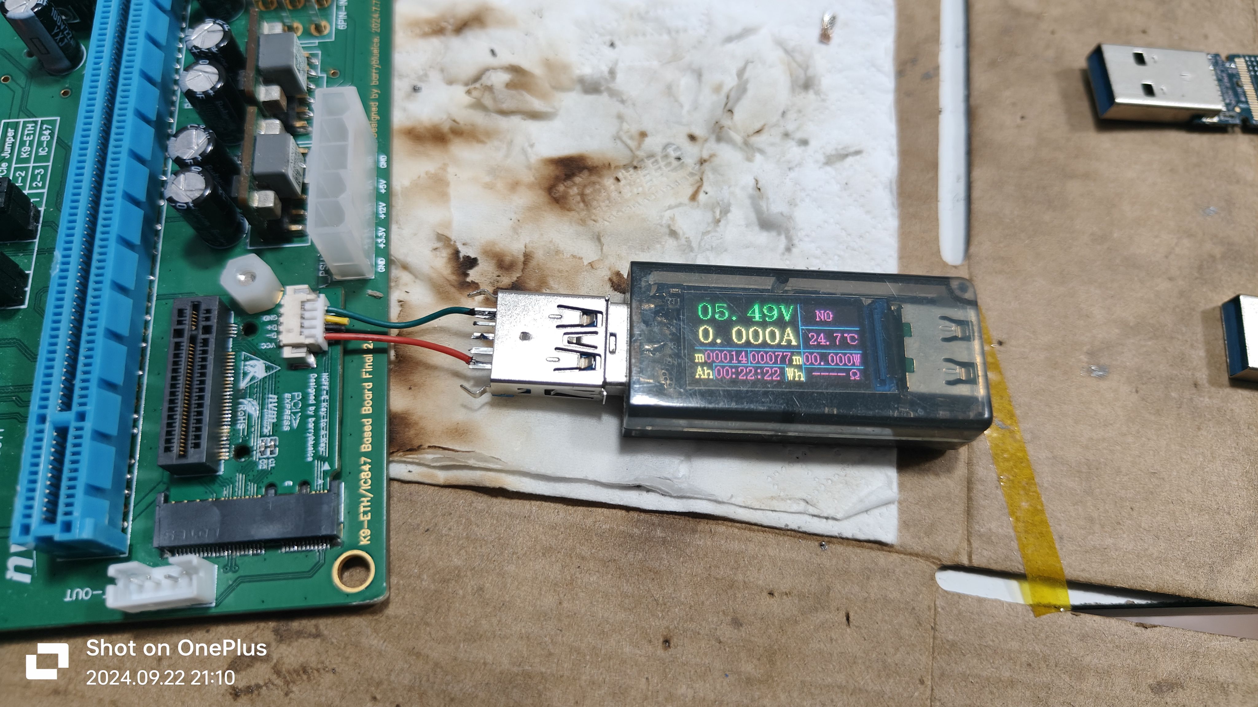

USB test:
Idle state:
Light load state:
Tested on-machine:

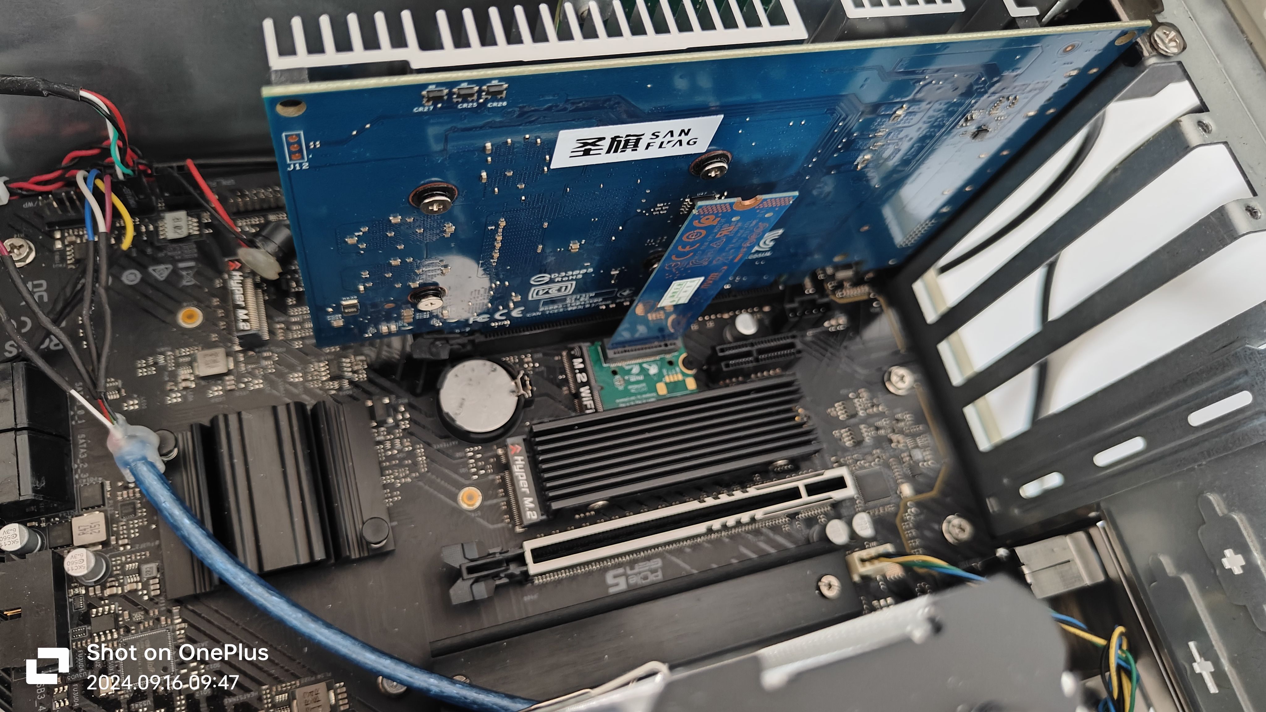

NVMe SSD test:
Hynix BC501 (2230 length):
Test with 2280 length Intel Optane 16G SSD:
Some smaller cards, such as RTL8125-BG expansion network card, are compatible under physical installation:
When replacing with a PCIe to four-port SATA expansion card, due to internal interface issues, conflicts may occur, so it is recommended to install some shorter length SSDs such as 2230, 2242, or smaller cards:
System test:
CPU: Intel® Core™ i3-12100F
Memory: 4 x Kingmax Silver Star Changxin DDR4 8GB 3600MHz
Motherboard: ASRock H670 Riptide
System: Windows Server 2025 for DataCenter 26100.1742

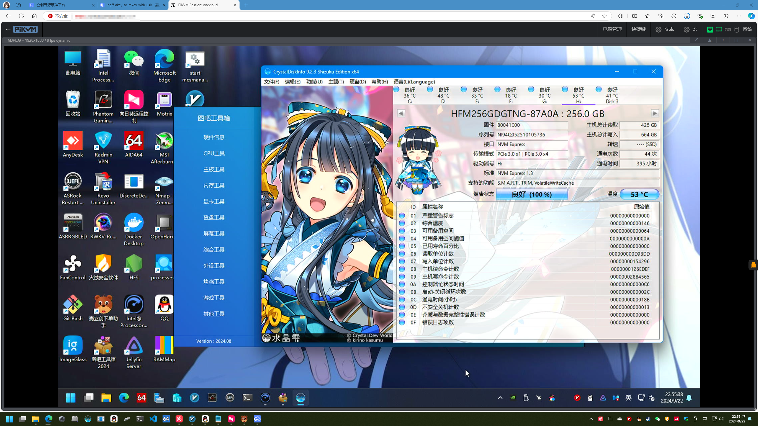

Test Hard Drive: Hynix BC501 256GB

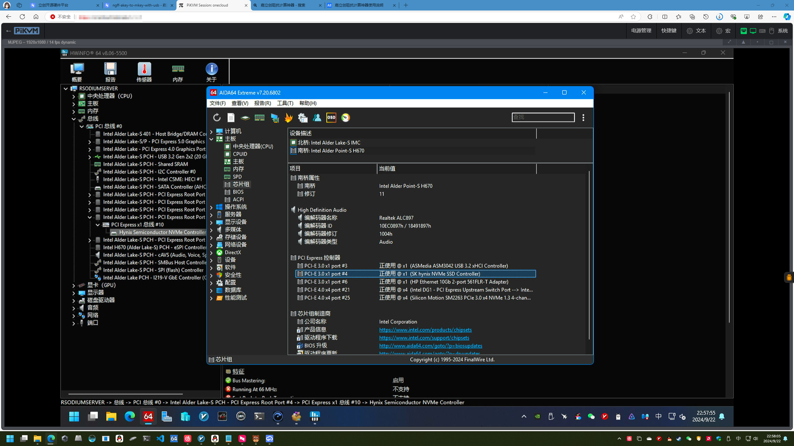

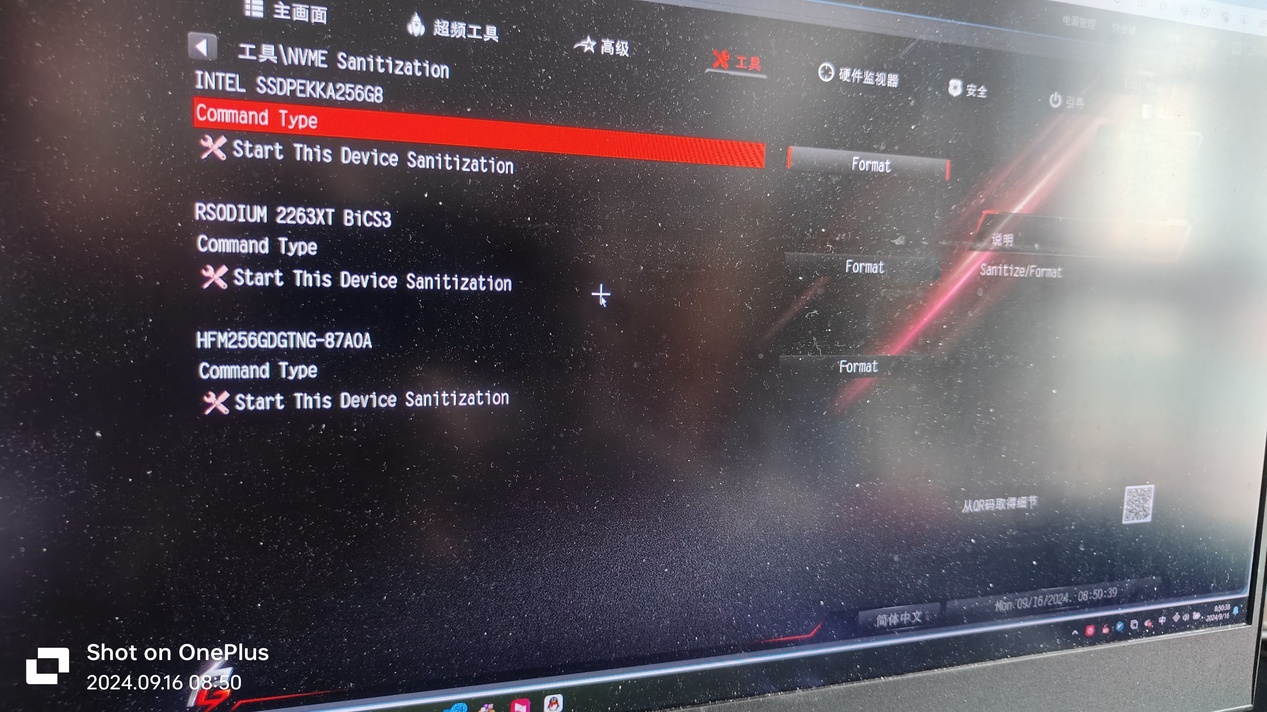

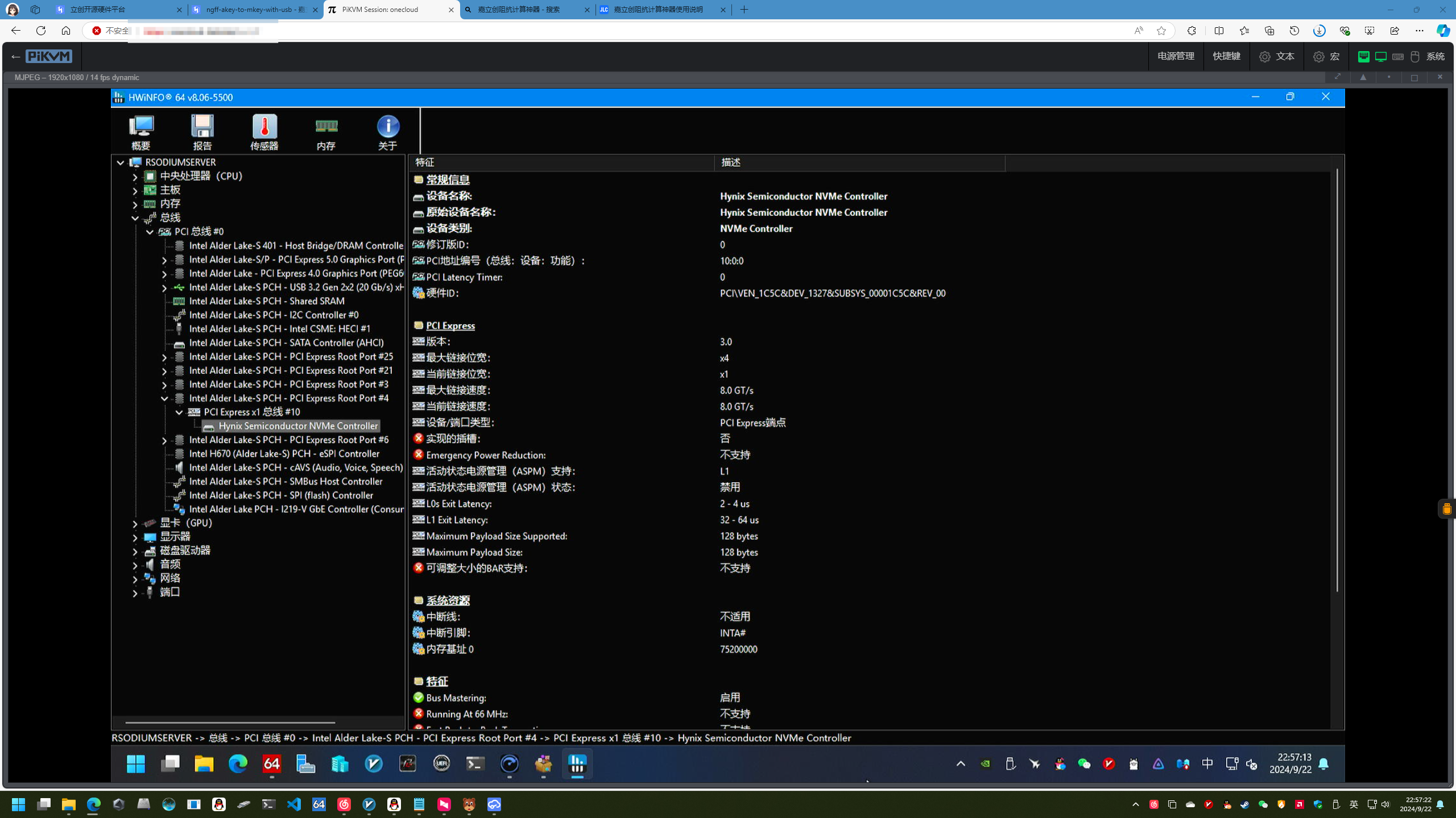

BIOS cannot recognize which NVMe drive it is, but it does recognize that it is an NVMe drive:
Crystal Disk Info, AIDA 64, and HWiNFO64 tests show that the BC501 has successfully negotiated PCIe 3.0*1:

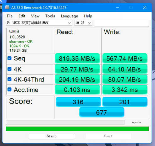

AS SSD speed test (test drive AM521):

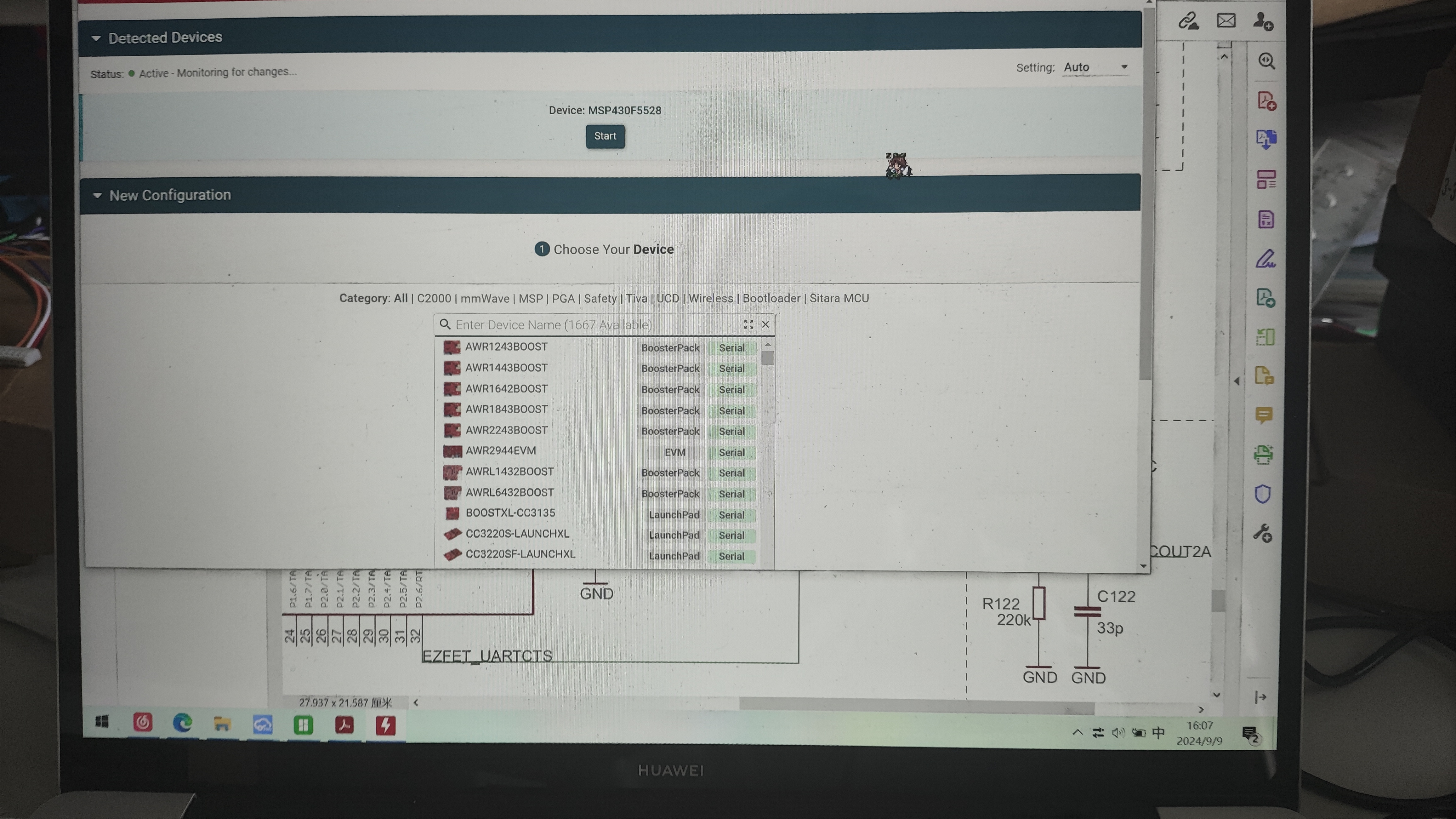

Find a programmer capable of programming the 5528 chip. The LaunchPad's onboard eZ-FET-Lite or FET430UIF will work. Connect it to the prepared board using the following connection method: SBW-RST --> RST; SBW-TST --> TEST; 3V3 --> 3.3V; GND --> GND.
Install the UniFlash tool on your computer.
Download the firmware package from the attachment; any of the three firmware options are acceptable.
Open UniFlash, select the MSP430F5528 chip and connector. The first connector should be selected by default. (For the current version, there's an auto-detection option at the top. If auto-detection is enabled and the programmer is properly connected to the microcontroller, it will automatically recognize the target microcontroller. Just click on it (as shown in the image, simply click START to enter).) On the Settings & Utilities page, find the Erase section and click Mass Erase. Wait for the erase to complete. (Do not click EraseByAddress. If you are using firmware with addresses 0x00-0x243ff or 0x4400-0x243ff as shown below, you can enter those addresses in Start and EndAddress to perform a full erase.)
In the Download section above, check Allow Read/Write/Erase access to BSL memory. Return to the Program page,
select the firmware you just copied in Flash Image(s), and click Load. After uploading the firmware to Image and waiting for a successful upload notification
, disconnect the burning cable and plug the EV2400-F5528 with the burned program into the computer. At this time, the three signal indicator lights will light up first and then go out, indicating that the computer recognizes the EV2400. The reported VID-PID is normal and can be recognized by the upgrade software.

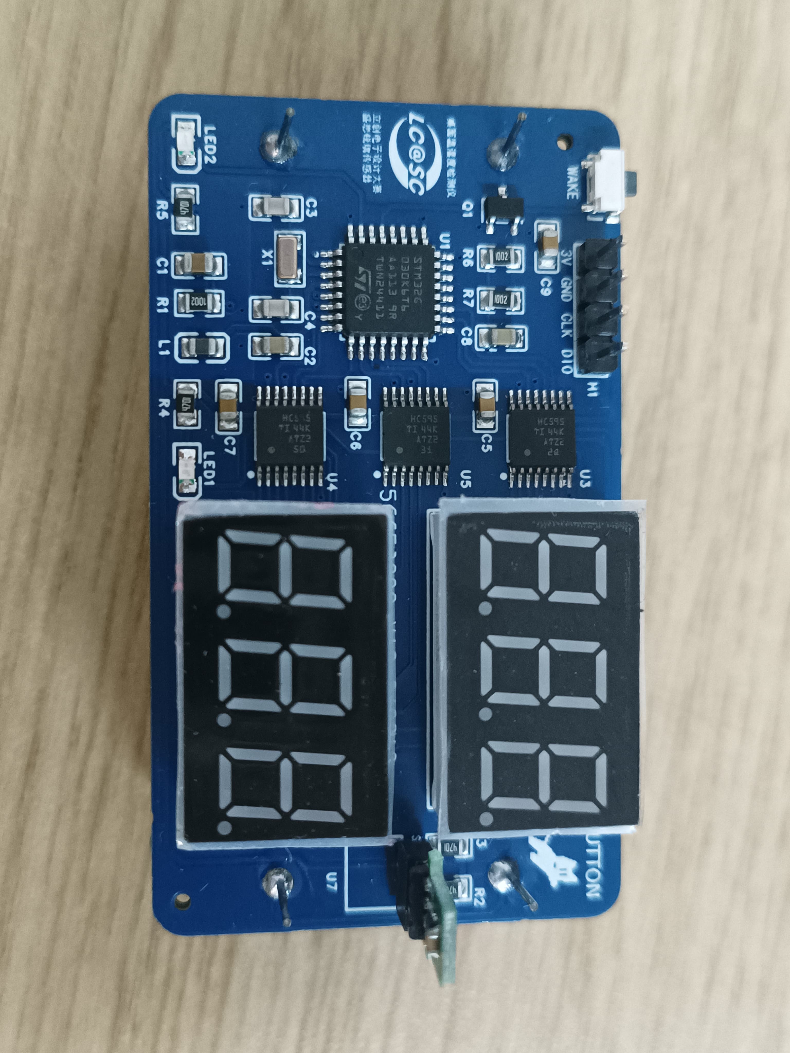

I. Project Overview
This project aims to design and implement a simple desktop temperature and humidity meter based on an STM32 microcontroller. This meter accurately measures the temperature and humidity of the surrounding environment and displays the data intuitively on a screen, providing users with real-time environmental information.
II. Hardware Components
STM32 Microcontroller: As the core of the system, it is responsible for data acquisition, processing, and control display.
Temperature and Humidity Sensor: A temperature and humidity sensor module is selected to accurately measure ambient temperature and humidity and transmit the data to the STM32.
Display Screen: A digital tube display is used to show temperature and humidity data and other relevant information.
Power Supply Module: Two AA batteries provide a stable power supply for the entire system.

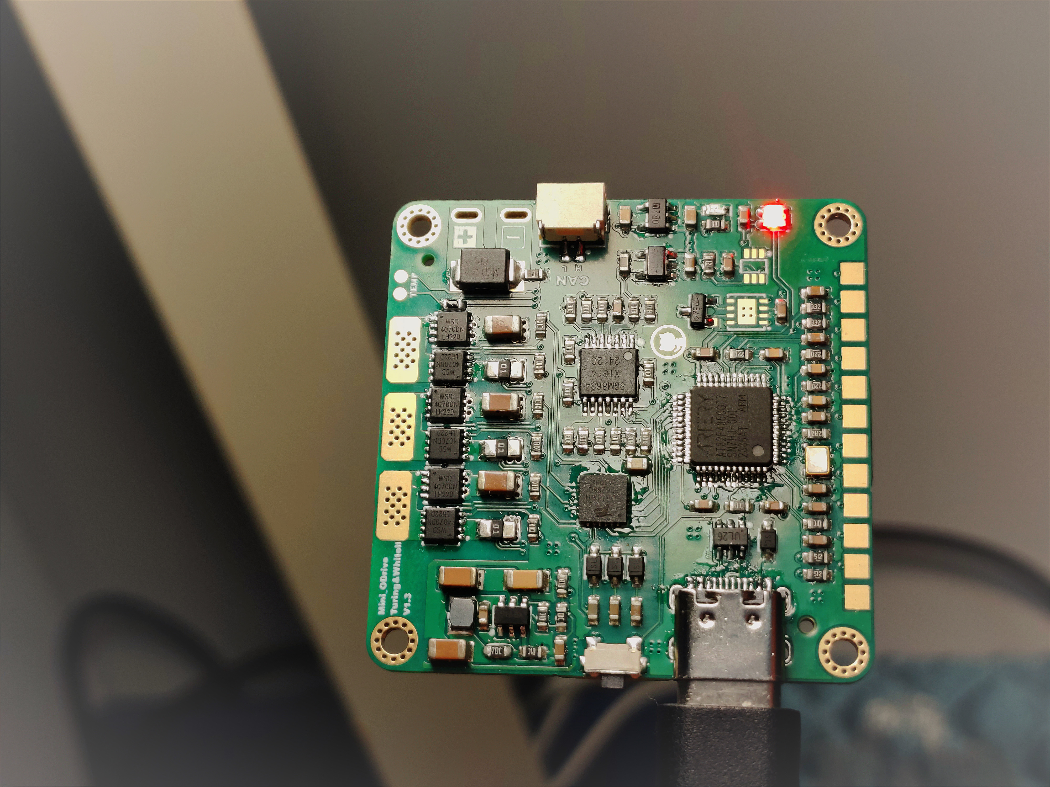

Mini_ODrive_AT32F435_42*42
The streamlined and optimized version of OFad has an overall cost of around 50 (onboard encoder). The main controller uses AT32F435, with a 24kHz current loop and an 8kHz speed and position loop, supporting both sensored and sensorless operation.
This document introduces
a streamlined and optimized version of ODrive, with an overall cost of around 50 (including the encoder). The main controller is an AT32F435, featuring a 24kHz current loop and an 8kHz speed/position loop. It supports both sensored and sensorless operation, with sensored support for MT6816, MT6825, MT6835, and AS5047P via SPI mode.
The code is primarily based on the latest version of ODrive, with secondary development and porting. It also includes ported VESC's observer and automatic open-loop components, MIT's encoder nonlinearity compensation (1024 points), and numerous optimizations and additions.
The host computer is mainly based on the ui_odrivetool project, with reference to some code from SimpleFOCStudio and VESC Tools.
Performance Parameters:
Voltage Input: 8-24V (2S-8S)
Temperature: -10-85℃
Peak Power: 240W
Control Rate: Speed/Position Loop 8kHz, Current Loop 24kHz
PWM Switching Rate: 24kHz
288MHz 32-bit AT32F435 Microprocessor
Peak Phase Current: 12A
Maximum Electrical Angular Velocity: 120000 ERPM
Size: 42*42mm - CAD Drawings/STEP Files
Communication: 1Mbps CAN or 115200bps UART
Reference Project Addresses:
https://github.com/odriverobotics/ODrive
https://github.com/vedderb/bldc
https://sourceforge.net/projects/phobia/
https://github.com/mjbots/moteus
https://github.com/bgkatz/motorcontrol
https://gitlab.com/p87942130/ui_odrivetool
https://github.com/JorgeMaker/SimpleFOCStudio
https://github.com/vedderb/vesc_tool
Related tutorials: https://www.bilibili.com/video/BV13XtseQEb3/
(This version is for group members; the open-source hardware is for reference. Firmware and host computer can be obtained by joining the group @ContradictionAggregator)
Notes:
This project only provides the packaged host computer file (.exe) and compiled firmware (.hex). The software part is not open source, please don't keep asking in private messages.
When soldering, note that the silkscreen of GS4157B-CR is very small, and a magnifying glass may be needed to assist soldering. Of course, it's okay not to solder it, but some functions will be lost.
The main controller uses a 288MHz AT32F435, and the power consumption and temperature are relatively high during operation, which is normal (estimated by hand to be about 40°C, no-load power consumption 0.8W).
The recommended MOSFET is WSD4070, and a 10-ohm gate resistor can be used. If other MOSFETs are used, the gate resistor may need to be replaced.
This project uses the RS724 op-amp, which is relatively expensive. You can choose a cheaper option like the RS624, a 4-channel op-amp that is pin-to-pin compatible.
The LP5907 requires a 3.3V power supply; make sure you buy the correct one.
For the dissipation circuitry, you can selectively solder it as needed; it's not mandatory.
I recommend buying the WS2812B RGB LED from Taobao. Different manufacturers produce these LEDs with significant differences, which may result in reversed red and green colors or random flashing.
The FD6288 on Taobao for 1.5 RMB is a used product; a brand new, original FD6288 costs 2.5 RMB or more.
That's all I can think of for now; I'll add more later.
