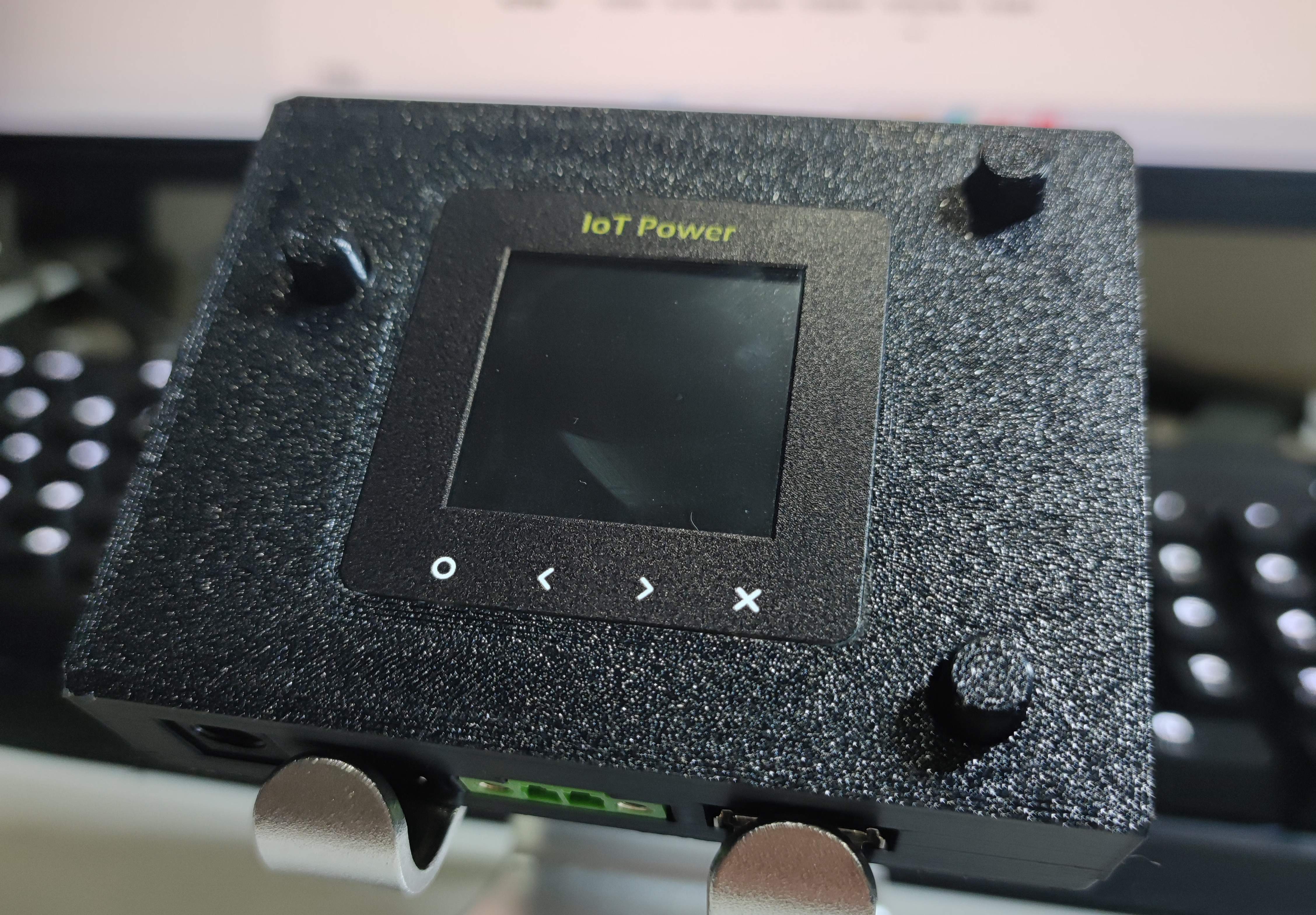

Hezhou CC Meter Simple Expansion Baseboard
Update:
June 16, 2024: V3 Update. 1. Added CH22K PD decoy circuit; DIP switch configurable input voltage. 2. Replaced push-button switch with toggle switch; fixed poor switch contact; increased current carrying capacity (V2 casing compatible with V3).
December 12, 2023: V2 Update; added input reverse connection protection circuit.
Self-use baseboard; simple function, used for device debugging and monitoring start-up current.
Design principle is simplicity and low cost, so not many functional circuits were added.
Three switches control input/output and the CC meter's power supply respectively.
The casing is magnetic, easy to disassemble and adjust functions by pressing buttons.
When the input is greater than 5V, the USB output is also greater than 5V. Pay attention to the input voltage when using USB
(casing file attached).
