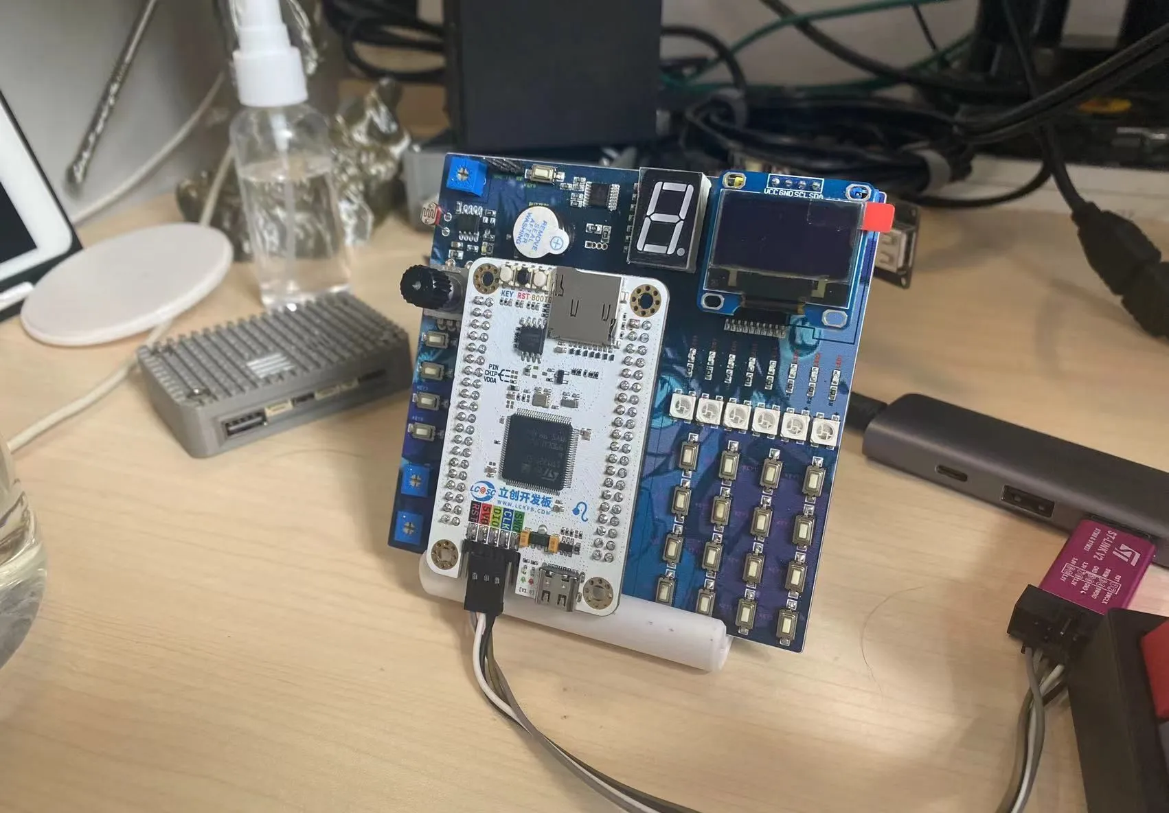

#Training Camp# STM32 Sky Star Expansion Board

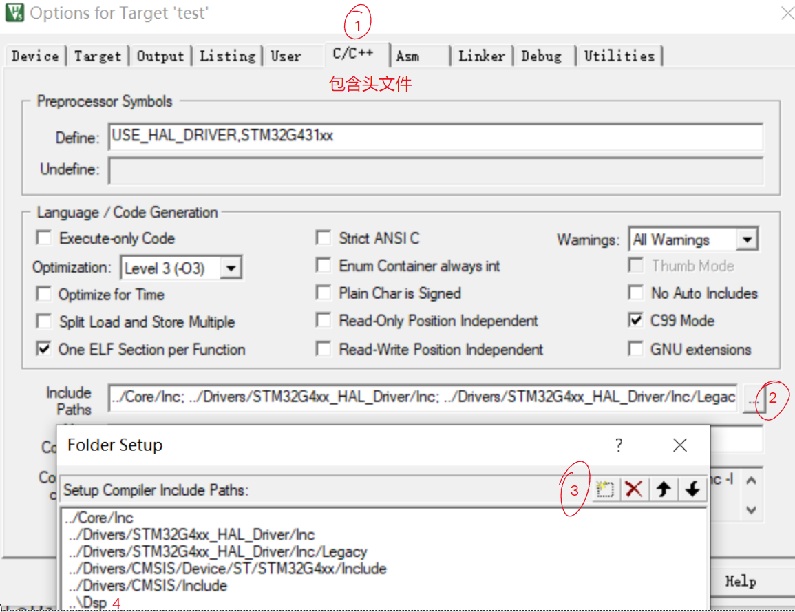

Keil5 configuration
September 9, 2024
11:02

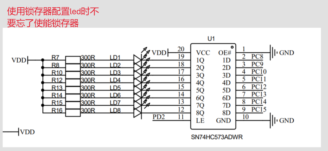

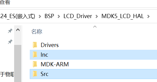

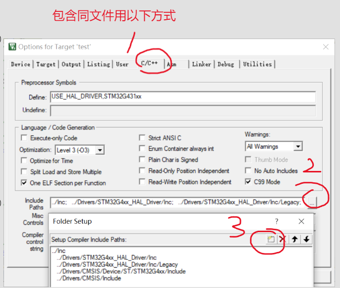

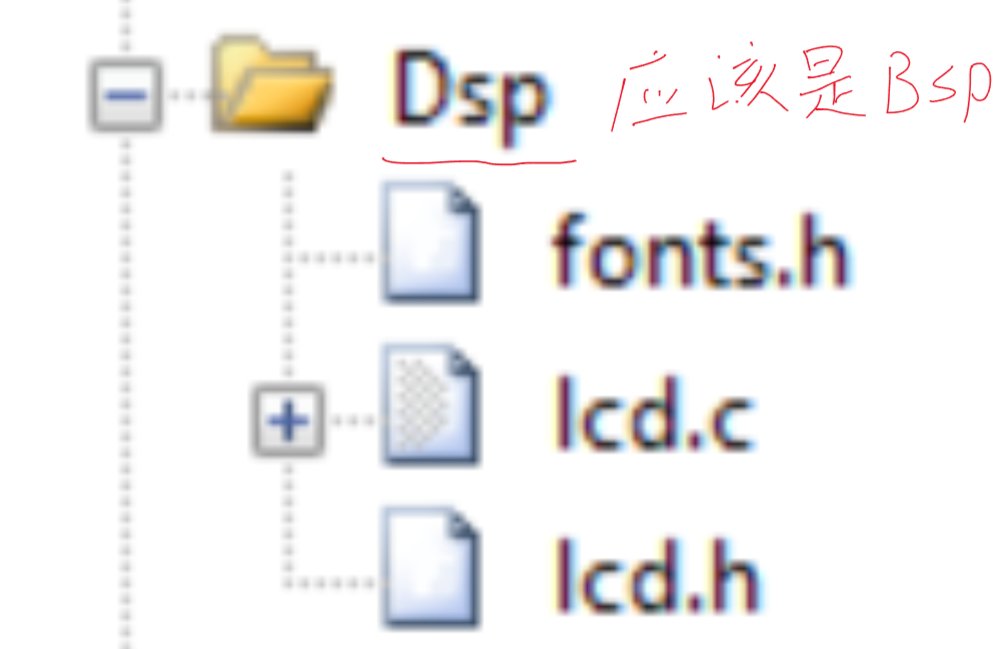

lcd driver (requires external import of related library files)
Put these three files into the group file of the created project (modular call is equivalent to)
LCD_Init(); // Initialize lcd
LCD_Clear(Black);// Clear screen and display initial background color
LCD_SetBackColor(Black); // Background color
LCD_SetTextColor(White); // Font color
char miao[10];
int hh = 0;
sprintf(miao," %d",hh); // Conversion function needs to include stdio.h header file
// Print the required content into the string
// I understand it as storing the hh integer data into the miao[] array, and then using the function pointer below to get the first address and input it to the next LCD_DisplayStringLine(Line1, (u8 *)miao);
// lcd screen character output function, line + content

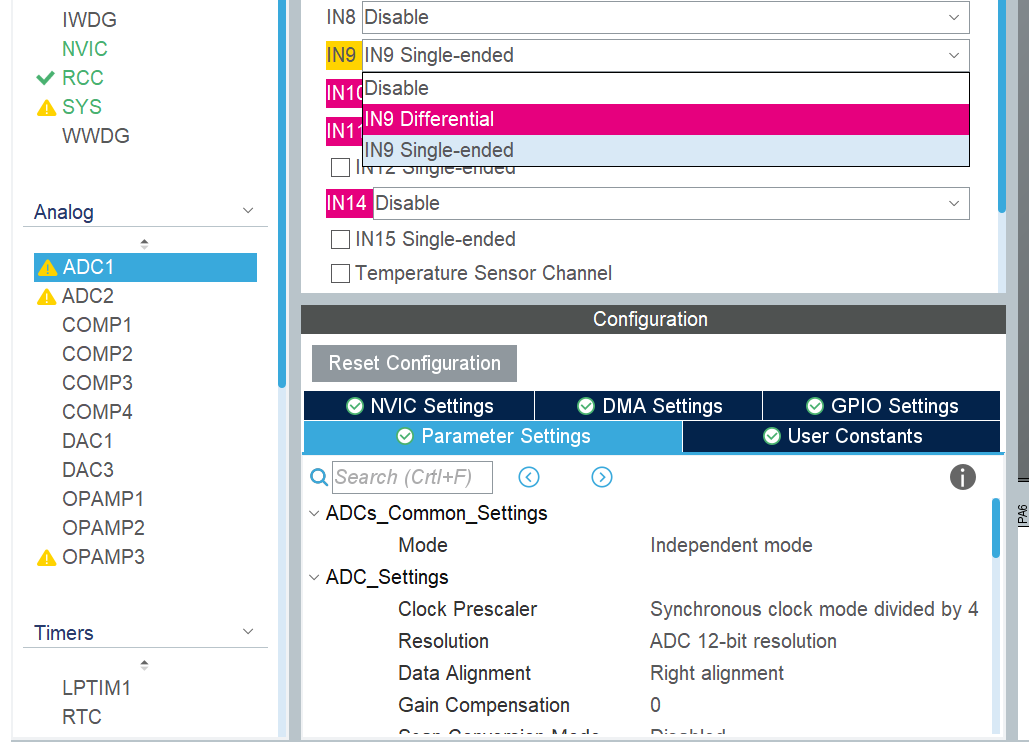

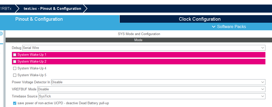

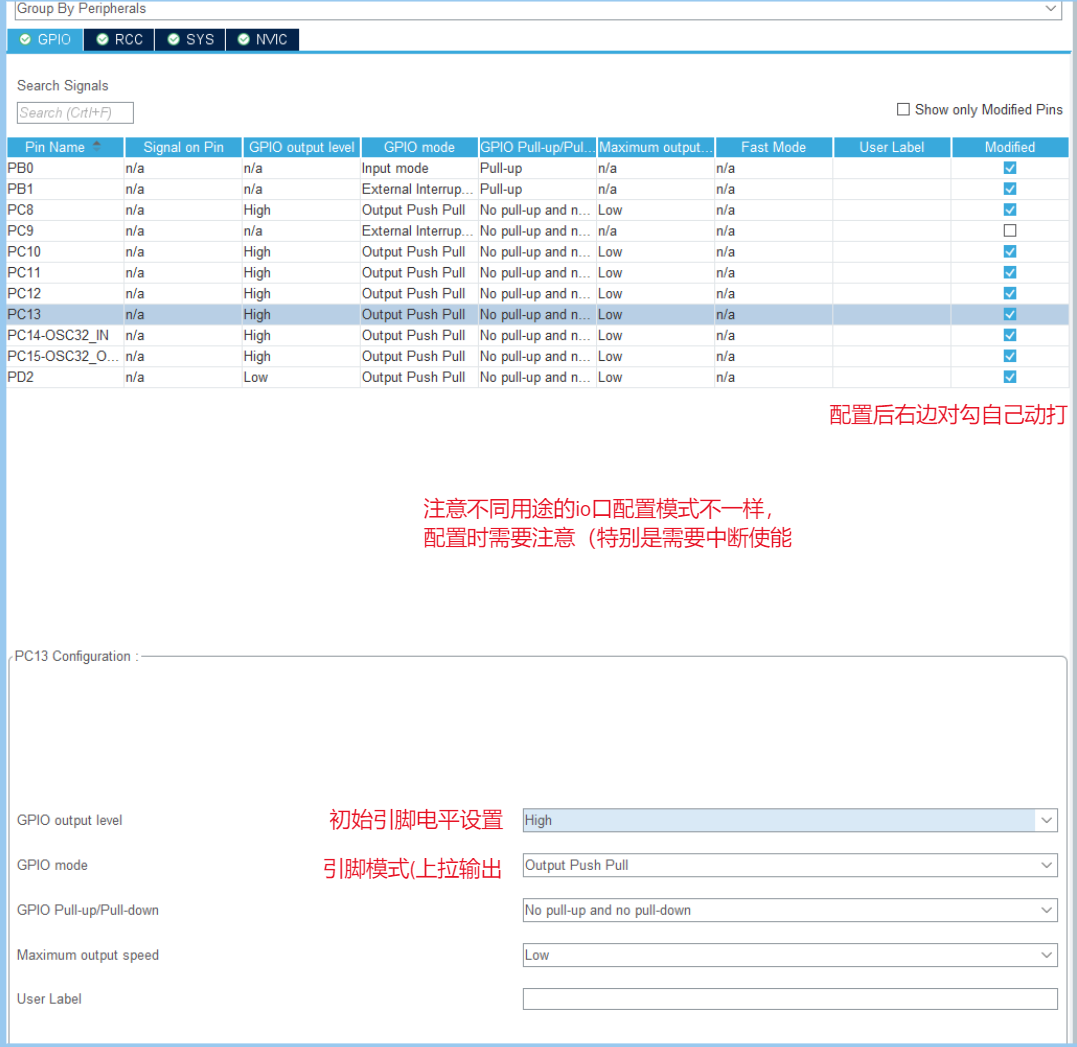

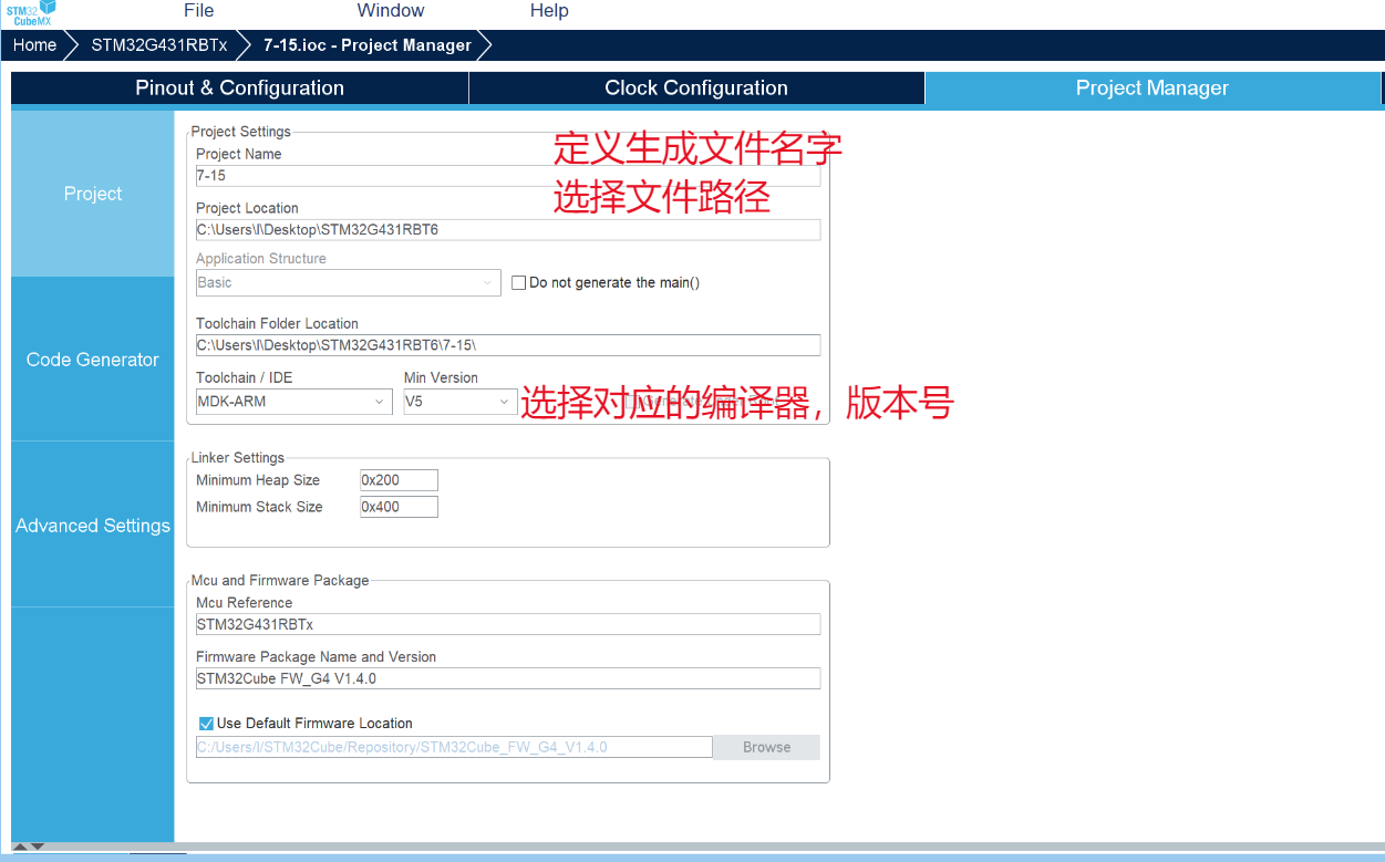

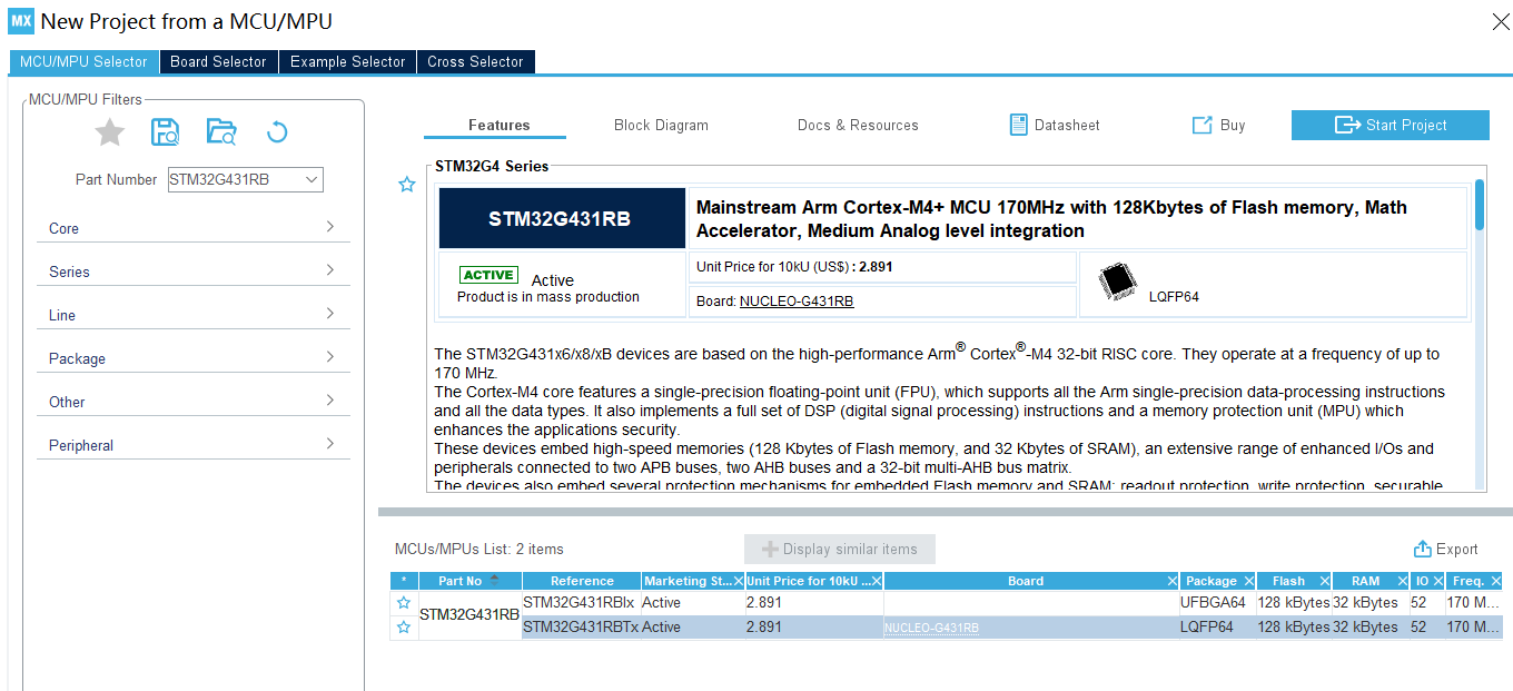

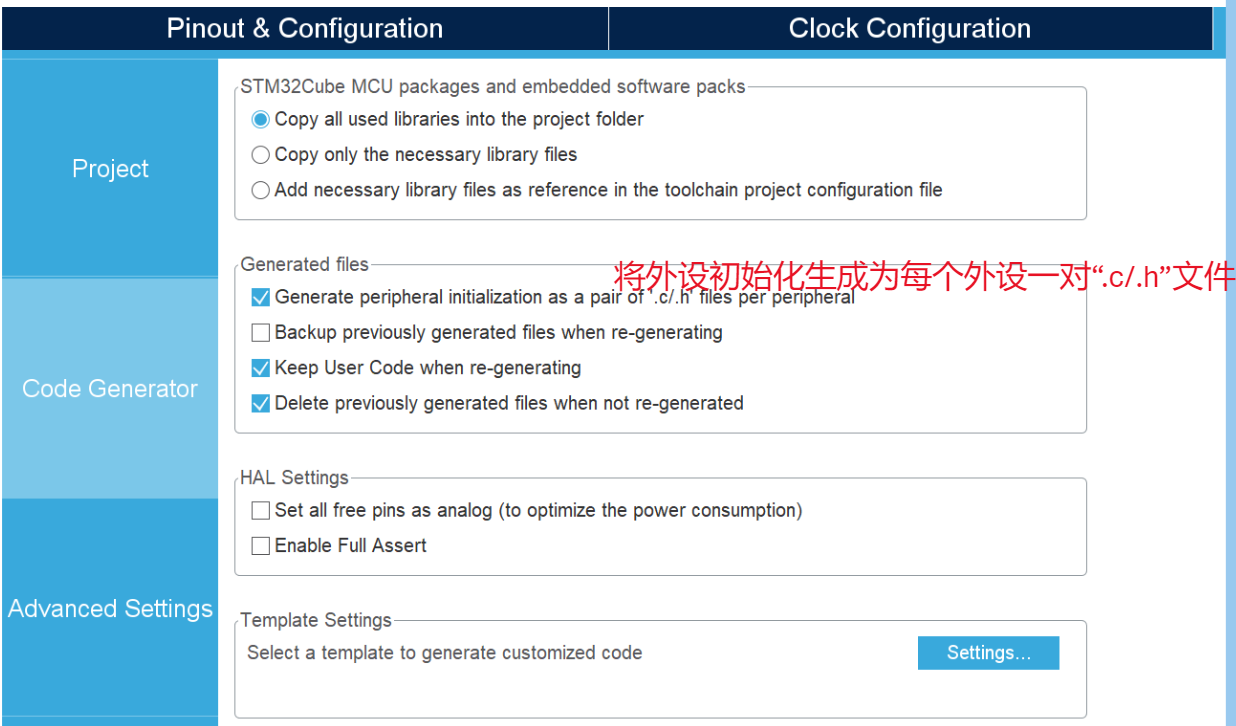

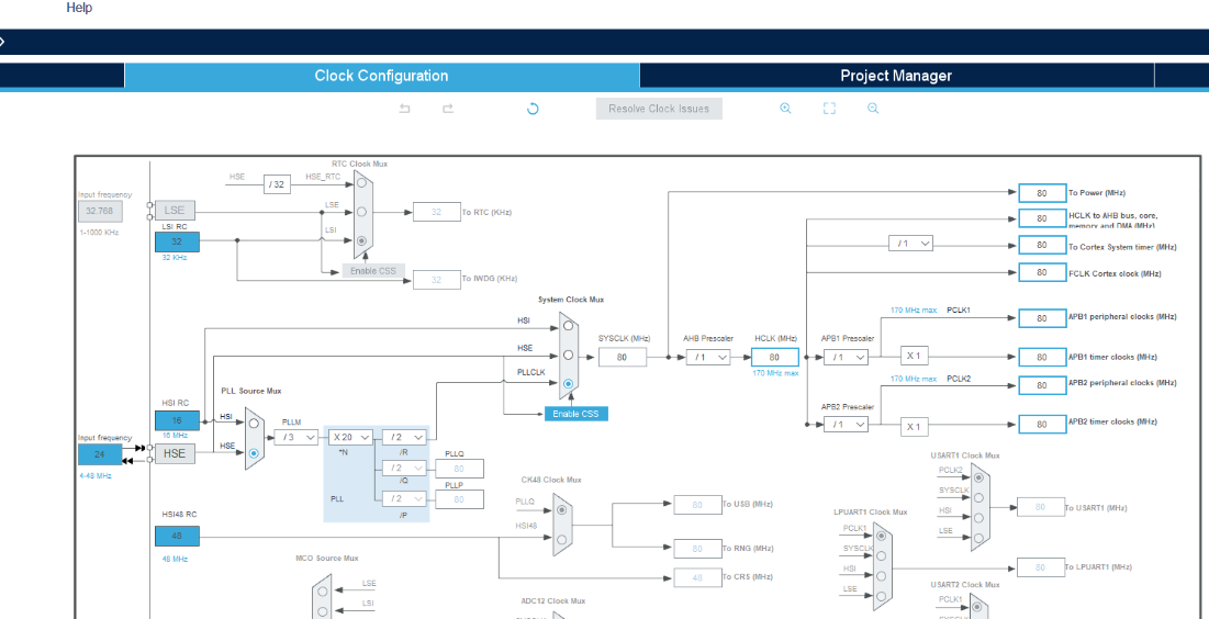

CubeMx configuration
September 9, 2024 10:56
Create
a new project:
1. Chip selection (correct chip model, correct package)
2. Debug selection

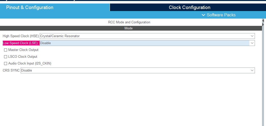

3. Clock configuration: first enable the clock as needed, then configure the clock tree.
The clock tree configuration should be adjusted according to the actual external crystal oscillator on the board.
4. GPIO configuration

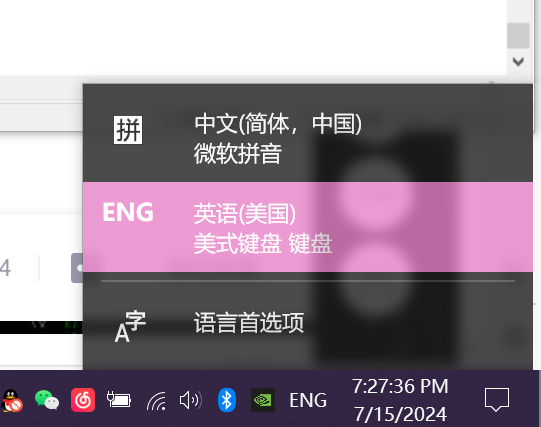

When using Keil 5, Ctrl + Alt + Space to display the prompt requires keyboard mode.

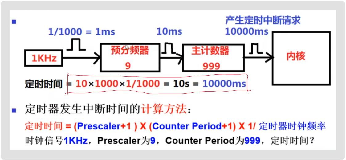

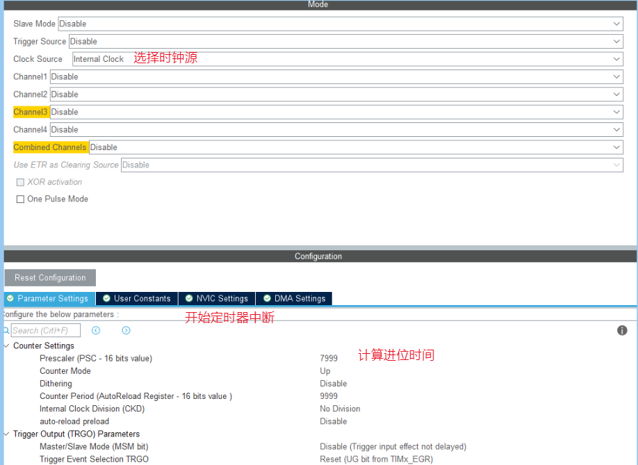

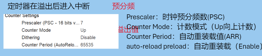

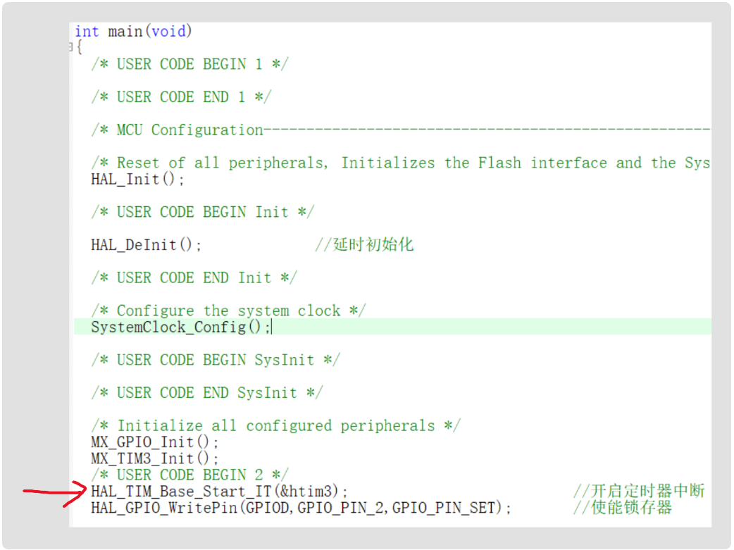

Timer interrupt
September 9, 2024,
11:03 AM
HAL_TIM_Base_Start_IT(TIM_HandleTypeDef *htim); // Enable clock interrupt, a necessary function, but note that it should be placed after the timer initialization function.
Interrupts can be configured in two ways:
void HAL_TIM_PeriodElapsedCallback(TIM_HandleTypeDef *htim)
if (htim->Instance == TIM1) // Ensure that the callback was triggered by timer TIM1
// Add your code here, such as updating variables, triggering an interrupt, etc.
void TIM3_IRQHandler(void)
HAL_TIM_IRQHandler(&htim3)
// Interrupt handler function

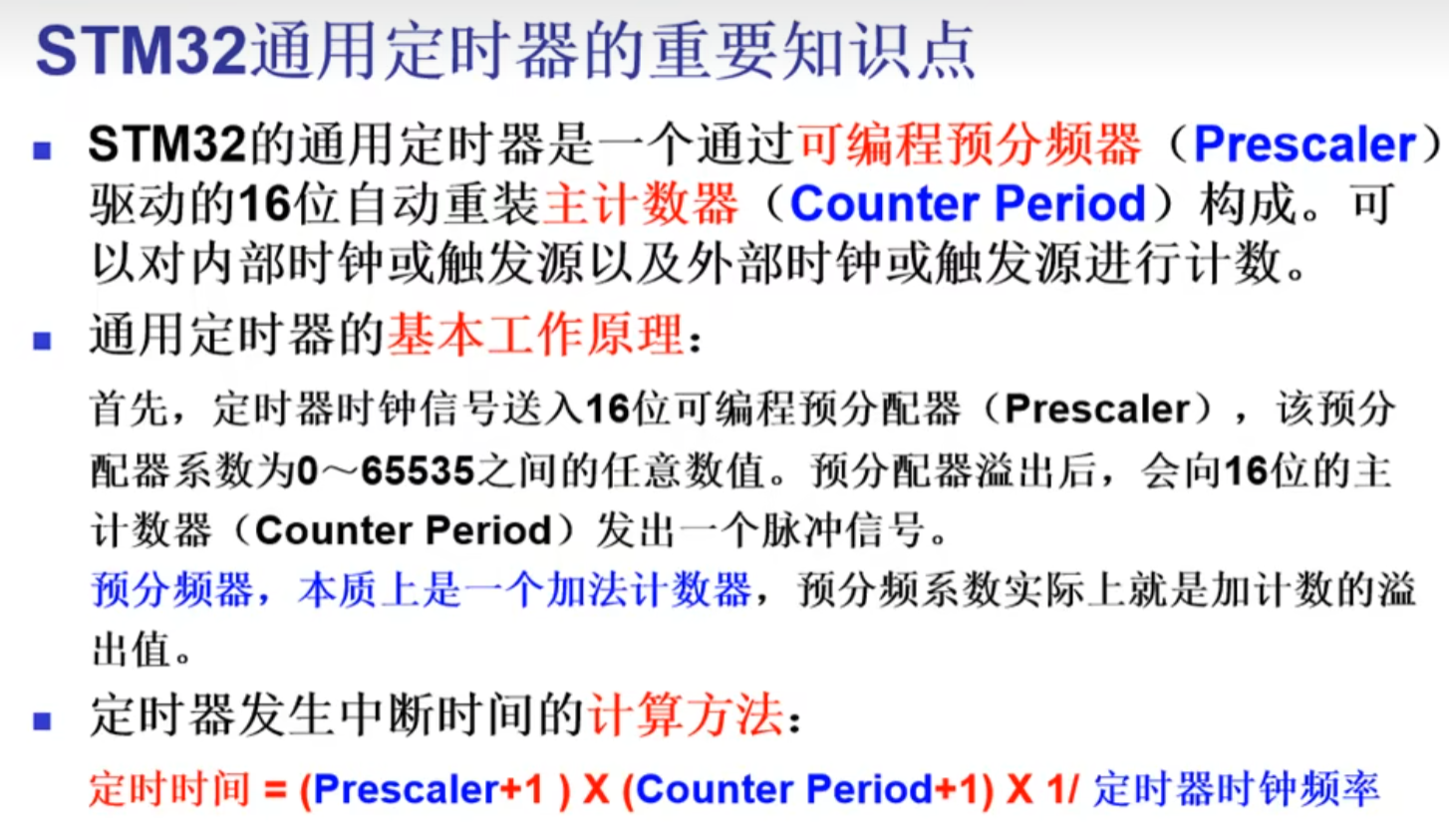

Timer timing calculation:
After enabling timer interrupts, the timer will enter the interrupt service function once after each count.
Interrupts:
preemption priority, response priority;
when multiple interrupt requests are made, they are handled according to the order of preemption and response. (Lower priority interrupts can be interrupted by higher priority interrupts) When
preemption and response priorities are the same, the system handles them according to the natural order.
(Therefore, interrupts must have a sequential order)
Understanding timers:
Timers are independent counters, unaffected by interrupts. Even when an interrupt is entered, the timer will continue counting.
Therefore, timers are used to replace delays. The interrupt handler function is entered only once after each count is completed. At this time, the program enters the interrupt service function, but this time is extremely short (I think it can be ignored). Compared to delays where the program stops, a better delay solution can be obtained.

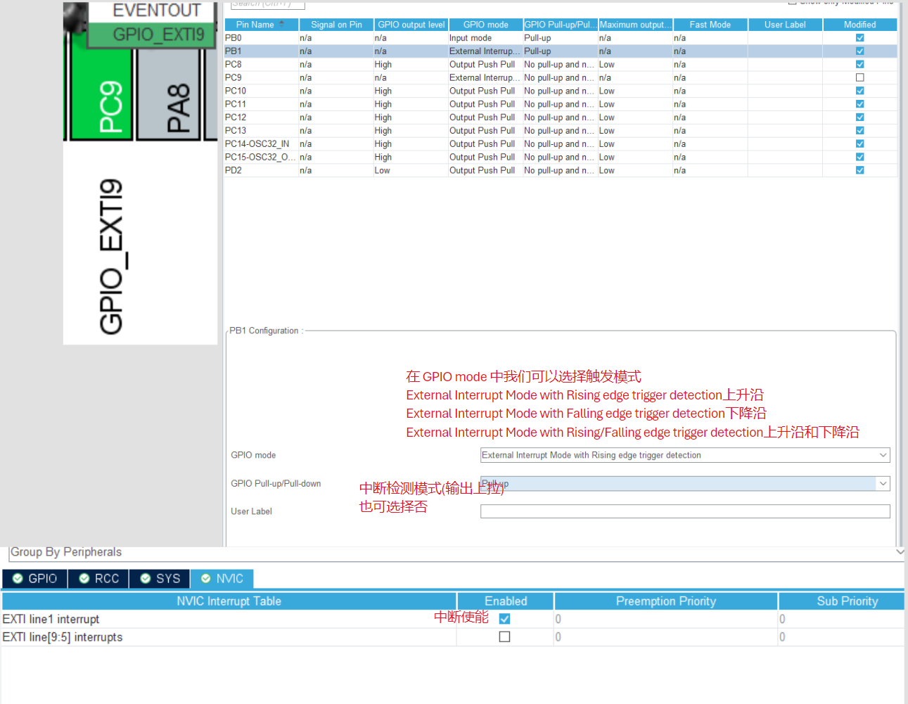

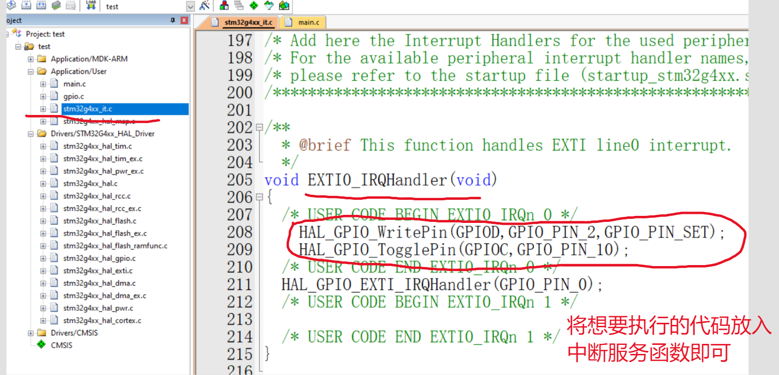

External Interrupts (Taking button interrupts as an example)
September 9, 2024,
11:09 AM
void EXTI1_IRQHandler(void) { HAL_GPIO_EXTI_IRQHandler(GPIO_PIN_1);
// External interrupt handling function }
void HAL_GPIO_EXTI_Callback(uint16_t GPIO_Pin)
// In hal_gpio.c, this is the callback function for external interrupts and must be placed under the main function
if(GPIO_Pin == GPIO_PIN_12)
} // Multi-button interrupt callback handling function

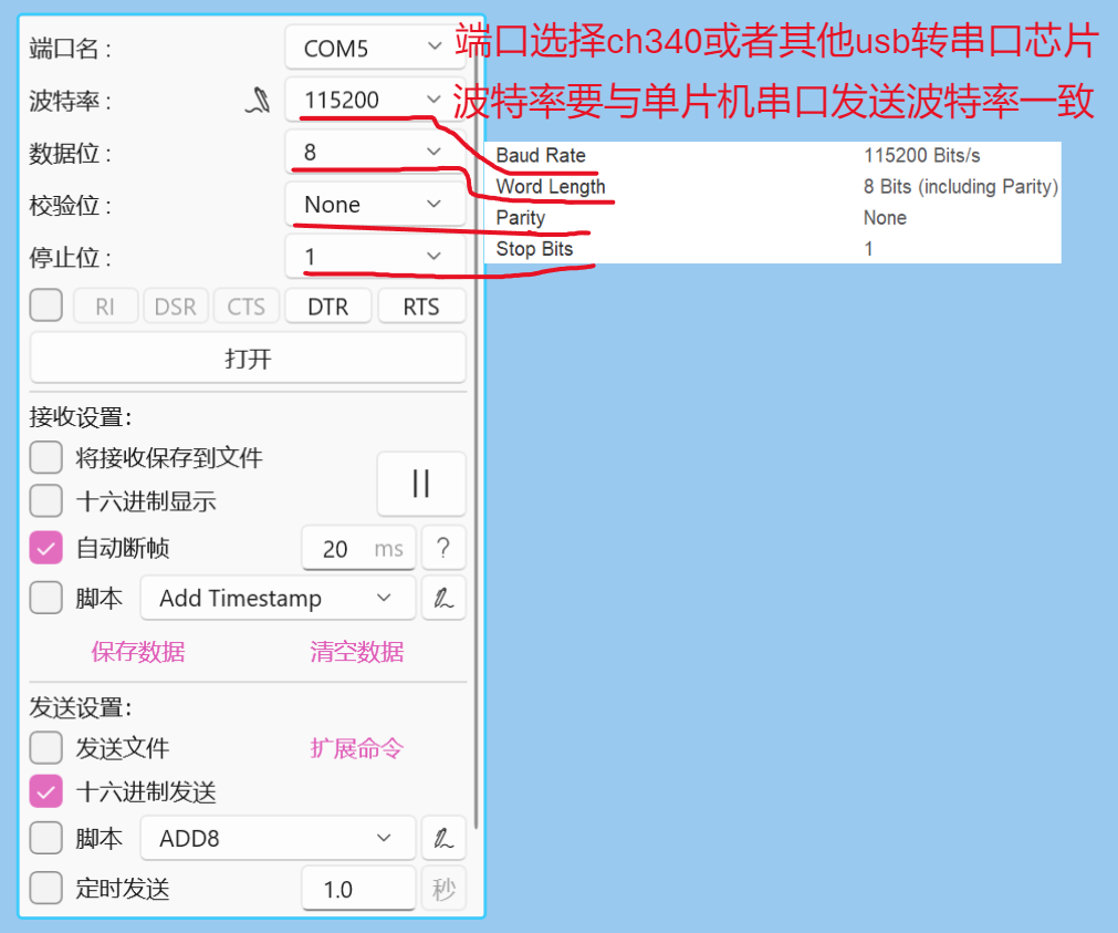

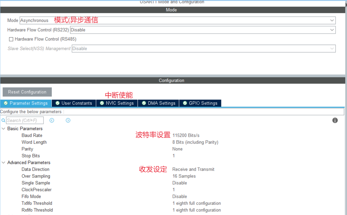

Serial communication (
September 9, 2024
, 11:15 AM):
I2C is half-duplex, SPI is full-duplex, and UART is full-duplex.
USART: Universal Synchronous and Asynchronous Receiver/Transmitter
; UART: Universal Asynchronous Receiver/Transmitter.
When performing asynchronous communication, there is no difference between the two. The difference is that USART has synchronous communication capabilities, which UART lacks. This synchronous communication capability allows USART to be used like SPI, for example, to drive an SPI device.
Blocking transmission: The microcontroller waits for the transmission to complete and does nothing else during the process.
Non-blocking transmission: Transmission interrupt is enabled, and a callback function is executed upon completion.

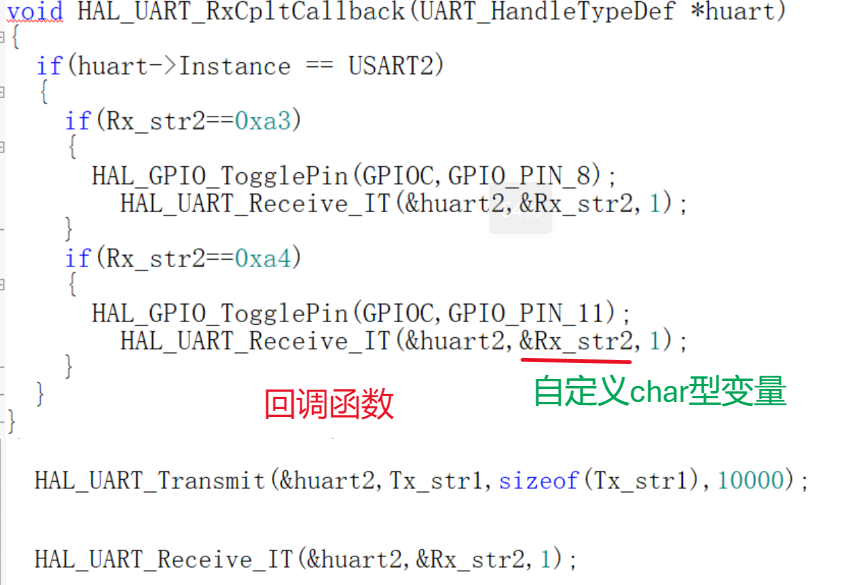

HAL_StatusTypeDef HAL_UART_Transmit(UART_HandleTypeDef *huart, uint8_t*pData, uint16_t Size, uint32_t Timeout); // Blocking transmission
HAL_StatusTypeDef HAL_UART_Transmit_IT(UART_HandleTypeDef *huart, uint8_t*pData, uint16_t Size); // Non-blocking transmission
void HAL_UART_TxCpltCallback(UART_HandleTypeDef *huart); // Callback function
void HAL_UART_TxHalfCpltCallback(UART_HandleTypeDef *huart); // Half-callback function
HAL_StatusTypeDef HAL_UART_Receive(UART_HandleTypeDef *huart, uint8_t*pData, uint16_t Size, uint32_t Timeout) `neout);` // Blocking receive `HAL_StatusTypeDef HAL_UART_Receive_IT(UART_HandleTypeDef *huart, uint8_t *pData, uint16_t Size);` // Non-blocking receive `void HAL_UART_RxCpltCallback(UART_HandleTypeDef *huart);` `void HAL_UART_RxHalfCpltCallback(UART_HandleTypeDef *huart);`
When performing serial port transmission and reception, you must know the corresponding pin number of the serial port.
The ch340 RX is connected to the microcontroller TX
, and the TX is connected to the microcontroller RX. They must share a common ground! (
Serial port debugging tool

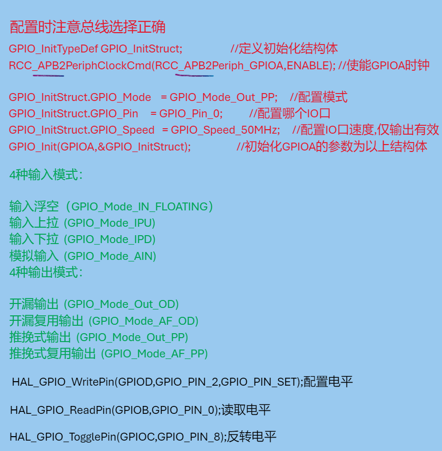

) void Uart1_init(u32 bound){
//GPIO port settings
GPIO_InitTypeDef GPIO_InitStructure;
USART_InitTypeDef USART_InitStructure;
RCC_APB2PeriphClockCmd(RCC_APB2Periph_USART1|RCC_APB2Periph_GPIOA, ENABLE); //Enable USART1, GPIOA clock
//USART1_TX GPIOA.9
GPIO_InitStructure.GPIO_Pin = GPIO_Pin_9; //PA.9
GPIO_InitStructure.GPIO_Speed ​​= GPIO_Speed_50MHz;
GPIO_InitStructure.GPIO_Mode = GPIO_Mode_AF_PP; // Multiplexed push-pull output
GPIO_Init(GPIOA, &GPIO_InitStructure); // Initialize GPIOA.9
// USART1_RX GPIOA.10 initialization
GPIO_InitStructure.GPIO_Pin = GPIO_Pin_10; // PA10
GPIO_InitStructure.GPIO_Mode = GPIO_Mode_IN_FLOATING; // Floating input
GPIO_Init(GPIOA, &GPIO_InitStructure); // Initialize GPIOA.10
// USART initialization settings
USART_InitStructure.USART_BaudRate = bound; // Serial port baud rate
USART_InitStructure.USART_WordLength = USART_WordLength_8b; // Word length is 8 bits data format
USART_InitStructure.USART_StopBits = USART_StopBits_1; // One stop bit
USART_InitStructure.USART_Parity = USART_Parity_No; // No parity bit
USART_InitStructure.USART_HardwareFlowControl = USART_HardwareFlowControl_None; // No hardware flow control USART_InitStructure.USART_Mode = USART_Mode_Rx | USART_Mode_Tx; // Transmit/receive mode
USART_Init(USART1, &USART_InitStructure); // Initialize serial port 1
//USART_ITConfig(USART1, USART_IT_RXNE, ENABLE); // Enable serial port receive interrupt
USART_Cmd(USART1, ENABLE); // Enable serial port 1

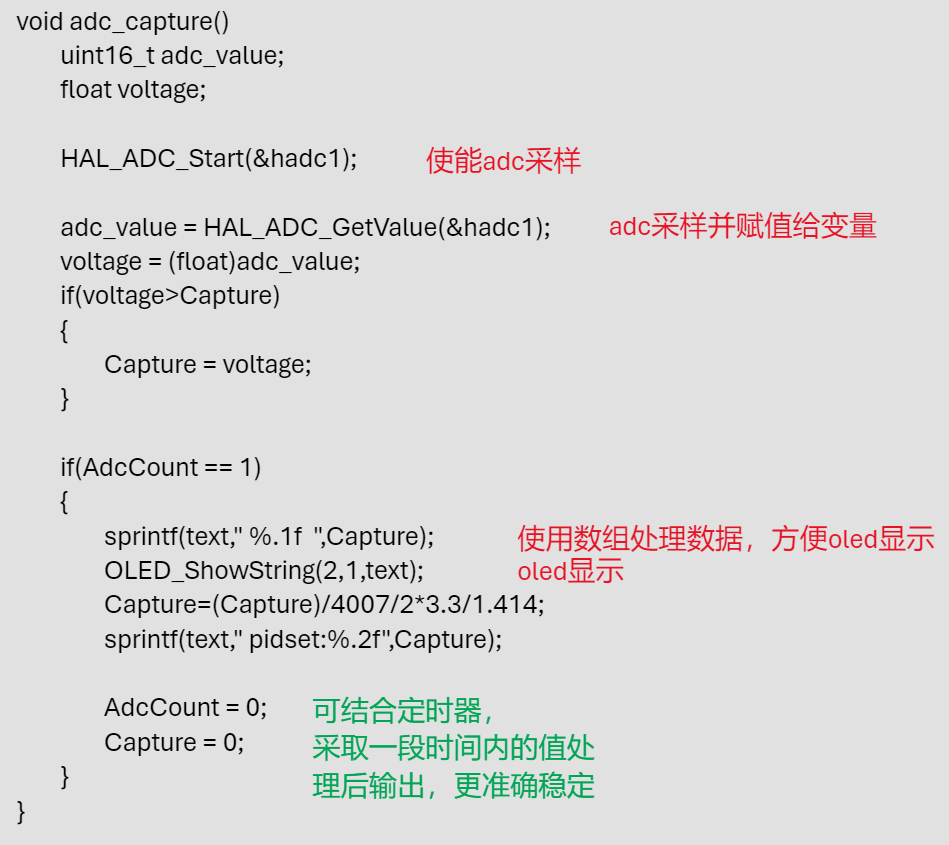

OLED driver notes (
September 9, 2024,
11:26 AM ):
First, import the relevant font library .h files. The
OLED .c and .h files are included in the compiler . The
main function includes the header file.
Configure the hardware I/O; you only need to enable the two communication interfaces.
Note the clock frequency; too high a clock frequency may affect the display effect.
(Hardware IIC is implemented through the IIC controller hardware module to achieve IIC communication, while software IIC is simulated by software control of GPIO ports)
OLED_Init();//oled initialization file
char text[20];
sprintf(text, character (%d), variable);
OLED_ShowString(2,1,text);
Clear screen problem, set screen background color, etc.

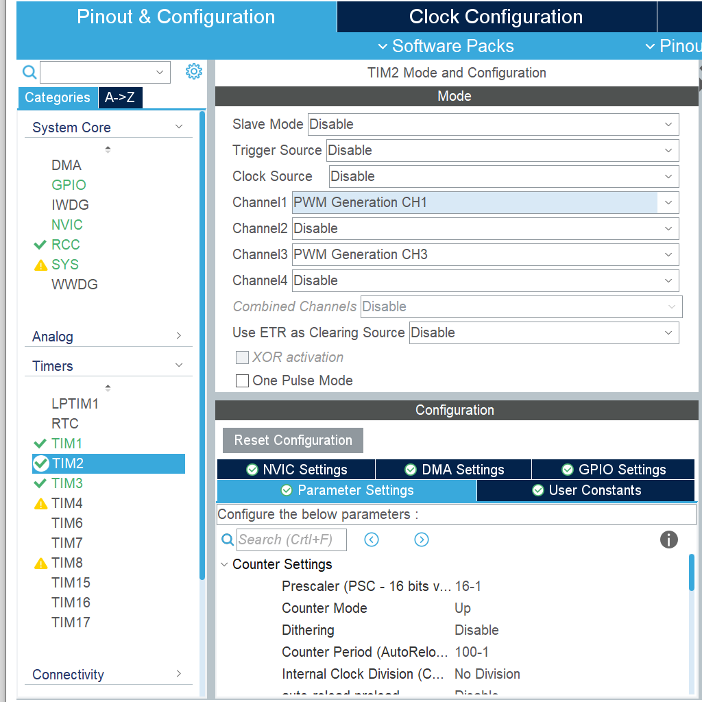

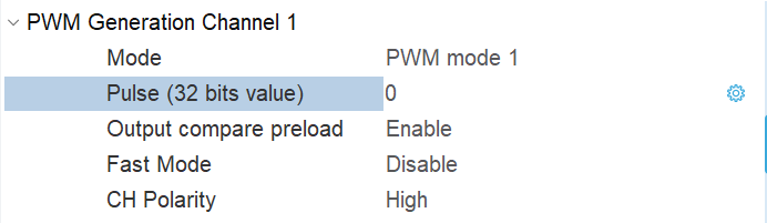

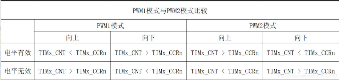

PWM configuration
September 9, 2024
11:27
Just configure the corresponding timer PWM output channel in CubeMx
HAL_TIM_PWM_Start(&htim2,TIM_CHANNEL_1);
TIM2->CCR1 = (constant/timer count value or timer overflow value)//Control tim2 channel 1 output PWM duty cycle
PWM effective drive two codes
PWM frequency: Freq = CK_PSC/(PSC+1)/(ARR+1)
PWM duty cycle: Duty = CCR/(ARR+1)
PWM resolution: Reso = 1/(ARR+1)
Comparison of PWM1 and PWM2 Modes of
STM32 Timer The STM32 timer has two PWM modes: PWM1 and PWM2. These two modes are similar yet opposite.
PWM1 Mode: Counting up, when TIMx_CNT = TIMx_CCRn, channel n of timer TIMx is invalid; otherwise, it is valid.
PWM2 Mode: Counting up, when TIMx_CNT = TIMx_CCRn, channel n of timer TIMx is valid; otherwise, it is invalid.
Below is a comparison table of PWM1 and PWM2 modes, which clearly shows the differences between the two.
Comparison of two PWM modes: Note:
Throughout the text, TIMx refers to the STM32 timer, where x represents a specific timer, and the value needs to be determined based on the chip;
TIMx_CNT refers to the counter register value of timer TIMx;
TIMx_CCRn refers to the capture/compare register value, where n represents a specific channel, with values ​​of 1, 2, 3, and 4;

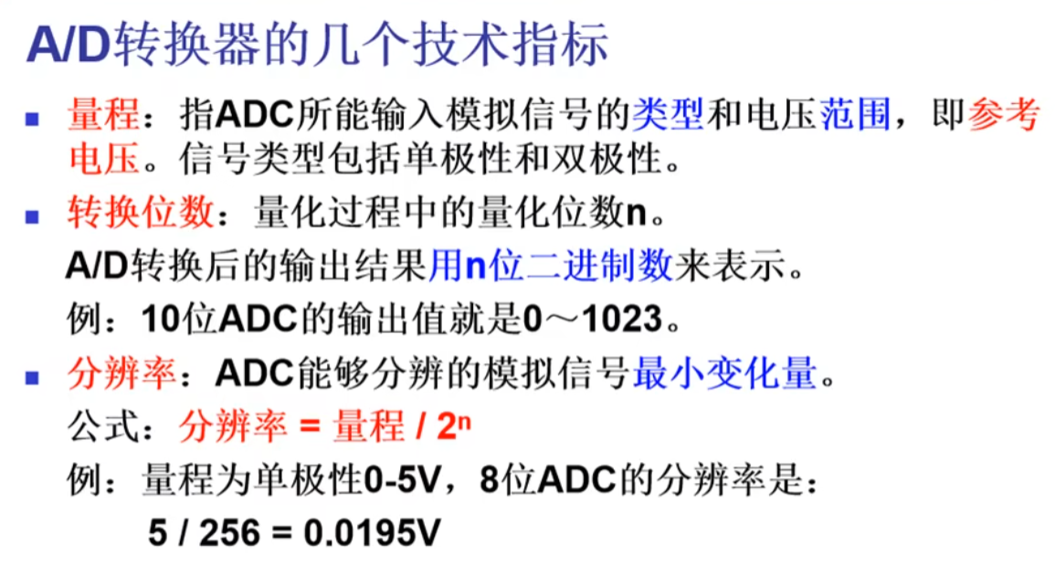

ADC sampling:
September 9, 2024,
11:29 AM
. Simply start the relevant pin ADC sampling channel in CubeMx.
