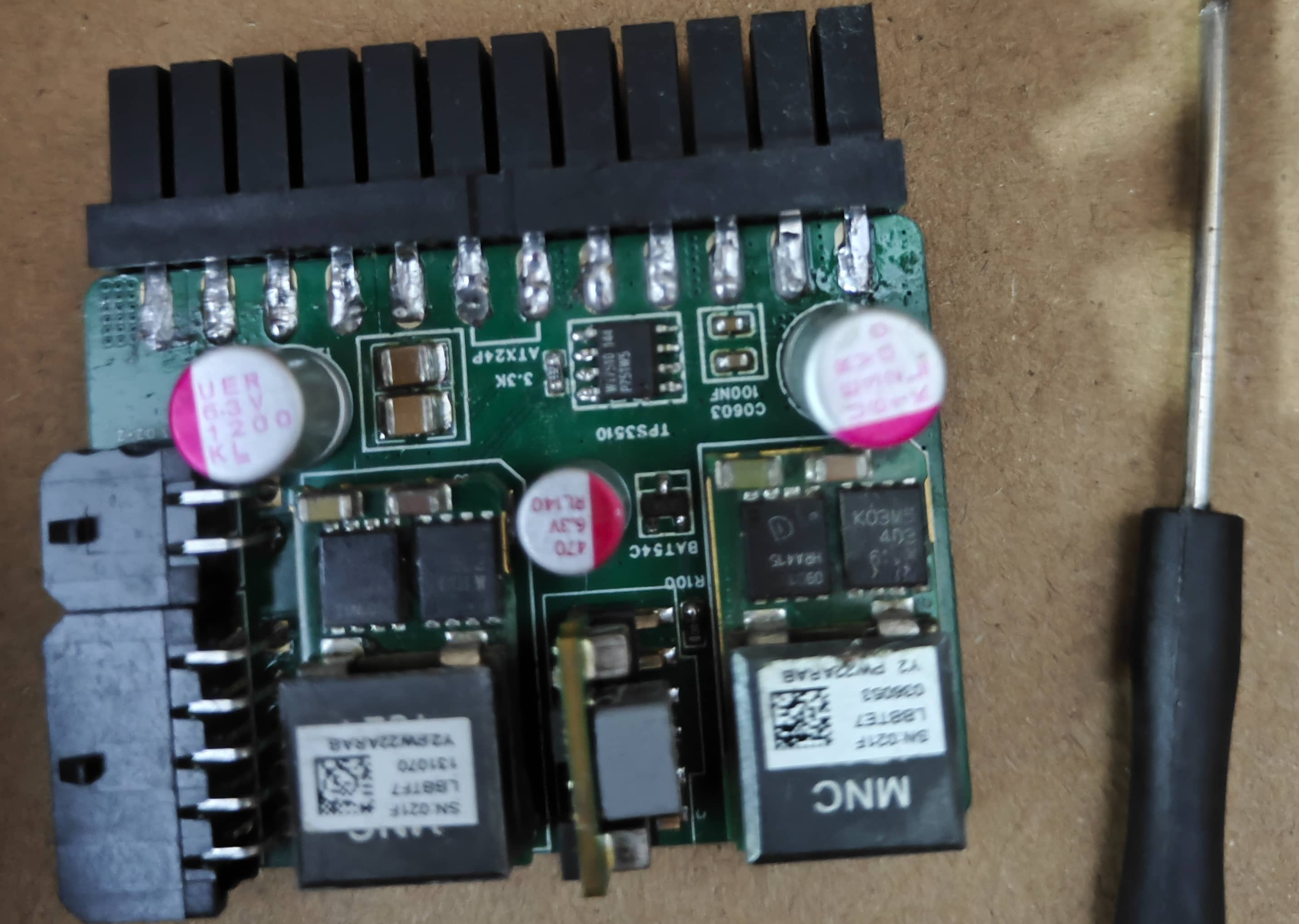

Using an MX3.0mm 10p/2p input, 5V is used. The 3.3V input uses a PW22 step-down converter, supporting 20A output. The 5VSB input uses a ZXDN10 step-down converter, supporting 10A output. For 12V, WT7510 is used for input power management. Refer to
Harry_2005 ATX power supply plan [Frosty Autumn] CSPS server power supply cage FRPS-06A.
