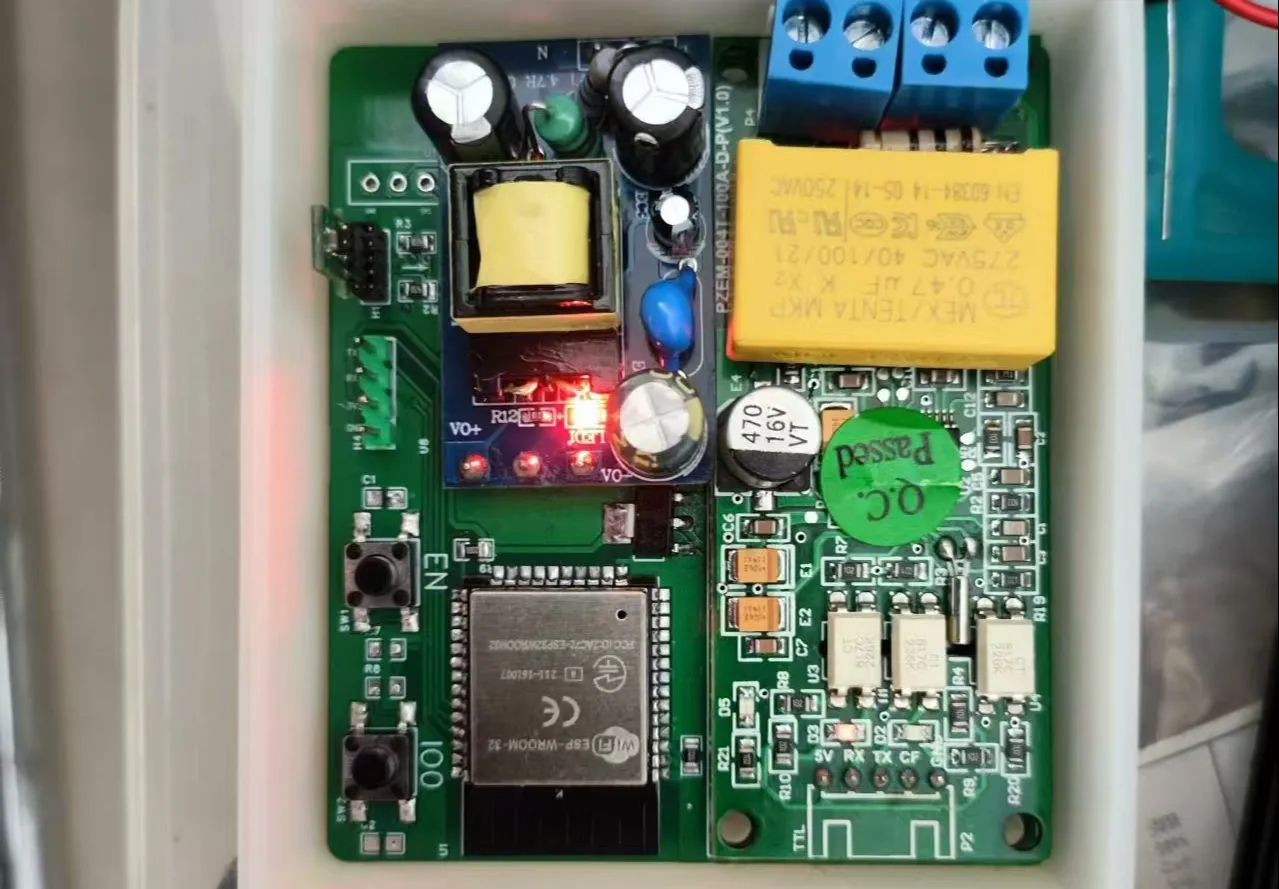

I think if it's not practical, it's basically meaningless. Don't do it just for the sake of doing it; it's about reducing the burden on my life. I don't want to pay for charging during power outages, I don't want to check the thermometer and hygrometer, and I don't want to press switches. It's better to have Xiao Ai (Xiaomi's AI assistant) remind me when the electricity is low, or ask Xiao Ai for the indoor temperature and it will tell me, or turn on the lights when I'm on the toilet or at the computer (and turn them off when I leave).
The project plans to use ESP32 modules to reduce soldering burden, and Peizheng PZEM-004T V3 modules to monitor power consumption (current, voltage, power consumption, power factor, apparent power, frequency, etc.) for daily, monthly, and yearly power consumption statistics. A Sensory SHT40 temperature and humidity module (leftover from a temperature and humidity training camp) will be used to monitor temperature and humidity, as the pins would otherwise be wasted. The ESP32's Bluetooth function will also be used as a Bluetooth gateway for Home Assistant, connecting a HI-LINK LD2410 to Home Assistant to enable lights to turn on when someone is present and turn off when they leave (unlike infrared sensors, this only detects presence). A natural gas module was initially planned, but it was decided that since the electrical box and kitchen are not located together, it should be practical rather than added just for the sake of adding it.
A 220VAC to 5VDC module (which I already have, no need to purchase a new one)
and a Peizheng PZEM004T-V3.0 module will be used. This module can monitor AC power, including voltage, current, power factor, and power consumption. Daily, month, and year power consumption can be recorded via software.

The main controller is a simple ESP32; I couldn't use anything else, so I chose a module for easier soldering. Using a chip would result in a QFN package, which most people probably can't solder.
EN and GPIO0 are absolutely essential! Absolutely essential! Absolutely essential! Pull-up switches are necessary for the module to start properly; don't forget them.
Don't forget the EN and GPIO0 buttons. You need to press the GPIO0 button during programming, and the EN button restarts the module.
It's convenient for programming, but after using esphome for online upgrades, it's basically unnecessary. The 3D casing doesn't have button windows anymore.
