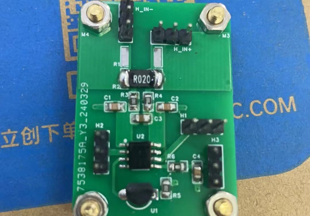

INA282 Current Detection Module for the Electronic Design Contest
Wide common-mode range: -14V to 80V
bidirectional current detection -2.5A to 2.5A (can be extended to -5A to 5A via a parallel resistor).
External reference output connection:
Using TL431 as the external reference, the output is 2.5V.
Test results:
Under the detection conditions of 24V
input current and a positive current of 1A, the INA282 output voltage is 3.47V.
Under the input current of 1A in reverse, the INA282 output voltage is 1.51V.
