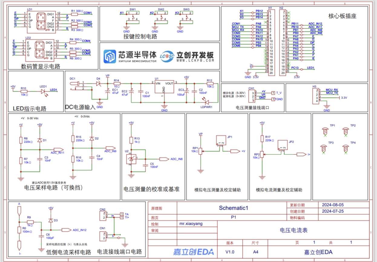

1. Project Schematic
The circuit diagram of this project adopts modular drawing. Different modules are divided into sections using lines in the circuit diagram for easy reading. The circuit diagram will be analyzed module by module below.

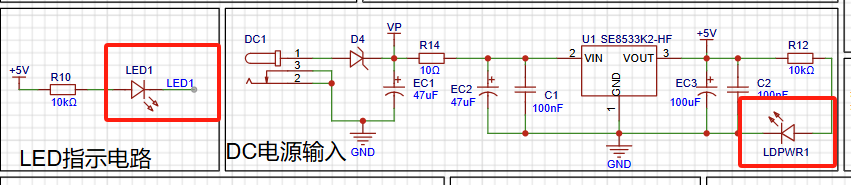

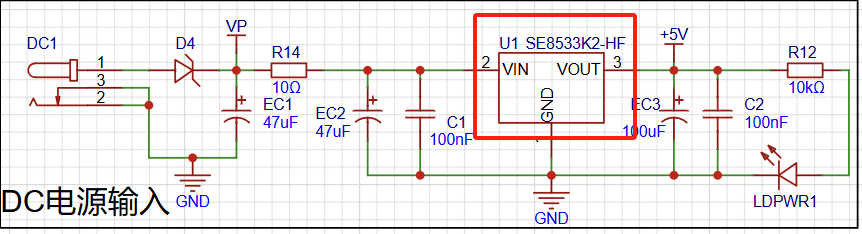

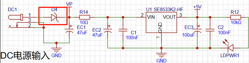

1. Power Supply Circuit
LDO (Low Dropout Linear Regulator) Selection
This project uses an LDO as the power supply. Considering that most voltmeter products are used in industrial scenarios with 24V or 36V power supplies, the
SE8550K2 with a maximum input voltage of up to 40V was selected. The main reason for not using a DC-DC step-down circuit to handle the large voltage drop is to avoid introducing DC-DC
ripple interference during the design process; a secondary reason is to reduce project costs.
Diode Reverse Connection Protection
Considering that high-voltage reverse connection will cause irreversible damage to the module, the voltmeter power supply circuit adopts a series diode scheme for reverse connection protection.
Note: The use of series diodes for reverse connection protection in this project takes into account the operating scenario where the power supply voltage of this equipment is usually higher than 5V, and the 0.7V voltage drop of the diode will not affect
the power supply . When the supply voltage is low, the overall power consumption of the project is low, and the measured supply current is low (20mA). Due to

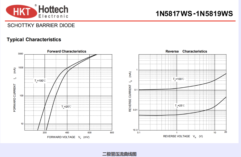

the unique structure of the Schottky diode D4 (1N5819), its VF is lower than that of general-purpose switching diodes, as shown in the figure below, with a voltage drop of approximately 0.2V or less.

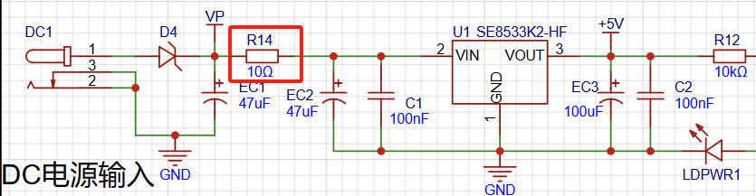

The role of the series small resistor (10Ω):
This project additionally uses a series small resistor (10Ω) for voltage division. On the one hand, this reduces
the problem of severe overheating of the LDO due to the large voltage difference under high voltage conditions. On the other hand, it utilizes the principle that the series 10-ohm low-power resistor has low overcurrent,
acting as a low-resistance fuse, providing overcurrent or short-circuit protection. (The point about using a resistor as a fuse is that, because the resistor is in an overcurrent state and in a heated state, it is 99% likely to be an open circuit; it will almost never short-circuit. Its fault
analysis determines that it is primarily an open circuit—that is, it burns out, not short-circuited.)
The series small resistor (10Ω) also reduces the peak value of the power-on surge, preventing excessive surge damage to the LDO.
If electrolytic capacitors are not used, a small series resistor (10Ω) can also prevent the inductance of the wires and the ceramic capacitor from resonating during hot-plugging. Because ceramic capacitors
have very low ESR, the damping in the LC network is very low, resulting in a high gain at the resonant point. Adding an external resistor to provide damping can suppress
the gain .

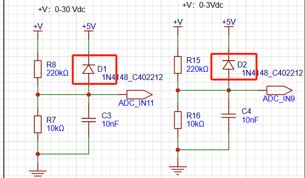

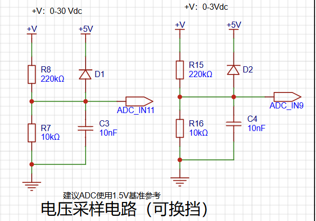

3. Voltage Sampling Circuit
This project uses a voltage divider circuit to achieve high voltage acquisition. The designed voltage acquisition voltage is 100V, and the current configuration acquisition voltage is 0-30V.
The voltage divider resistors in this project are designed to be 220K+10K, therefore the voltage division ratio is 22:1 (ADC_IN11).
Voltage Divider Resistor Selection
1. The maximum value of the designed measurement voltage is 30V for safety reasons (the actual maximum display value can be 99.9V or 100V);
2. The ADC reference voltage is 1.5V in this project, which can be configured through the program;
3. To reduce the power consumption of the sampling circuit, the low-side resistor (R7) is usually selected as 10K based on experience;
then the high-side resistance of the voltage divider resistor can be calculated using the above parameters:
1. Calculate the required voltage division ratio: i.e., ADC reference voltage: design input voltage. Using known parameters, 1.5V/30V = 0.05
2. Calculate the high-side resistance: i.e., the low-side resistance/voltage divider ratio. Using the known parameters, we can calculate 10K/0.05=200K.
3. Select a standard resistor: Select a resistor with a value slightly higher than the calculated value. The calculated value is 200K. We usually choose E24 series resistors. Therefore, in this project, we choose 220K, which is greater than 200K and the closest.
If, in practical use, the voltage to be measured is lower than 2/3 of the module's design voltage (66V), the voltage divider resistor can be replaced and the program modified to improve measurement accuracy. An example is provided below:
1. Assume the measured voltage is no higher than 24V, and other parameters remain unchanged
. 2. Calculations show 1.5V/24V = 0.0625, 10K/0.0625 = 160K. 160K is a standard E24 resistor and can be directly selected, or a higher value 180K can be chosen with some redundancy.
If, in practical use, the voltage to be measured is higher than the module's 99V design voltage, the voltage divider resistor can be replaced, or the reference voltage can be modified to achieve a larger voltage measurement range. An example is provided below:
1. Assuming the measured voltage is 160V, the solution is to increase the voltage reference to expand the measurement range.
2. Given that the voltage division ratio of the selected resistor is 0.0145, we can calculate 160V * 0.0145 = 2.32V using the formula. Therefore, we can choose a 2.5V voltage reference to achieve the range expansion (expanding the range will reduce accuracy).
Considering the potential fluctuations in the measured power supply, a 10nF filter capacitor is connected in parallel with the low-side voltage divider resistor in the circuit design to improve measurement stability.
Diode clamping ensures MCU safety.
In designing this project, I added an additional 1N4148 (D1, etc.) as a clamping diode to the sampling circuit. This is to avoid
damage to the chip pins due to incorrect voltage input during learning and debugging. Diode clamping is an important electronic circuit design technique. Its main function is to protect the circuit by
limiting the voltage amplitude, preventing damage or malfunction caused by excessively large or small signals.
Clamping in circuits refers to limiting voltage, while diode clamping specifically refers to the technique of using a diode to limit the potential at a certain point in the circuit.
Diode clamping primarily utilizes the unidirectional conductivity of diodes. When the positive voltage of a diode is greater than its negative voltage and it conducts, the voltage across the diode is limited to
its voltage drop across the diode, typically around 0.7V for a silicon diode.

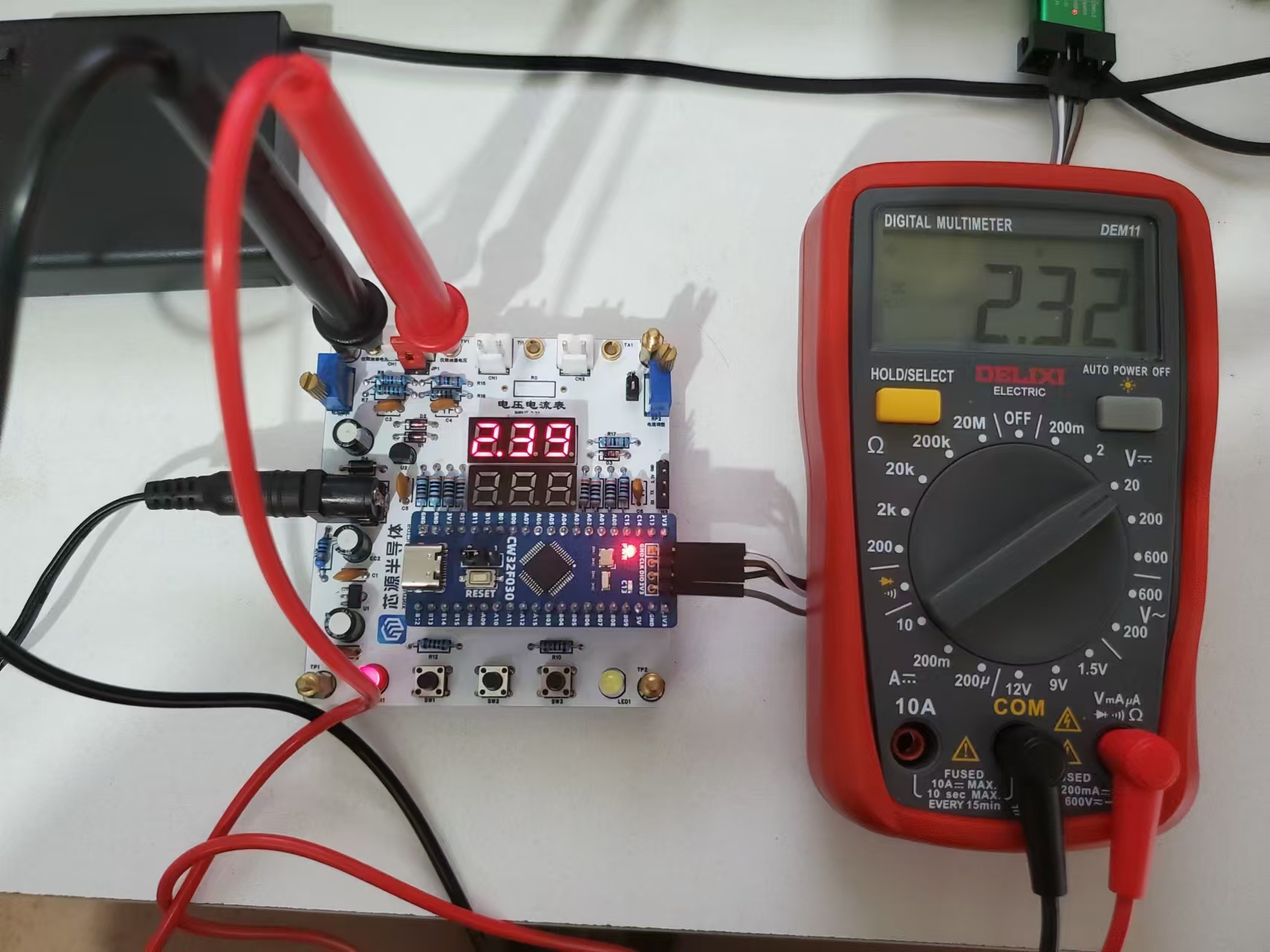

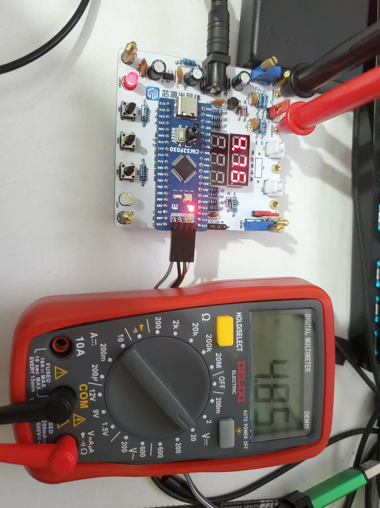

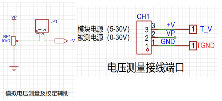

the circuitry used for simulating voltage measurement, calibration, and measurement assistance are
the 2mm banana plug connectors on the development board, used to connect multimeter probes. You can insert the probes of a multimeter or a high-precision benchtop digital multimeter to verify the accuracy of the development board's measurements. Alternatively, you can insert 2mm banana plug multimeter probes to replace the CH1 port for handheld measurements.
The VP pin is the power supply pin for the development board and should not be connected when using the DC port. When not using the DC port for power and the measured value is greater than 5V and less than 30V, you can connect it to the power supply under test, or it can be powered independently.
Use the multi-turn adjustable potentiometer (RP1) to divide the development board's power supply voltage and connect it to the +V network through the development board's internal circuitry. Note that JP1 needs to be shorted in this case; a jumper cap is sufficient, and a long-handled jumper cap is recommended. Do not short JP1 if this function is not used.

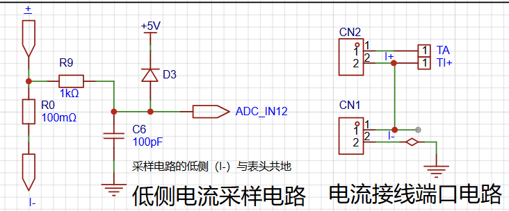

4. Current Sampling Circuit
This project uses a low-side current sampling circuit for current detection. The low-side of the sampling circuit shares a common ground with the development board's meter interface.
Analysis:
The sampling current designed for this project is 3A, and the selected sampling resistor (R0) is 100mΩ.
The selection of the sampling resistor mainly needs to consider the following aspects:
1. The maximum value of the pre-designed measurement current, which is 3A in this project.
2. The voltage difference caused by the current sensing resistor, which is generally not recommended to exceed 0.5V.
3. The power consumption of the current sensing resistor; a suitable package should be selected based on this parameter. Considering the power consumption (temperature) issue under high current, a 1W metal wire-wound resistor was selected in this project.
4. The amplification factor of the voltage across the current sensing resistor: No operational amplifier is used to build the amplification circuit in this project, so the amplification factor is 1. The
current sensing resistor value can then be calculated using the above parameters.
1. Since this project does not use an amplifier circuit, a larger sampling resistor is needed to obtain a higher measured voltage for measurement.
2. Considering that a larger resistor would result in a larger voltage drop and higher power consumption, an unlimited selection of a larger resistor is not advisable.
3. This project uses a 1W packaged resistor, corresponding to a power consumption of 1W. Based on the
above data, a 100mΩ current sensing resistor was chosen. According to the formula, 3A * 100mΩ = 300mV, 900mW

In practical use, the voltage at I+ is simulated as the voltage drop across the unsoldered 100mΩ sampling resistor. At this point, the simulated measured current value Imeasured = the voltage value Vi+ ÷ 100mΩ, which
is also exactly equal to the measured voltage value multiplied by 10. That is, it provides a simulated current measurement range of 0~2.38A.

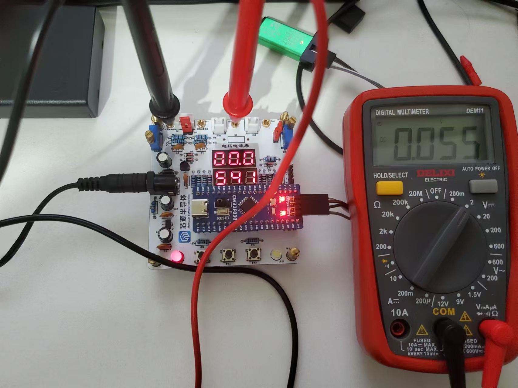

Set a multimeter or high-precision benchtop digital multimeter to the voltage measurement port, with a range within 3V. Insert the black negative probe into
the T_GND interface next to the voltage measurement terminal, and the red positive probe into the TI+ port for current measurement to measure the actual voltage value of I+. Therefore, this circuit can not only
complete the above design tasks but also allow for a direct test to experience the accuracy of the MCU's ADC peripheral. You can write your own program to verify this.

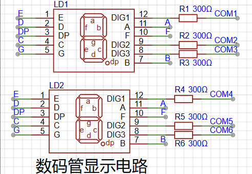

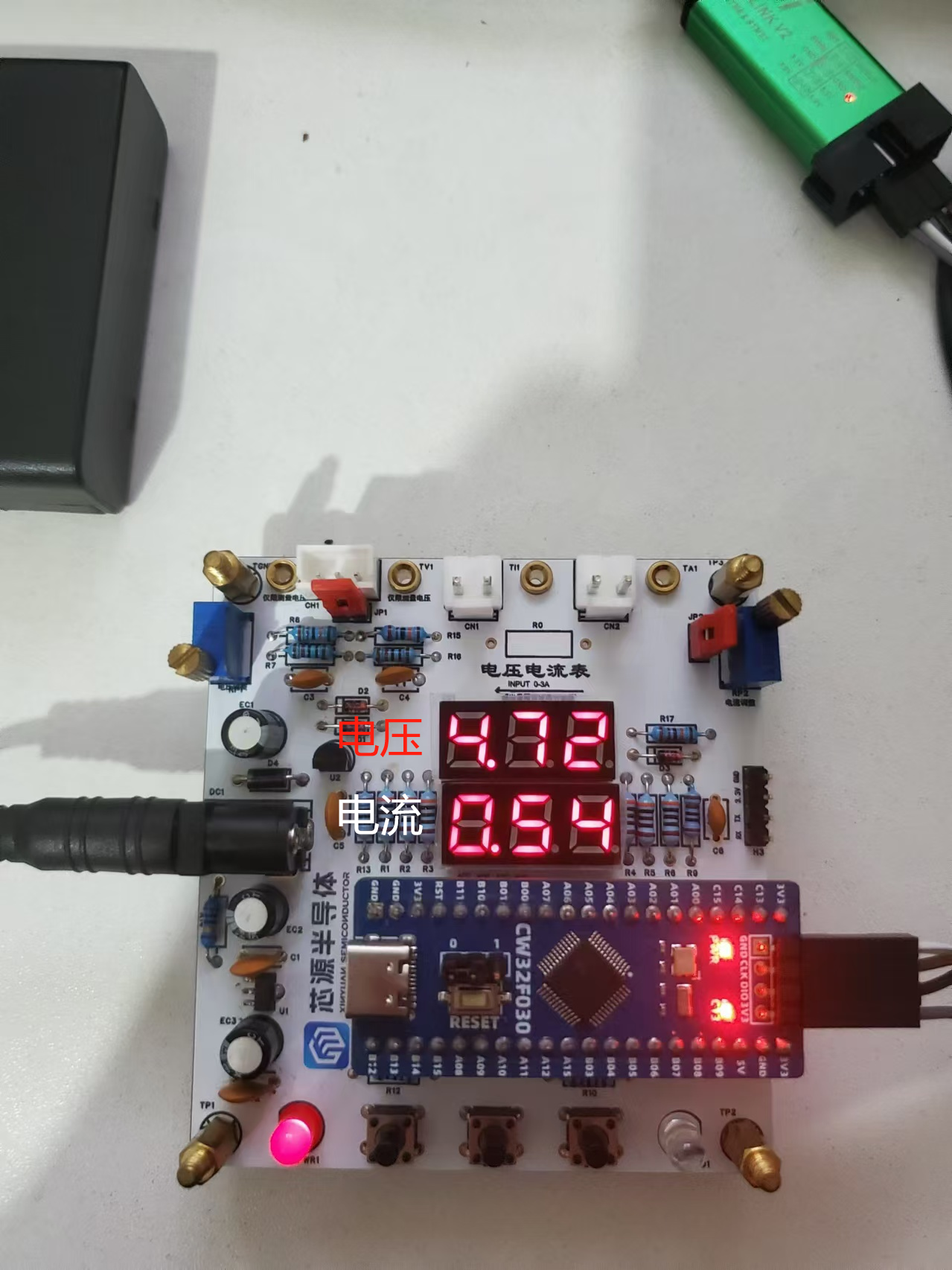

5. Digital Tube Driver Circuit
This project uses a digital tube as the display unit.
This project uses two 0.28-inch three-digit common-cathode LED displays as display devices. Compared to displays, LED displays offer better visibility in complex environments. The brightness of the LED displays can be increased by using smaller current-limiting resistors, depending on the specific needs of the application environment. Furthermore, LED displays have better mechanical properties and are less susceptible to damage from external forces than displays. They are commonly used in industrial applications requiring stability and reliability. From a development board learning perspective, this makes it easier to learn electronic measurement principles and related development in a targeted manner.
In this project, actual testing showed that the current-limiting resistors (R1~R6) for the LED displays were configured to 300Ω. The corresponding brightness for both red and blue LED displays was good, and the brightness was soft and not glaring.
Strictly speaking, the current-limiting resistors should be added to the segments; adding them to the digits would affect the display effect. Our design places them in the digits to save a few resistors, but the impact on the display is not significant. Therefore, we add them to the digits for convenience.

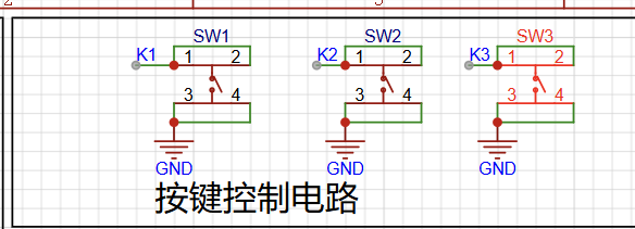

7. Button Circuit
The button control circuit has various design methods. Thanks to the fact that the CW32's I/O port can be configured with pull-up and pull-down resistors internally, the button control circuit on the outside of the chip does not need to be configured. One end of the button is connected to the MCU's I/O, and the other end is grounded. When the button is pressed, the I/O is pulled low.

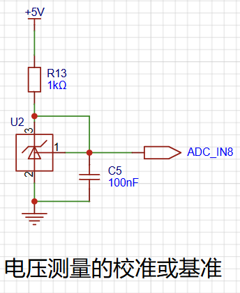

8. TL431 Circuit Design for Voltage Measurement and Calibration
This project adds an extra TL431 circuit to provide a 2.5V reference voltage, which can be used to provide an external voltage reference for the chip to calibrate the AD. From a product design perspective, due to the inherent ADC performance advantages of the CW32, this circuit is not necessary. This circuit is designed on the development board for learning the relevant application principles.
The TL431 is a relatively "old" device, very classic, widely used, and still found in many electronic products today.
Many beginners may be encountering this device for the first time, so I'll briefly explain its principles to help you better apply the TL431.
TI defines it as a "Precision Programmable Reference," and we can focus on several key characteristics on the first page of the references.
**Precision:** Precision indicates its highly accurate output voltage. I used a ±0.5% accuracy TL431, which measured 2.495V on the board at room temperature. This is a world of difference in accuracy compared to common Zener diodes. In application circuit diagrams, the TL431 is represented internally by a Zener diode symbol. **
Adjustable Output Voltage:** The adjustable output voltage is between Vref and 36V. In our project, we use the output Vref voltage, which is approximately 2.5V. Therefore, we use 2.5V in the description, which is approximately equal to Vref. **
Sinking Current Capability:** This refers to how much current the output voltage pin can provide, which is greatly influenced by the resistance (R13) in the application circuit. It should not be less than 1mA. If there is no need for sinking current, avoid designing the current too high to prevent unnecessary power consumption.

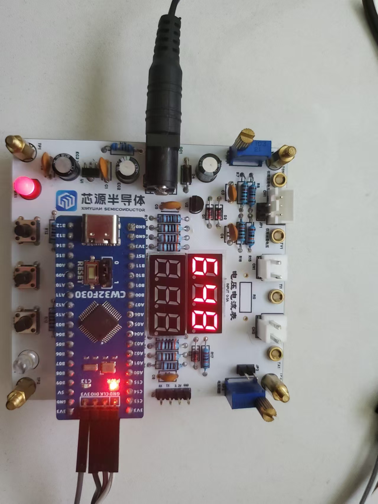

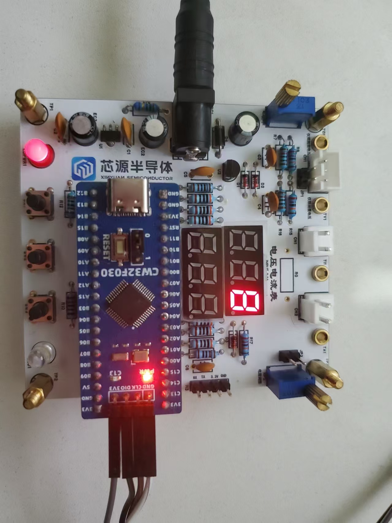

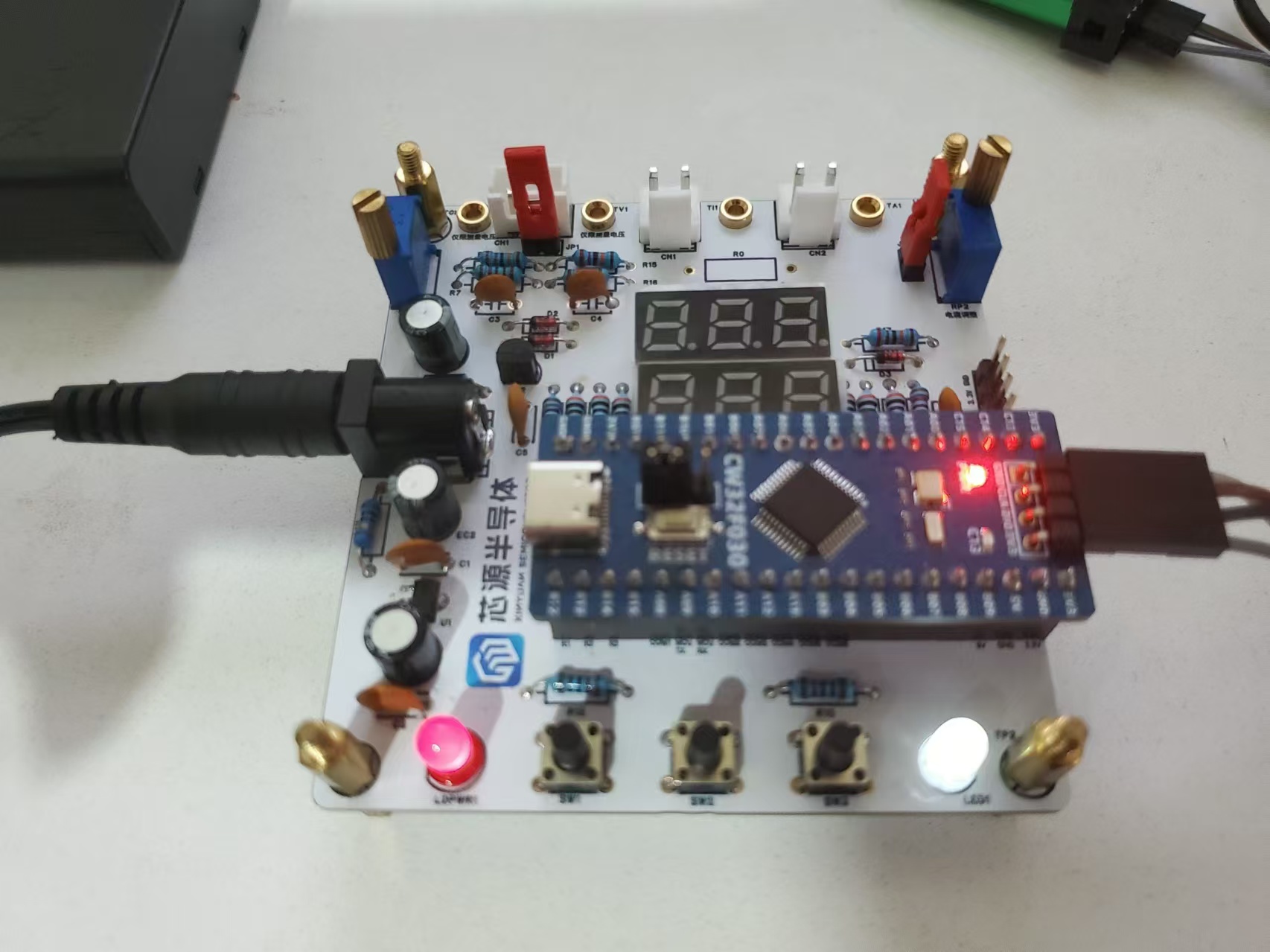

1. Experiment 1: LED Light Driver
The white light in the diagram is the control indicator for this experiment, which is an experiment to light up an LED.
Experiment 1: Experiment

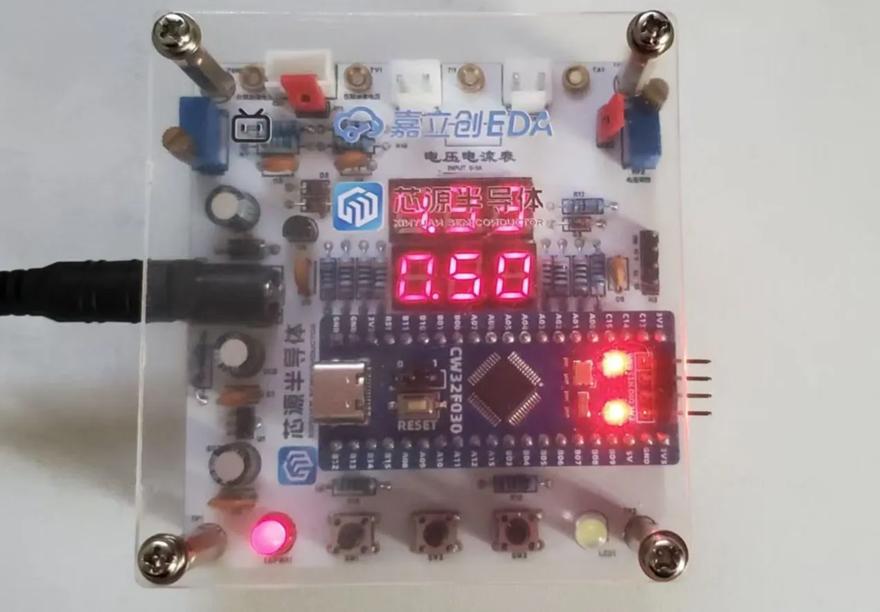

The final result is shown below. Compared with the previous result, the value displayed on the digital tube is more stable, filtering out the influence of interference on the MCU's operation.
Experimental effect diagram

7. Experiment Seven: Current Channel Acquisition Voltage Display of a Six-Digit Display
The purpose of this experiment
is simply to display the voltage using two digital tubes. This voltage is acquired through the current channel.
When we need to test the MCU AD sampling accuracy, we often input a specific adjustable voltage from the MCU AD pin, and then programmatically collect and calculate the pin voltage, comparing it with the actual voltage to observe the performance of the ADC conversion. In the development board, we can use the current channel to acquire and display the voltage to judge the AD conversion performance.
Current sampling is completed through the ADC_IN12 channel.
We can use the PR2 potentiometer to adjust the voltage value of the analog I+ input. The actual voltage value can be obtained by testing the voltage between the TI+ and GND terminals using a multimeter. The digital display shows the voltage value measured and calculated by the MCU. Comparing the actual value with the measured value allows for analysis to determine if the configuration or performance of the AD conversion process needs improvement.
Note: In this experiment, R0 is not soldered. JP2 jumper is shorted.
The voltage provided by RP2 is within the range of 0~0.238V (5V÷210K*10K) (ideal value; the actual value may be determined by the resistor accuracy), and is connected to the chip's current sampling pin via the I+ network.

8. Experiment Eight: Simultaneous Voltage and Current Measurement and Display
The project code file is as follows:
Link: https://pan.baidu.com/s/1ExWP4fKwc6O8zjcyVymRVA?pwd=LCKF Extraction code: LCKF
Since there is no load to measure, only simulated voltage and current can be tested.
The experimental effect diagram
shows that the voltage at the measured terminal is 4.72V and the current is 0.54A.
