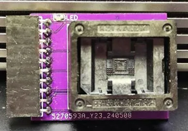

T48 ISP adapter lower pressure seat
The T48 ISP board's BGA153 adapter socket
speed is consistent with the official specifications, reaching a maximum of approximately 20MB/s (at a clock frequency of 40MHz). It supports 1.8V/3.6V, 1-bit/4-bit modes.
The VCC and VCCQ circuits are separate
for ease of modification. The project has been transferred to the LCSC EDA professional
board, and the capacitor and resistor values ​​are already labeled, all being 0603 specification.
LEDs are optional (if not installed, neither the LEDs nor resistor R2 are needed).
