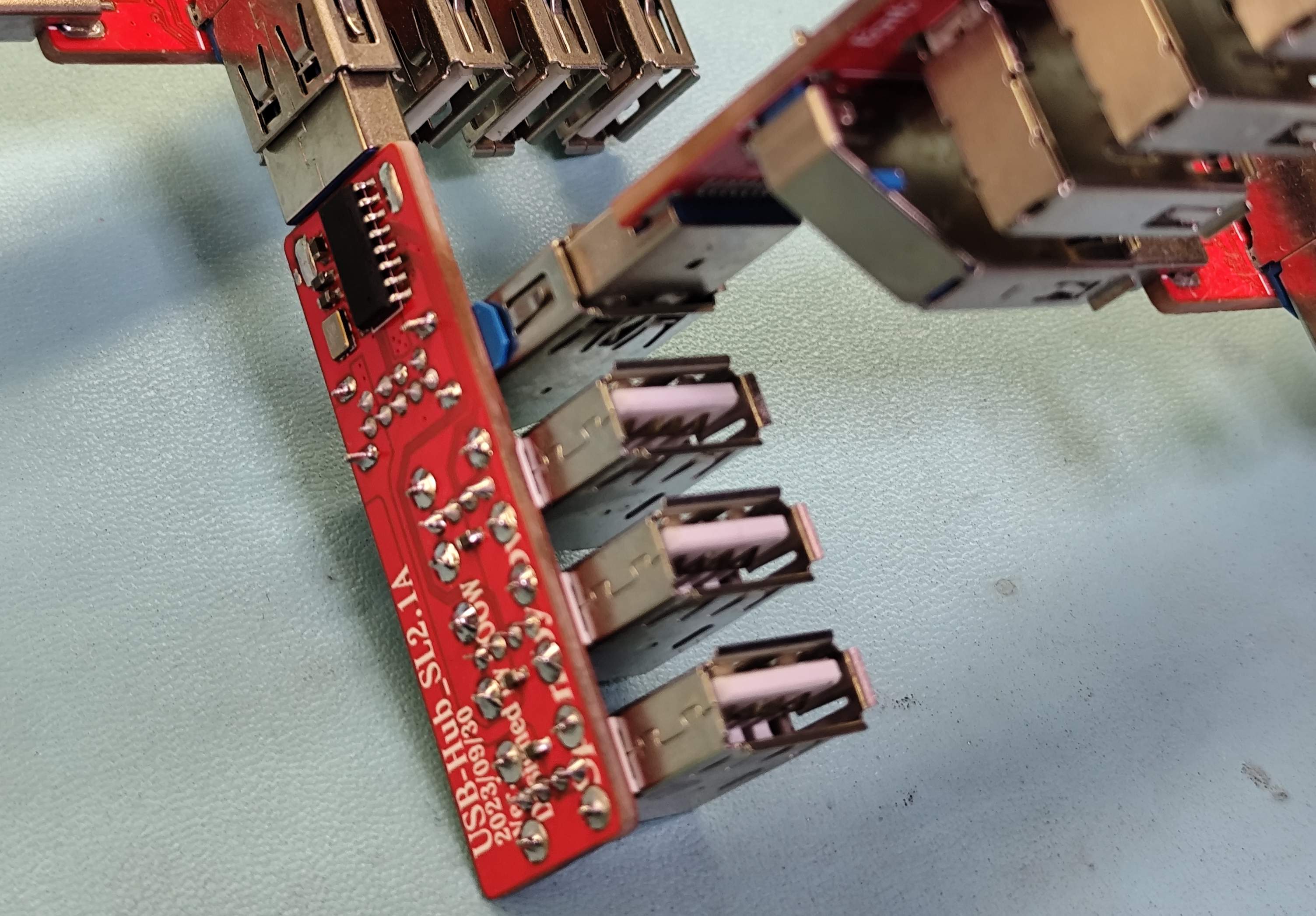

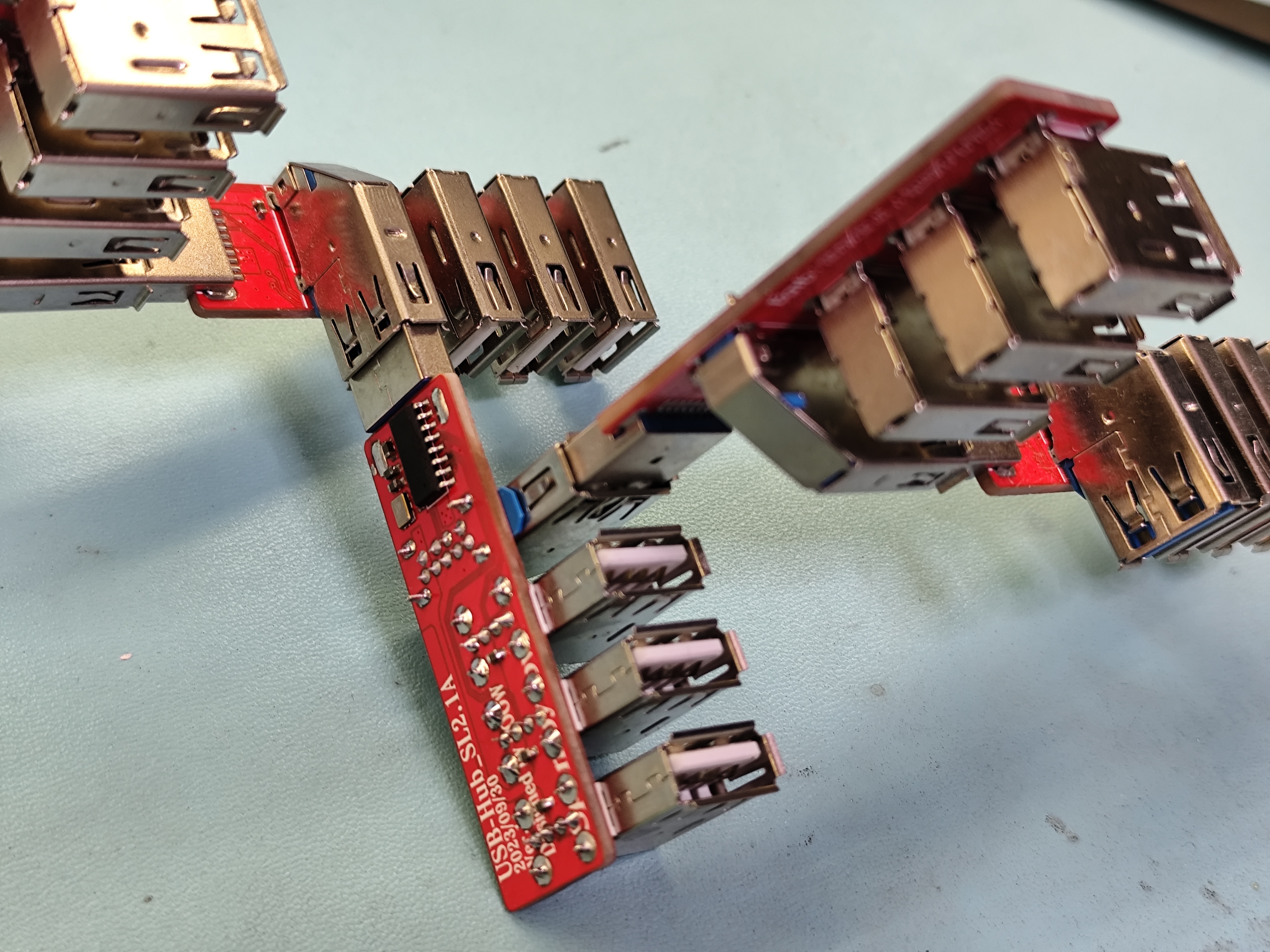

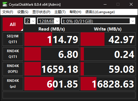

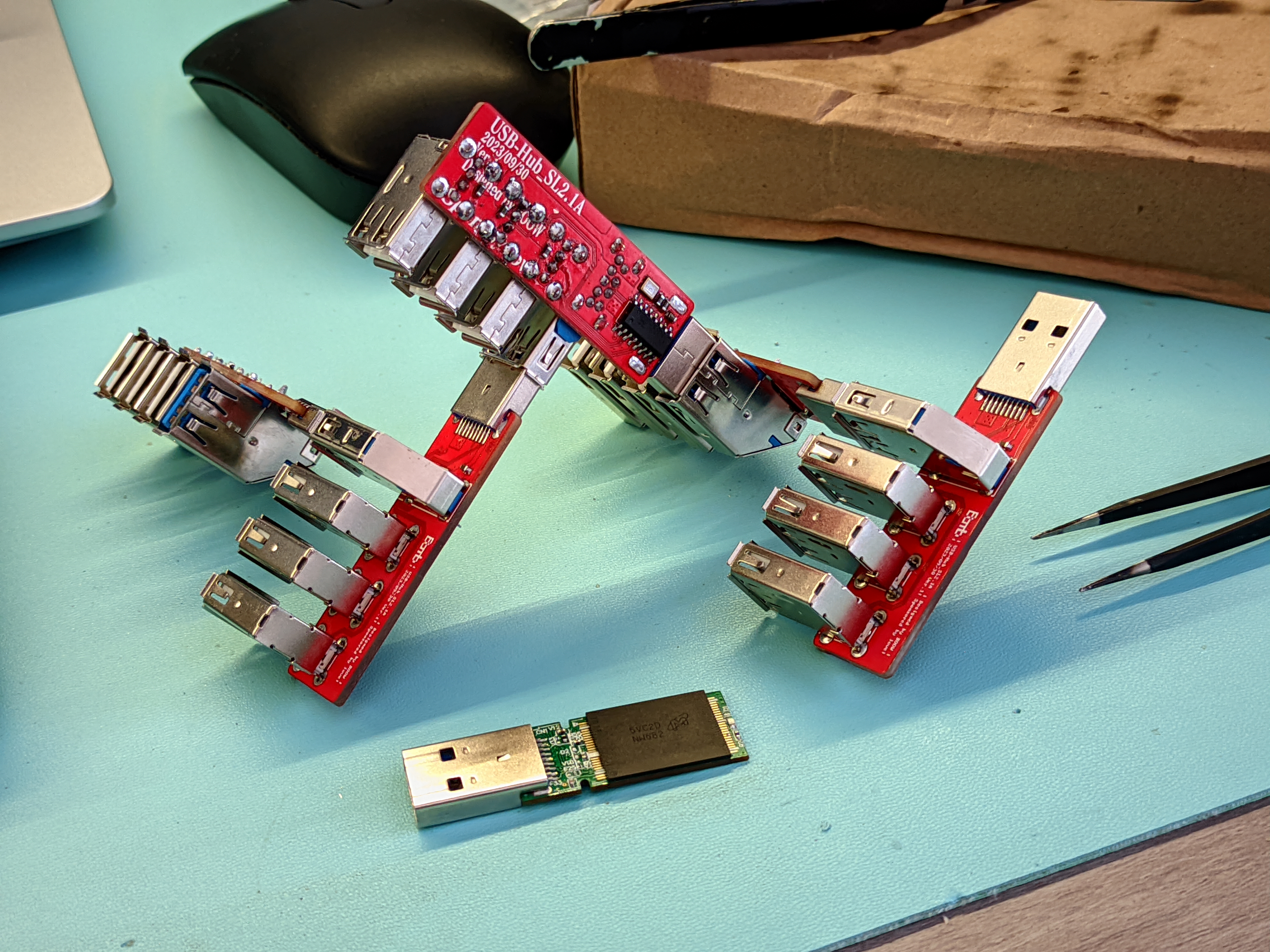

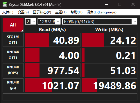

The test device uses an SL2.1A hub with 1 USB3 port and 3 USB2 ports.
The left image shows a direct connection to the computer, while the right image shows five
USB2 ports connected in series with the hub before connecting to the computer. The left image shows a direct connection to the computer, while the right image shows three USB3 ports connected in series with the hub before connecting to the computer. Connecting four USB3 ports in series is unstable, and five ports are not recognized.
The test used a self-made AU89103 single-layer NW682 flash drive, a Dell Inspiron 5493 computer running Windows 11.

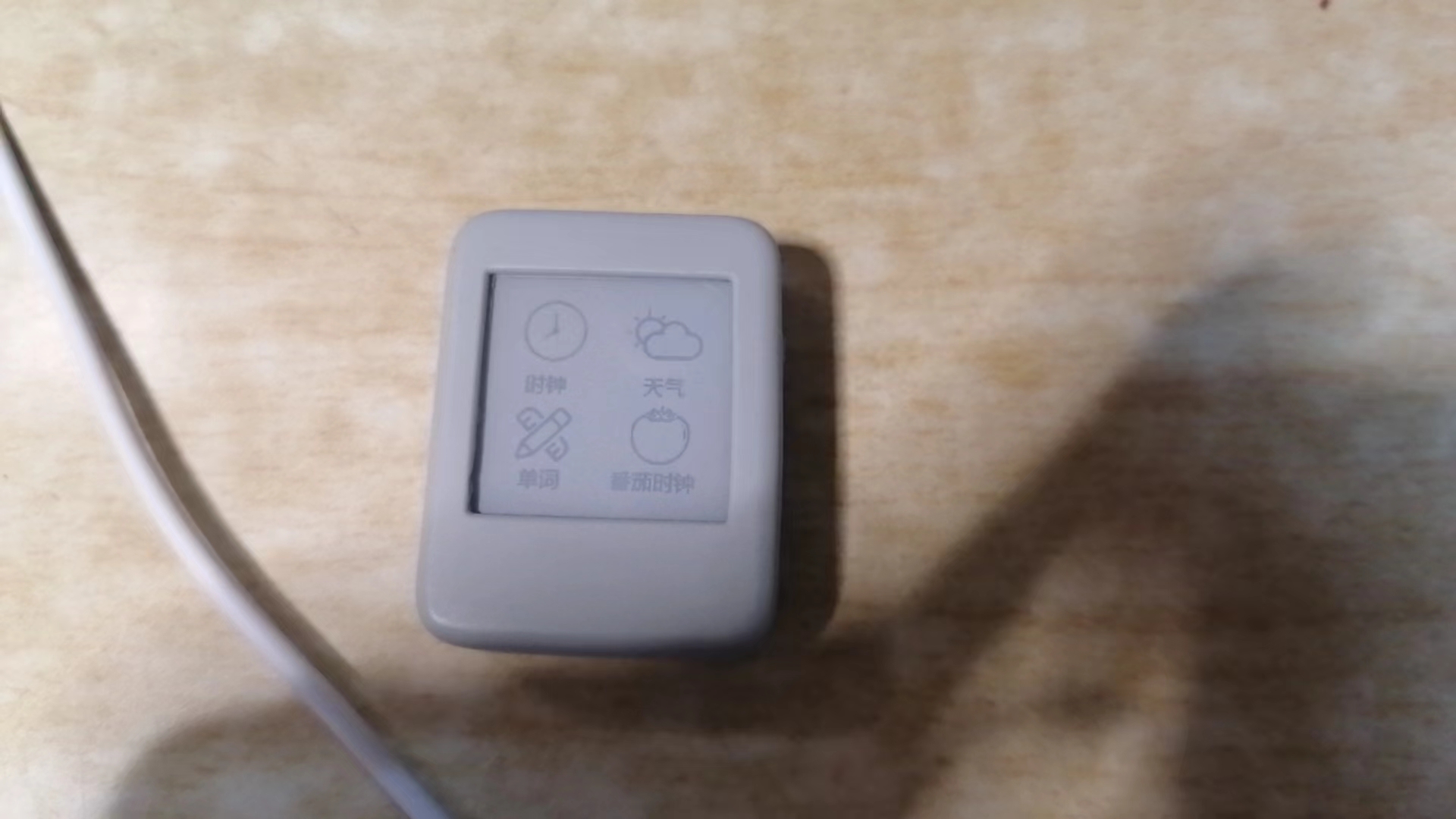

I originally planned to build this a year and a half ago, but various reasons delayed it. I didn't have time to compile the code slowly; I simply used burning software to burn the bin file provided by "Xiao Zhi Xue Chang" to run it.
The hardware PCB has been running smoothly in my hands so far without any failures. The only drawback is that the corners and USB port area don't quite fit the small screen casing, possibly requiring some trimming of the casing or PCB.

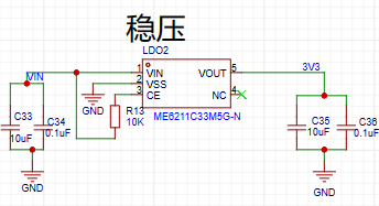

First, let's discuss the reasons for the changes. The main reason is that these are the only chips available, and I wanted to minimize expenses, especially since these chips are relatively inexpensive.

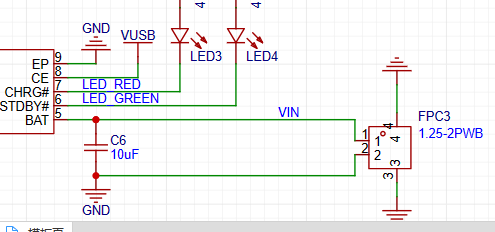

1. Voltage Regulator Chip: Changed to ME6111. Similar performance parameters to the original chip, but with a smaller package.

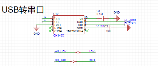

2. Serial Port Chip: Changed to CH304X, with a smaller package

     b. The large pad connecting to the power chip's power interface was removed, leaving only the 1.25mm pitch terminals and their pads.

VIII. Physical Display
