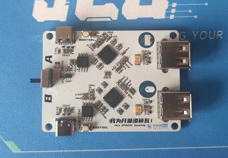

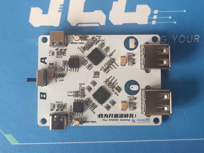

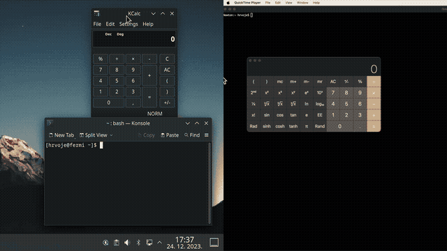

This is a small gadget for sharing a keyboard and mouse between two computers. Moving the mouse and keyboard allows for seamless switching between the two computers – it's incredibly smooth!
Original Git link: https://github.com/hrvach/deskhop.
I only redesigned the PCB; the open-source software is the same as the original author's.
Wired mice and 2.4G wireless mice have been tested and work without issue, but Bluetooth mice are not supported. For the keyboard, I tested a custom-made mechanical keyboard and a regular wired keyboard. The custom-made keyboard works fine in wired mode, but Bluetooth mode is not supported. Even my Dell wired keyboard doesn't work; it keeps pressing the spacebar, I don't know why!
Operating system tests included Win10, Win7, WinXP, and a domestic computer with a Loongson CPU and the NeoKylin operating system; all worked without problems. See the two attached videos for testing.
Usage:
1. Firmware flashing method: Switch to A, plug in the computer. A USB drive will appear on the computer. Copy the file board_A.uf2 to the newly created RP USB drive!
                            Switch to B, plug in the computer. A USB drive will appear on the computer. Copy the file board_B.uf2 to the newly created RP USB drive!
2. Usage: Connect the Type-C cable to port B on the computer on the left, and to port A on the computer on the right. The power switch can be set to either A or B; whichever computer it's on will power the entire device, keyboard, and mouse. Moving the mouse from right to right on computer B will display it on computer A's screen, and the keyboard and mouse will then work on computer A. Conversely, moving the mouse from left to left on computer A will display it on computer B's screen, and the keyboard and mouse will work on computer A.

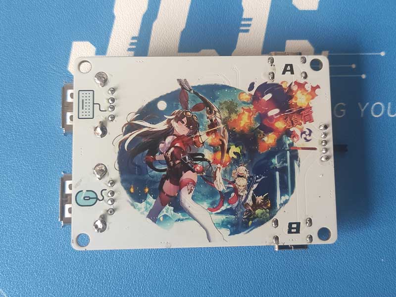

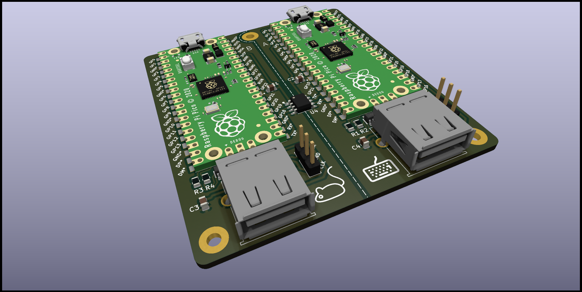

Original PCB: Used two Pico development boards as the baseboard!
My PCB: Based on two RP2040 chips, much smaller and more elegant!

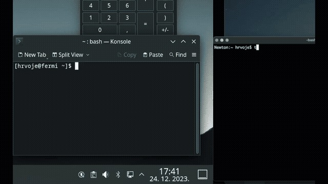

To get the mouse cursor to magically jump across, the mouse hid report descriptor was changed to use absolute coordinates and then the mouse reports (that still come in relative movements) accumulate internally, keeping the accurate tally on the position.
When you try to leave the monitor area in the direction of the other monitor, it keeps the Y coordinate and swaps the maximum X for a minimum X, then flips the outputs. This ensures that the cursor seamlessly appears at the same height on the other monitor, enhancing the perception of a smooth transition.
Dragging the mouse from Mac to Linux automatically switches outputs.
The actual switch happens at the very moment when one arrow stops moving and the other one starts.

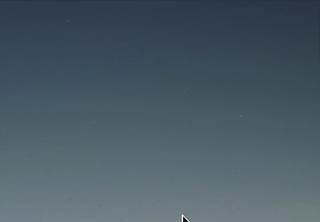

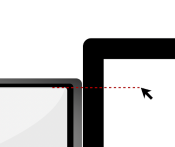

Switch cursor height calibration
This step is not required, but it can be handy if your screens are not perfectly aligned or differ in size. The objective is to have the mouse pointer come out at exactly the same height.
Just park your mouse on the LARGER screen at the height of the smaller/lower screen (illustrated) and press Right Shift + F12 + Y. Your LED (and caps lock) should flash in confirmation.
Repeat for the bottom border (if it's above the larger screen's border). This will get saved to flash and it should keep this calibration value from now on.

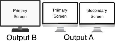

Multiple screens per output
Windows and Mac have issues with multiple screens and absolute positioning, so workarounds are needed (still experimental). Your main screens need to be in the middle, and secondary screen(s) on the edges. Move the mouse to the screen with multiple desktops and press right shift + backspace + 2 if you have 2 desktops and right shift + backspace + 7, 8 or 9 depending on your OS (Linux, Windows, Mac).
