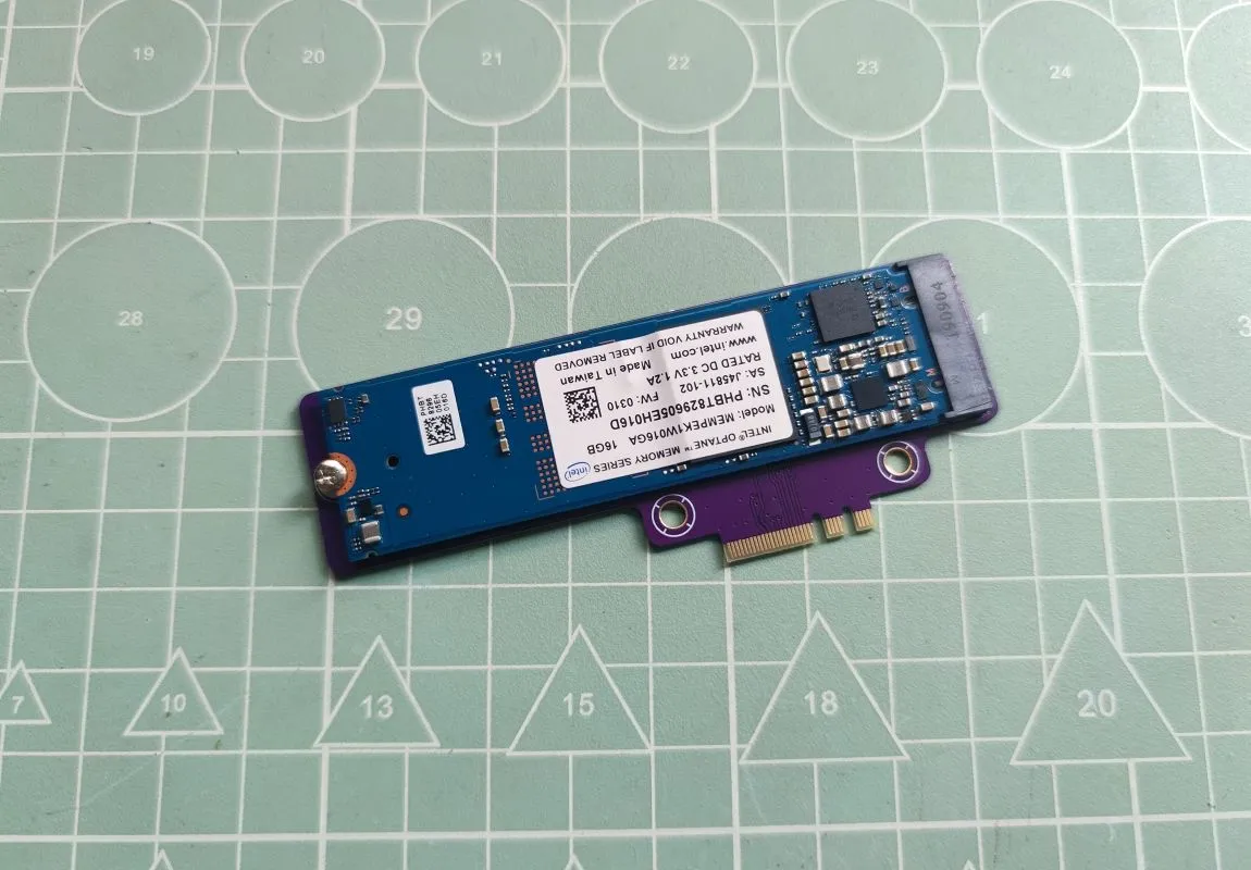

Figure 1: Front of the adapter module (with Optane 16G hard drive inserted)
Figure 2: Front of the adapter module
Figure 3: Back of the adapter module
Figure 4: Installation Image 1
Figure 5: Installation Image 2

Verification images are shown below (correctly recognized in BIOS, subsequent verification shows entry into the PVE system):
Figure 6: Verification Image
