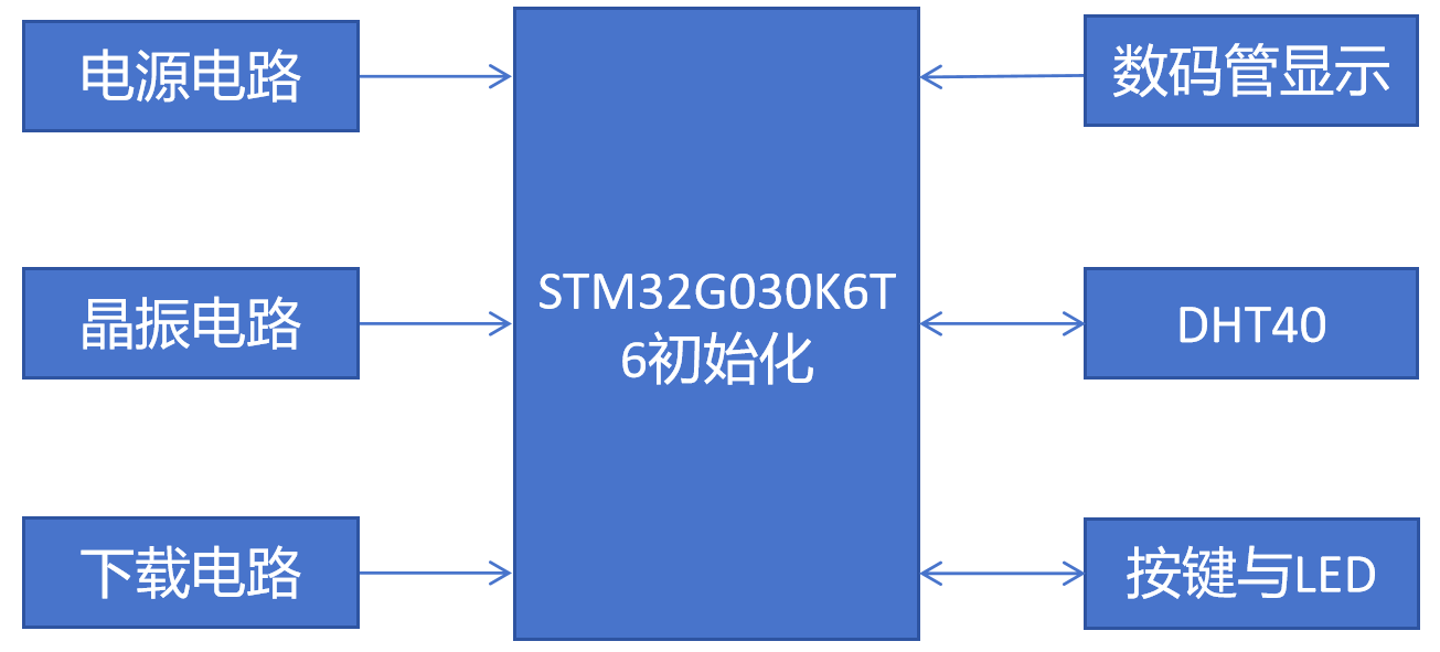

V. Overall Design Block Diagram
The following is the overall design block diagram of the system.

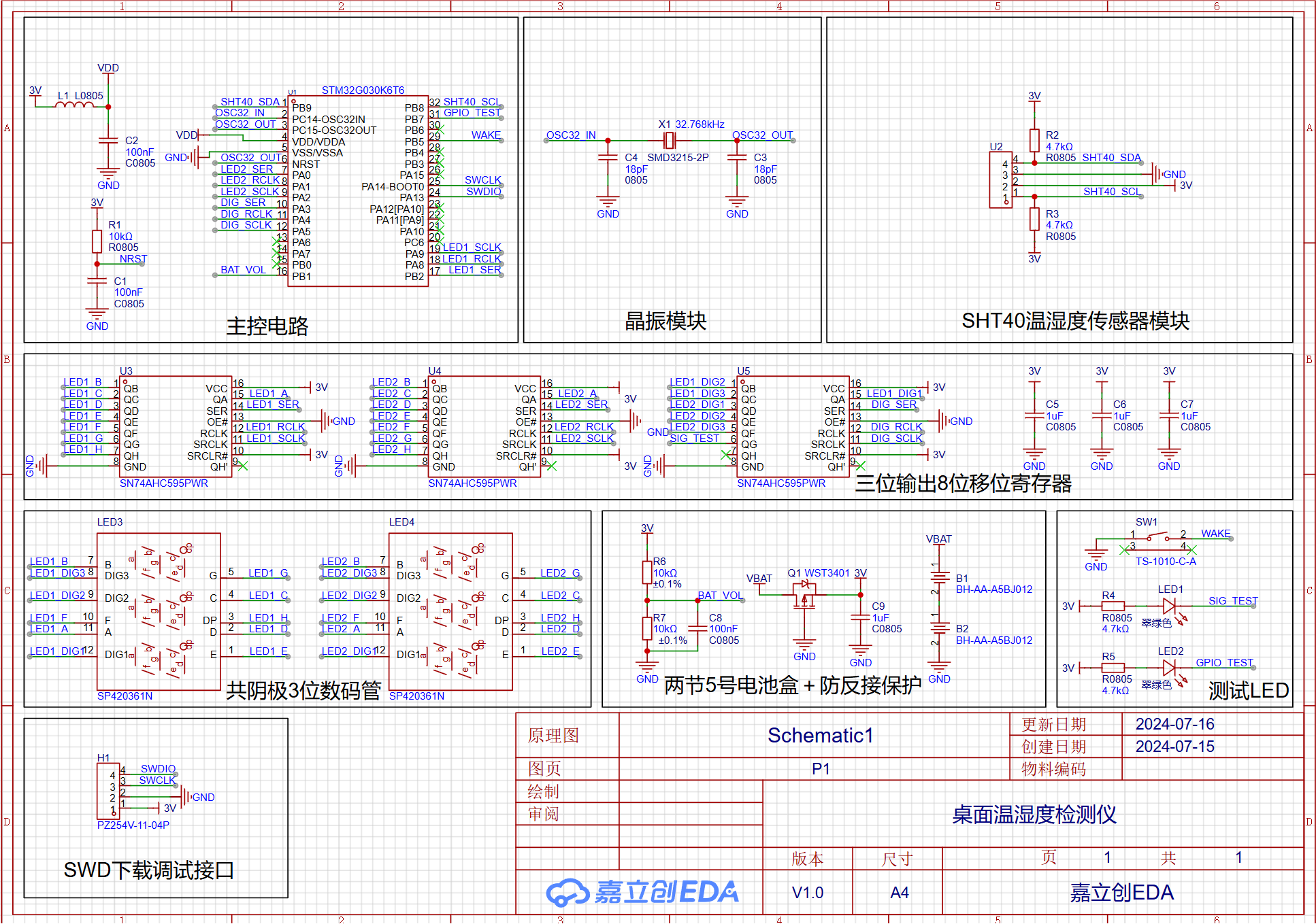

VI. Hardware Circuit Composition
The following is the PCB schematic of the hardware circuit, mainly including the main control circuit, crystal oscillator module, SHT40 temperature and humidity sensor module, three-digit output 8-bit shift register, common cathode 3-digit digital tube, two AA battery boxes + reverse connection protection, test LEDs, and SWD download and debugging circuit.

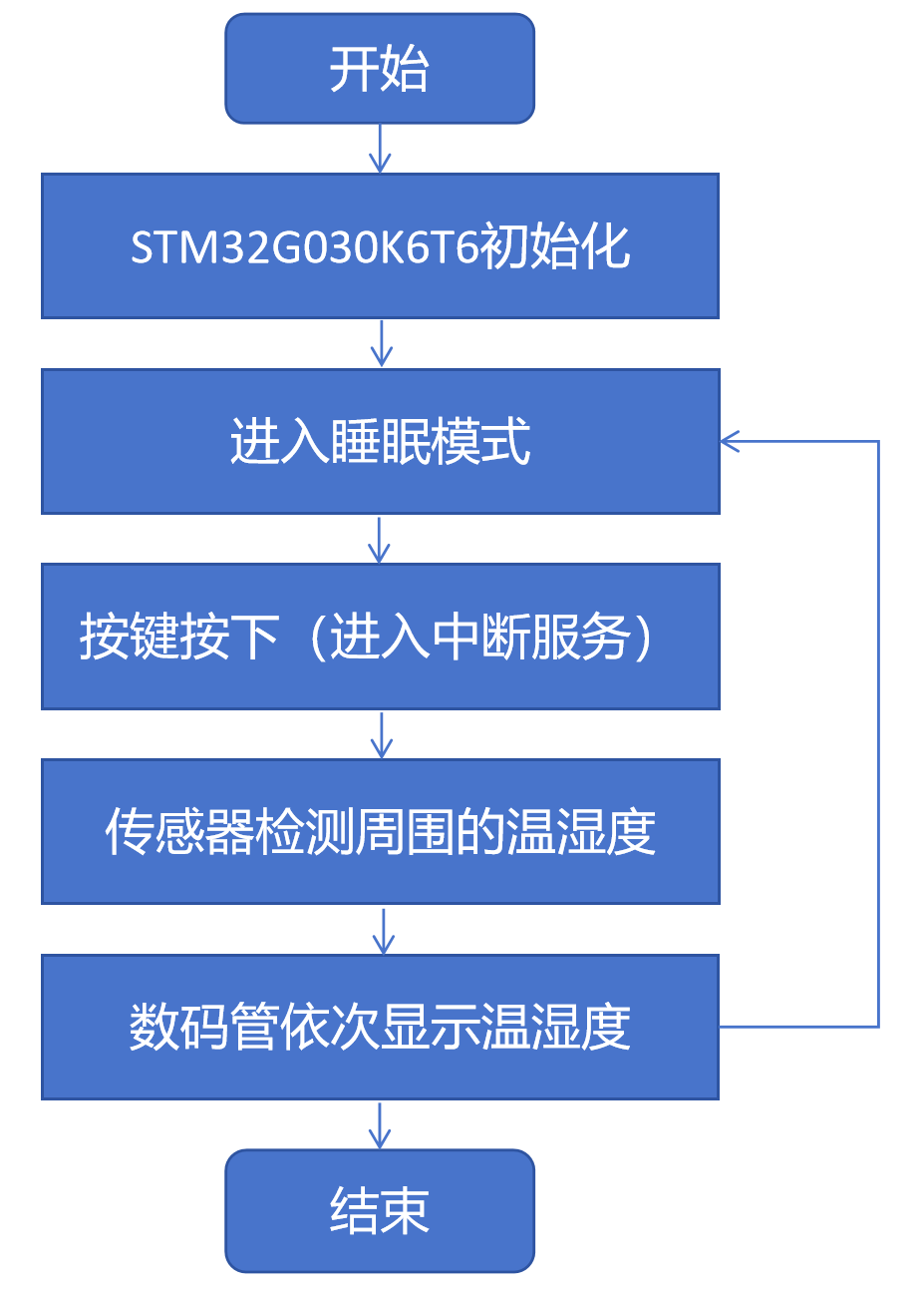

VII. Program Flowchart
The following is the software program flowchart of the system.

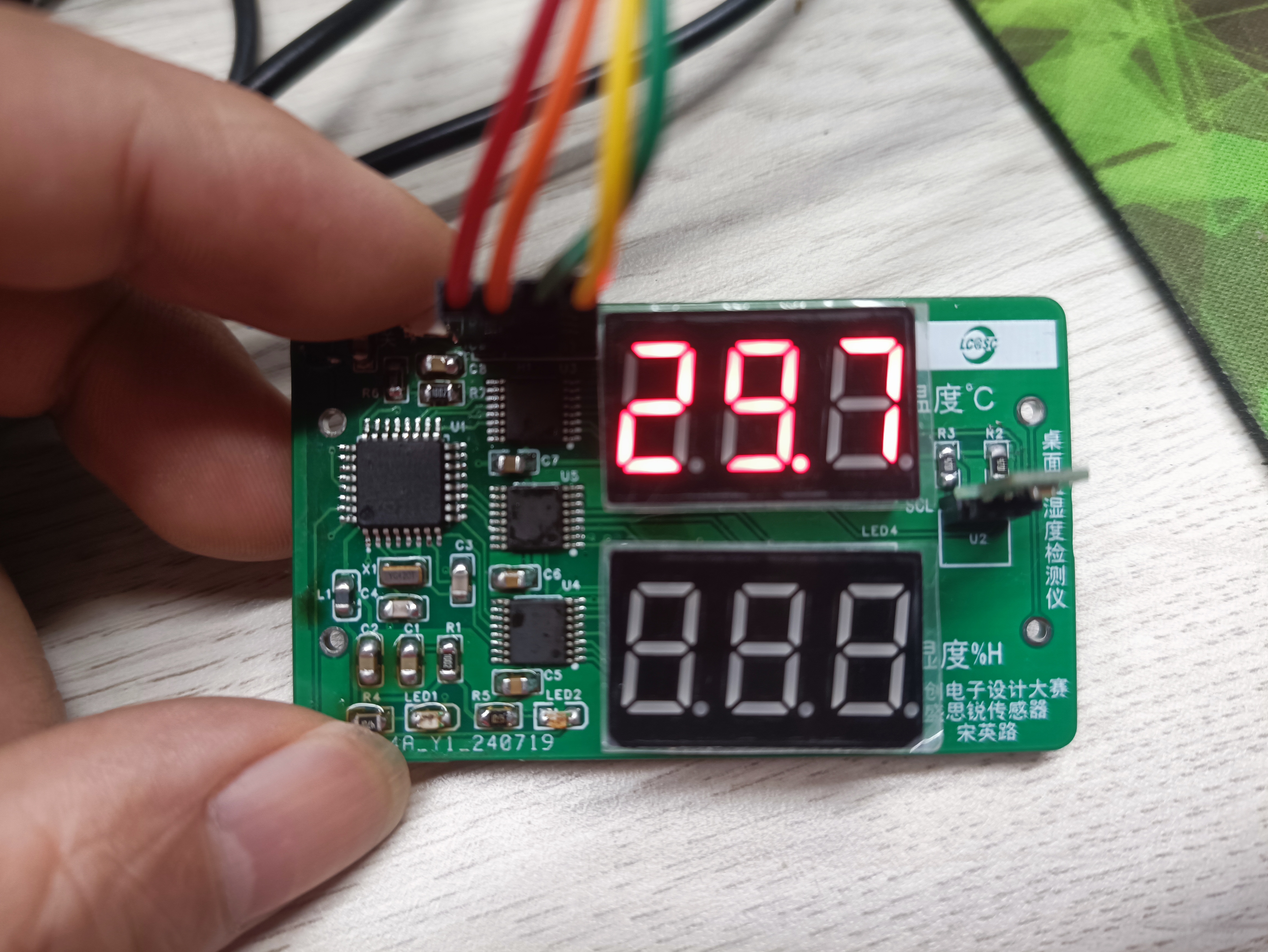

VIII. Physical Demonstration
IX. Precautions
Solder from smallest to largest, pay attention to the positive and negative terminals of the LEDs, and select the corresponding download module when downloading the circuit.
