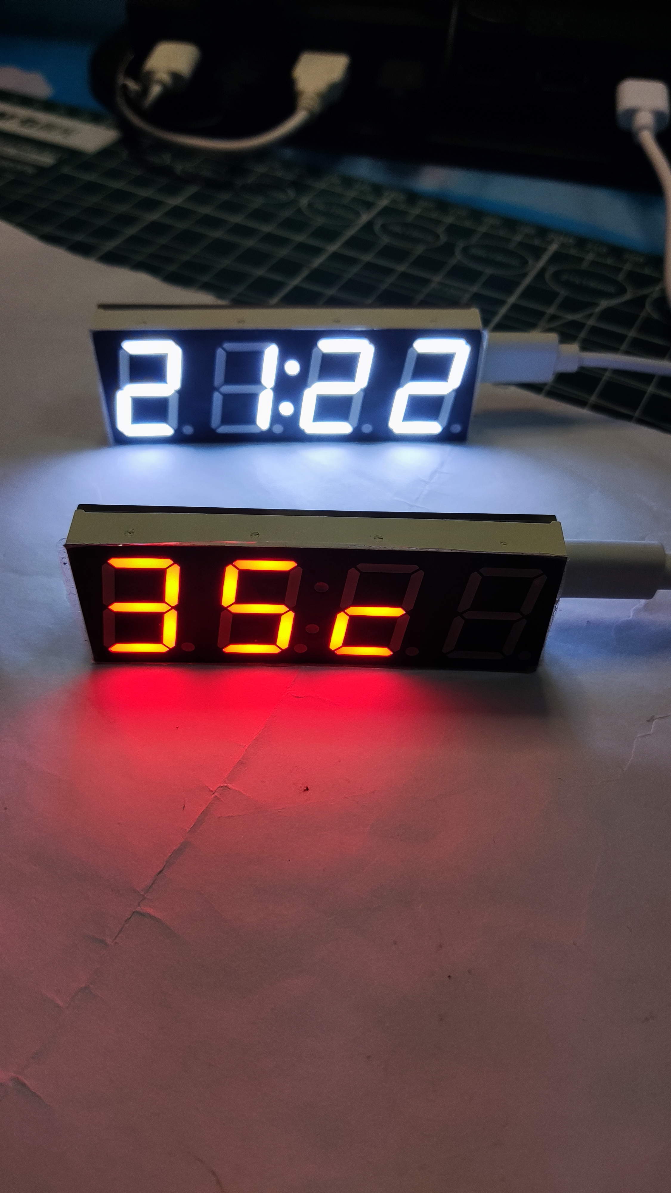

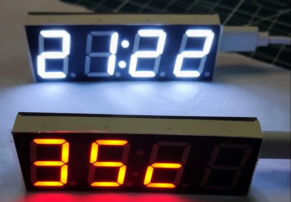

0.8-inch TM1650 Desktop Electronic Clock and Thermometer (Fully Upgraded Version)
The TM1650 can adjust the brightness of the digital tube using PWM and can be used as a button. It can also expand the microcontroller's I/O. For constant current driving, the common cathode digital tube must be selected.
A solution for a black screen on the digital
tube is as follows: Strangely, if the "Clear EEPROM after download" option is checked when using the STC programming software, the digital tube will not light up. This issue has not been observed in DIY projects using this microcontroller base. It's possible that the TM1650's button scanning is causing a bug. The solution is as follows: Download twice. Before the first download, add "//" before "eeprom_init();" in the main page to block it. Also, check the "Clear EEPROM" option in the download software. Before the second download, remove the `eeprom_init();` comment from the main page and uncheck the EEPROM box in the programming software. After the second download, it will light up and function normally.
A brown acrylic shell has been added for a softer lighting effect.

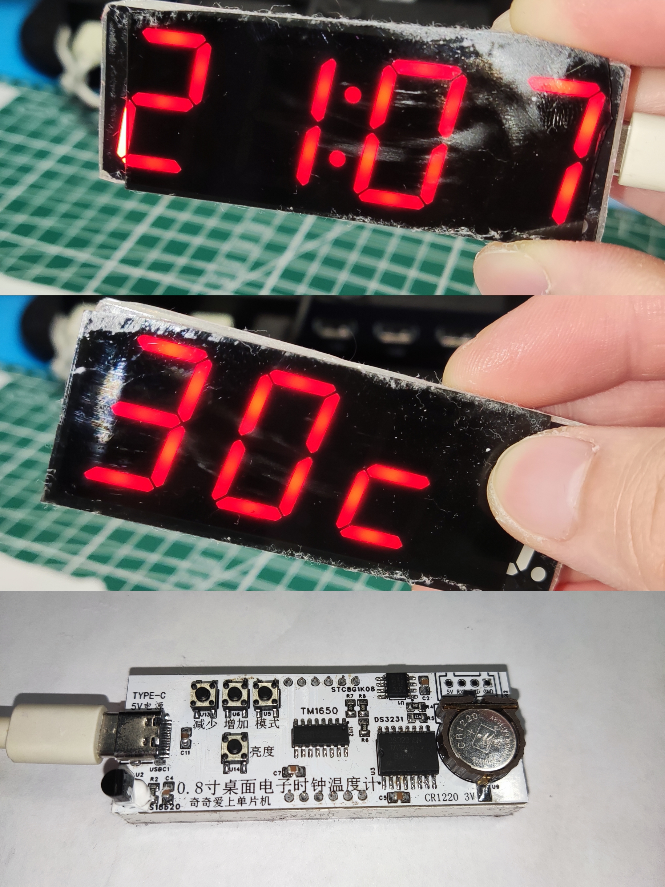

//The source code and PCB for the above works are publicly available. Search for the username "奇奇爱上单盘机" on the "LCSC Open Source Hardware Platform". //Microcontroller model: STC8G1K08 1. When programming, be sure to select built-in IRC=30MHz. 2. Set the reset pin to the IO port. 3. Uncheck the option to erase the user EEPROM area when downloading the user program.
