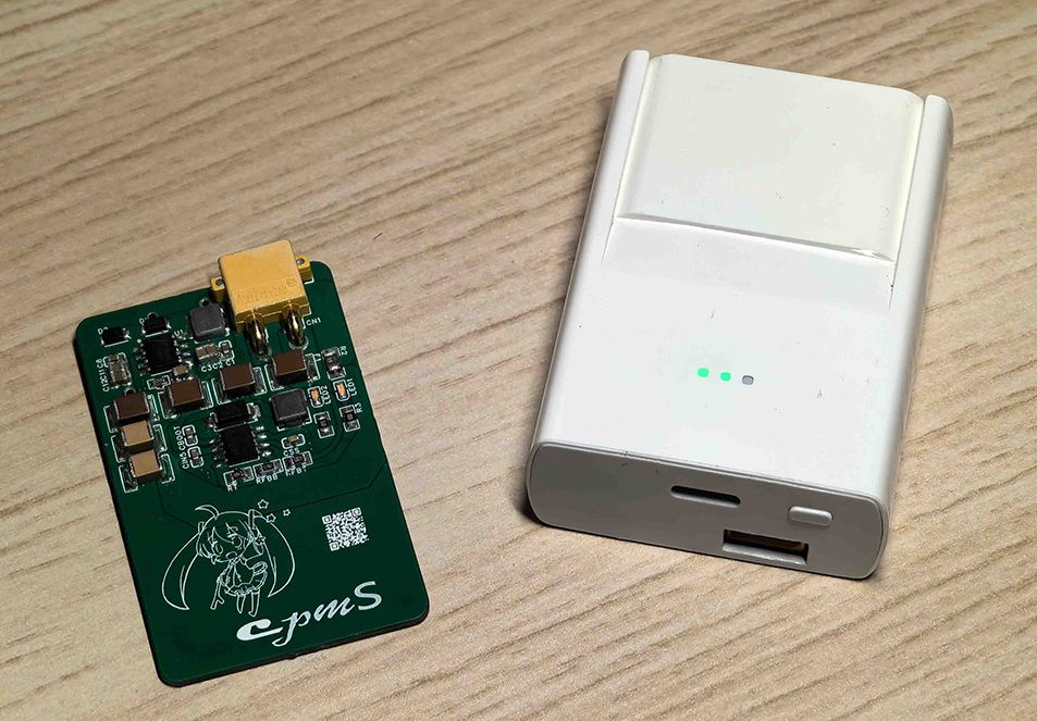

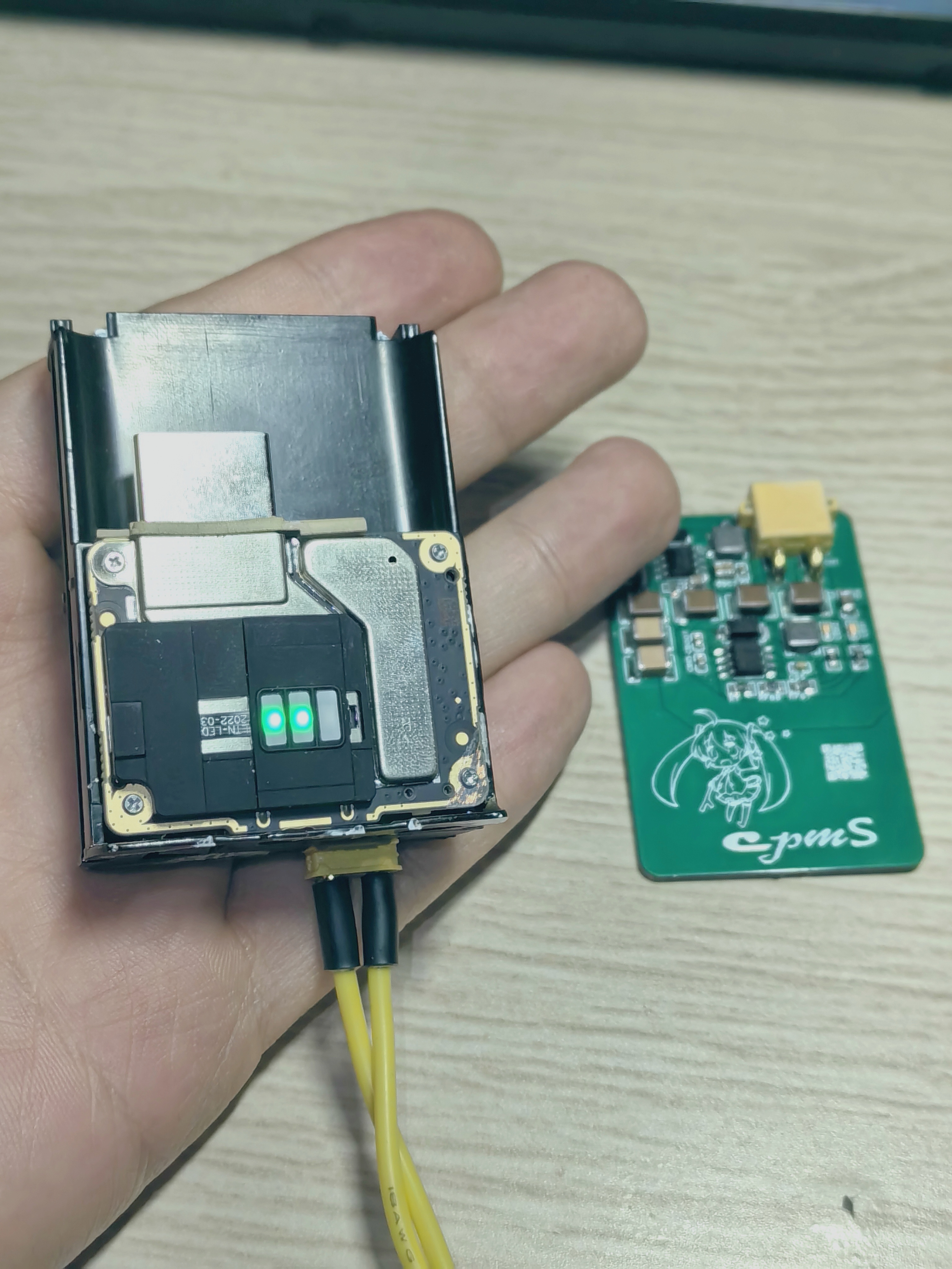

XREAL AR glasses adapter with modified power board for simultaneous use and charging.
The adapter uses an LMR14030 to provide a wide 4-40V input voltage, initially stepping down to 5V; then a TP4510 steps down to 4.2V, providing battery protection.

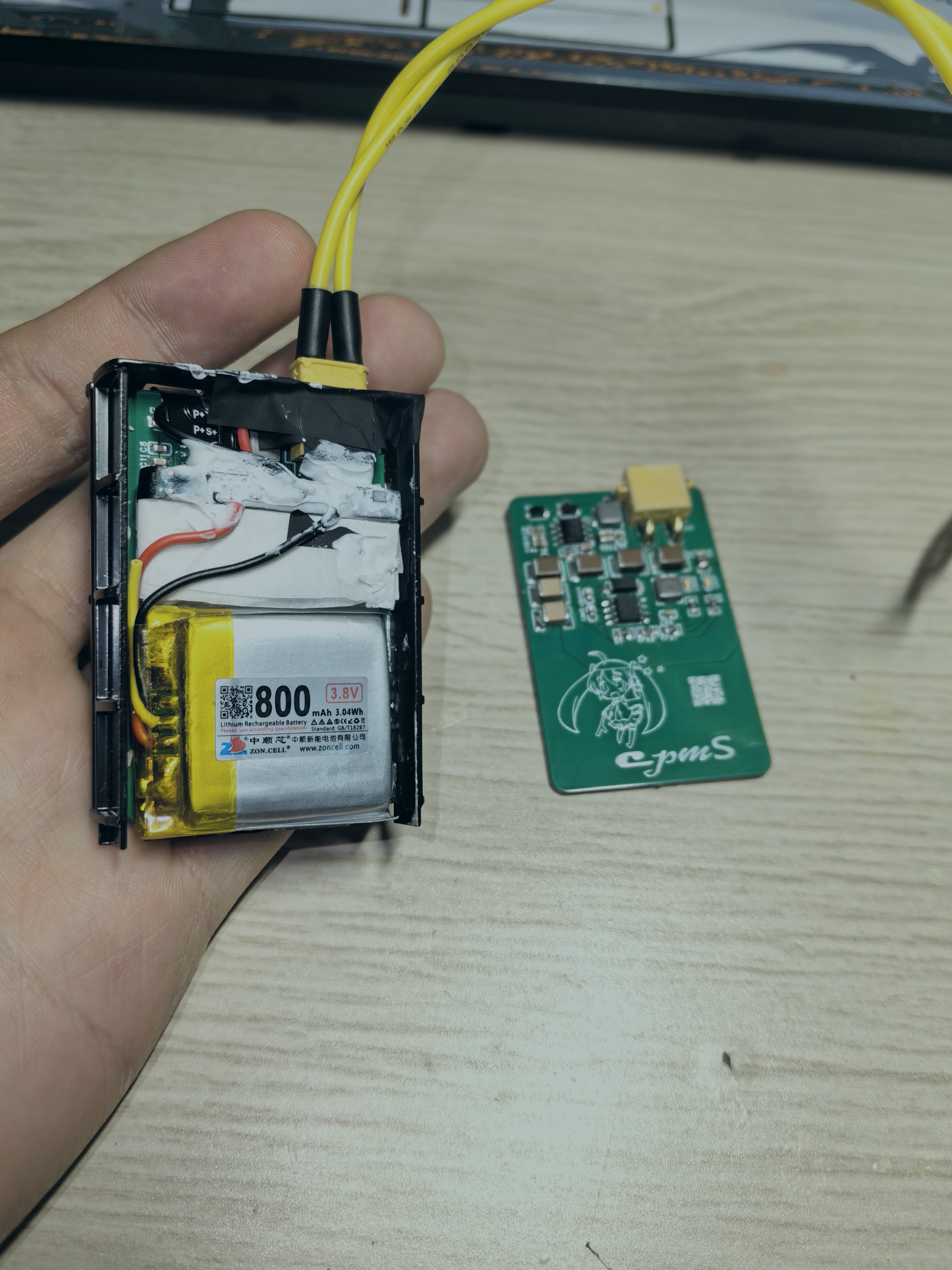

The lower half of the adapter houses a large battery, providing ample space on the power board, even allowing room for a small battery
! [Image 1]
[Image 2] This does not affect the adapter's battery indicator lights (the original battery is a high-voltage lithium battery; the power board uses a TP5410 with a charging cutoff voltage of 4.25V, so even when fully charged, only two indicator lights will illuminate)

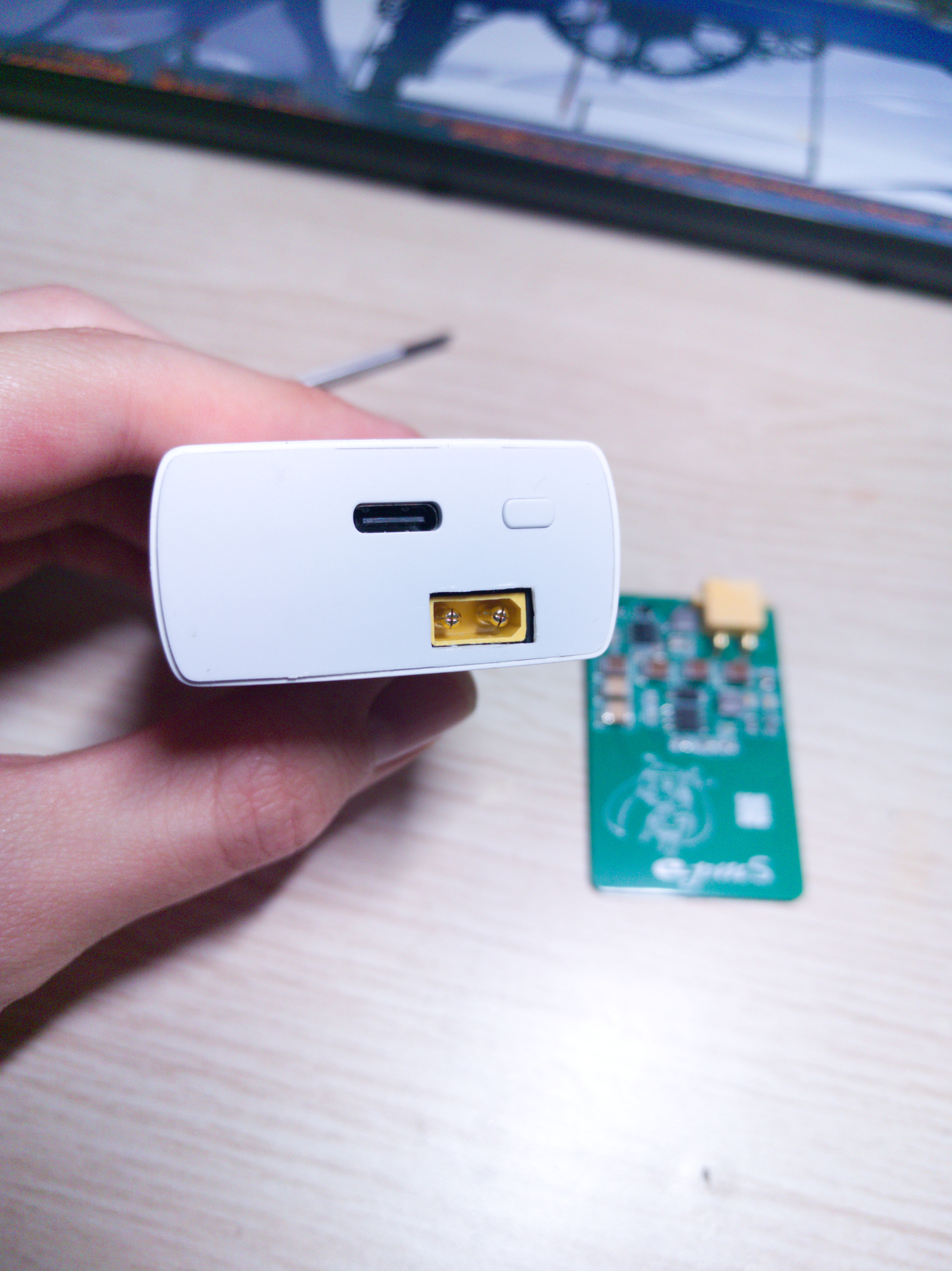

. [Image 3] The side panel has an opening, using an XT30 as the power input interface

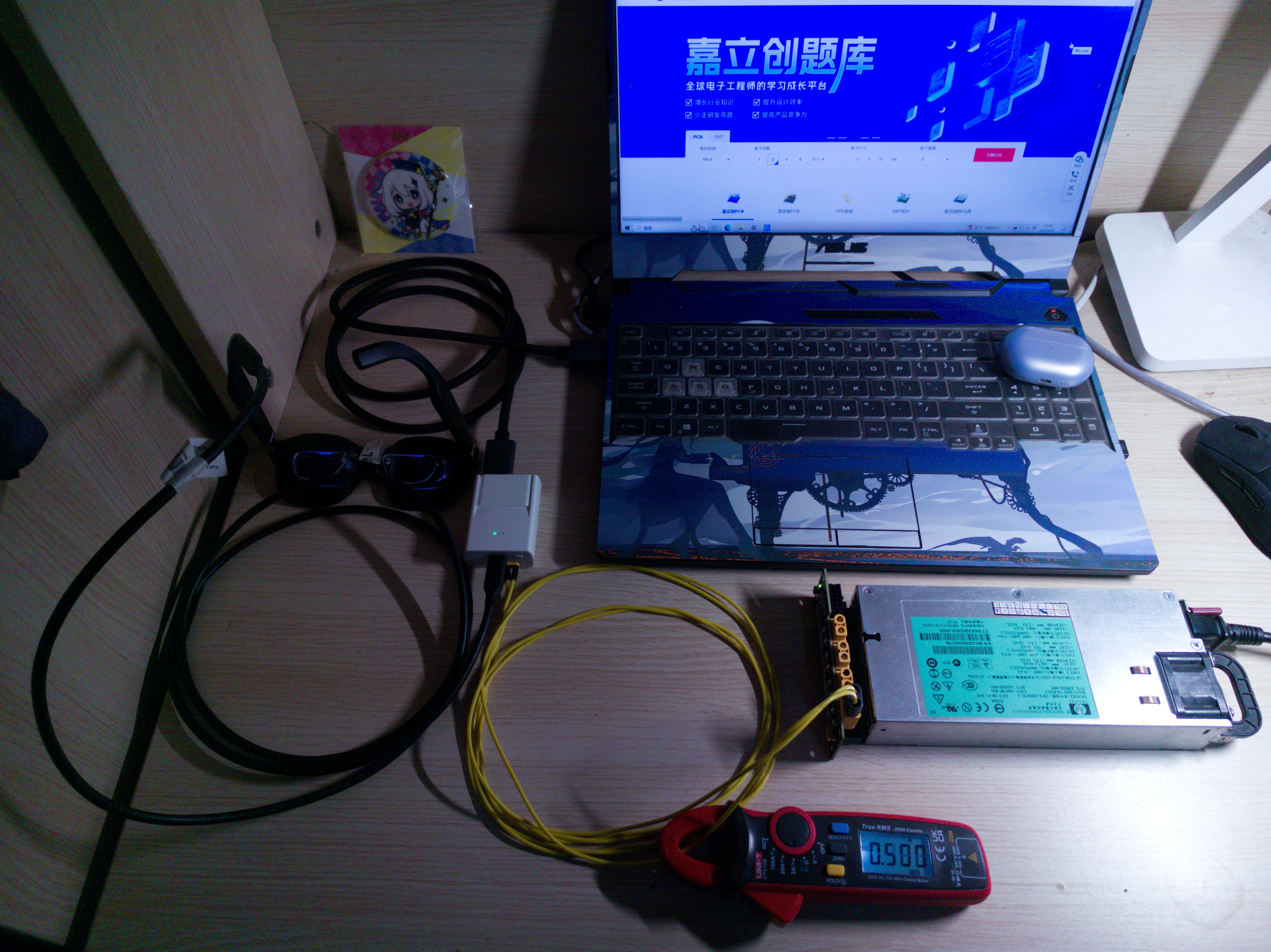

. [Image 4] Overall connection effect; using a 12V input, the battery current is 1A.
[Image 1]
[Image 2] The glasses display is normal, with no flickering
. [Image 3] [Image 4]

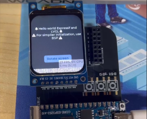

ESP32S3 drives ST7789/ST7735/ILI9341 screens
This program implements the ESP32S3 to drive the screens of ST7789/ST7735/ILI9341, controlling these LCD screens via LVGL to display images, text, and other information.
Connecting the screen using DuPont wires is too cumbersome, so I drew a simple driver board.
