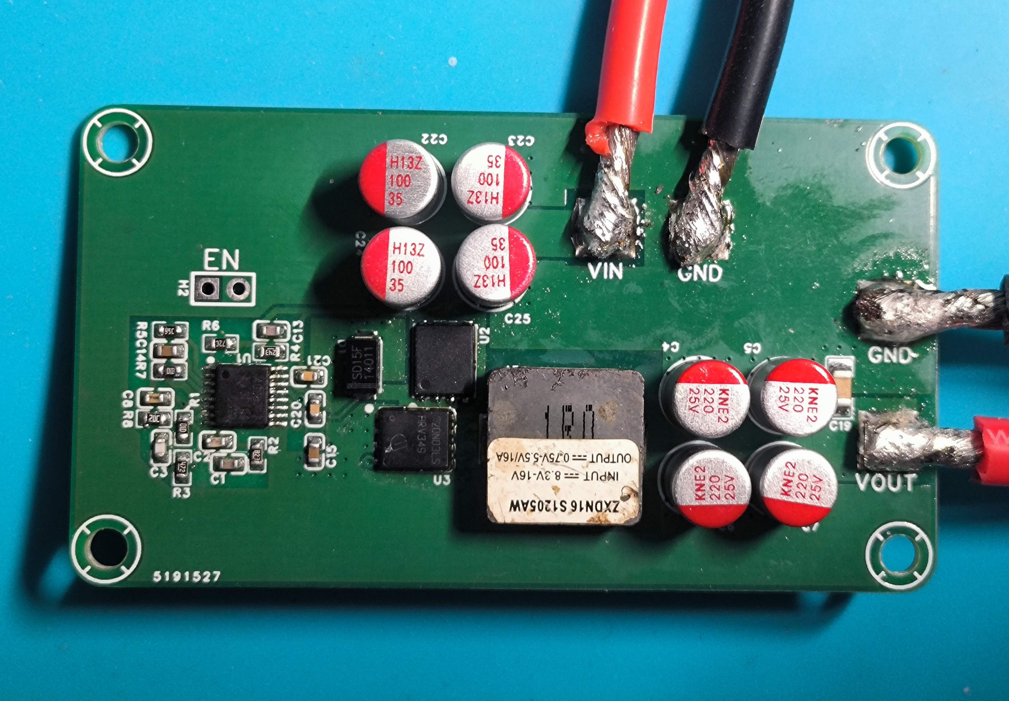

TPS40057 Solution Verification (5V Output)
Vin=12.2V (25V max) Vout=5.1V Iout=16A (max)

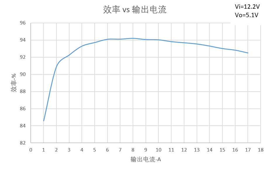

Efficiency>90% (5A) Ripple Voltage
Graph Efficiency vs Output Current

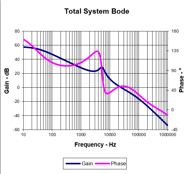

Graph System Bode Plot (FCO actual=23885Hz; Phase at FCO=53.8°)

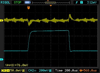

Graph Load Dynamic Response Test Conditions: Vin=12.2V; Vout=5.1V; Iout=2.0A -> 7.0A -> 2.0A; dI=3A/us; CH1=VOUT; CH2=IOUT
Note:
The inductors, high-side/low-side MOSFETs, dummy load (510Ω resistor), diodes, and TPS40057 controller used in the module can all be obtained from ZTE power modules (ZXDN16S1205).

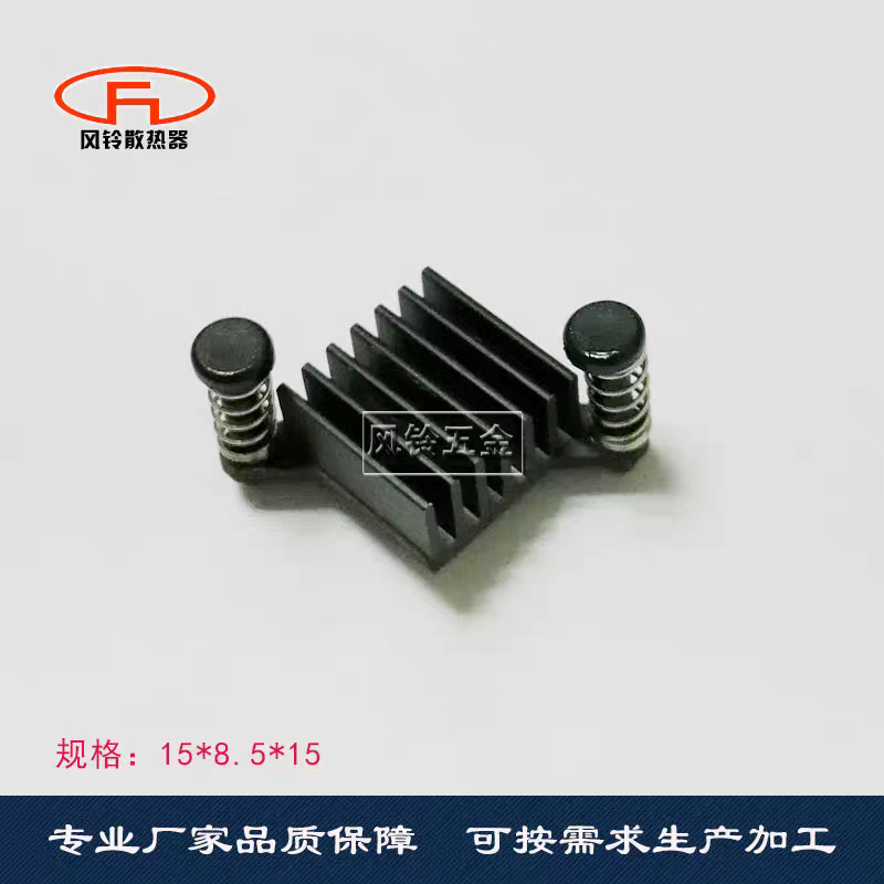

A heatsink location has been added in version V0. A 15*8.5*15 clip-on heatsink can be selected, available on Taobao.
Compensation parameters.xlsm
TPS40057 Verification Board Test Data - Copy.xlsx
PDF_TPS40057 Solution Verification (5V Output).zip
Altium_TPS40057 Solution Verification (5V Output).zip
PADS_TPS40057 Solution Verification (5V Output).zip
BOM_TPS40057 Solution Verification (5V Output).xlsx

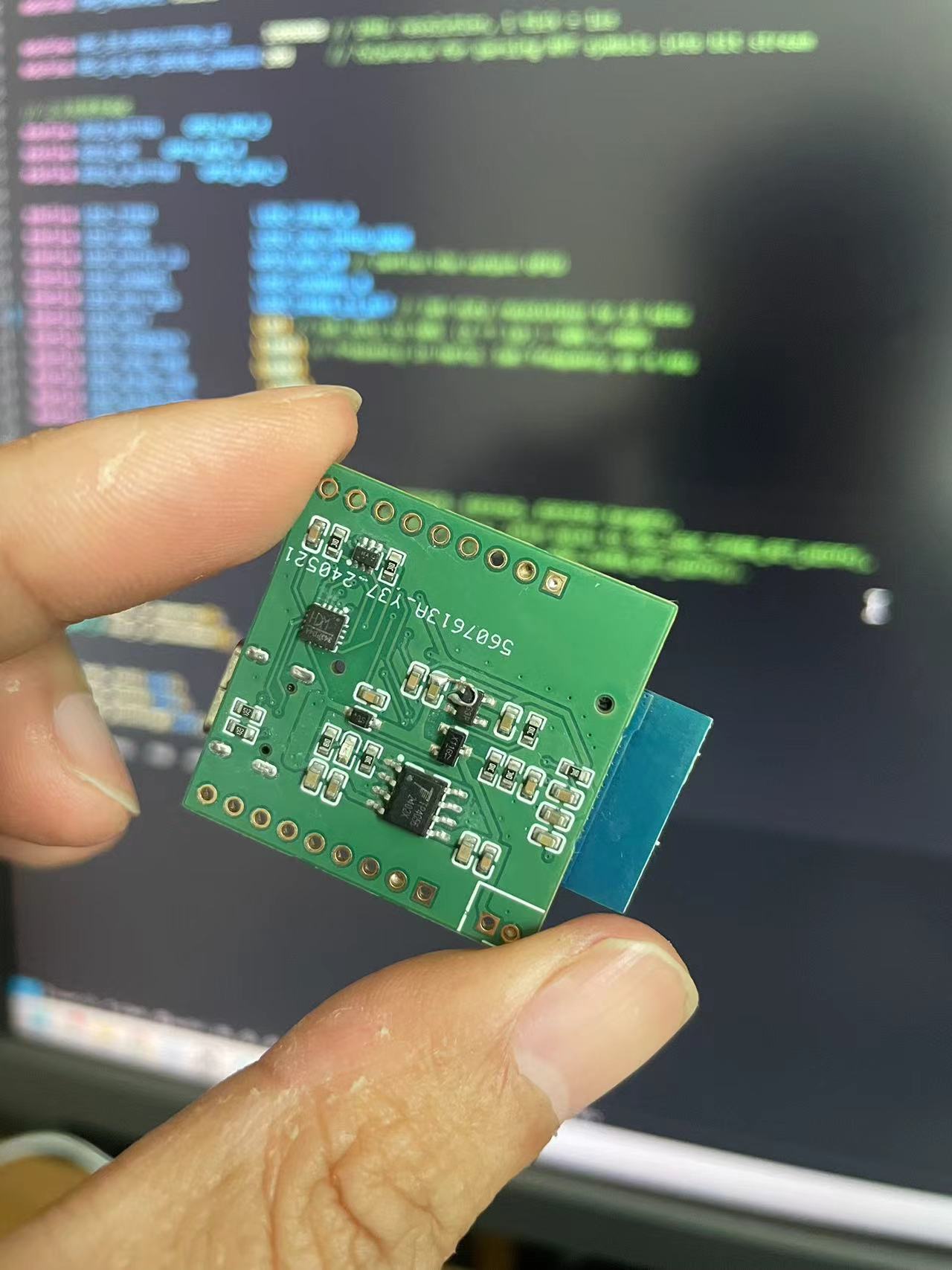

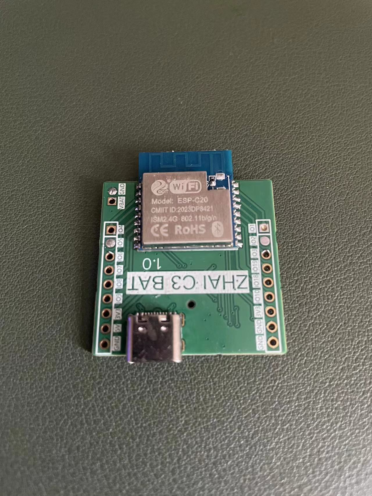

My recent projects have all been based on lithium battery charging, so I integrated the charging chip. Considering the limited pins on the ESP32C3, I introduced a serial port chip, reserving USB pins 18 and 19 for application use. The bug with the flying wire in the screenshot
regarding GPIO 0 voltage detection has been resolved.

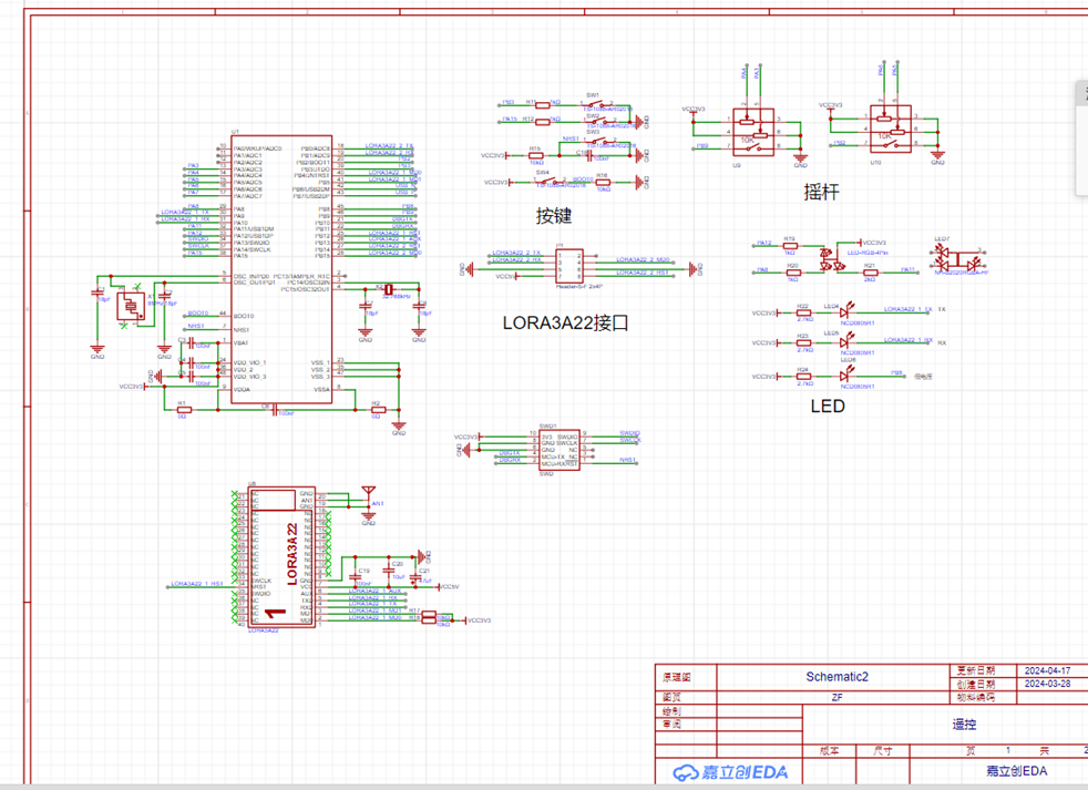

This project utilizes the CH32V203C8T6 wireless remote control, which can be paired with the custom-designed LORA3A22 module from Zhufei to create a wirelessly controlled car. It can be used in the 19th National Intelligent Car Competition.
This project is a wireless remote control based on the CH32V203C8T6, which can be used with the customized LORA3A22 module from Zhufei to realize a wireless remote-controlled car. It can be used in the 19th Intelligent Car Competition.

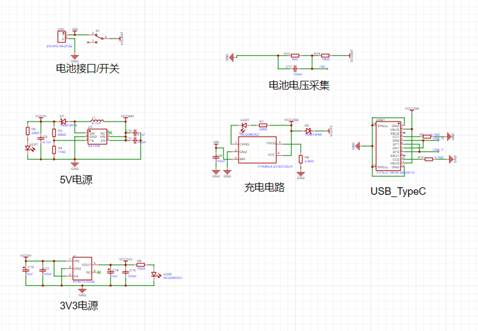

Schematic diagram:
I. The remote control supports Type-C power supply or 1S lithium battery power supply, and has a built-in charging circuit, which can charge the 1S lithium battery via Type-C. It supports low battery voltage indication, LED indication of working status, etc.
II. It uses the TP4065 battery charging chip. The TP4065 is a complete lithium battery charger. It has the following advantages: 1. World's first single chip with reverse polarity protection for battery positive and negative terminals and reverse polarity protection for input power supply. 2. The maximum charging current can be set to 600mA, which is set to 500mA in this project. 3. It automatically performs trickle, constant current, and constant voltage control. 4. The SOT23-5 package and fewer external components make the TP4065 an ideal choice for portable applications.
III. The wireless module uses the customized LORA3A22 module from Zhufei Technology, which has the following advantages: 1. Supports sleep mode with a sleep current as low as 2.4uA. 2. High transmit power, up to 22dBm. 3. Maximum transmission distance up to 5km. 4. Wide baud rate range: 1200bps to 115200bps. 5. Eight-level adjustable airspeed: 1.2 to 62.5kbps. 6. Adjustable wireless frequency from 410 to 525MHz, with 116 channels.
PCB Design
: PCB size within 10*10.
Line Spacing: High-current lines are treated with large-area copper plating; power lines are 30mil, signal lines are 10mil.
Copper Silkscreen: Indicates power, download, peripheral interfaces, and serial port, and adds the project name and logo.
Circuit Debugging and
Soldering: Solder the switch and each power module first, testing after soldering one power module. This ensures that each module is problem-free, and makes troubleshooting easier when problems occur.

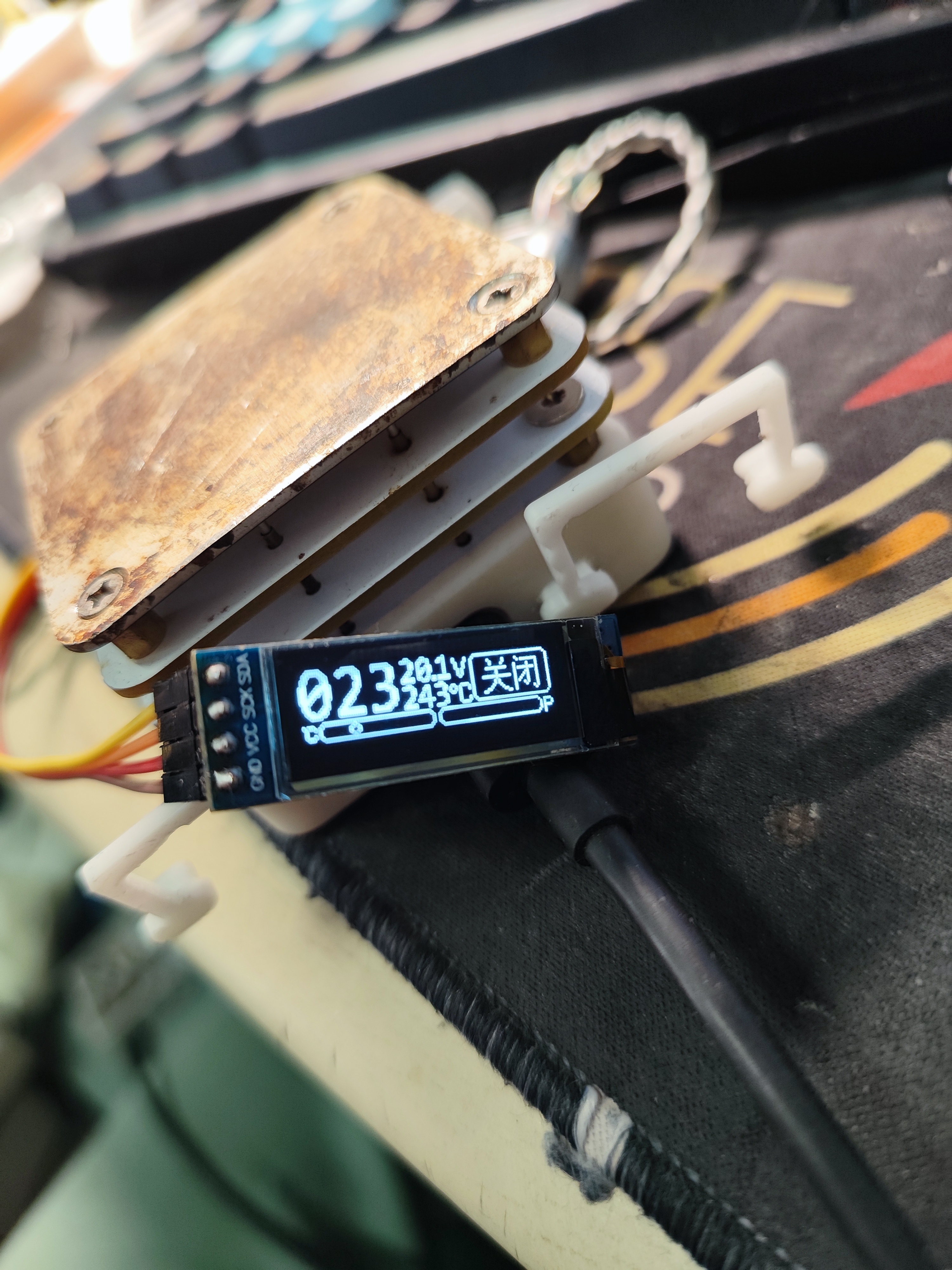

320W Desktop Charging Station
A charging station with a single DC input and a maximum output of 320W, supporting fast charging protocols such as PD100W/PD65W/QC/VOOC.
This small, high-power charging station is built using the Zhirong SW318S/SW3526 and Ingenic IP6505T chipsets. It features
1*PD 100W, 2*PD 65W, and 4*24W
outputs, with a maximum input voltage of 32V. Multiple ports offer independent output, supporting all charging protocols including PPS/PD3.0/PD2.0/QC4+/QC4/QC3.0/QC2.0/AFC/FCP/VOOC.
The station is compact, with a PCB size of 58*100mm and a thickness of approximately 23mm after casing. While

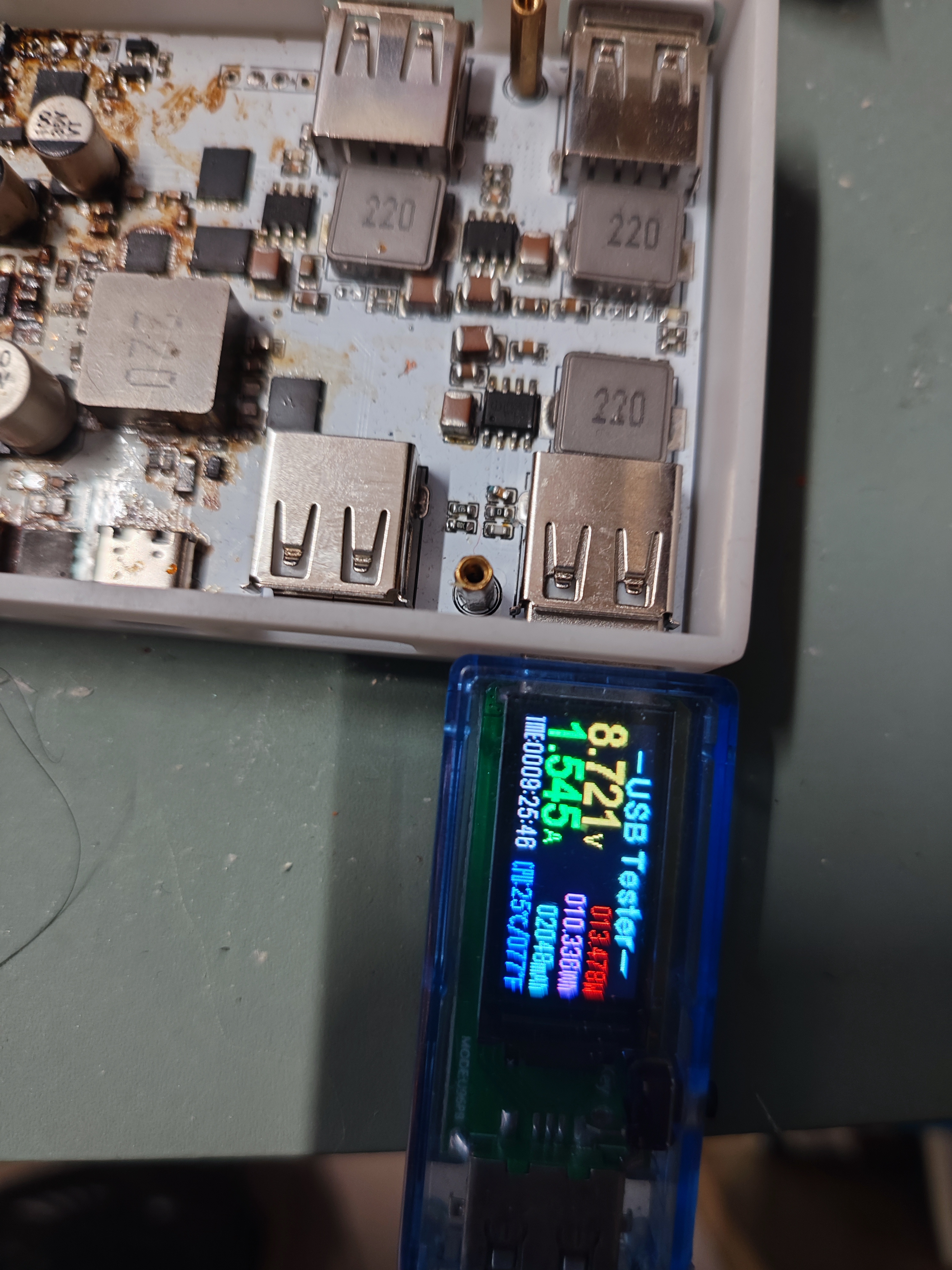

the author lacked a USB-C port current and voltage meter, tests with PD-compatible devices confirmed a normal 20V output.
The onboard ESP32 provides voltage detection and digital display, with the three high-power channels supporting current and power display.
Casing files and the digital display program will be uploaded later.
The casing files  and
power display program have been uploaded.
The casing uses a two-layer copper pillar connection,
with an M2x3 module installed below and an M2x9 module above.
Under the outer shell. step
On the outer shell. step

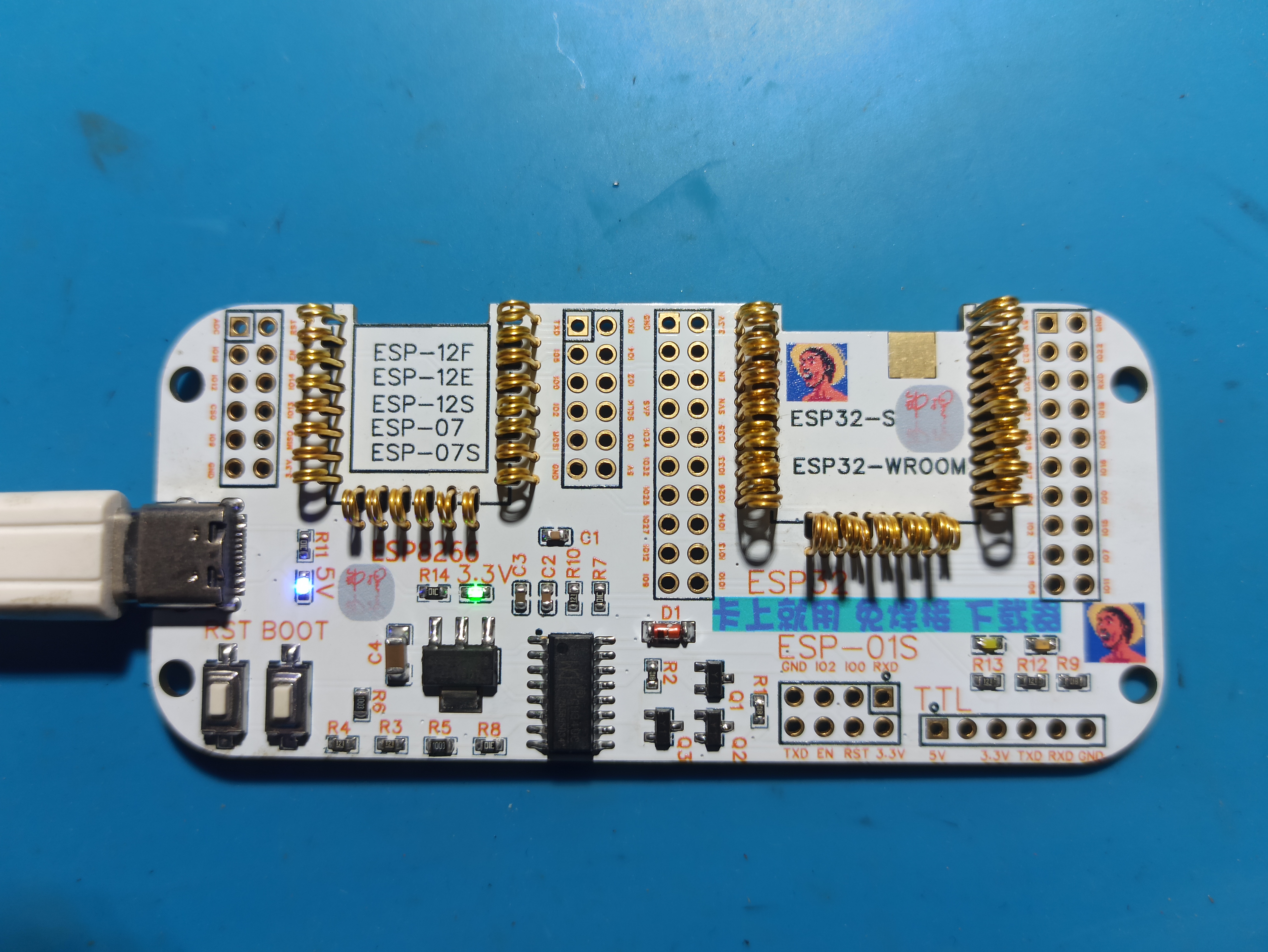

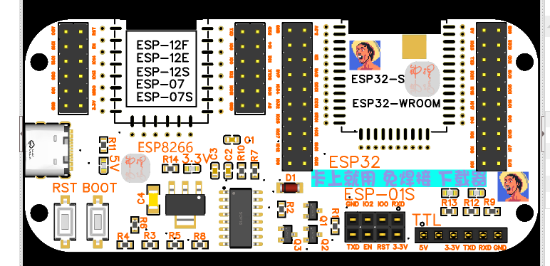

Color silkscreened ESP12 and ESP32 quick downloader, programmer, and burner rack
Convenient, fast and cheap downloader
It saves a little money on the development board; it's ready to use right out of the box, making it very user-friendly for program burning and testing.  The antenna PCB has been removed for easier disassembly without affecting the signal. The following colored PCB images are from the second version. If you don't want to prototype the colored PCB, just delete the images and icons in the project.
The file path for the programming dock is available on Taobao.xlsx

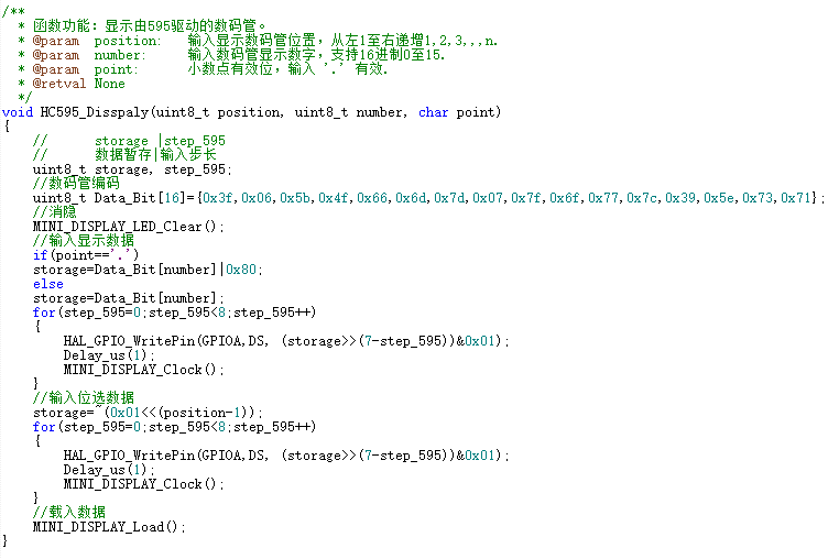

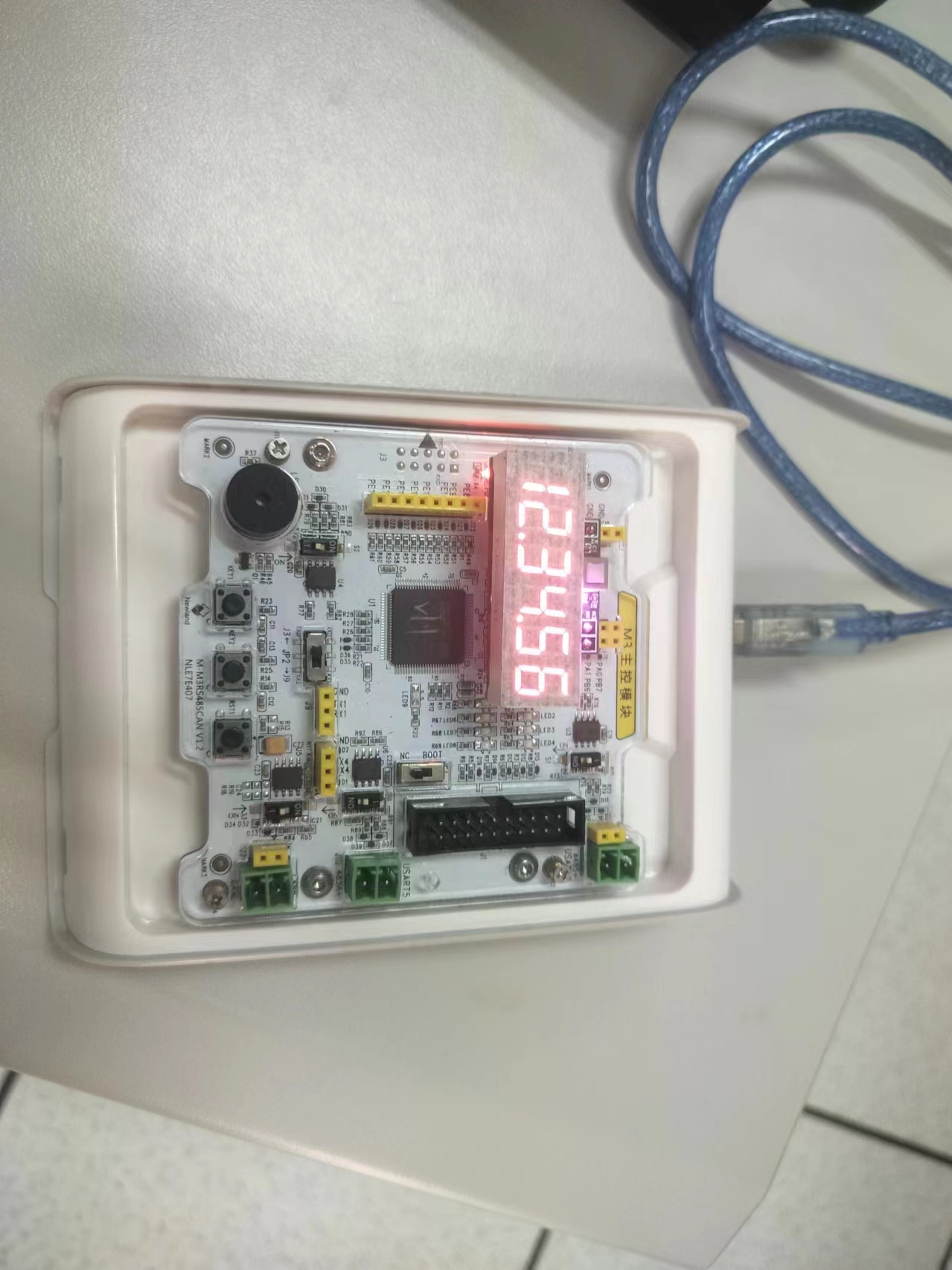

Mini_DisplayLED
A 6-digit LED display module designed based on the sensor interface of the Newland M3 development board.
It has three status interfaces, one data interface, and is powered by a 5V power supply. There is slight leakage current after power is off.
Driver section:
The first 8 bits of input data control the segment selection of the digital tube, and the next 8 bits control the digit selection.
Example usage:
Actual display:
The leftmost digit is the first digit.

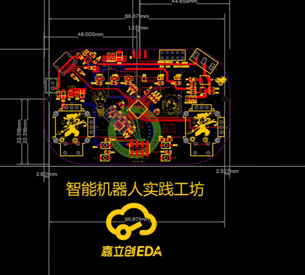

HoloCubic Reissue [with Complete Sharing Tutorial]
Replicating the Holocubic project
The problem requires
replicating Holocubic. The project mainly consists of two boards (main board and screen board). There are two versions of the main board, v1 and v2, both with modifications compared to the original. Version v2 is the closest to the original. For easier PCB routing, only the package of the main control chip was modified. Version v1 (four-layer board): Added a battery module and a power switch. Version v2 (two-layer board, recommended): Modified the ESP32-PICO-D4 package. Software instructions, 3D shell files, etc., have been uploaded. Software open-source address: https://github.com/wan-h/holocubic_reproduce. Reproduction tutorial : **Zhihu section**:   [Holocubic Reproduction Journey - Preface](https://zhuanlan.zhihu.com/p/667687467)   [Holocubic Reproduction Journey - Principles](https://zhuanlan.zhihu.com/p/668107235)   [Holocubic Replica Journey - Hardware - Circuit Schematic](https://zhuanlan.zhihu.com/p/668943131)   [Holocubic Replica Journey - Hardware - PCB Design](https://zhuanlan.zhihu.com/p/669356547)   [Holocubic Replica Journey - Hardware - PCB Soldering](https://zhuanlan.zhihu.com/p/669744283)   [Holocubic Replica Journey - Software - Project Architecture](https://zhuanlan.zhihu.com/p/670184699)   [Holocubic Replica Journey - Software - Driver Porting](https://zhuanlan.zhihu.com/p/670385330)   [Holocubic Replica Journey - Software - App Development](https://zhuanlan.zhihu.com/p/670804613)   [Holocubic Replica Journey - Shell Part - 3D Printing](https://zhuanlan.zhihu.com/p/671441116)   [Holocubic Replica Journey - Assembly Completed](https://zhuanlan.zhihu.com/p/672671669)   **WeChat Official Account Sections**:   [Holocubic Replica Journey - Preface](https://mp.weixin.qq.com/s/g9OoGMnk5hJdyEyZY1zoVg)   [Holocubic Replica Journey - Principle Part](https://mp.weixin.qq.com/s/hCcCmEE-HVDEflkmTs4eXQ)   [Holocubic Replica Journey - Hardware Part - Circuit Schematic](https://mp.weixin.qq.com/s/9BZ2hZZiAkcib54U-MHgQA)   [Holocubic Replica Journey - Hardware - PCB Design](https://mp.weixin.qq.com/s/UG-cqXRy1sHwRkdve2HKiw)   [Holocubic Replica Journey - Hardware - PCB Soldering](https://mp.weixin.qq.com/s/iGqCdDKC1GpauwrAINV9UA)   [Holocubic Replica Journey - Software - Engineering Architecture](https://mp.weixin.qq.com/s/_jIpUm0_Vr3VP4WGBFgyiw)   [Holocubic Replica Journey - Software - Driver Porting](https://mp.weixin.qq.com/s/LPaq20nl86-nybf8BDHKPg)   [Holocubic Replica Journey - Software - App Development](https://mp.weixin.qq.com/s/clkCv0ckISnppMRNjqzFOA)   [Holocubic Reissue Journey - Shell - 3D Printing](https://mp.weixin.qq.com/s/eF_fNTJvMFr8hR-gaSXPrQ)   [Holocubic Reissue Journey - Assembly Complete](https://mp.weixin.qq.com/s/OH6-Obgg1hRzLUqWNXFC6w)   Demo Video (Bilibili): https://www.bilibili.com/video/BV1hN4y1h719/?share_source=copy_web&vd_source=aa112a1eb5d3efeaf1237b8099bfc146 Physical Product Display and Description
