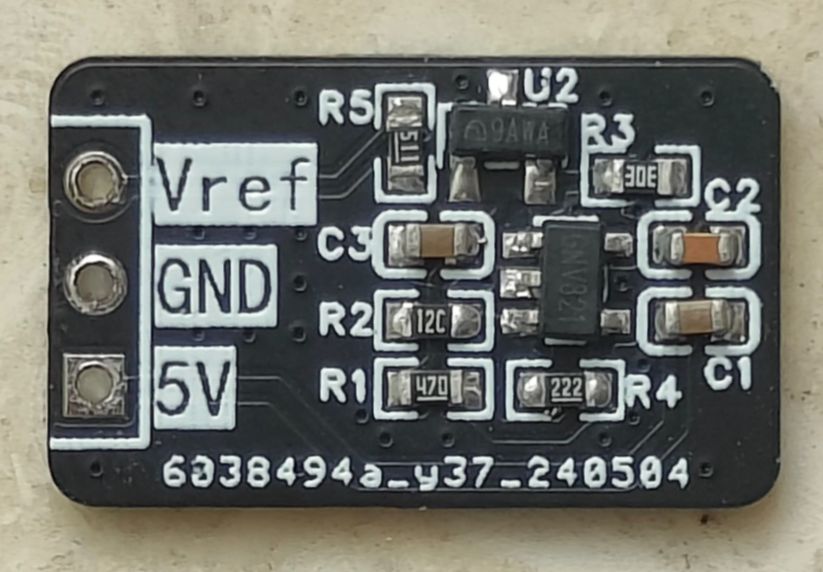

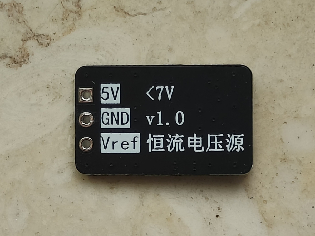

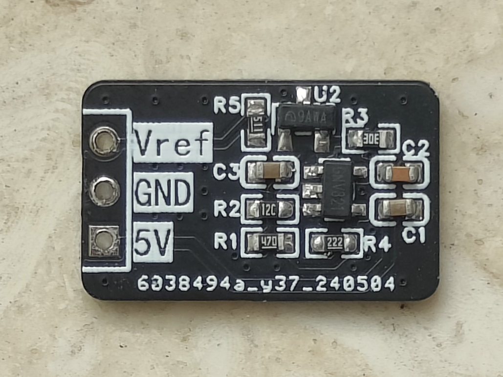

Constant current voltage source
I found an article on Zhihu that mentioned using a constant current source for a voltage reference to improve its accuracy.
This module is just for testing purposes, and the provided resistance values ​​may not be usable. Please use software simulation before building.
Simple tests showed a difference of 0.019 μm between
high temperature (2.468 Ω)
and room temperature (2.487 Ω).
